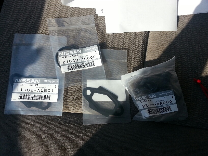

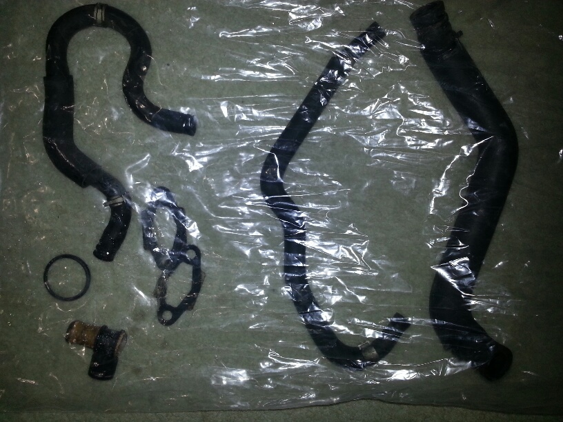

ok. so i finally got fed up w/ refilling coolant on a daily basis because i ran into a few overheating session so i been refilling coolant on a daily basis as i drive my car.
i decided to take it to a mechanic. it turns out the leak was toward the back of the engine on a pipe. it was a bad gasket. i end up replacing the gasket & O ring & valve.
the part cost about $50 at the dealer but labor was $200. it has been 2-3 days & coolant level appears to be at normal level.
there was some hose that i wanted to replace but they didn't have it at dealer & needed to be ordered.
hope this will help someone. thanks again for all your input. good luck.
pics
Attached Thumbnails 2003 G35 Sedan:  Missing Coolant - Overheating-fix.jpg   2003 G35 Sedan:  Missing Coolant - Overheating-fix-2.jpg   2003 G35 Sedan:  Missing Coolant - Overheating-fix-3.jpg
