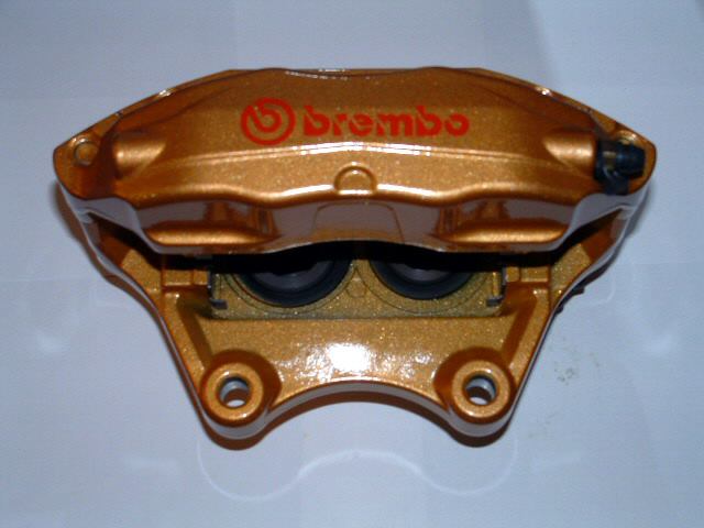

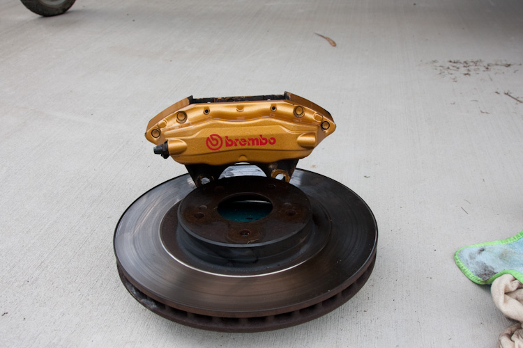

I looked through some saved pics on my computer, and it looks like the faces of the calipers are the same, but the mounting area is different. So pattyskin is probably right.
First attachment is a R34 brembo. Second is of a 350z/g35.
