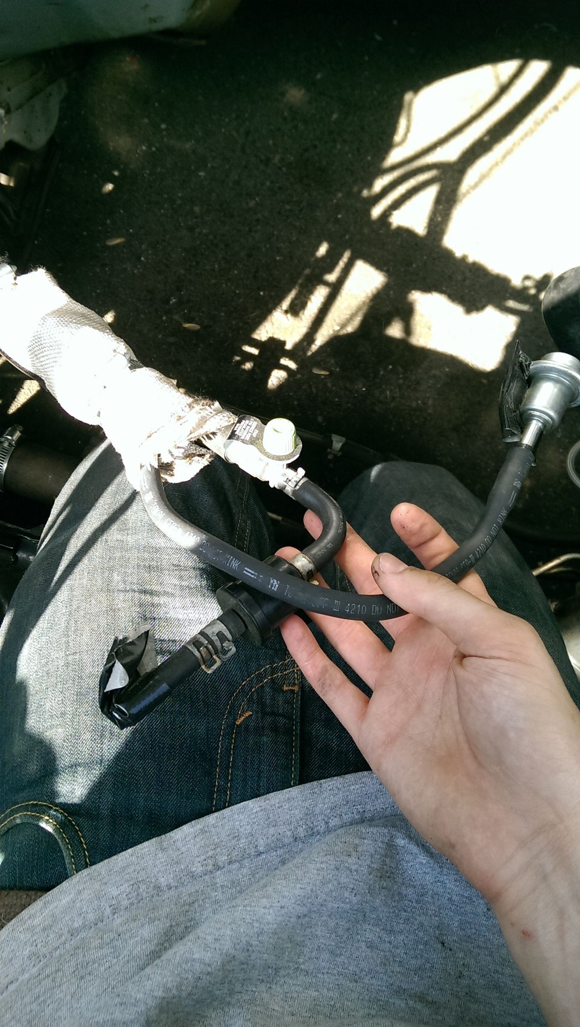

Here are some pics of the fuel lines, do these look different RWD guys?
Is the 2.87 pulley going to be too much for a stock bottom end?
Are you saying 400 with the stock pulley and 6mt?
I'm looking into return systems regardless to see what they are about.
