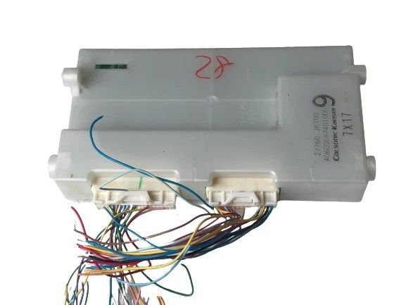

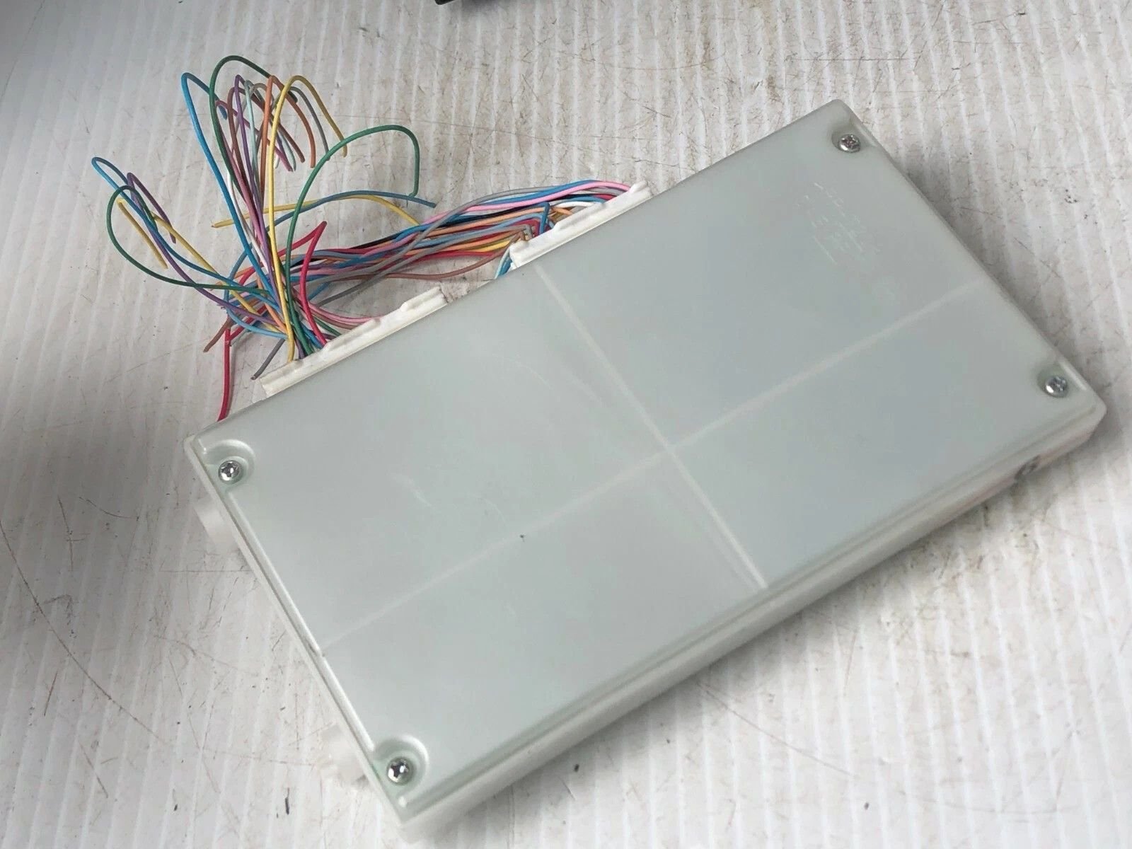

Greetings. I have great experience with the infamous fuel gauge problem on Infiniti G35X. My daughter had a 2008 G35X that I absolutely loved so I spent a lot of time working on her car until she locked up the engine and we just recently scrapped the car in June 2025. For the first several years of her ownership of her car, the fuel level reading on the gauge on the front instrument cluster was never reliable, and she ran out of gas on at least three occasions. I cleaned the existing fuel sending units, but that didn't help. I replaced them with used OEM ones that I pulled off another G35X at a junkyard, but that didn't help. Then I replaced them with used OEM ones that I bought from somebody on ebay, but that didn't help. Next, I refocused on the instrument cluster. I removed the instrument cluster from her car and took it to two guys that specialize in instrument cluster repairs in their basement shop. They couldn't find anything wrong with her instrument cluster. I bought a used OEM instrument cluster on ebay and installed that one, but the inaccurate fuel gauge persisted. I spent countless numbers of hours searching the internet and this forum in search of the answer. I was dumbfounded how many G35 lovers have suffered with the same problem, but I could never find a solution. I bought access to drawings from Infiniti and finally deduced the potential problem to a heat amplifier control module (p/n P:27760 JK700 that is mounted on top of the center stereo module. I spent countless more hours trying to locate a new one of those modules. I would frequently check with local junk yards and ebay and google in search of one. After several months my persistence paid off because I found a used OEM one. It only took me about 30 minutes to install it. I wish I video taped the procedure. Once I installed the used OEM AC Heat Amp Control Module P:27760 JK700, the fuel gauge worked correctly for the next 4-5 years until we scrapped the car . Before the tow truck arrived, I pulled that module moments only before the tow truck arrived because somebody out there needs it, and you'll be lucky to find another! The attached four photos beginning with s-l1600 are the actual ones from the ebay posting where I found the used module. The fifth photo entitled "Infiniti G35X OEM AC Heat Amp Control Module P 27760 JK700" is the module as fitted on the computer assembly that I removed from my daughter's car. Trust me, this is the answer. I've never used this forum before and I haven't investigated how to DM yet and I'm hesitant to post my name, email address, or phone number yet because I don't want to attract spam, but if somebody out there who has been enduring the fuel gauge problem who is mechanically inclined and ambitious enough to finally fix it, feel free to drop me a message. I have the module and I could probably point you in the direction of a YouTube video that shows you how to remove the center computer that is tucked behind the stereo button panels. Rgds, Andrew
