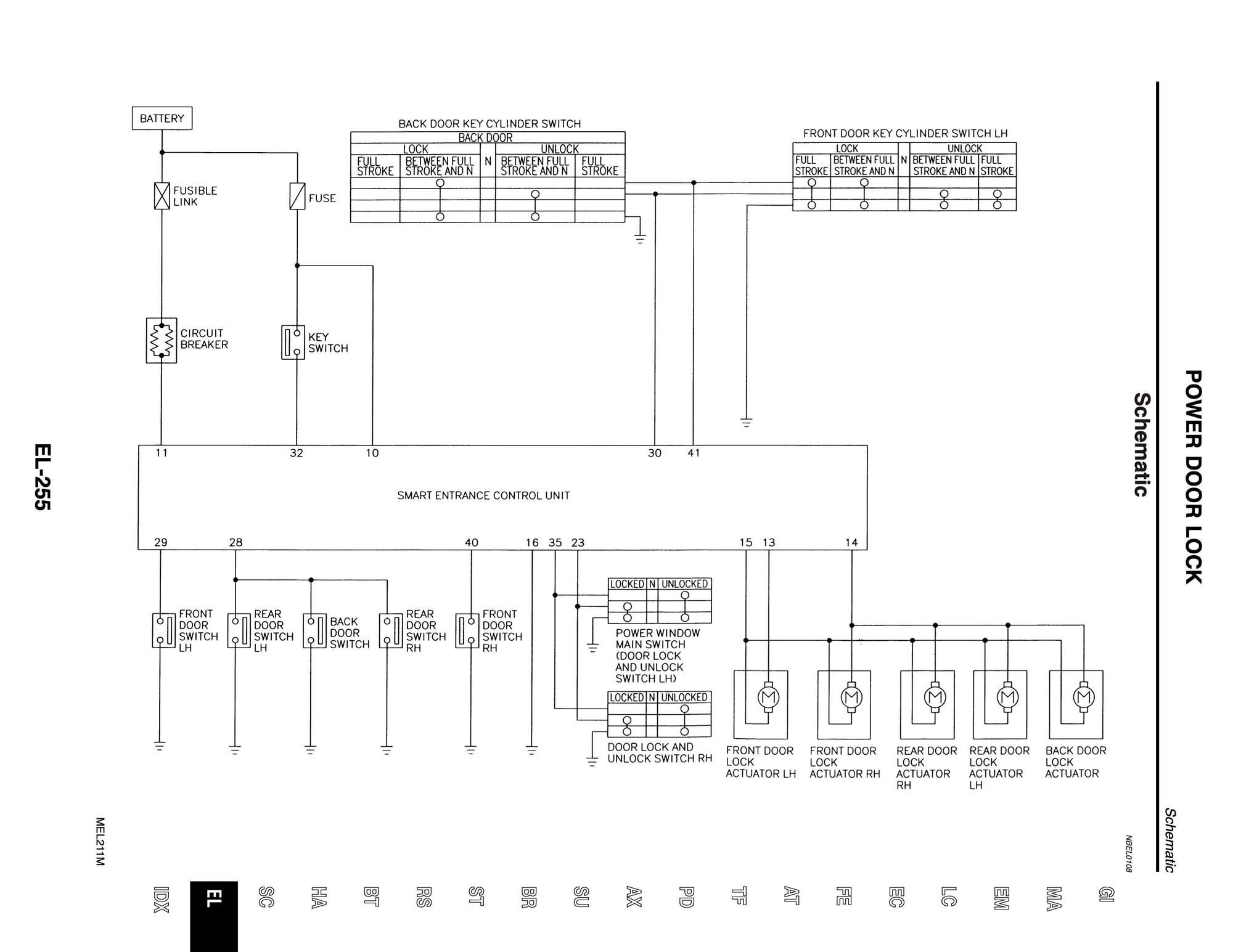

You know, it feels more like a hardware or shorted wire issue. Please keep in mind I don't know what I'm talking about, only guessing. For example, I now think I'm wrong about the driver's door piece in your car having any logic circuitry - that happens in later years. Looking at the system's schematic (attached below), it seems that all the lock / unlock switches are just that - switches, which connect to ground to indicate they are being pressed. But that means that any of those switches or wires running to them might be shorting to ground and sending incorrect signals. Your description of the passenger door button unlocking then locking all, would be as if you pressed it 3 times in quick succession. I'm surprised you haven't found the car unlocking and locking itself at random.
I'm not sure how to suggest you troubleshoot this other than disconnecting one pin at a time at the SECunit to see if the behavior improves. Or at least using a meter to test through each pin and switch. Sorry, that's about all I've got...

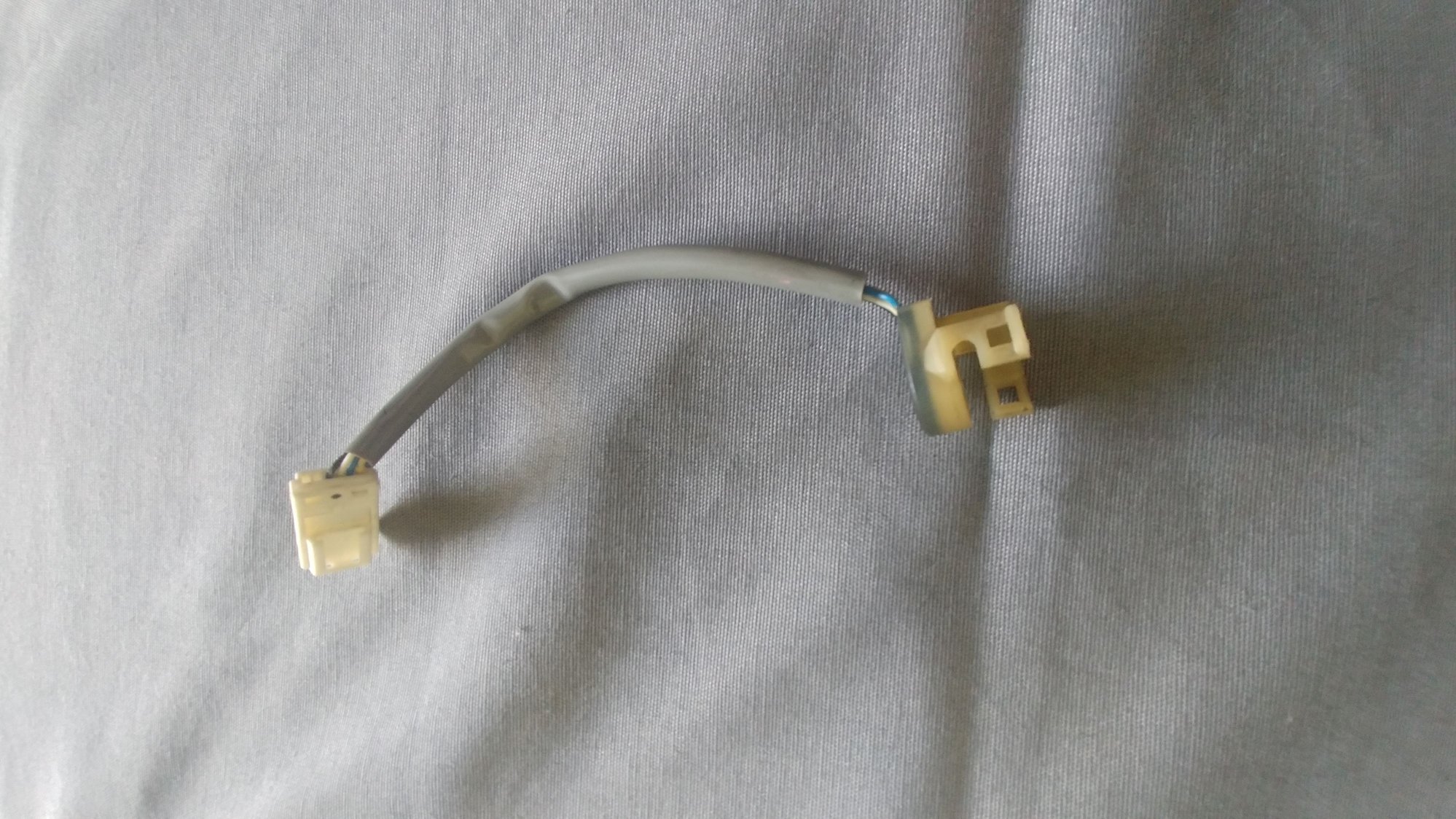

I finally received the rear hatch switch connector, installed it, and it definitely fixed the problem. I've attached a picture of the connector. It just snaps over the rear hatch lock and for some reason (heat, years, etc.) did not fit secure over the switch any longer causing the unlock/lock issue. I found this one on Ebay for $25 free shipping. Thanks again for the replies and assistance in troubleshooting.
