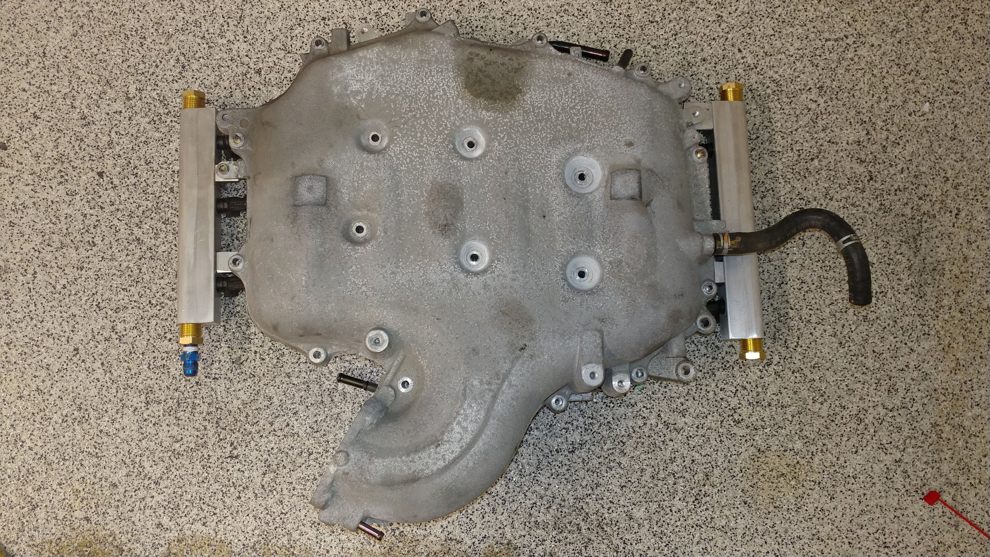

Modify upper intake manifold for 6 more fuel injectors - Finished 2-10-19
6x GT500 EV6 fuel injectors - Finished 2-10-19

6x aluminum injector bungs - (Fit and weld to lower section of upper intake) - Ebay $26 - Done
Custom 1/2" fuel rails - $30 (cut custom length and step drill injector top bungs - tap ends) - Done

Finished up the custom fuel rails and intake to add 6x GT500 injectors
