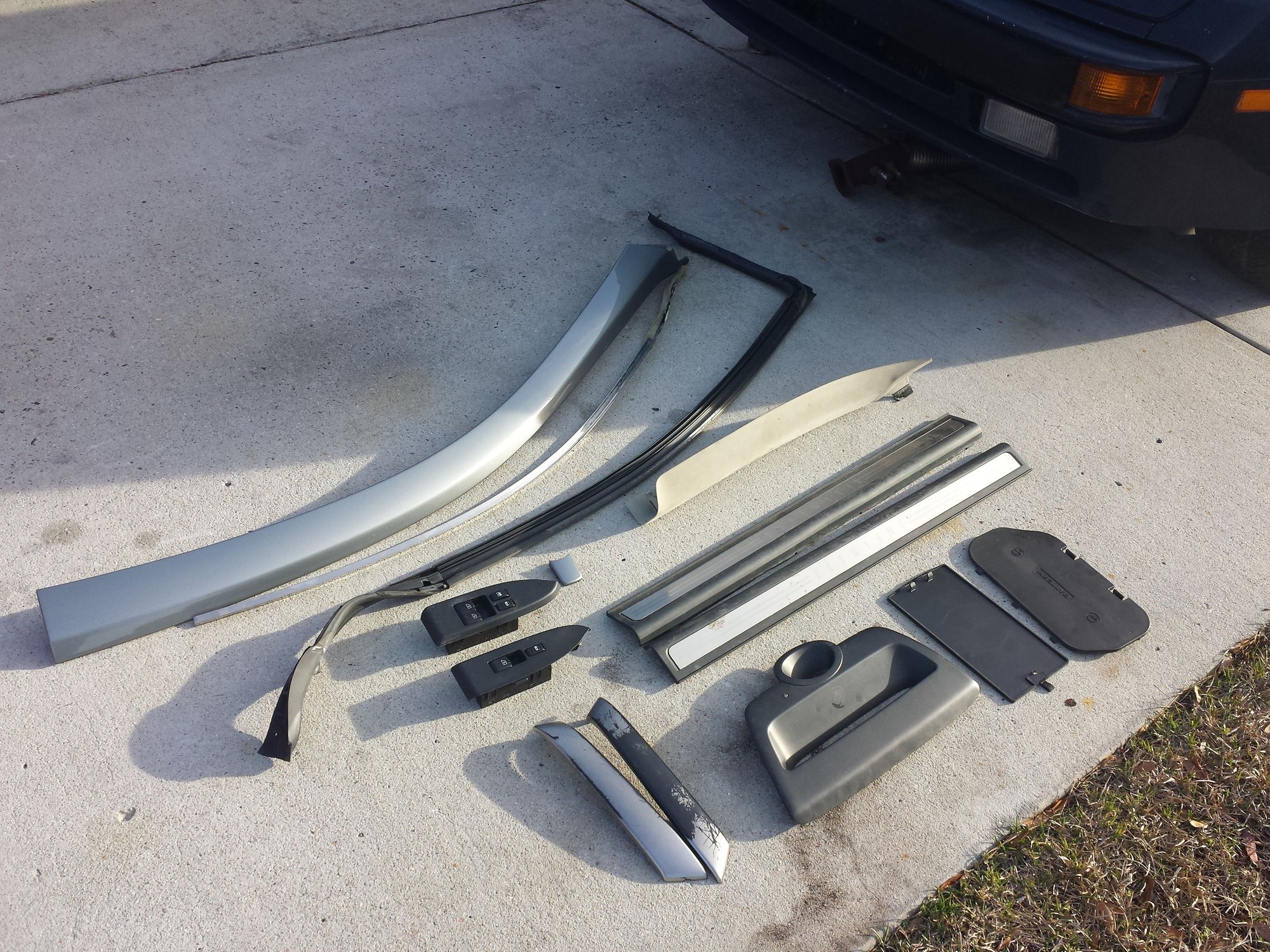

Progress... found a local guy parting an 03 coupe and pulled a lot of little things that had been bugging me.
-exterior A pillar trim that was broken by the windshield installers that didn't know how to remove it. Got the trims and seals and all. DONE
-03 clock surround that the PO had broken a corner off of and I always hated it. DONE
-driver door pull cover that was cracked and glued back together by the PO. Picked up both sides. DONE
-grabbed the window switches for both doors.. Saved for later til I need them
-doorsill covers in better shape than mine.. saved, haven't installed yet.
-interior A pillar trim since mine was broken and hanging off. DONE
-underhood battery cover that was always missing. DONE
-cover for the cubby between the back seats. DONE
