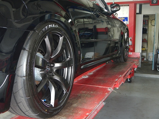

Originally Posted by CarlosM
Didn't think I was going to install the GTR wheels after I bought them, but after reconsidering, I put them on.. Here's how it looks:
Attachment 163182
They look (*)(*)
Side pics.
What size tires are you running?
