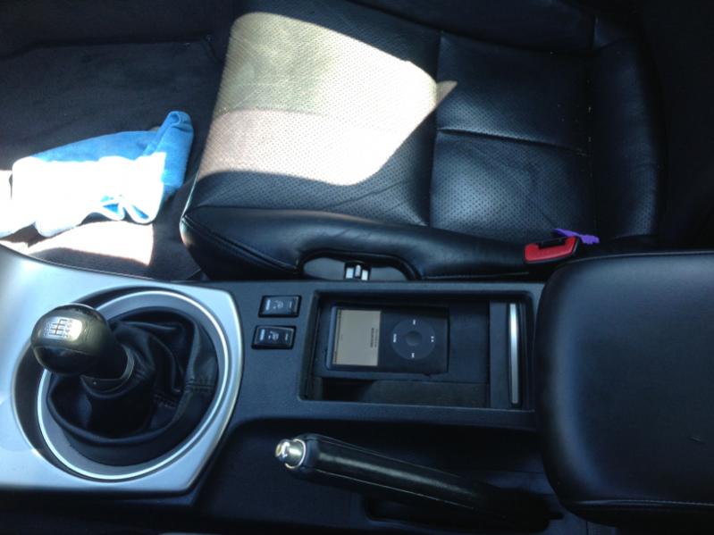

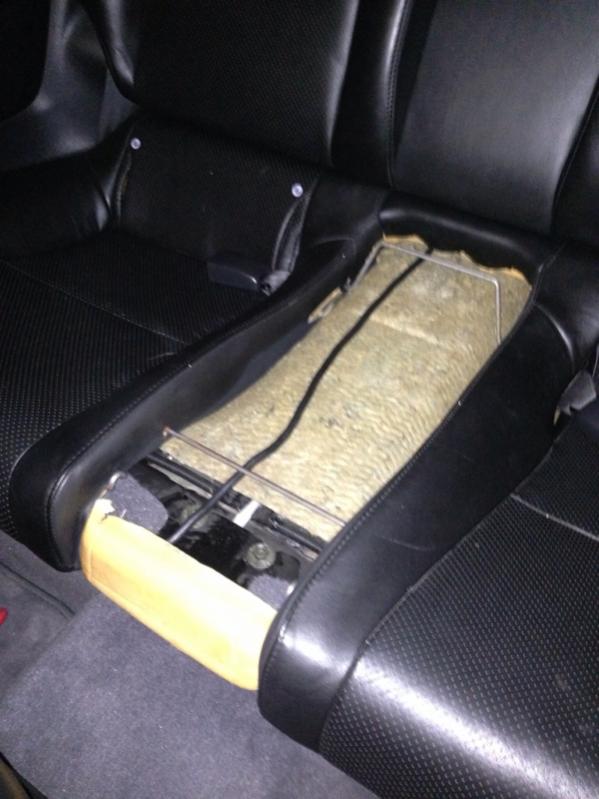

Yep, module under passenger seat. Installed the iPod in the sliding cup holder space. Wires going to the Bose amp are run under the carpet (easy to do without taking the carpet up) under the rear center armrest, and then back into the trunk.

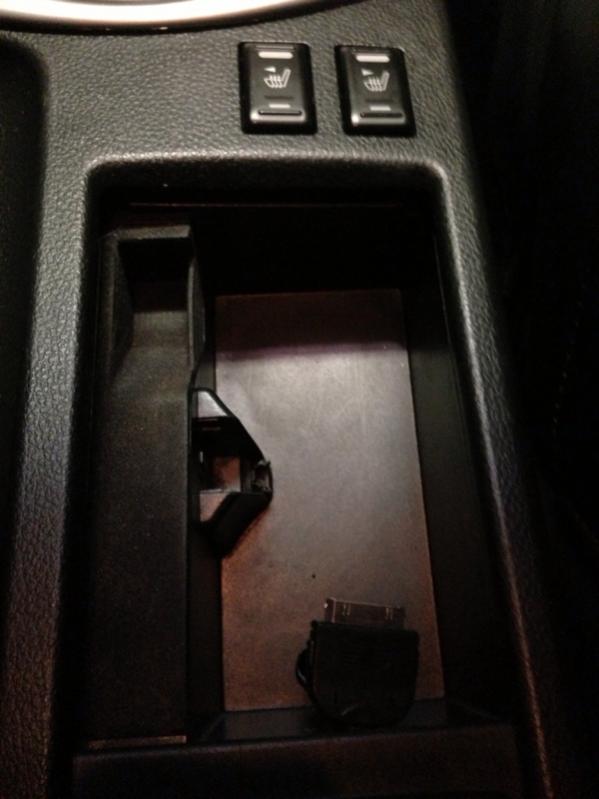

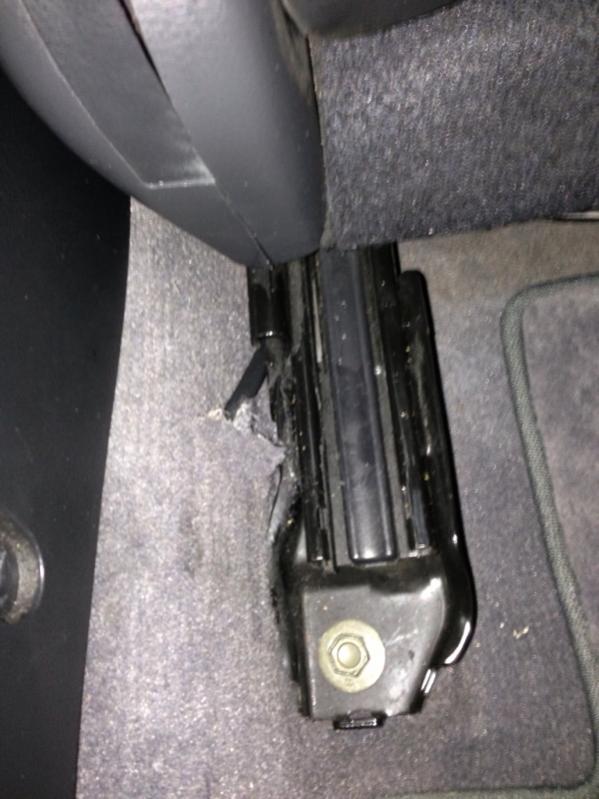

First off, relax. You won't damage anything by doing this. As mentioned before, the module resides under the passenger seat in my coupe. From there, the 30 pin connector runs inside the left side of the center console into the sliding cup holder compartment via a drilled hole in the bottom of the compartment with the cup holder insert removed. I then carved a flush mount iPod dock out of a yoga block, and painted it black with fabric paint. It feels like a soft suede actually.
To connect the module harness to the amp, you'll need to cut a small slit in the carpet under the passenger seat for the big wiring harness to fit through. Remove the center console from the rear seat by pulling up on it. Use a wire coat hanger or a fish tape to fish down the carpet leading to the rear seat to the slit under the passenger seat. Be patient as this might take a few tries. Tape the module harness to the fish tape/hanger really well, and pull it through until the harness can be reached, and navigate the harness up into the center console of the rear seat. Guide the harness under the metal bars of the rear seat center console. Release the rear seat back, and fish the harness into the trunk. Once you've removed everything from the left side of the trunk, and have the Bose amp exposed, you can guide the harness around, and plug into the satellite harness on the amp. That's all there is to it.
The module should have came with setup instructions which you'll need to follow. If you don't have them, you can get them via Google search.
Once everything is setup, you'll be able to hit the SAT button on your radio to use the iPod. Disc buttons 1-4 are head unit controlled setups which allow you to search by artist, song, playlist, etc.. I mostly use disc 5 which allows for manual iPod control via the iPod. IPOD DIRECT displays on the head unit in that mode instead of the artist, song, etc... Disc button 6 does the same as button 1, I believe. All of this can be found in the manual as well.
Below are some photos (sorry for quality) that I found from when I did this last March that will hopefully help.

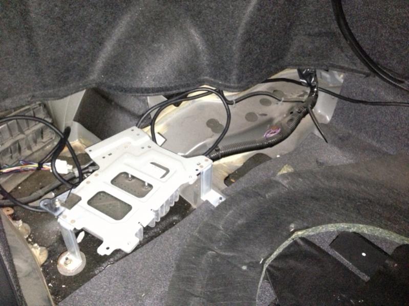

hey man I am really sorry if I am being annoying...I ended up ordering this from amazon threw a friend in the states and I don't know if I got the wrong harness since it didn't fit or I am just doing it wrong...your installation helps a lot.
Here is a picture of my rear trunk...what is that thing on top of my amp? is that the Bluetooth?
I thought the white plug is where the harness plugs in?
and this is the harness plug...
Hope this helps man. I am sorry for being annoying...my buddy sent me this from the states so I hope I don't have to deal with the hassle of sending it back!
