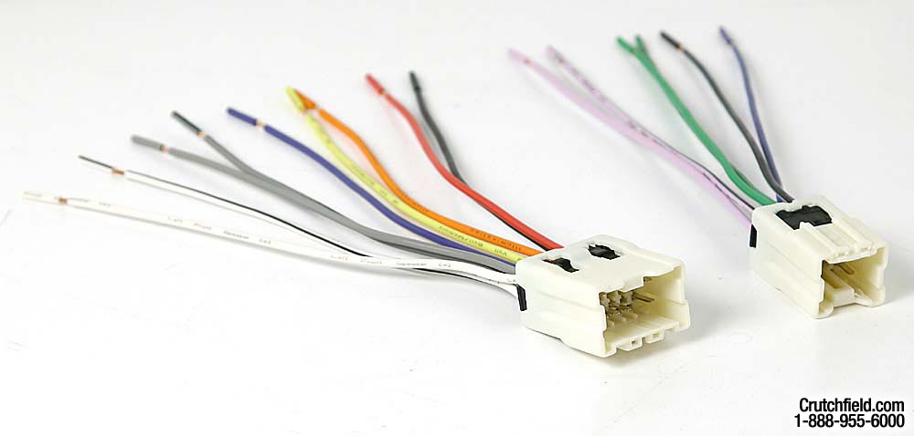

Sorry to jack your tread lancer. Good to see you Sean. Is that apply to Z1 as well. I don't understand much about amp stuff and I just want to use my bose amp with Z1. I got these harness from Crutchfield. Do I have to do anything else or just connect it to Z1 harness.
If you run speaker level outs to the Bose amp, it's not going to be good.
You can run the RCA outs into the Bose amp or get an LOC and reduce the speaker level to line level.

I think I need help on this one badly because first I don't know what LOC is.
From the research I've learned that there are 5 groups of wire behind the OME unit. 1 for AC control, 2 for OEM HU, 1 for ash tray and last one I don't know maybe for sat harness. What I want to know is 2 of those wire plugs for HU does not including the connection to the OEM amp? I am very confused. By reading these posts I had the impression of OEM amp is another step which I've to use RCA cable to wire into the Z1 HU. Please help me out and I need detail DIY information on how exactly I should do this. I just have a Z1 HU and I am using stock speakers and stock amp. Thank you again.
