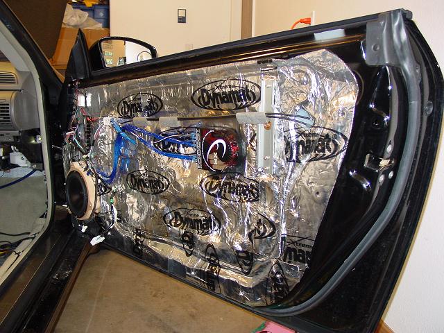

so what's a good spot for in-door crossover?
For those that have an upgraded component system with a crossover mounted in the door, where did you place it?

Here's a pic of mine. I trimmed a little of the styrofoam on the inside of the door panel armrest.

I mount them in the area beneath the window switches.
