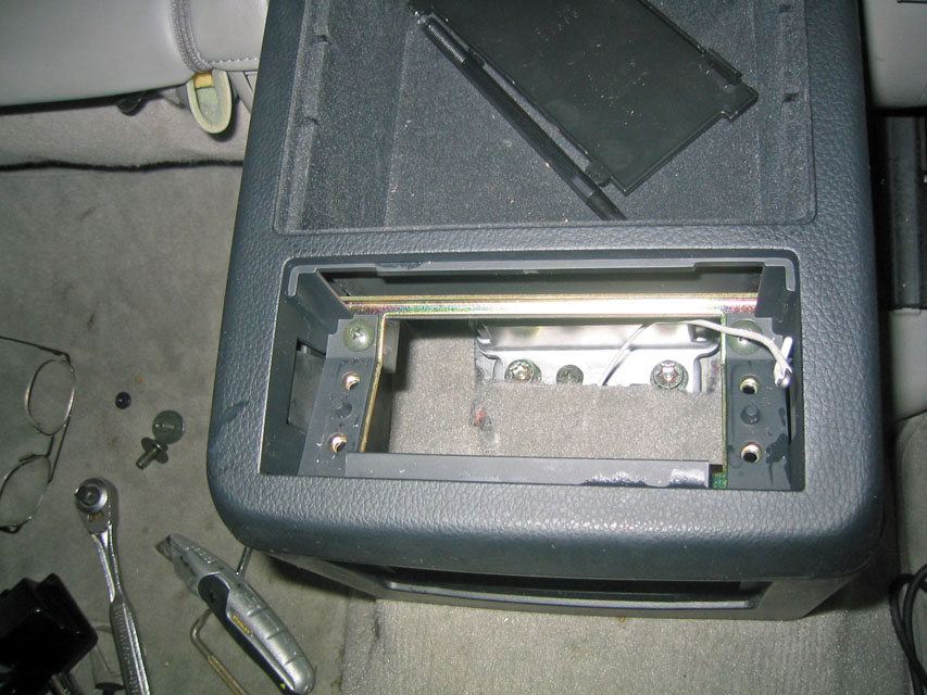

Well these are great instructions but there are a couple more things to help the truly incompetant do this (on an 05 coupe):
First, if you cant remove the trunk carpet, remove spare tire, plastic cover and then plug into the only white plug showing than you are truly hopeless ( it's very simple if you want to leave the Ipod in the trunk-20 minutes, top).
Running the cable to the rear seat console is straight forward... it helps to put the seatback up and down to get your route for the cable to go thru (just open the velcro on the seatback material between the seat and trunk near the driver's side to easily get it thru).
The rear console popped out fairly easy but for some reason one side of my rear seat was hard to pop off (more on that). Unbolting the front console only gives you about a half inch to lift up... but it was enough.
Elrooko must be some kind of Houdini to get that wire from the front console to the rear with the rear seat in place. It was impossible for me and my skills.
So here's my extra tips for those of us with limited skills:
Yank on the rear seat to pop it up (the manual says to "lift and pull forward"... no need to remove from car, just push it up out of the way to have room to pull wire thru carpet.
Take off the front console lid (pop off plastic cover between hinges and unscrew 4 phillip screws) and remove the ashtray (push down on the silver thing as your opening it and it will come out).
If you have big hands the rest of this might not work for you as the confines of the 2 openings in the console are tight.

I took a screw driver and than a socket extension and from the carpet under the back seat I tried to make a wedge/opening/path for the wire to get to the front console (you can pop off a couple plastic caps and loosen the carpet edge under the rear seats).
I used a wire coat hanger, with the tip folded over and taped and ran it to the front console. This wasn't easy and using my fingers inside the small opening at the rear of the front console I was able to feel the end of the hanger and bend it upwards so it could clear the metal backet it was bumping up against. I also took a razor knife and cut the carpet inside this spot of the console to help make an opening (you'll never see it as it's inside the console).
It was a major pain in the A*#@ to work inside this small opening and I got so excited when I got the fish thru that I taped up the wrong end and pulled it back thru
It was easier the 2nd time
I put the box in the same spot but on my car the rear console has only that one spot for the box. I couldn't get my console to snap/lock down, though it is all the way down and snug. I can live with this... if it bugs me I'll just put it under the rear seat like others have done.
I'll post/insert some pics I took but I have to reduce their size first. Except for fishing wire that 10 inches between the console and rear seats, it was really easy. That part though....

THen i tackled the installation. "Gently" pulling on the console of the 2005 model will not remove it. In fact, if i had pulled any harder i may have broke the brackets that hold it in. If you have a 2005 coupe, just remove the bottom rear seat by pulling up and towards the rear of the car. Then you can use your thumb to pop out the console if need be.
I was planning on putting the box under the rear metal piece like the write up says. Either my box is different or my console is different because there was no way it was going to fit in there. I ended up dremmeling out a rectangle hole from the inside of the console near the cup holders underneath the little piece that removes from the top of the rear console. Not ideal but it worked and it is out of sight and secure.
Obviously the front console of an AT and MT are different. I have an AT and i was not going to be able to put the hole in the back of the console. The metal bracket for the rear ashtray covers most of that area. I put it in the floor of the console near the driver side rear corner, not as sleek, but functional.
Running into those snags and being that my drill would not keep a charge, it took me about 6 hours.....entirely too long. I also dropped one of the skrews that holds the console lid on down in the console and could not get it out. Hopefully the dealership will have a few on standby.
Now that I am done, I am very happy that i did it. My friend who just bought a 370Z told me that he liked his car better because he had the Ipod connector in the console. I guess now he will be one more Z owner with G envy.
