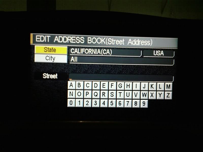

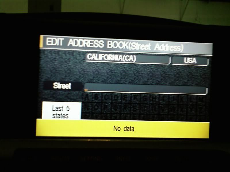

I tried clearing the memory.. I tried taking the dvd out and putting it back in.. I made sure I had gps signal.. I have tried going to edit the address book entry, then try to select a state. And it pulls up no data.. I switch countries to Canada, and it had its data for states.. Just the USA doesn't. I am all kinds of confused. please help.
Here is the screen i see to insert address book entry...
Then here is what i see when i goto select a different state.

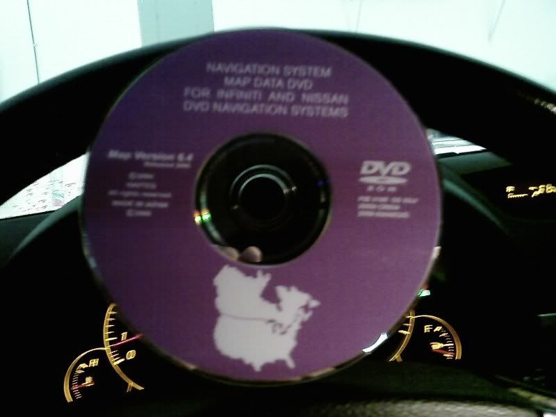

Here is the navigation dvd that came with the car, just incase i have the wrong dvd... version 6.4
