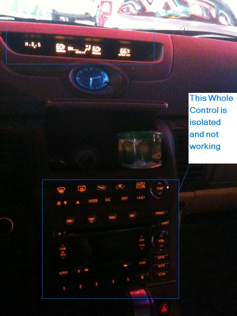

Hi there
am facing a troubler problem and i need your help guys
when i start the engine the Ac and the radio\cd\tape control is isolated
(all the buttons is not working)
and the AC starts automaticly on auto mode
** this thing happened with me before 11 months and the dealer told me to change the FINISHER-RADIO p#: 28074am883 (the whole control) and it costs about 600$, i waited about 2 month for the part because they order it from US (while am freezing in my car )
unfortunately am not living in US and there is just 1 stupid dealer in my country
and now it happens again in less than one year
if some one faced this problem please i need your help and recommendation
i dont know whats happening and how to solve this thing
My car is
2003 g35 coupe
check out the attached pic
regards.
Attached Thumbnails The instrument panel is not working and the AC is an auto mode.. HELP Please-img_0065.jpg

i had the same problem, this is very common for the 03 and 04 models. i bought the metra dash kit, wire harness and adapters. i had a single din alpine deck and used that for my g. all the climate control issue went away. there is a jdm double din kit which is better quality then the metra but cost alot more. i never bought the jdm kit but im sure members here can help you with that in youre going with the jdm kit.

Had the same problem, replace the stock head unit as the dealer says or go aftermarket as the second poster did.

my problem may have been different, but my instrument cluster went dark too... check the fuse box and look for the fuse that controls the mirrors... change that one out with a spare and see if that fixes it... my problem was the same as yours with the addition of not being able to control the mirrors and the instrument cluster was dark...ac went full cold on auto and it was freezing!!
