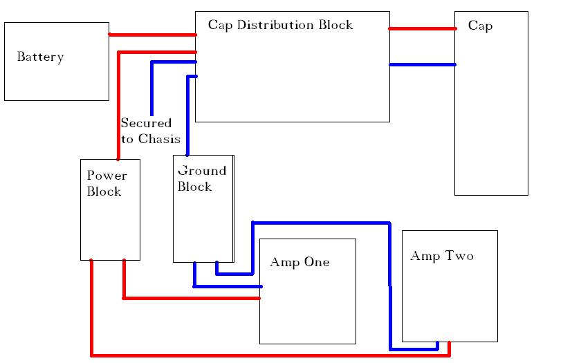

2. I followed the DIY for the sub install as posted above. I'm using a cap and the led read outs are always on. I'm concerned about battery drain and if I installed the cap correctly or not. I attached a quickly made wiring diagram of my current power setup. Can someone review it and tell me if it looks correct? Red indicates power wire, blue indicates ground.

2. Can't see any diagram here, but the cap shouldn't be connected to an always-on source.

2. Forgot to attach... just attached the wiring diagram. I made it really quickly and it is definitely not to scale.
