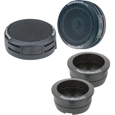

I got these replacing the factory ones located in the front doors. If you have a stock head unit i would replace that pos first.
Amazon.com: Power Acoustik NB-2 200-Watt 3-Way Tweeters: Automotive Amazon.com: Power Acoustik NB-2 200-Watt 3-Way Tweeters: Automotive
