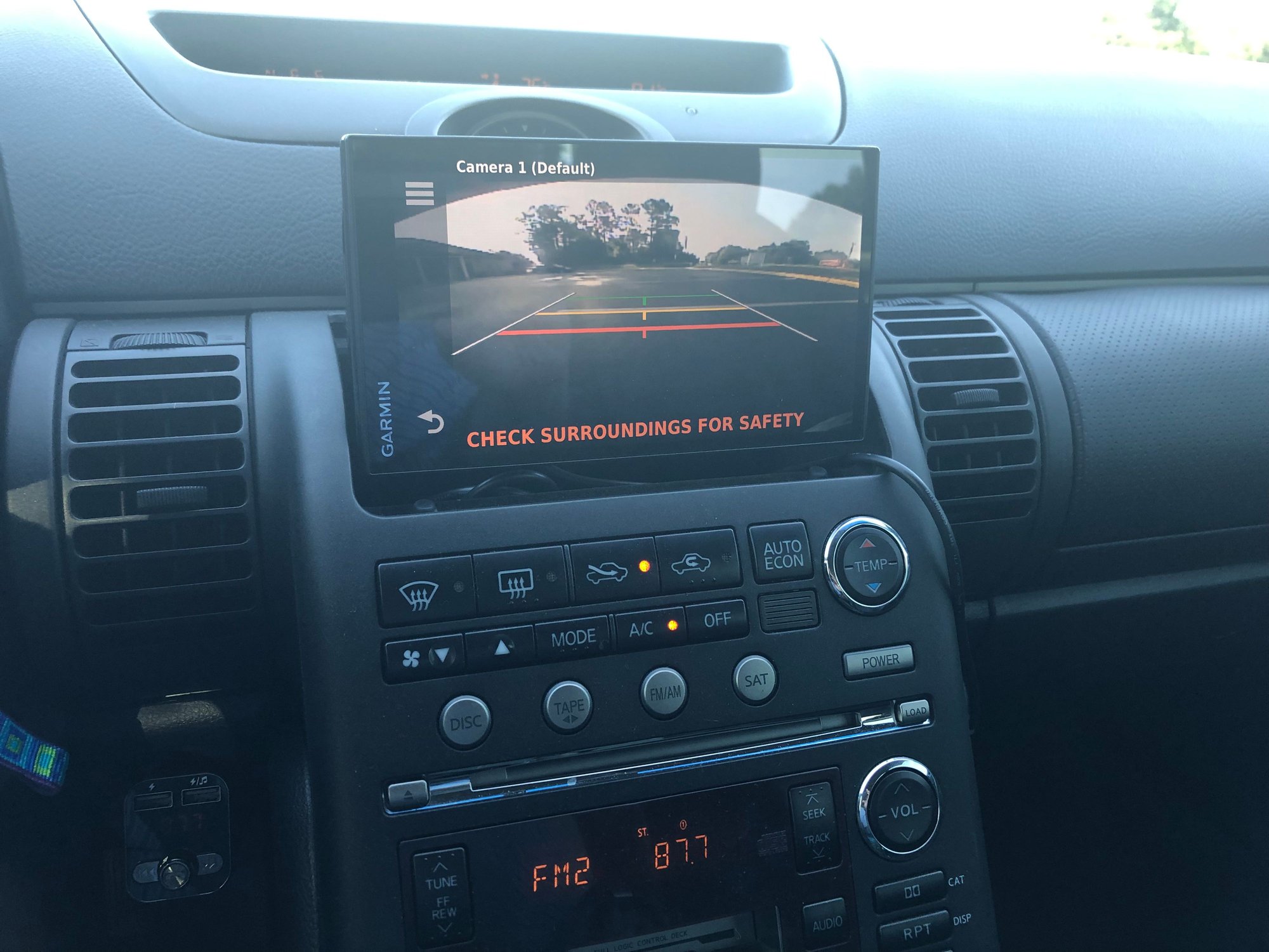

Added Garmin Wireless Backup Camera
I purchased the add on Garmin wireless backup camera. It actually comes with a new power adapter for your GPS which must be used as it has a wireless receiver built in. Be careful buying this wireless camera kit from Amazon vendors as some of them only sell the camera and camera harness.
install was easy, I tapped into the reverse lights by finding the orange wire in the loom running from the passenger side to the trunk lid. Grounded it nearby.
To mount the camera which only has a tiny single hole bracket, I had to drill a bolt hole thru my license plate. No big deal but some people might not wish to do that. I didn’t trust the clip to grip the plate alone.
Setup was automatic once everything was plugged in. The GPS unit instantly recognized it and paired with it.
Picture quality is about as good as you can hope for with an aftermarket wireless camera. Reaction time when going into reverse can take 2-4 seconds which isn’t great. But overall very happy with it and for the $130 kit price.
Garmin Drivesmart 61 LMTS with BC 30 wireless backup camera kit
DG35coupe
