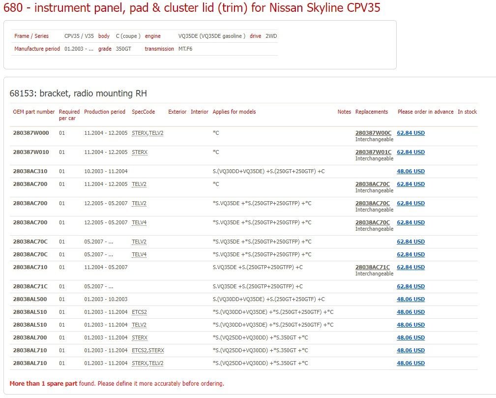

It sounds like he's looking for the bracket itself. I've looked into this myself since I bought a JDM bezel for future install (still don't have the HVAC buttons for it). It appears to be this:
https://www.japanparts.com/parts/detail/?id=11922
https://www.ebay.com/itm/175374108253 (I don't think the the OEM part number they have listed is correct, but I can't find what it's supposed to be.)

Mike - that was an amazing pull on your end! Don’t know if it will work or not I guess until we try, but I ordered it.

I don't know. It looks there are several part numbers since the V35 Skylines had more radio options than the G35. I'm not sure if the nav made a difference too.
