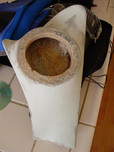

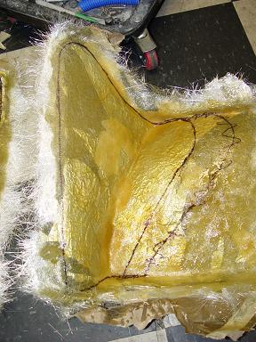

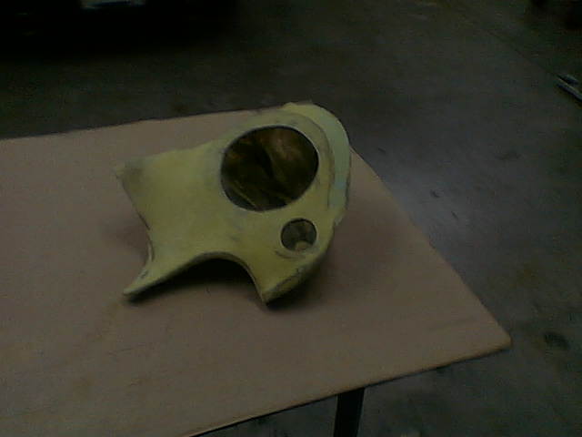

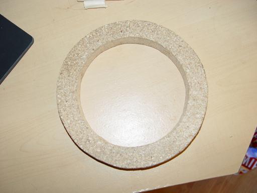

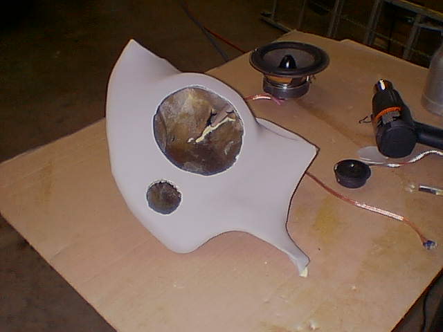

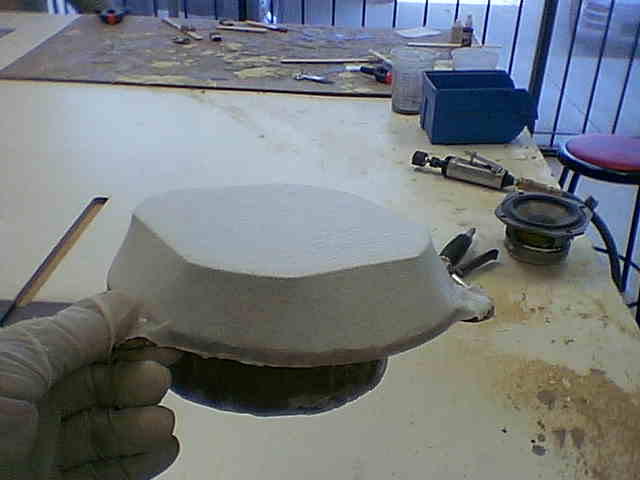

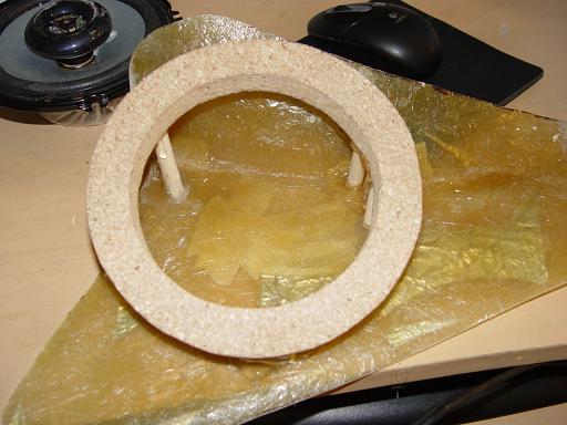

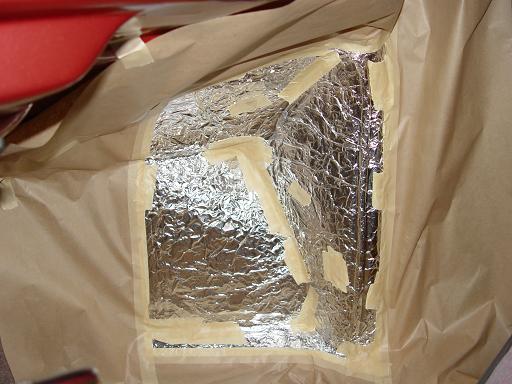

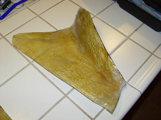

Started on my first ever kick panels today.
We bought my wife a 61 VW Ragtop about a month ago. It didnt have a Stereo so I had to install one. Theres no place to put the front speakers so I thought I would make so kicks for the car. I should be finished with them tomorrow or atleast get them in primer.
Attached Thumbnails Strated on my first ever kick panels today.-picture-1327.jpg   Strated on my first ever kick panels today.-picture-1328.jpg   Strated on my first ever kick panels today.-picture-1329.jpg   Strated on my first ever kick panels today.-picture-1330.jpg   Strated on my first ever kick panels today.-picture-1332.jpg

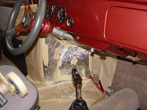

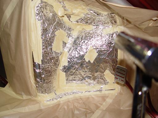

Starting to come together Steve but how about a quick DIY on how to make the "mold" to start a kick panel enclosure? Is that standard aluminum foil you used so you can pull the FG off the car?

Yeah when Im done Ill make up a how to. That was the reason for posting this in here.

It looks like you trimmed away a lot of the front edge, which would give your kicks kind of an inward-firing angle rather than pointing at you, unless I'm reading your pics wrong... and what are you putting in here?

I checked the angle by holding up the speaker. The speaker are nothing big, just some kenwoods. I should gave done this with my MB's in the G. But this will be a good test before I start tubbin the trunk on the G.

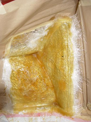

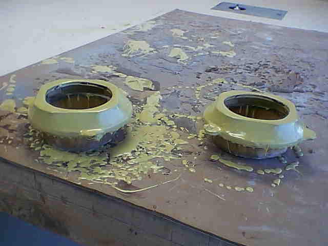

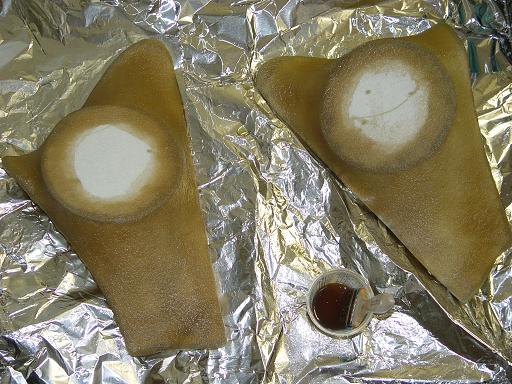

Fiberglass is drying.
Attached Thumbnails Strated on my first ever kick panels today.-picture-1335.jpg   Strated on my first ever kick panels today.-picture-1336.jpg   Strated on my first ever kick panels today.-picture-1337.jpg   Strated on my first ever kick panels today.-picture-1339.jpg   Strated on my first ever kick panels today.-picture-1340.jpg

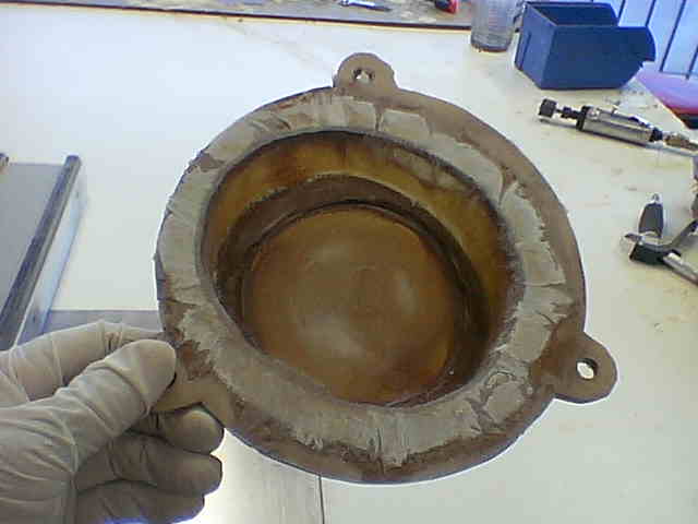

Well didnt get as far as I would have liked. I hope to get em in primer tomorrow.
Attached Thumbnails Strated on my first ever kick panels today.-picture-1346.jpg

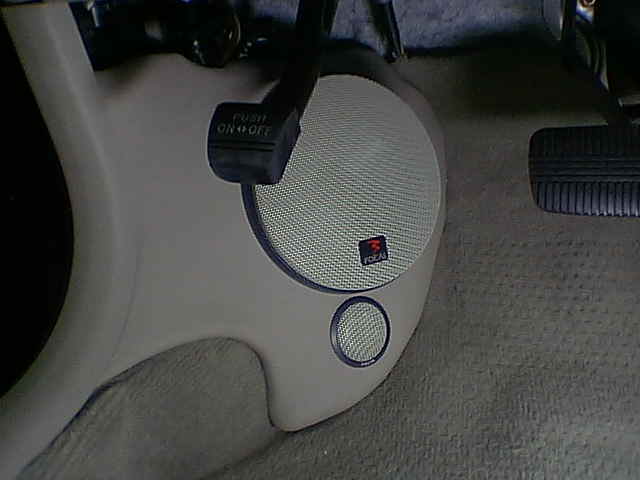

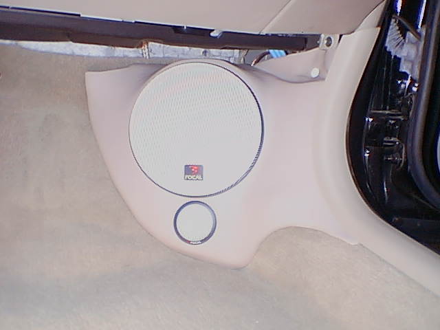

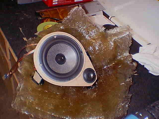

Steve - Here's what I managed to shoe-horn into my coupe. Those R Focal Utopia 6.5" I've crossed over as midranges.
Seeing your tutorial will bring back memories as well - good job so far & can't wait to see the finished product!
I've shortened the E-brake by about 4" since these pics & it works perfectly while hidden as well!

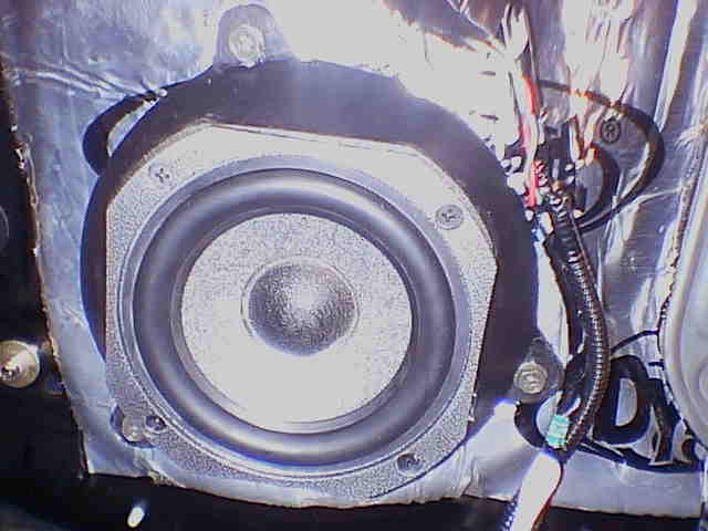

Attached Thumbnails Strated on my first ever kick panels today.-g35-stereo-install-070.jpg   Strated on my first ever kick panels today.-g35-stereo-install-074.jpg   Strated on my first ever kick panels today.-g35-stereo-install-077.jpg   Strated on my first ever kick panels today.-g35-stereo-install-085.jpg   Strated on my first ever kick panels today.-g35-stereo-install-088.jpg

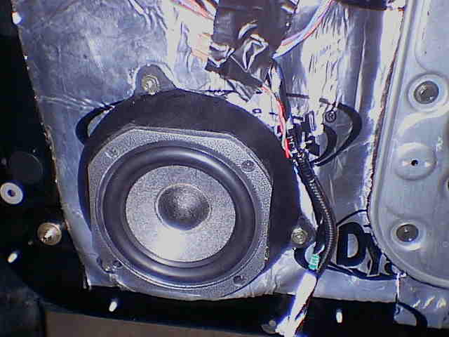

Focal Utopia 5 WS woofers in sealed enclosures in my front doors & used for mid-bass.
Attached Thumbnails Strated on my first ever kick panels today.-g35-stereo-install-089.jpg   Strated on my first ever kick panels today.-g35-stereo-install-092.jpg   Strated on my first ever kick panels today.-g35-stereo-install-109.jpg   Strated on my first ever kick panels today.-g35-stereo-install-111.jpg   Strated on my first ever kick panels today.-g35-stereo-install-113.jpg

MeanGene, do the sealed enclosures really make an improvement in the midbass?
