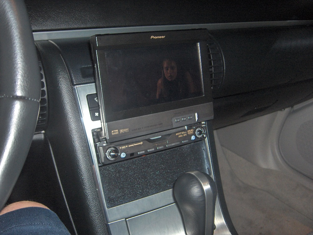

Grubbs has the parts for the '03-04's so you dont have to go through J's Garage and pay an extra $100 like i did (although J's did have excellent international business IMO) But get the DD finisher and the JDM A/C controls. Here's a pic of my '05 install with a single Din HU...
Hope this helps, if you have any question feel free to ask away.
