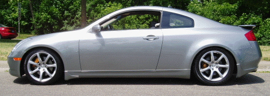

So, I installed a set of Koni Sports and Eibach Sportlines last weekend. The drop is pretty aggressive (just under 2"), but it's going to the track, so I was looking for something pretty aggressive. My camber is just over -1 degree in the front, but is in the neighborhood of -3 degrees in the rear (I'm running the stock 18" wheels). Not bad for the track, but the tires aren't going to hold up for very long at that setting. I did find that the stock setting was sitting at just around -2 degrees, which seems pretty extreme for stock (unless the previous owner messed with it). I know that I can take some of the camber out using the eccentric bolts in the rear (camber and toe)...does anyone know how much I can gain just using the stock setup (and yes, I know I can only adjust the rear...front would require adjustable A-arm)? I'm just trying to get it back to around negative 1.5 or 2.

Yeah thanks for the advice kenchan, but to each his own I guess. The stock springs are not terribly track worthy, and I would put the Koni's up against the d-specs anyday. I wanted the car dropped and wanted a stiffer spring (didn't want to just try to fix it with swaybars). If you like body roll, I suppose your suggestion would be the route you'd take...I on the other hand had enough body roll with my WRX. And yes, as you probably already know, the G does have, surprisingly enough, some substantial body roll.
As for the ride, it is bumpier than stock, but the Koni's are surprisingly smooth at the softest setting (feel a lot better than stock). Now, at the firmest setting the car can be a little unbareable but handles like a dream, but that will only be used for the track. Again, at the stiffest setting the car is very "bouncy", but at the softest setting the car is very comfortable. I just have to be on the lookout for potholes and or really nasty curbs.
Finally able to get a pic small enough.

i would really like to see that drop must look sick!!

cusco arms will not get you close to oem specs with that drop. i suggest 350evo, or kinetix/etc.
good choice on the Koni yellows. they kill all tocrappos.
