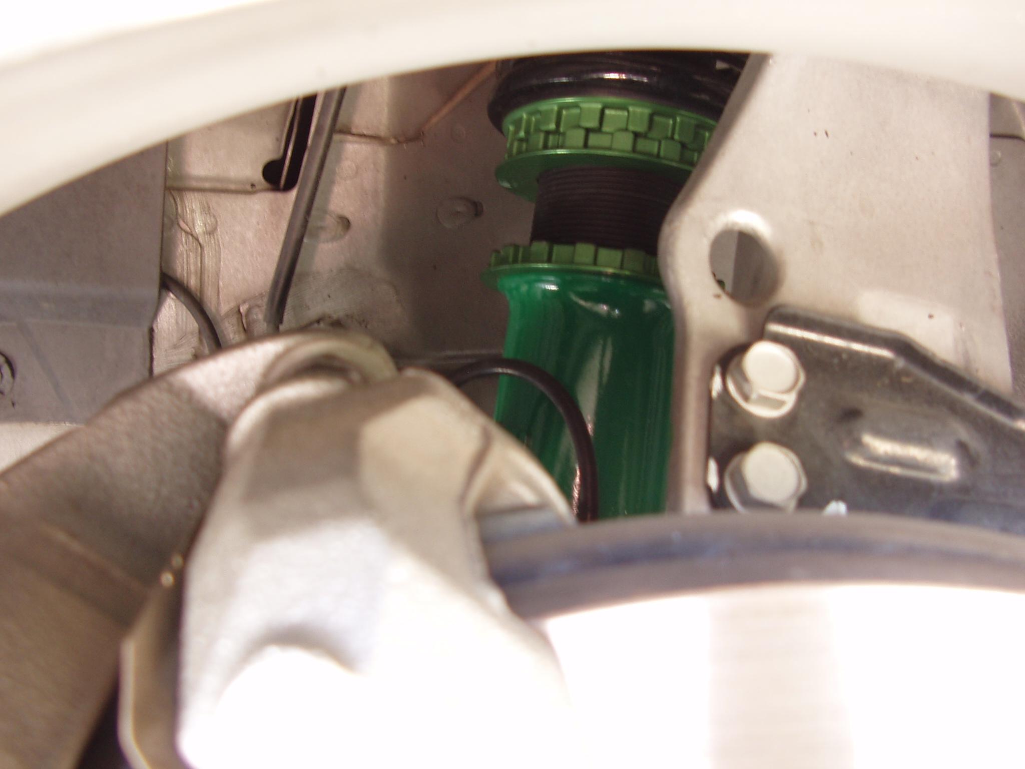

TEIN FLEX pix
Tein Flex pix
Attached Thumbnails TEIN FLEX pix-tein-front-1.jpg   TEIN FLEX pix-tein-rear-1.jpg   TEIN FLEX pix-tein-rear-2.jpg

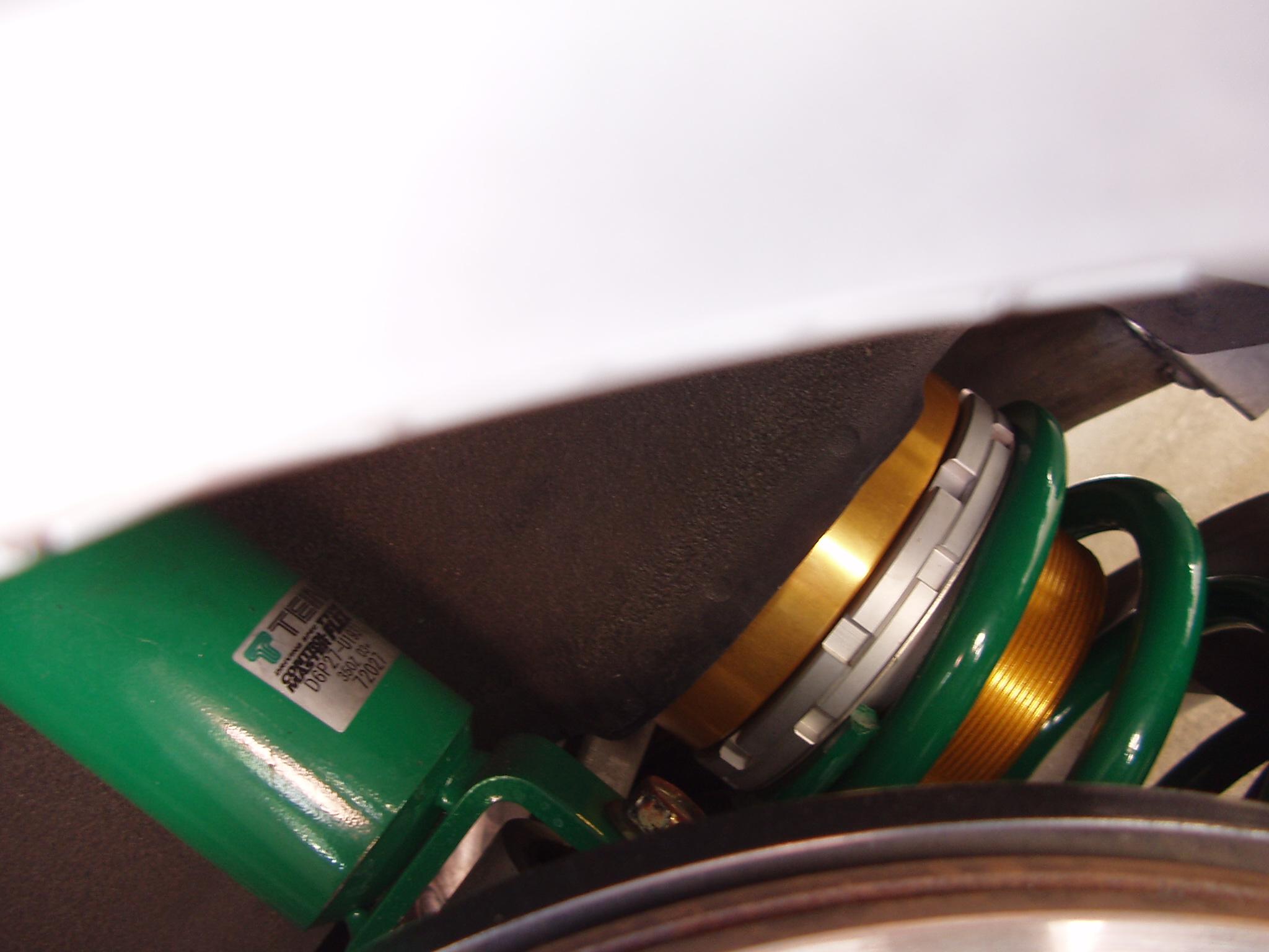

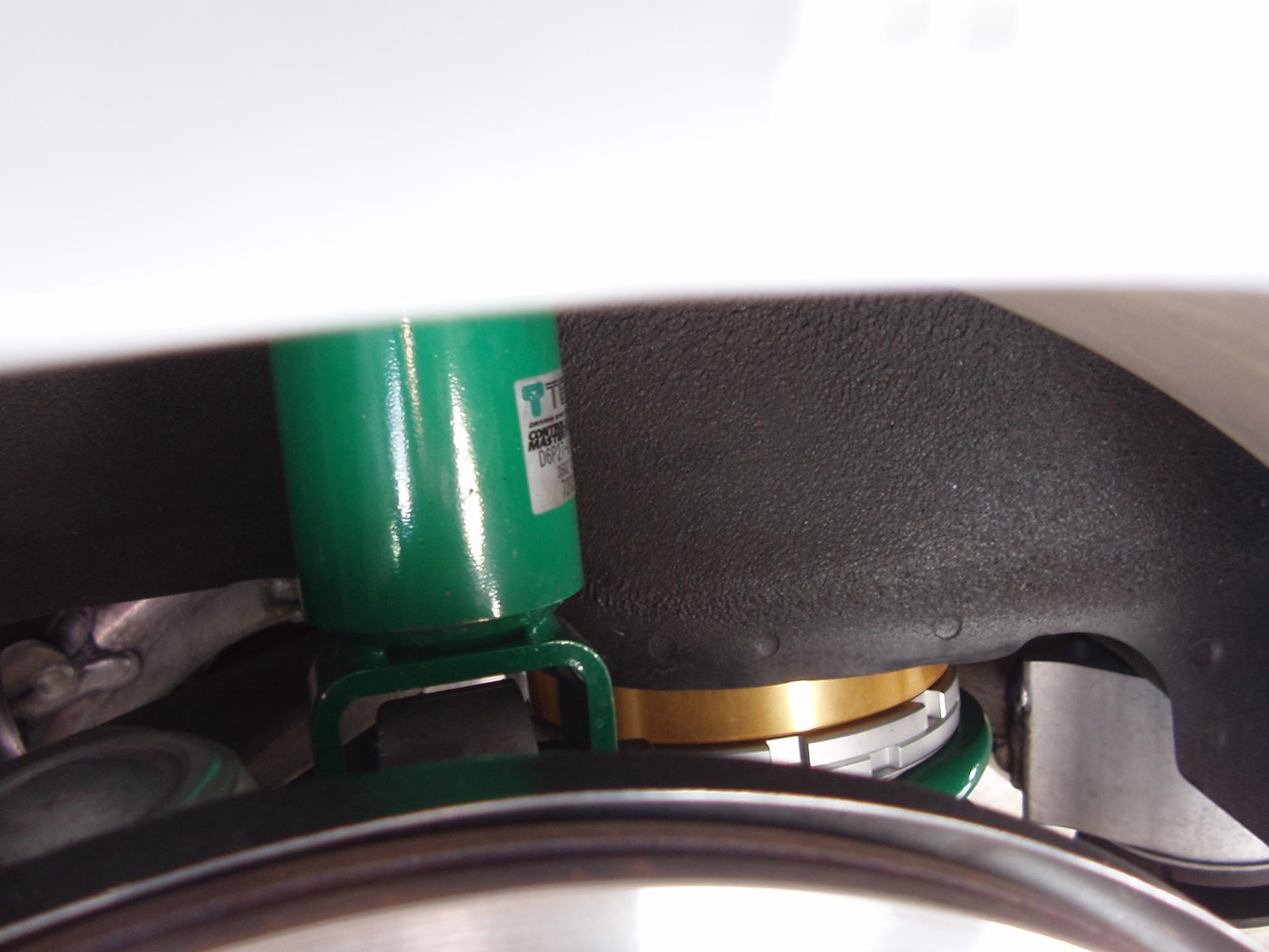

Lower pix
Lower~

Very Nice...but I have a quick question for you...I have the CS and when I tried adjusting the rear to lower it...I turned the "lock plates (dont know what theyre called)" downward, so that it compressed the spring...but after I was done, the rear looked higher and still does 2 weeks later...am I adjusting the REARS the wrong way??? Thanks!
You are turning them the wrong way.That will not compress the spring.It raises the spring mount location.Turning them up towards the car will lower the spring mounting location,in a sense creating an overall shorter spring.
when you say towards the car you mean upwards??? Is this the same for the front as well? Thanks!

turn the collar upwards towards the gold piece to lower the car.
YES For the rear.For the front lowering the collar will lower the car.
