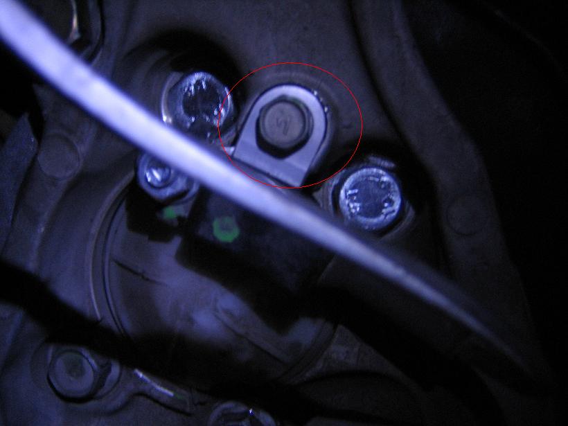

i circled the area where the bracket screws on to the hub.
i have a washer that goes on the hub, and then the bracket, followed by the nut with a locking washer screwing on the bracket.
is that right, or shud that first washer not be there? seems like removing that washer before the bracket would move the abs sensor closer to the hub.
one more thing, do you guys have a hard time screwing down the abs sensor to the bracket?
not the screw that i circled, but the sensor that screws to the bracket itself.
even tho the abs sensor is loose, it's as if the nut isn't the right size or something. it takes quite bit of torque to get the nut off till the very end.

^ where'd you get the washer that goes between the hub and bracket? i never had one. removing that would make it closer. and yea the nut holding down the sensor to the bracket is very hard to tighten down, i think thats the problem, which causes the bracket to bend.
