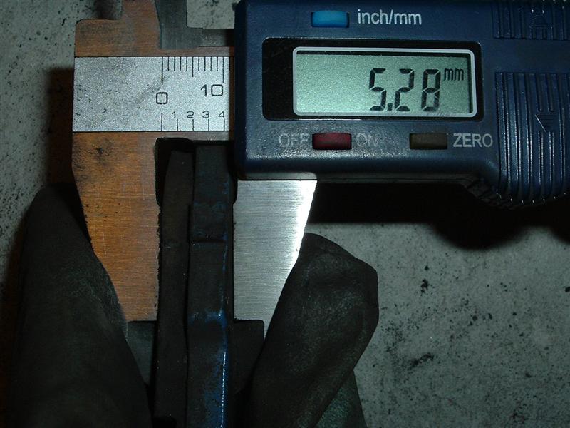

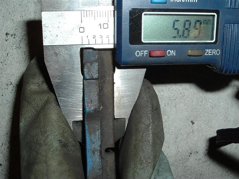

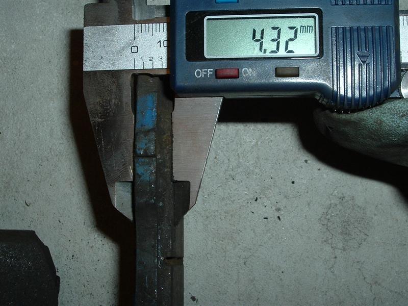

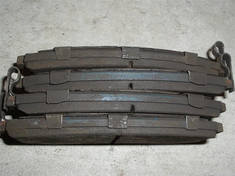

Hi GTR_Boy, I asked the dealership tech to return my old pads to me, so here are their measurement. They have around ~5.0mm left on them.
First, the sale person told me my pads are worn out, need replace asap, then I asked their manager, he said 20%, now I measured them, they still have 37.5% left on them??? 3mm /8mm = 37.5% left?
Is my dealership ripping me off?
I hope I am measuring them correct.
ILuvMyG35
ILuvMyG35
Well, there's 5mm left if you plan on grinding your steel backing plate against the rotors. You're measureing the thickness of the pad with the backing plate, which is about half the thickness of your pad right now.
As for them needing to be replaced ASAP...They look to me like they still got a few thousand good miles in them. I wouldn't track on these pads, but for street driving they're fine.

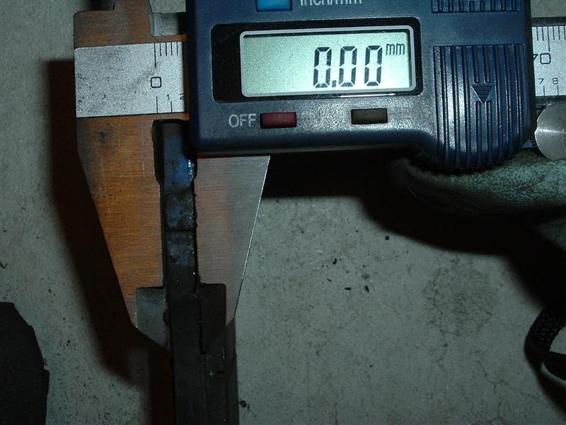

No.. I measure the backing plate first, then set my reading to 0.0mm (as in the second photo). The measurement is only for the pad compound not including the backing plate.

What am I missing one of your photos showned 4.32 mm so 2mm above absolute minimum.
I would have changed them also since I cannot gauge when you might come back and the closer you get to minimum the hotter the pad get and thus increase wear rate vs brand new............wear rate is not linear as you get worn down.
After all thick pads are for your safety.
Hi Q45, yeah I guess you are right about the 4.32mm one which has 2.32mm left before minimum. It's really sad all my other 3 pads has like ~5.5mm or more left which is like 37.5% left.
Thanks for telling me the wear rate is not linear, cuz I also thought it is.

I wouldn't suggest running any brake pads this far, but if you take a look at the first picture of the brake pads, you'll notice there are strips of metal on the left or right of each pad. Those are wear indicators, and if you really need to replace the brake pads, you'll hear them scrape on your rotors, producing a squeaking sound when you step on the brakes.
Old Jul 21, 2007 | 12:37 PM
avs007's Avatar
Joined: Jan 2004
Posts: 1,504
In my experience, wear indicators tend to squeel whenever you aren't pressing the brakes, and then quiet down when you press the brakes.
