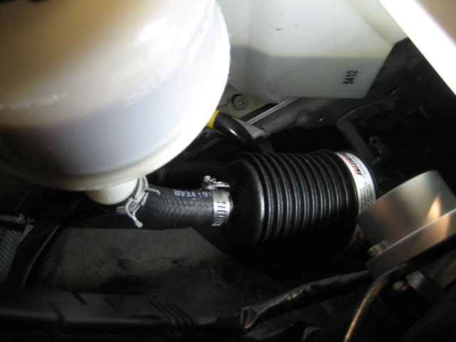

progress
Started the install tonight...
I've ripped out a bunch of plastic covers to get good access to the area. Here are some progress pics:
Magnefine power steering fluid filter-viewofreturnhosenearreservoirfromthebottom.jpg
Of course I'll be doing some videos as well. A power steering flush video and a magnefine in-line filter install video.
Old Apr 19, 2008 | 05:46 AM
bythabay's Avatar
Posts: 2,174
Likes: 77
From: Santa Clara, CA
finished
Thanks for helping me out erdog, I couldn't have done it without you
