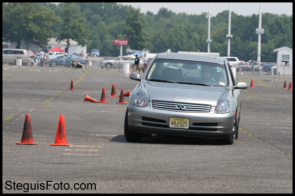

Just seems like ALOT of body roll in the pics at the autoX, and I'd like to see if anything can be done about that without moving out of stock class. I don't mind moving out of stock class, but when I do, I want to do a helluva lot more to the car, which I can't afford right now.

I am not sure about the endlinks and such. I autox'ed my X stock and it did roll like crazy.
I never had too much of a problem with understeer. The car is RWD going into a corner, I would push it pretty hard and when it starts to slip a little (oversteer) you can feel the front tires start to pull you through the turn... its a freaky feeling but the ATTESEA-ETS AWD does it job well.
I thought the car felt overall neutral, because of the RWD->AWD nature of the trans.
Here is me autoxing on a .6 mile go cart track.
