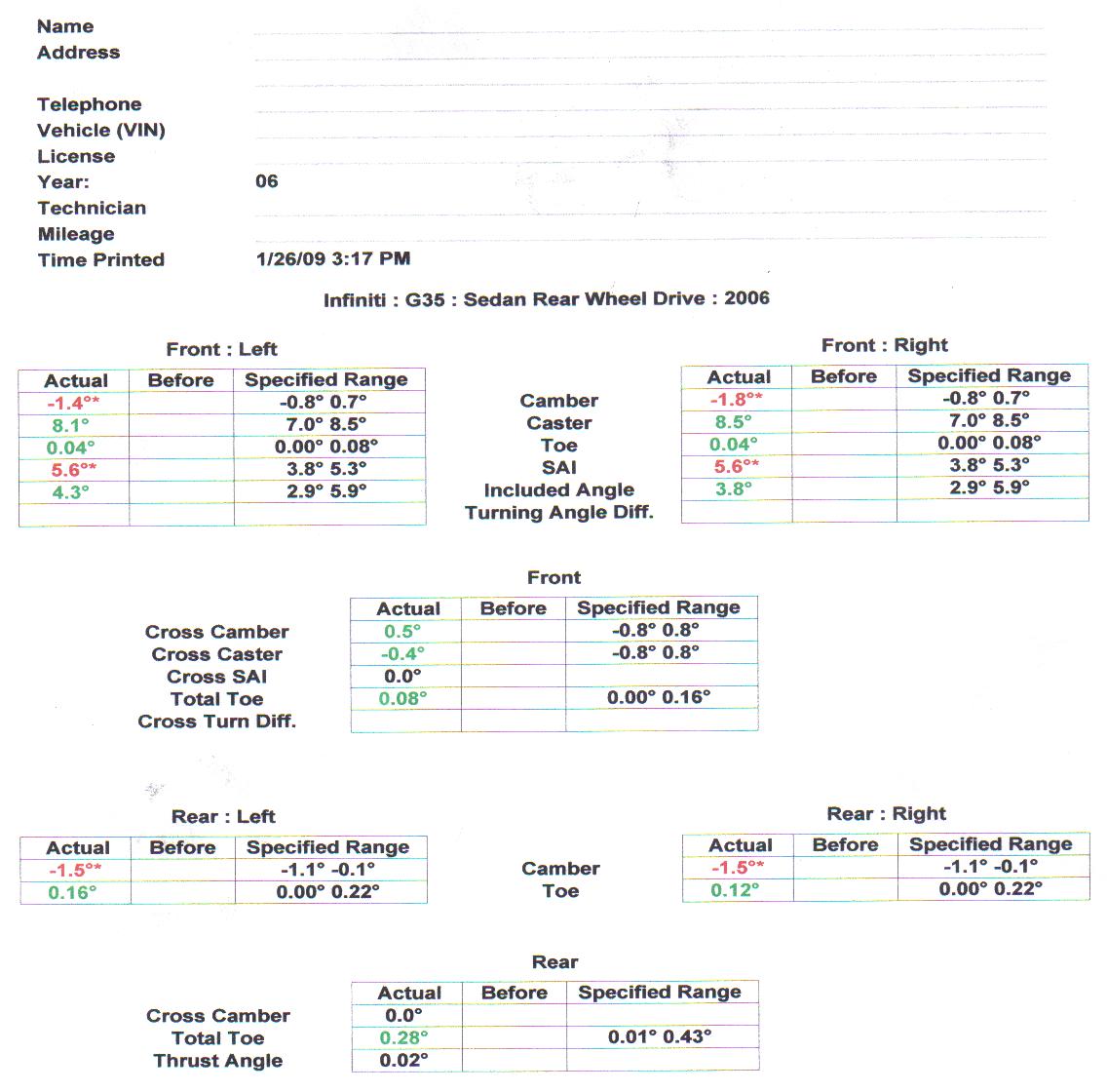

just got alinement dont know if its rite
I have 06 coup with 20s ad coilovers. I also have spl a arms and spc camber w toe bolts ect. what do you guys think I dont know anything,, Lol I am new to all this I thought I would be all in specs... I had firestone do life time alinment two weeks ago and they did not give me resolts act, one of my rear tire was way out, you could se it right away so I took it back they tride to tell me there was nothing they could do. I told them I had camber kit act they said they would se what they could do and this is what they came up with. I have to go back because they left my stiring wheel off and I cant stand that........... I lowered it about 1/8 gap front and 1/2 to 3/4 back.

I would have them adjust the rear toe in to around 0.05, other than its not too bad. The camber in the front right is a little off, but I assume you had it done without you sitting in the car, so with your weight, the front camber should even up pretty well. Ideally they would let you sit in the car while aligning and get both sides even, but most shops won't do that

how do they ajust the rear toe because I dont know if they know I had the toe screws. do they just tietn or loosen to ajust because I dont think he nows what to do they said thats the best they could do. am I going to have on even tire wear

The adjustments are in the stock locations, so it shouldn't be any different. Did you elongate the bolt holes before installing the toe bolts?

no I did not know I had to. do I need to do it now and what do I do.

http://my350z.com/forum/brakes-and-s...-protocav.html
