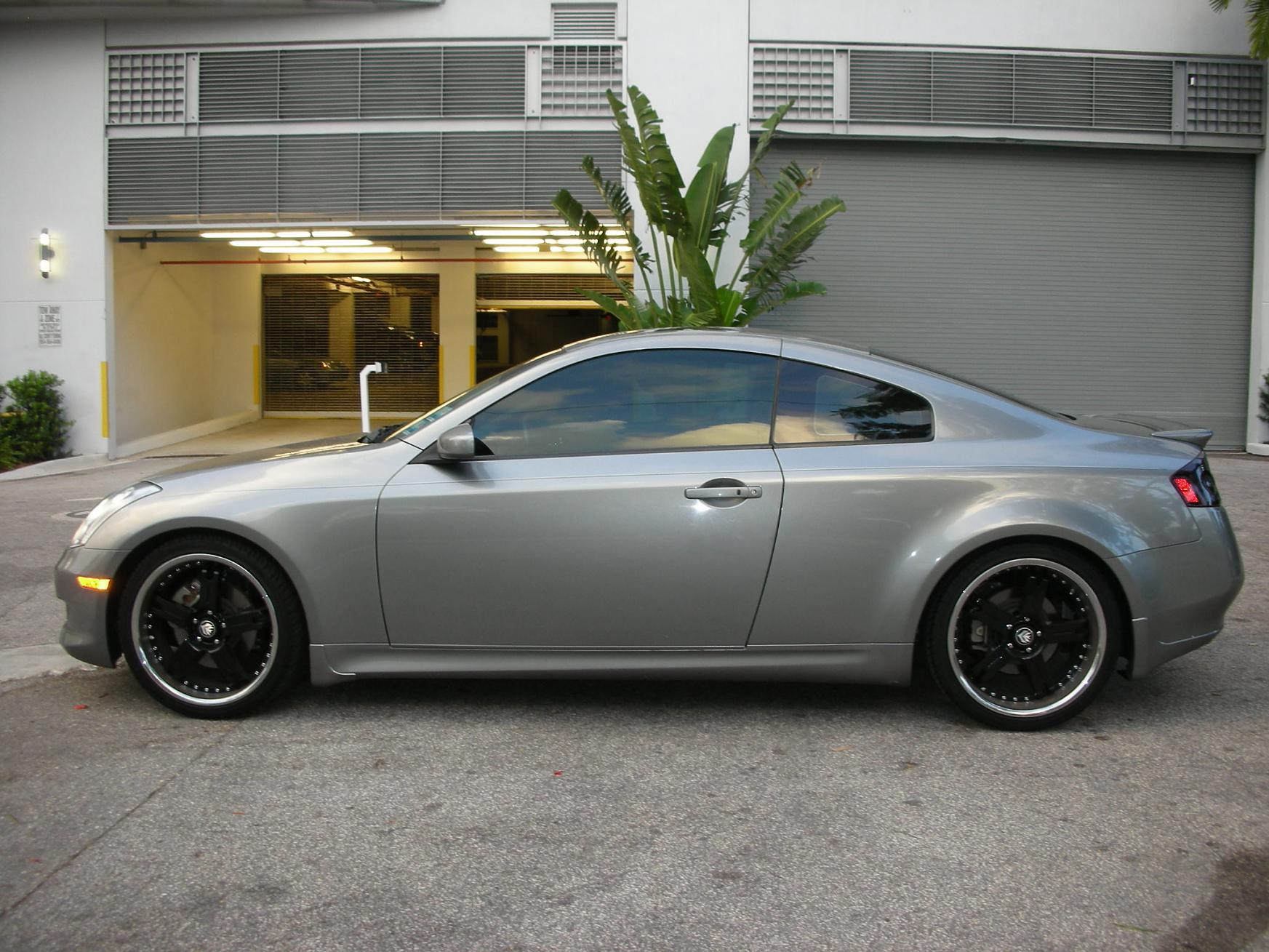

Exactly, Teofilo........and your 3-Series sport pack is why, as you've pointed out.
Now, still need to get 'er all cleaned up for some after-pics, but hopefully the before picture below comes out.
But if not, there's a gang of pics here: http://www.cardomain.com/ride/2618714
And as you may notice, with the 20s it's kinda sitting low.....but not quite where it needs be to run with the 3s. You know the score. Close, but no cigar.
Anyway, lets see what happens here:

Since you have the OEM '04 coupe suspension, you actually have springs that are at 314/342 f/r, so there won't be a dramatic difference to the 05+ 350Z springs, but there will be some difference due to the shorter springs (i.e. slightly lower Center Of Gravity). You can also achieve much of the desired effect with sway bars and stiffer shocks w/better rebound damping. I am running sways and Tokico D-Specs on my OEM '04 springs and the change in handling is pretty significant, without having to lower the car (my steep driveway is an issue for me).
Nah, Teo..........I don't have the Tokico HP Blues yet. But to answer your question, I don't think it matters - installing Tokico Blues - pertaining to alignment.
Maybe with the adjustable Tokico D-specs (same spec, but with adjustability), based on my research, but I could be wrong.
(TO ALL YOU TECHNICALLY SOUND CAR-GUYS: Am I correct? School me. I'm still learning.)
Anyway, T, I plan to get them, maybe in about 6 months. But I'm not really rushing because I know the spring rates have not increased in stiffness to where the upgraded shocks that come with the sport-tuned suspension package will wear out sooner.
(Again, based on my research. What say you, mechanical wizards?)
Only the front spring rates increased, but only by 10-15%..........11% if memory serves me correctly -- 314 to 358.
And I think the rear rates went down approx. 20-25% -427 down to 375.
