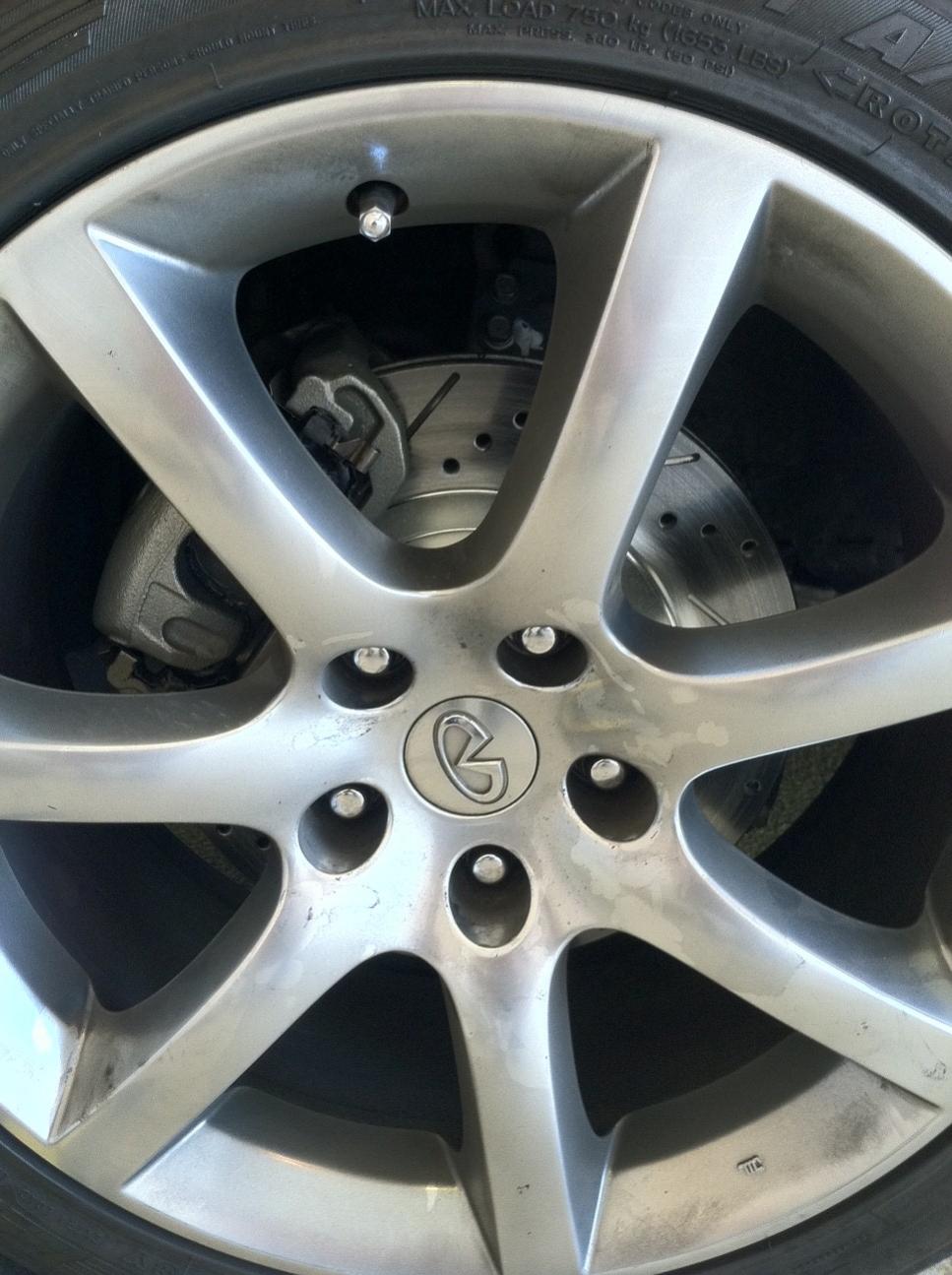

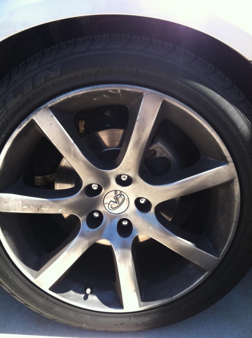

Old Apr 30, 2011 | 01:08 AM
  #26
SILVERAZG35's Avatar
Joined: Oct 2002
Posts: 369
Likes: 16
From: AZ
Originally Posted by Arkady
Have you gotten these installed yet? I'm thinking about ordering the exact same thing this weekend.
so far so good, here are some pics .... don't mind the dirty wheels though
Attached Thumbnails Rotor / Pad advice-new-rotor.jpg   Rotor / Pad advice-old-rotor.jpg
