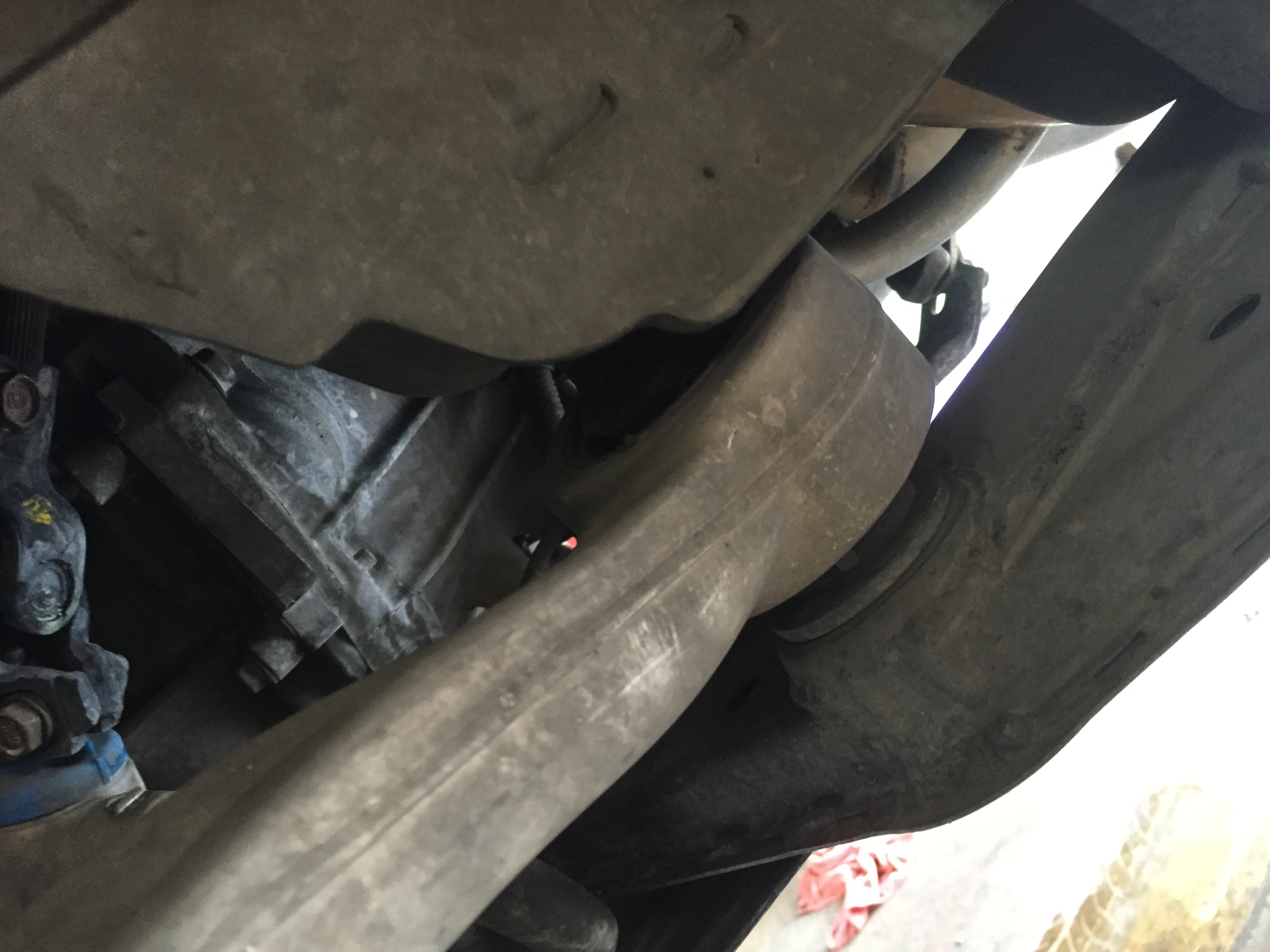

So Im having a problem. I honestly don't know what this bushing is out of, I think its the lower control arm bushing but not too sure. Well this bushing is bad and ordered some -whiteline lower control arm inner bushings - i ordered these because i was positive its the inner arm bushings. But now I'm having second thoughts as they come tomorrow. Please help.

That's the compression rod bushing whiteline part number: W83389

The bushings aren't the same ? If not, I'd have to exchange them. Sorry, don't know much about bushings lol.

No they aren't.
