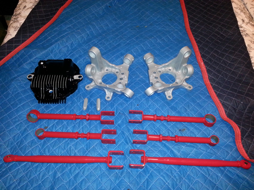

I'll just leave this here. Poly FTW!
yours?

Likes: 104
Yes it is.
Paint or powder?

Likes: 104
All powder / clear. Every suspension piece including spindles were done. Front ones are missing from the photo though
