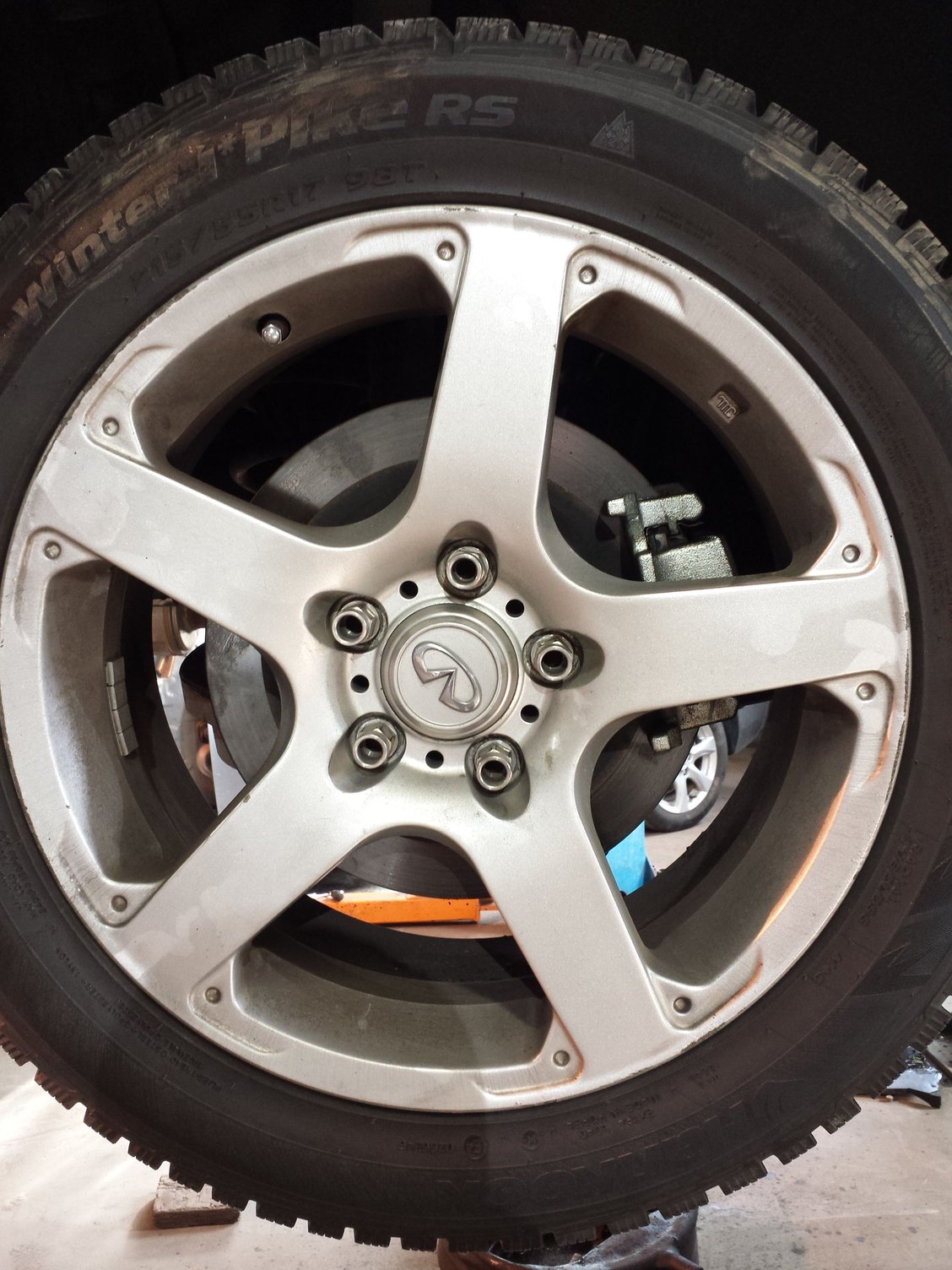

Hi all,
I upgraded brakes on my 370Z and had almost new rear disks/caliper/pads lying around. Since I still have my G and rear brakes were gone I reused the Z parts.
Perfect fit, bit more brake disk and pad area.
Not something you consider as performance upgrade to seek out as OEM parts are expensive, but if someone unloads Z parts for cheap then it can be useful for G owner on a budget.
Alex

Good to know thanks. Did you have to trim the rear dust shields?

My dust shields self trimmed ages ago Turned to rust dust

Was that for the front and rear ?

Rear only. I did not try fronts and cannot confirm.

Oo ok thanks, I'm trying to upgrade the front to the coupe brembo pack just wanted to know what exactly it is I needed. I heard you needed a bracket and such but don't know for certain
