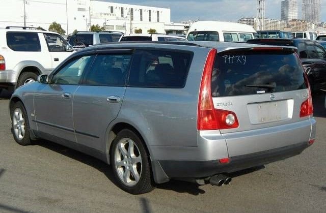

I have a 2002 Nissan Stagea that ran straight and true with no excess tire wear, until idiot mechanic bent something!! It was the Best Damn Hearse On The Lot! Which is equal to the 2004 G35XAWD in all suspension and underpinnings(Skyline AWD)
. Yes, these were the predecessor cars for the G35X all wheel drives released in the U.S. as 2004 AWDs. All suspension components are the same and same part numbers
. I had a guy bounce this car hard on a short hoist with the tires hanging(unsupported tires stretching stuff), and I picked up 1-dregree of positive camber(only on left front) with very very slight toe-in, but almost un-noticable on measuring toe. If anybody has heard of such a strange thing, or what part is the best guess to replace, let me know!!! No other alignment issues are noted, so it is and has been a bit frustrating, especially on the island I live on for now. Worn my tires off rotating them to the +1 camber positive front left. I cannot see any visual problem with left compression rod bushing, and given the nature of aluminum upper arm(more V-Shaped on AWDs) I see cracks near the forging built-up area around the upper left ball joint aluminum, but wherever aluminum is built up like that it can seem like a crack, but it can just be a part of the seem only. I am suspecting a stretch A-arm, since no play or bulges on the bushings. My second guess is the compression rod bushing (liquid filled, has no play??, has no sign of distress??). I could replace it out easy at home in the states, and drive away, but anything coming to here thru customs multiply 3X for each part, plus shipping gets taxed with it 3X. $125.00(part + freight) ends up being $375.00 = expensive A-Arm even if it is the correct guess!!!
Thanks for not tearing me a new one about posting this car on here, but from the underside it is a G35X with a 2.5 liter. Any help or guesses or similar odd jounce damage is sincerely appreciated.

I don't have the answer, but please! Moar pics of that bad boy. Dang, the rear looks like a Volvo ten years later!
Would like to see oblique view from front end to see those lines.

Stagea Pics
Old Dec 12, 2016 | 10:35 AM
kunf0002's Avatar
Joined: Dec 2016
Posts: 7
Stagea Pics
I bought it with 70,000kilometers on it(45,000 miles or less) for $850.00. Shipping from Japan to St. Kitts gave a total of $3,100.00. After taxes and Customs and license plates and a 1 year sticker = $8,600.00. That is why I love taxes so much, since they do so much for me.
