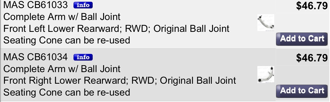

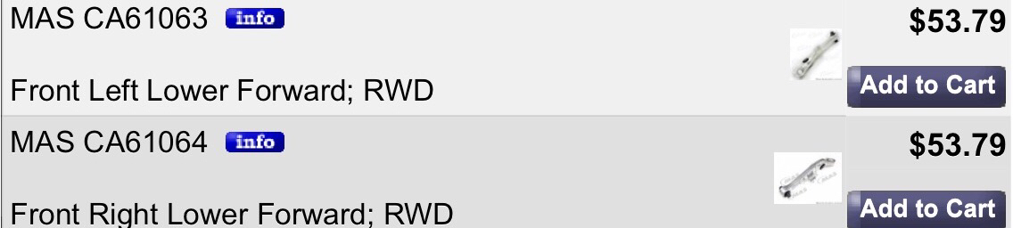

Btw now that I have your attention, this is my first time having to change comp rod and LCA bushings. Ino you've done it before so should i just replace the whole arms with cheap "MAS" brand ones I found on rock auto or should I get energy or whiteline replacement bushings?

Originally Posted by PLENUMCOUPE
No noise that I can hear over my blown bushings. They do the job and they're the best price on the market.
How long do you plan to keep the car?
Weak points are the comp rod bushings and LCA bushings.
If less than a year, and the ball joints are totally worn out, replace the arms with the MAS stuff.
If you are gonna keep it, test the LBJ in the LCA and if it's good definitely replace all the bushings with energy.
Energy makes a whole front kit, I found it for $30 less on eBay.
