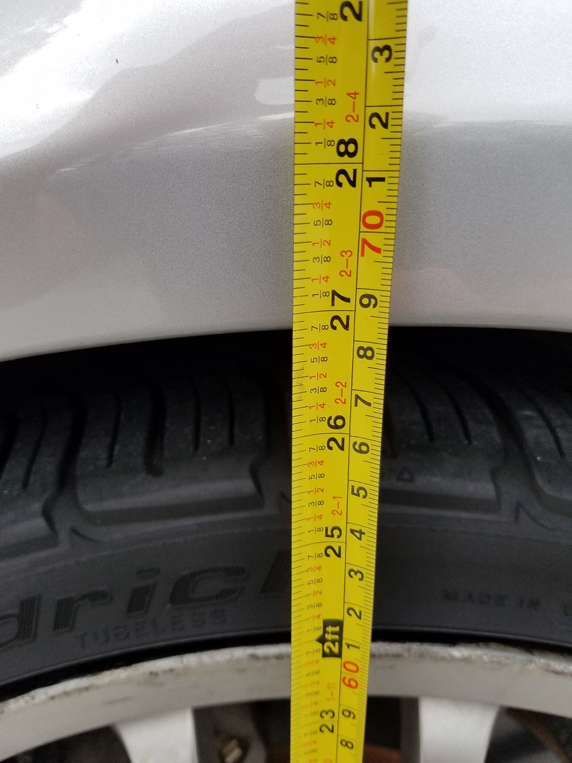

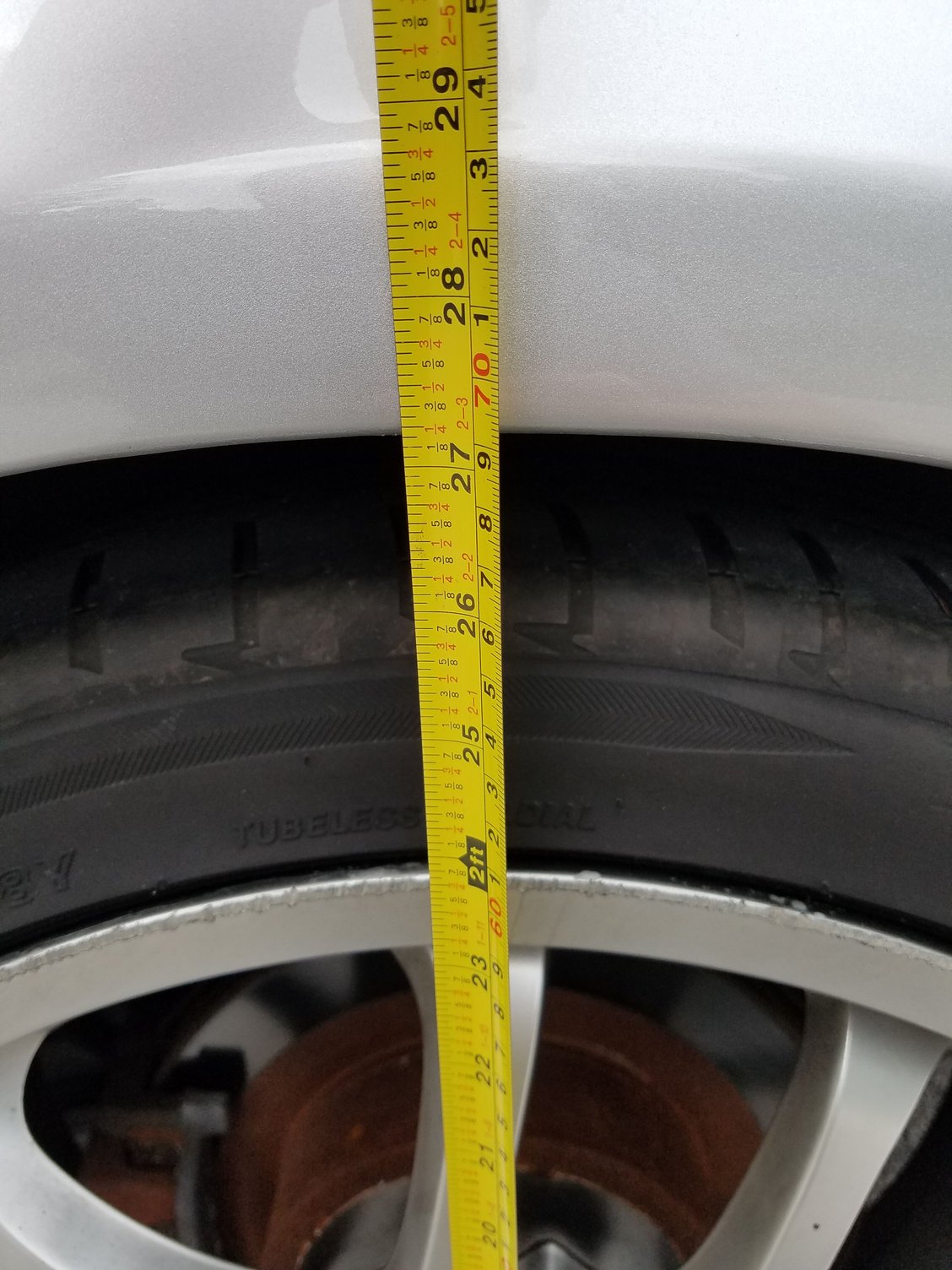

06 coupe/sport package with 19" wheels.
I was looking through the FSM to see how low the car sits at factory height. I've owned the car since 50,000 miles with factory struts and springs, I believe. The height is measured from the ground to the highest arch point on the fender. Factory specs are 27.52 in front and 27.95 rear. My front sits at 26 7/8. Rear sits at 27 3/16. I can fit three fingers in the front wheel gap and two in the rear gap(insert joke here). My last alignment they couldn't get the camber perfectly within spec, but not too bad.
Is anyone else with the same setup willing to measure their gap? Is it possible that the original struts have worn in so they sit lower than than new struts?
Rear
Front

Here's what I measured:
DF 26-3/4
PF 26-5/8
DR 27-1/2
PR 27-1/4
Tires have about 9K easy miles, so not much wear there. Gas tank is not completely full. I'm out of window washer fluid. It's parked on the street, driver's door to curb, so there's a little road crown action in those numbers. Not sure why the passenger side is lower, but there you have it for what it's worth.

Thanks for verifying. Your numbers are close enough to make me comfortable about my suspension. I'd just hate to switch out my struts when it comes time and have the car sit higher. I love the way it sits right now.
Old Aug 27, 2017 | 11:09 PM
gary c's Avatar
Posts: 19,433
Likes: 1,133
From: Valencia, Ca
No, your '06 isn't lowered! From experience if you can go thru a car wash, get your oil changed anywhere, that's another indication you're at stock height. New struts/shocks won't change the ride height, not after a few miles...Gary
