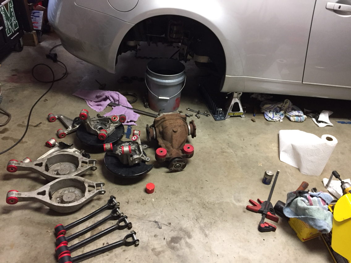

Likely compression rod bushings are toast, which requires removal of the front brace to get to. You likely have a repair that would total out your car. Cost me about $800 in parts and labor (pressing bushings replacing rear wheel bearings and diff stuff)! I had the time and space to do this myself, a lot of people don’t.
Attached Thumbnails Suspension clunking front end.. please help...-photo616.jpg
