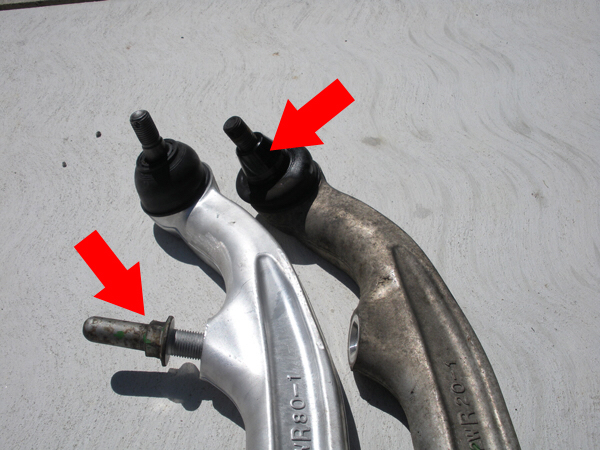

They forgot the “funnel†portion from the original compression rod. I made the same mistake when I put mine in and the car’s wheel shifted forward 2†when it went on the ground lol.
You need this ... on the RIGHT red arrow ...
https://g35driver.com/forums/brakes-...placement.html
I don't know how a suspension shop could possibly forget the cone washer tbh? Maybe if it was the tech's first time ever doing a ball joint? Either way it wouldn't explain the "crown nut" being pulled through the steering knuckle because it was too small.
