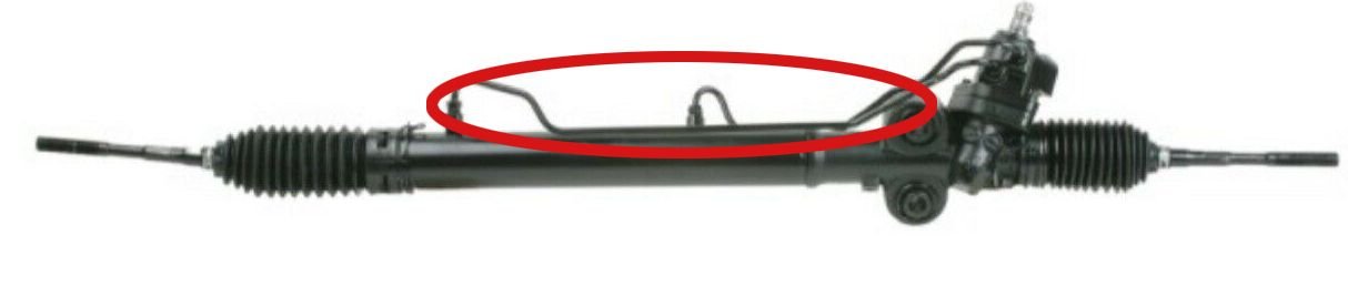

When I was taking out my engine I managed to crush my two power steering hard lines that run right along the rack.
I'm getting ready to put the engine back in but I need to replace these damaged lines.
Does anyone know the part number for these 2 lines? I keep getting the lines that attach to the power steering pump when I search for them.
Although my rack has seen better days and actually could use an entire replacement...
Comments / Suggestions?

Did you break the lines off or did you just flatten them a little, can't tell from your photo.
If they're just bent or slightly flattened but not actually FLAT FLAT flattened I would just leave it be and see if they leak. Those flared compression fitting are pretty stout.
If they leak then replace the rack, simple enough job, engine in or engine out doesn't really matter TBH.
