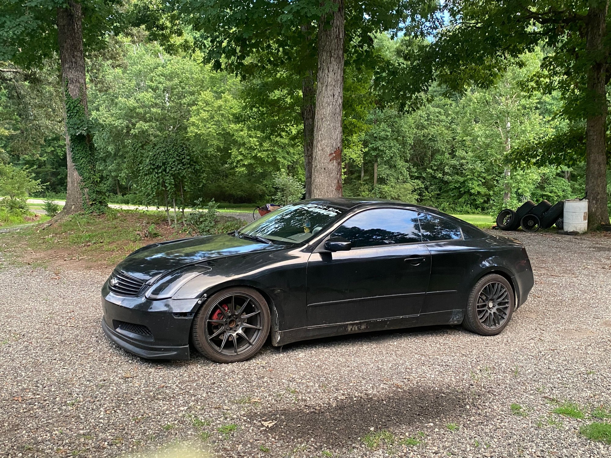

my car is lowered a lot if that makes a difference.

here’s a pic of my babes
