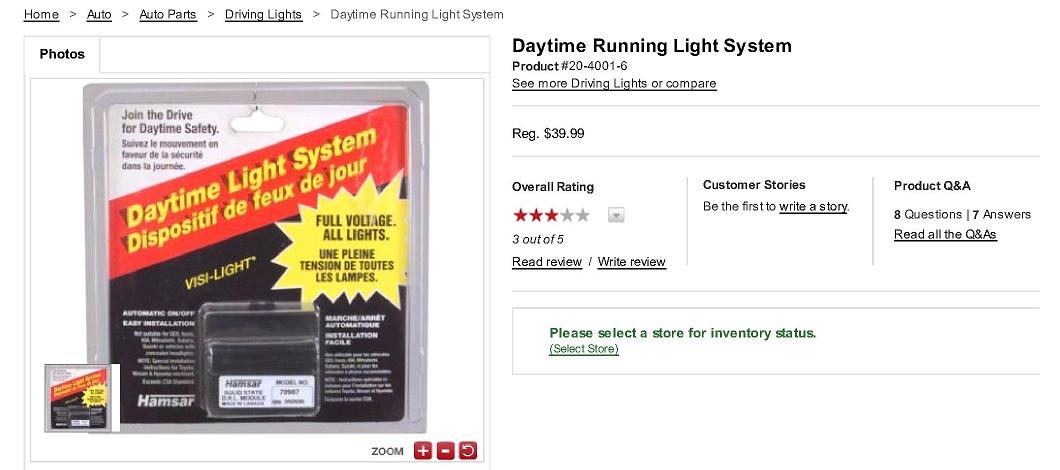

I have a 2003 G35 Coupe that was imported from the US. The guy I bought the car from says he went to Crappy Tire to have them install the daytime running lights module. I can only assume that the module they install is the one in the pic that I've attached to this posting shown on their website.
I now have the option of buying a set of 06 projector headlamps (post recall) from a Canadian coupe. Will I have an issue with the DRL module being installed OR will I be able to just 'plug and play' these new headlamps despite the fact that the module is installed?

For what it's worth, the DRL module is needed to pass your federal inspection when the car is first imported. I have an american vehicle as well and I installed mine myself (as per my hamsar DRL how to I made).
I have since disconnected the unit and plan to pull the thing out next time I have my bumper off. You can keep it or loose it but either way your lights should work fine.

I called Canadian Tire and the mechanic there tells me that the module they install simply sends power to the headlight assembly as soon as the car is started. He claims that there should be no impact to the headlight assembly if it is switched. Now, the question is whether I believe what he says
