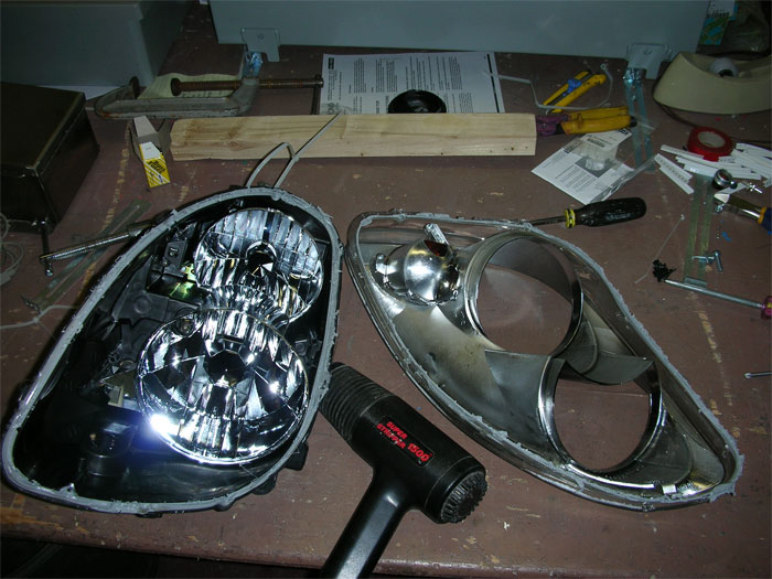

Played with the test unit today.
It was a bit of a struggle the first time.
It'll def be easier with the next ones

Well, I had a chance to play with changing the lens to clear.
It's a little tricky to do & takes time.
Also easy to screw up if not careful.
It will be up to you guys, if you want to attempt this.
I will have some tools & lens material if you're brave enough.
pic1 orange dremeled out
(orange part is actually all one piece, just part is chrome painted)
pic2 - clear lens rough cut for fitting
pic3 - clear assembled

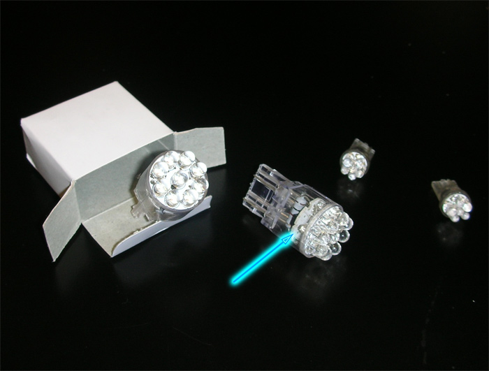

Talking New LEDs
Just got my replacement LEDs for the cleared turn signal & side markers.
These are high quality products & much cheaper than Stealth bulbs...
They should hide nicely behind the clear lens.
Side markers $6.50 US
Signal $15.00
Got them from Velocity LEDs
They are clear but flash amber.
The arrow shows a second row of LEDs aimed sidways..... this to fill out the beam.
