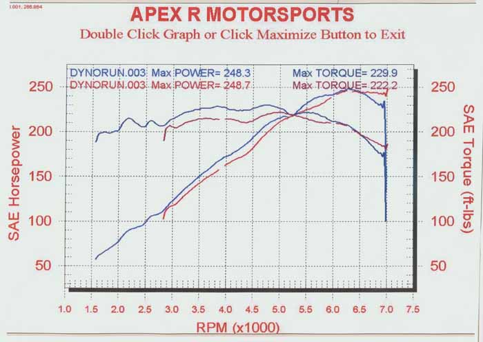

I have a 2003 "G" 6MT Coupe.
Mods:
TechnoSquare Crawford Reflash ECU
JWT PopCharger with "Z" Tube
Crawford V4 Plenum
Crawford HiFlow Cats
Crawford Headers
Invidia G200 Dual Exhaust with "H" Pipe
Ground Wires
My Dyno is the blue line. The red line is the aformentioned '05 6MT coupe with the motordyne spacer. Warm summer night in Tuscon. DynoJet Dyno. Before the spacer the '05 dynoed @ 242hp. I have no before readings of my Coupe because my mods were incremental.
Lou
Mods:
Crawford V4 Plenum
Crawford Headers
Ground Wires
Lou
Lou do you have a comparison with an '03 or '04?
The comparo with the "revup" engine is invalid.
The '05MT has a redesigned intake & internals.
The Crawford would loose "gains" on this engine as well.
