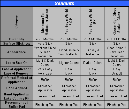

Hey, Nice site... I just visited for the 1st time... I am an avid Klass AIO and SG user... Does FMJ really give similar results and easier to remove than SG?
I was looking at this chart:
Thanks!

Triji - thanks for the kind words. Klasse combo works excellent for durability and a very nice reflective look. I personally think you get the most out of the SG after applying at least 2 coats of it and the effort needed to remove SG is not worth it IMO. I personally use the FMJ sealant due to its extreme ease of use, slick surface and nice look to it. I reapply FMJ on my vehicles once a season and think it is more deserving of a 3 - 6 month range. On a daily driver I'd go by the lower numbers on our charts for durability. It's the garage queens that come out for 1k miles a year and never see any element of weather that can achieve the higher ranges for the sealants.
If you enjoy the AIO you could keep that as your base and layer the FMJ on top, just as you would the SG. FMJ doesn't build upon itself as well as SG does, so if you do a second coat, it is more for even coverage not so much extended durability.
I think you'd be pretty pleased with the results of FMJ coming from SG, especially on the amount of effort needed to remove the SG.
Hope this helps clarify some things for you, please let me know if you have any other questions or need any help picking anything out.
