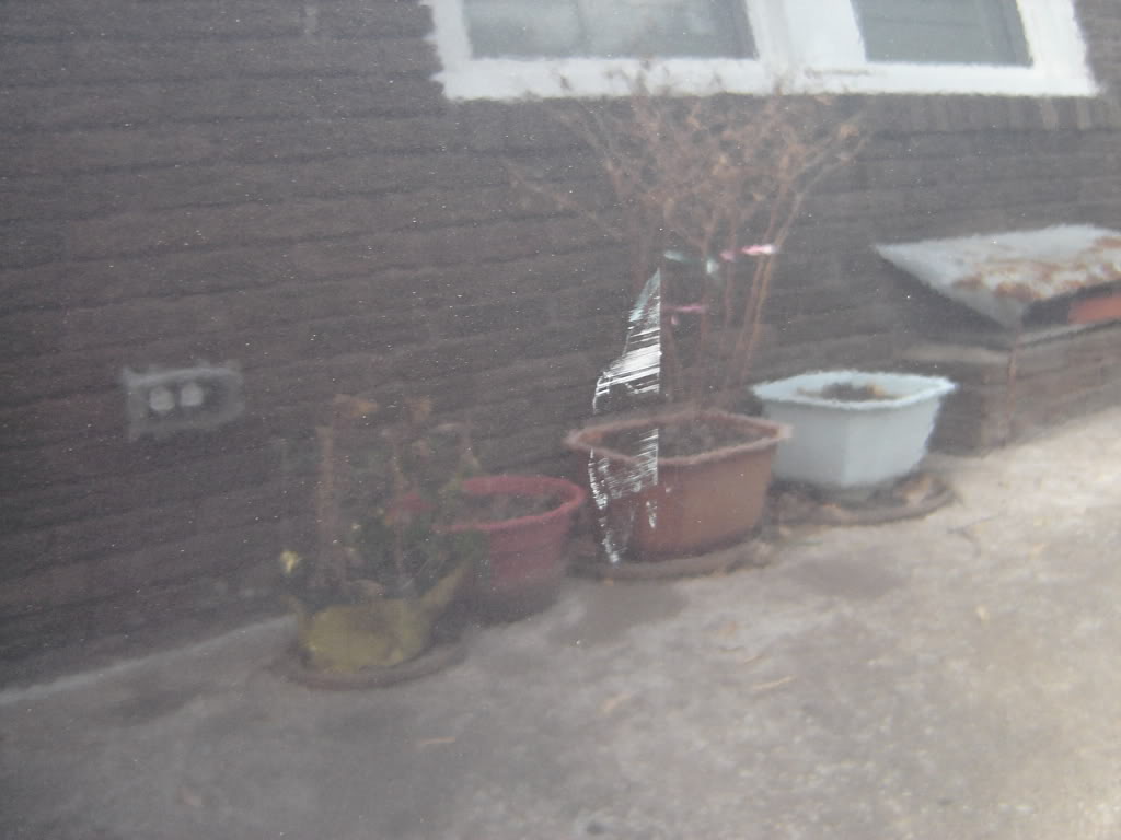

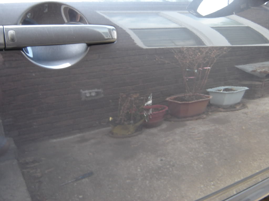

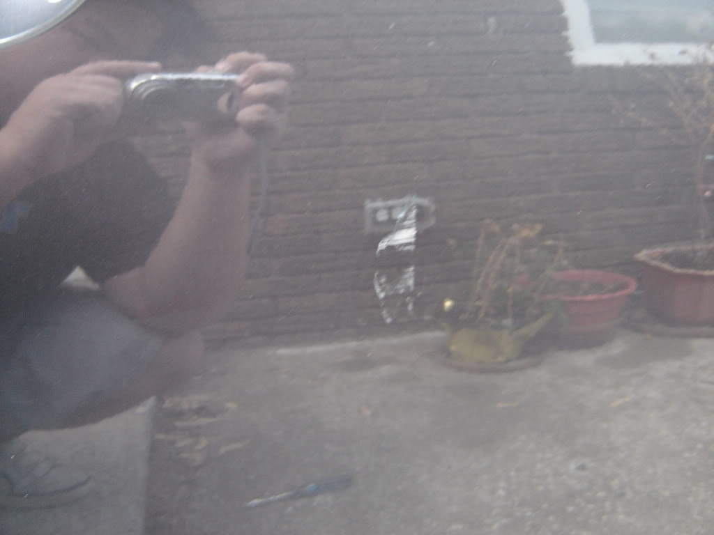

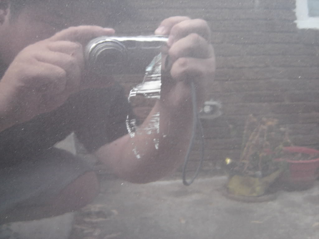

Here are some pics of the scratch. I went out today and purchased some touch-up paint from Infiniti and I haven't used it yet. Just wondering what everyone thinks about the touch-up paint pens.
How do I apply the paint?

Old Apr 24, 2009 | 04:26 PM
Nikku-'s Avatar
Posts: 187
From: Toronto
From what I see. It seems like at the very least there is some paint transfer. You can try buffing the paint that transfered by hand using a microfiber or a polishing pad.
In terms of your paint appilation, I never use paint touch up pens. I usually get aerosol cans for larger jobs or small paint cans from Napa or local body shops. Get them to match the paint.
Actually you know what? Picus has a great tutorial on touching up inclusive on wetsanding etc. etc. He provides step by step info.

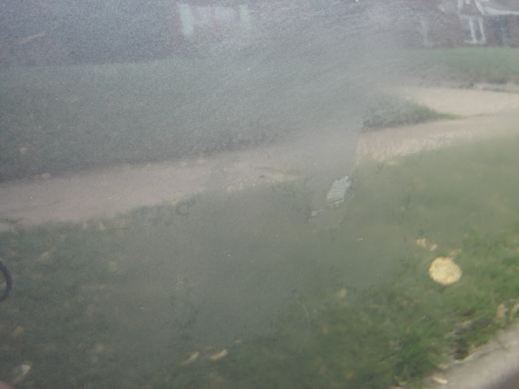

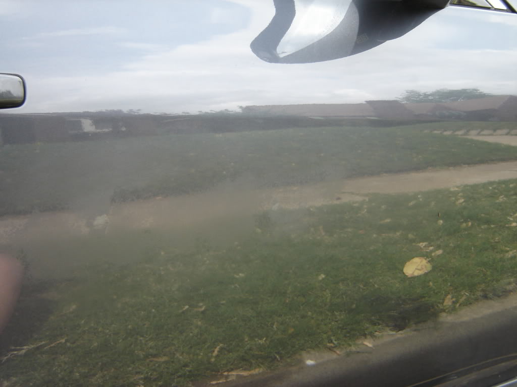

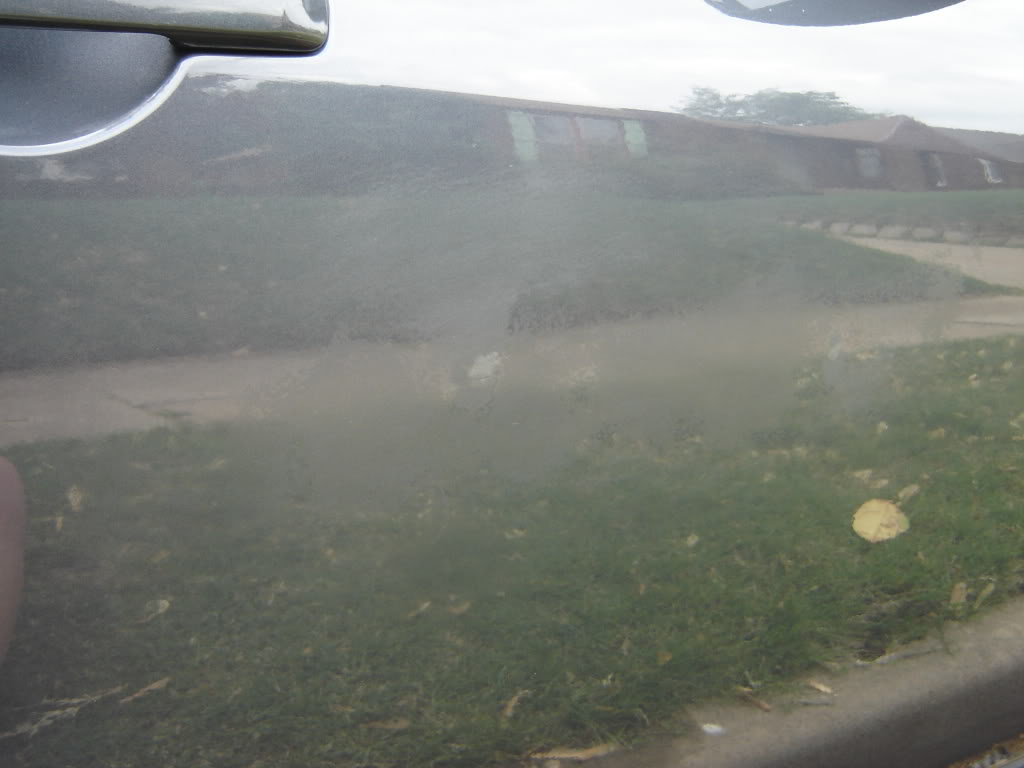

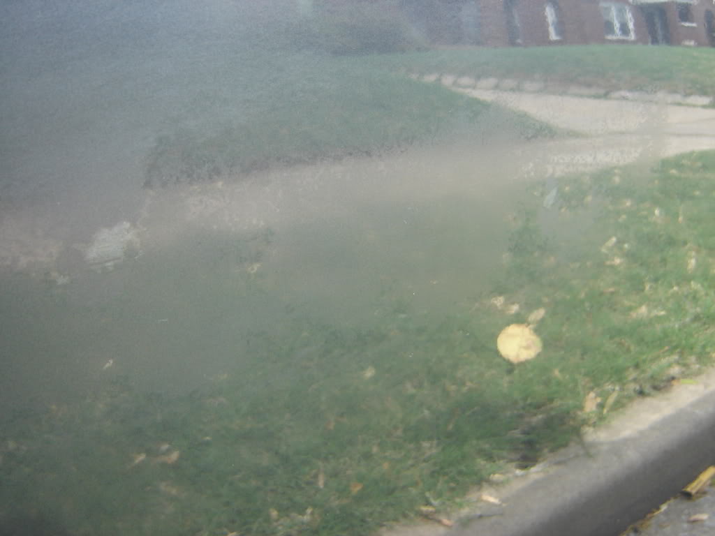

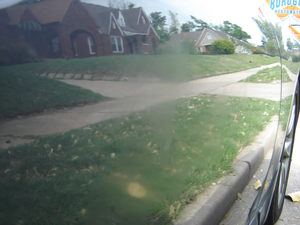

So this is where I am at right now. I'm really worried i might have done something that damaged the clear coat.
As you know I sprayed on some of the dupli color clear coat over the scratch and it had a build up on it, which wasn't smooth. I did the Picus wetsanding thing and this is where I am at right now. It still has a weird haze and it's not glassy reflect. It's kinda dull.
Here are some pics.

I did not make a template for the spray on clearcoat. I just used the aerosol can and dusted the area.
Old Apr 26, 2009 | 04:22 PM
Nikku-'s Avatar
Posts: 187
From: Toronto
Sorry deleted my message. I mistyped what I was trying to ask. In any case, as per the DIY instructions templates are neccesary when using an aerosol can. Just for future reference. It's very hard to control the spray action from an aerosol.
Did you sand the area that you sprayed with clear coat? It looks like you took sandpaper to a large chunk of the panel far beyond the "scratch" area.
Old Apr 26, 2009 | 04:24 PM
cloroxbleach4's Avatar
Joined: Feb 2009
Posts: 40
From: Tulsa, OK
I did sand the area that I sprayed with the clear coat, which was more than the scratch.
Old Apr 26, 2009 | 04:25 PM
Nikku-'s Avatar
Posts: 187
From: Toronto
Ok so just describe your process to me. Did you use 2000 grit then 4000 grit sand paper?
