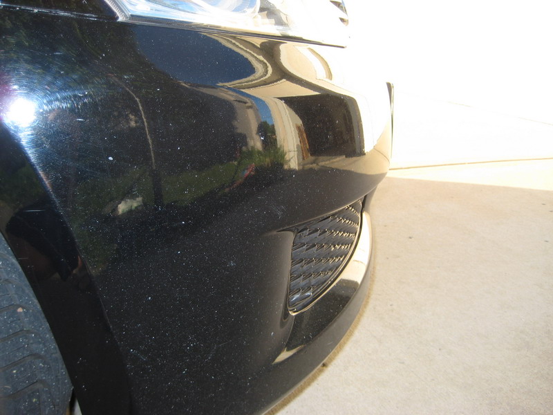

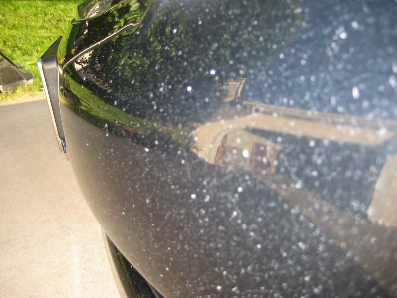

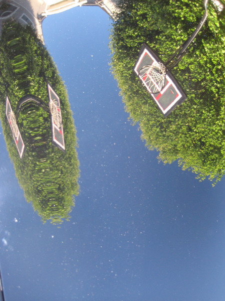

Will i need to completely repaint this to make it look good?
Old May 4, 2010 | 09:47 PM
iLoveMyG35x's Avatar
Posts: 41
I drive about 75 miles round trip everyday between work at home.. missouri roads are pretty terrible and there seems to always be stupid trucks dropping all sorts of crap onto the road..
That being said.. my hood/bumper are pretty torn up.. its not obvious from some distance but up close, its terrible looking....
what would be the best/most cost effective way to fix this up?
i also have all sorts of tiny chips in my windshield but i dont think there's a single thing i can do about that other than replace whole thing..
thanks for your time and advice!
Attached Thumbnails Will i need to completely repaint this to make it look good?-img_5654_resize.jpg   Will i need to completely repaint this to make it look good?-img_5656_resize.jpg   Will i need to completely repaint this to make it look good?-img_5657_resize.jpg

If they are stone chips, you'll need to re-paint it to make it looks perfect. If you want to make it better, you can polish it but you wont get rid of the chips.

Paint on the bumper looks toast.. I say repaint it then clear bra it. But you should wait for the paint to properly cure.
Hood can probably be clayed, polished, sealer, then waxed. maybe even apply a clear bra on the font edge of the hood for the future.

A paint job for a bumper is usually around 350. If you're worried about mismatching, shops can blend it into your fenders/hood for you for a little extra.
As far as clear bra's go, it'll protect your bumper/hood from rock chips. (Not collisions lol). So it would be perfect for your situation.
If you do clear bra after a paint job, you have to wait 30-90 days to let the paint cure and harden.

Polish and a Glaze/Wax can help the hood chips look a lot better, The front bumper is toast.

Ha, funny my front bumper looks exactly the same (hidden better on lighter silver). It is a Missouri car as well. No more though, it has now been converted to an AZ car. I was thinking of a light wet sanding to smooth the real fine roughness out, but chips there is nothing you can do without a repaint. If the sanding doesn't help, repaint here I come.
