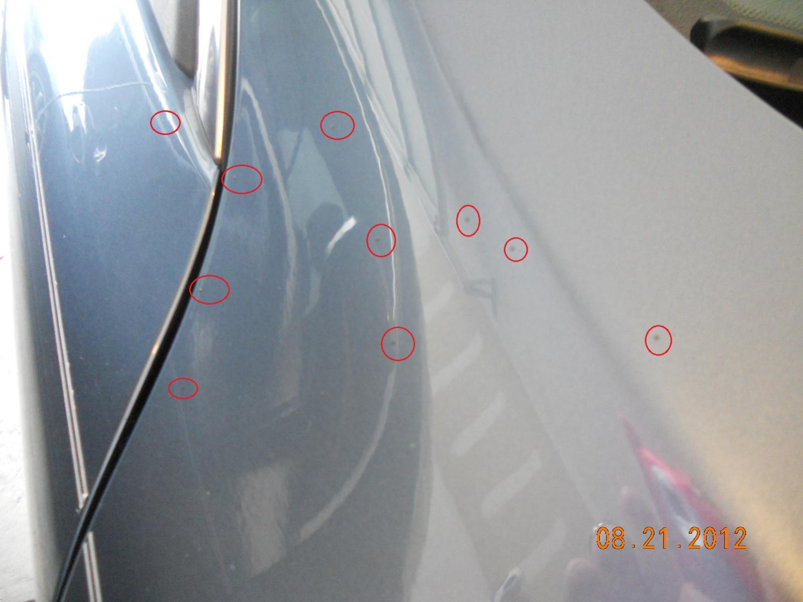

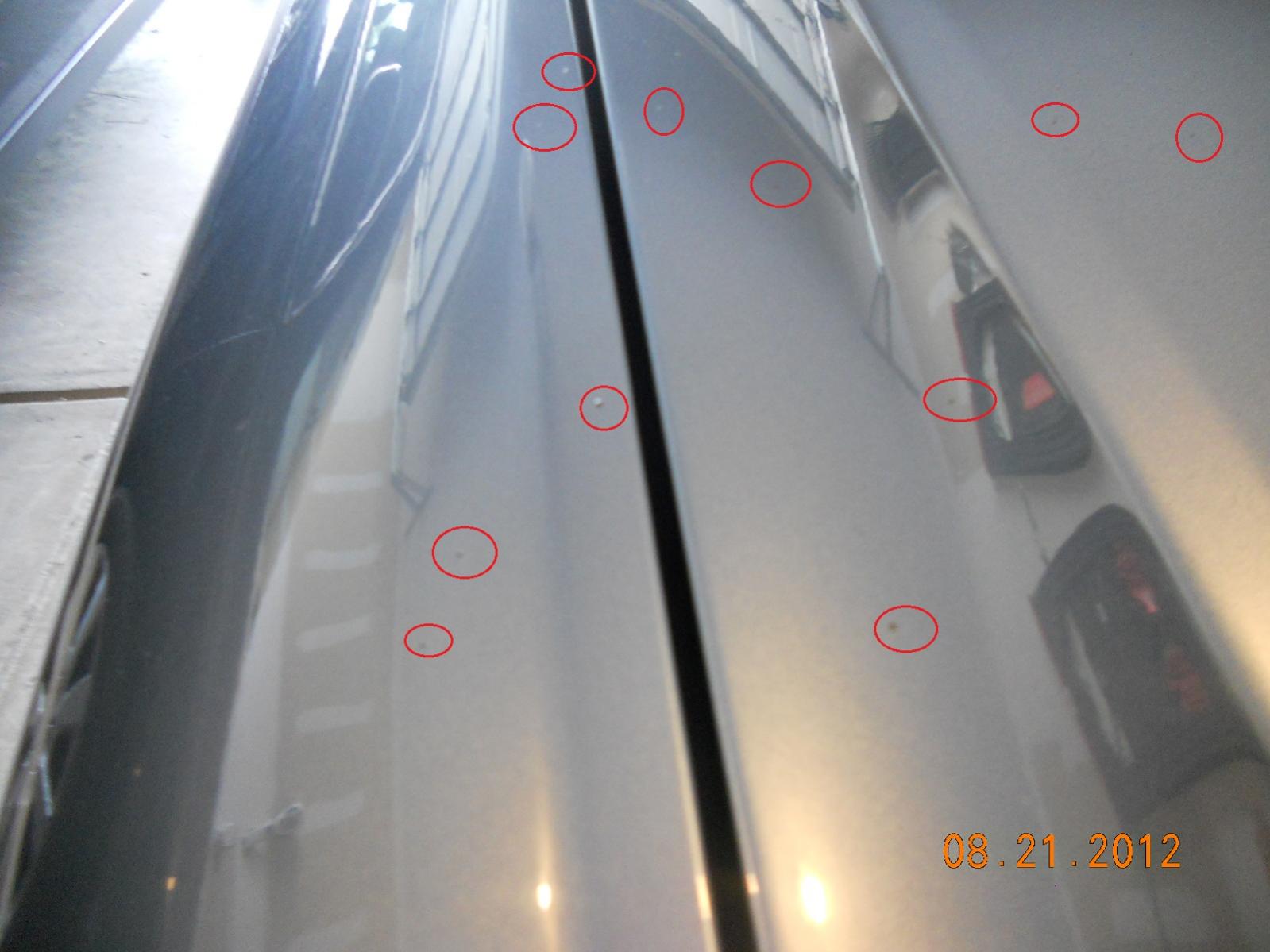

I probably see tar on 80% of the cars I detail to varying degrees of severity. It's pretty common. Pretty much invisible on black paint but I just spray tar remover on the areas where it typically sprays right behind the wheels on the lower panels. As far as being on the hood and pillars, that's not common at all, and should really only be from a freshly paved road if she was driving too close behind another vehicle.
Although it's probably tar, one other thing it could be is artillery spores. It's a fungus that shoots out a black tar like substance. It grows in mulch and shoots at bright surfaces, such as cars. They are black and form neatly into half a sphere. You can pick the head off of these with your fingernail or a plastic razor blade, then use tar remover and microfiber towel to lightly remove the small remaining amount.

Now with Pics !!
Here's a few pics of the tar spots. I could easily count 100 on the right half of the car. I washed it about a month ago and got them all off. It also sat at the dealership for 2 weeks while the valve cover was replaced. So this is about 2 or 3 weeks of driving, maybe 400-500 miles total.
Attached Thumbnails Tar Babies on Paint-hood-fender-top.jpg   Tar Babies on Paint-base-pillar.jpg
