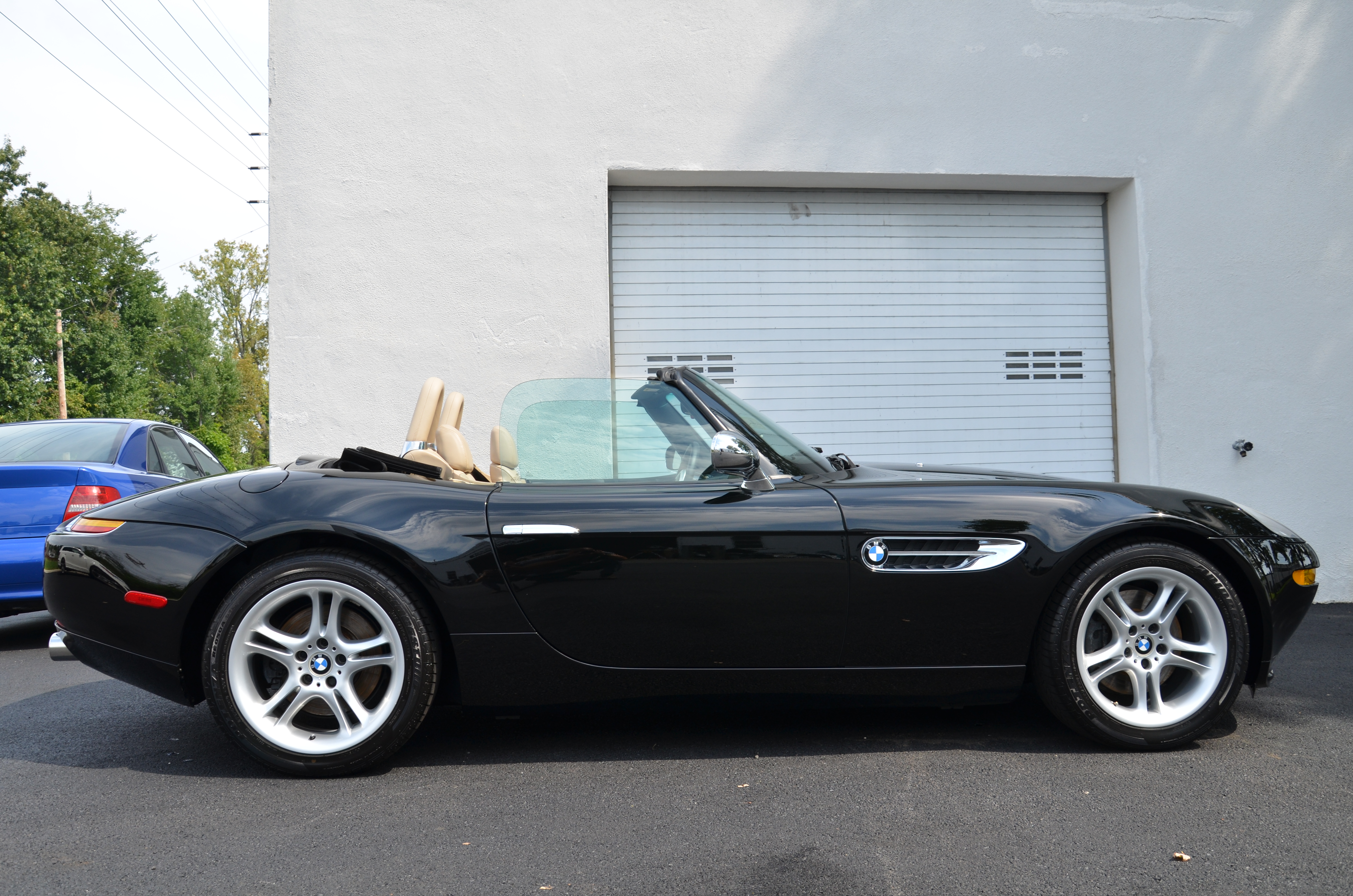

Detailer's Domain: BMW Z8 - Full Correction/Engine/Interior
Old Sep 17, 2012 | 06:40 PM
DetailersDomain's Avatar
Joined: Jul 2010
Posts: 464
Subject: BMW Z8

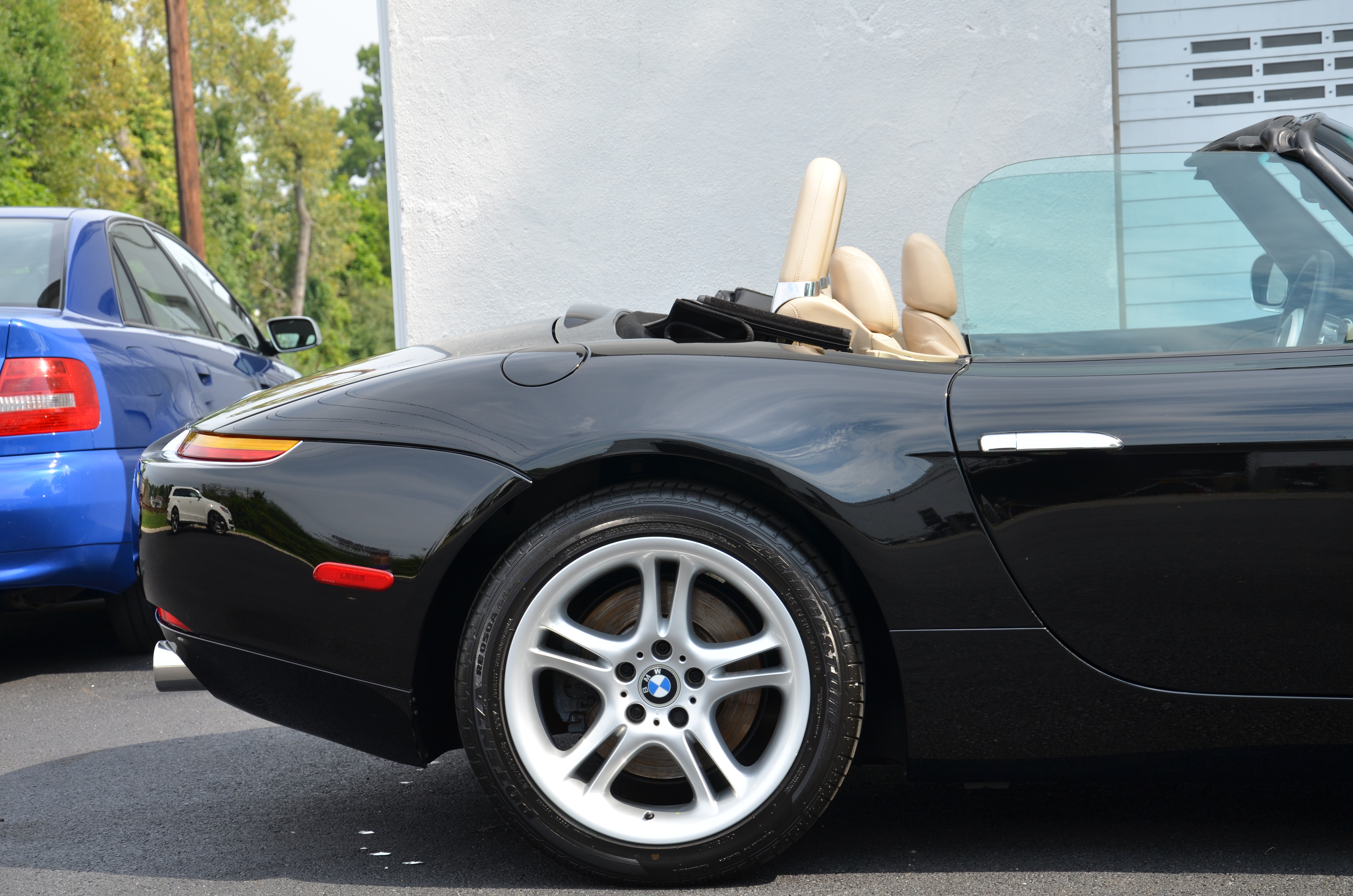

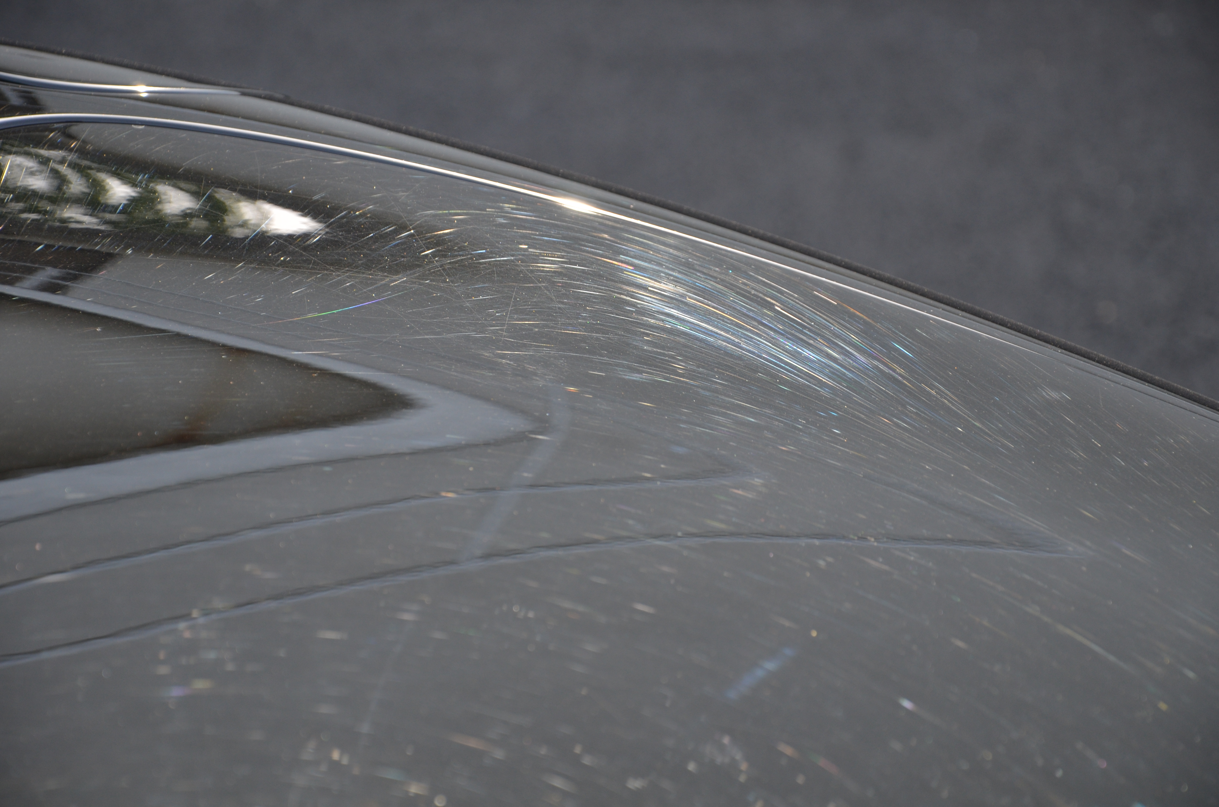

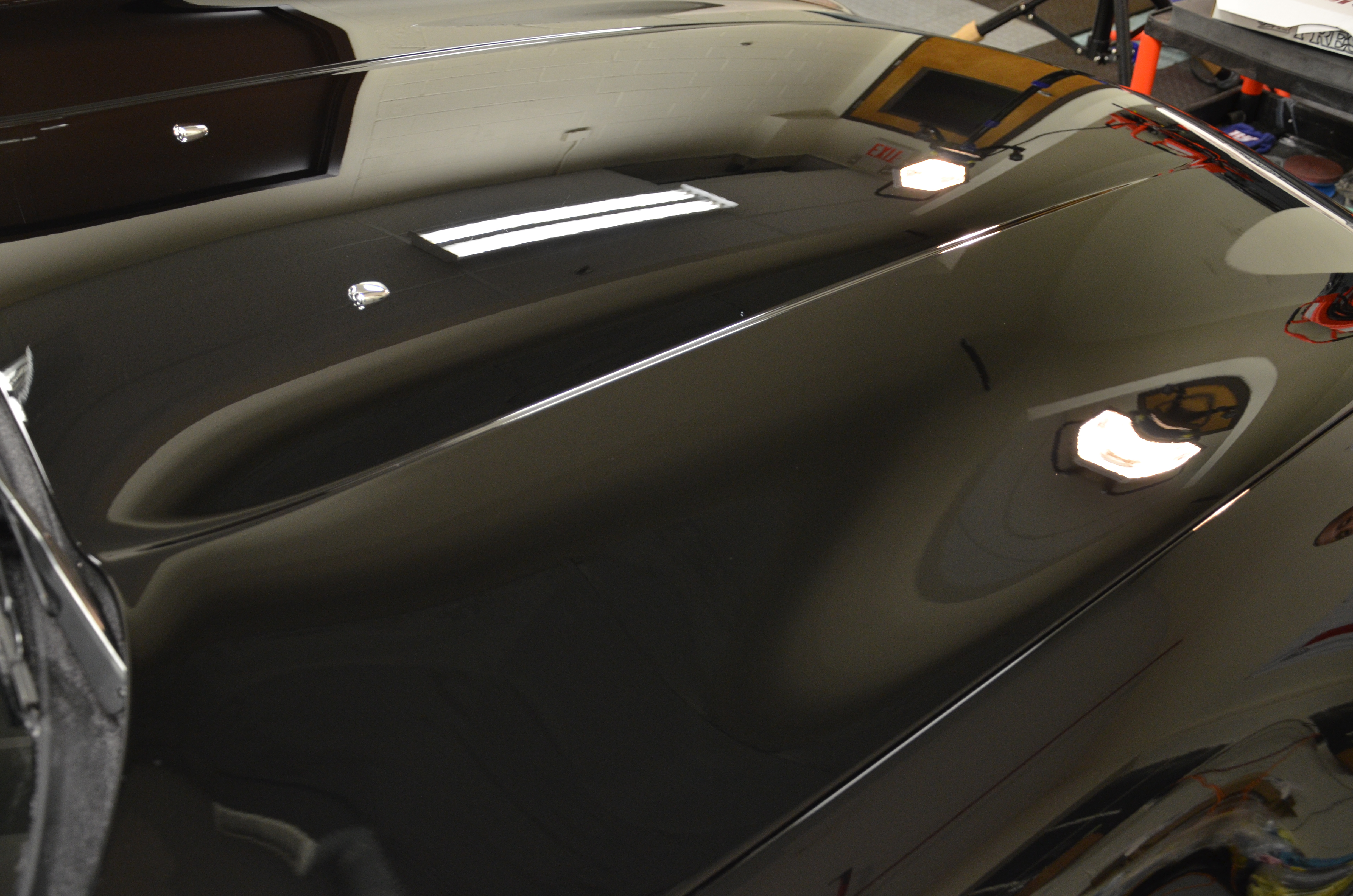

Requirements: Remove swirls and imperfections from over the years.
This was a car that was in great shape, not much needed on the inside at all. This Z8 had tons of gloss. However upon closer inspection we found the paint imperfections. Take a look at how we fixed them.

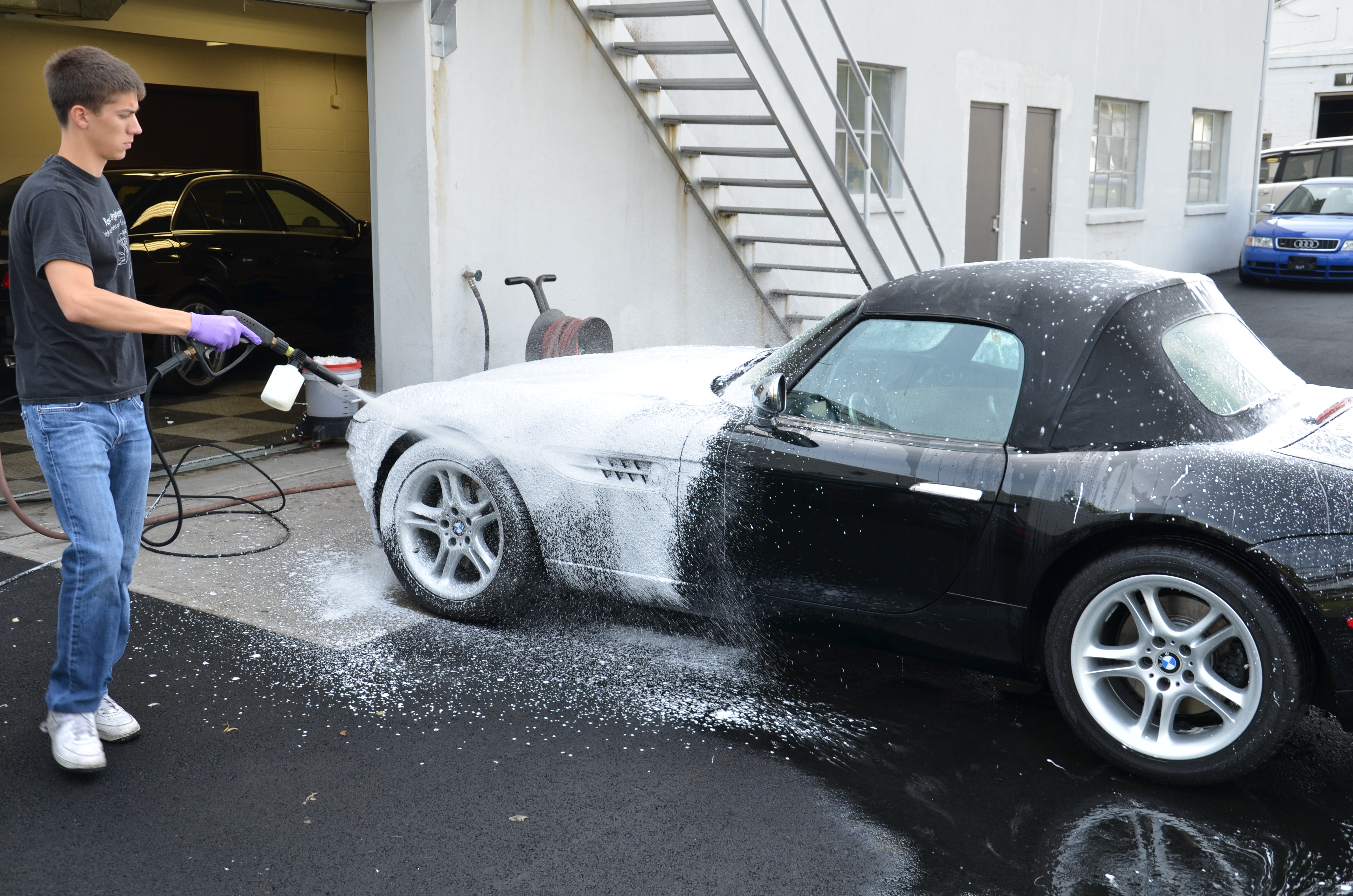

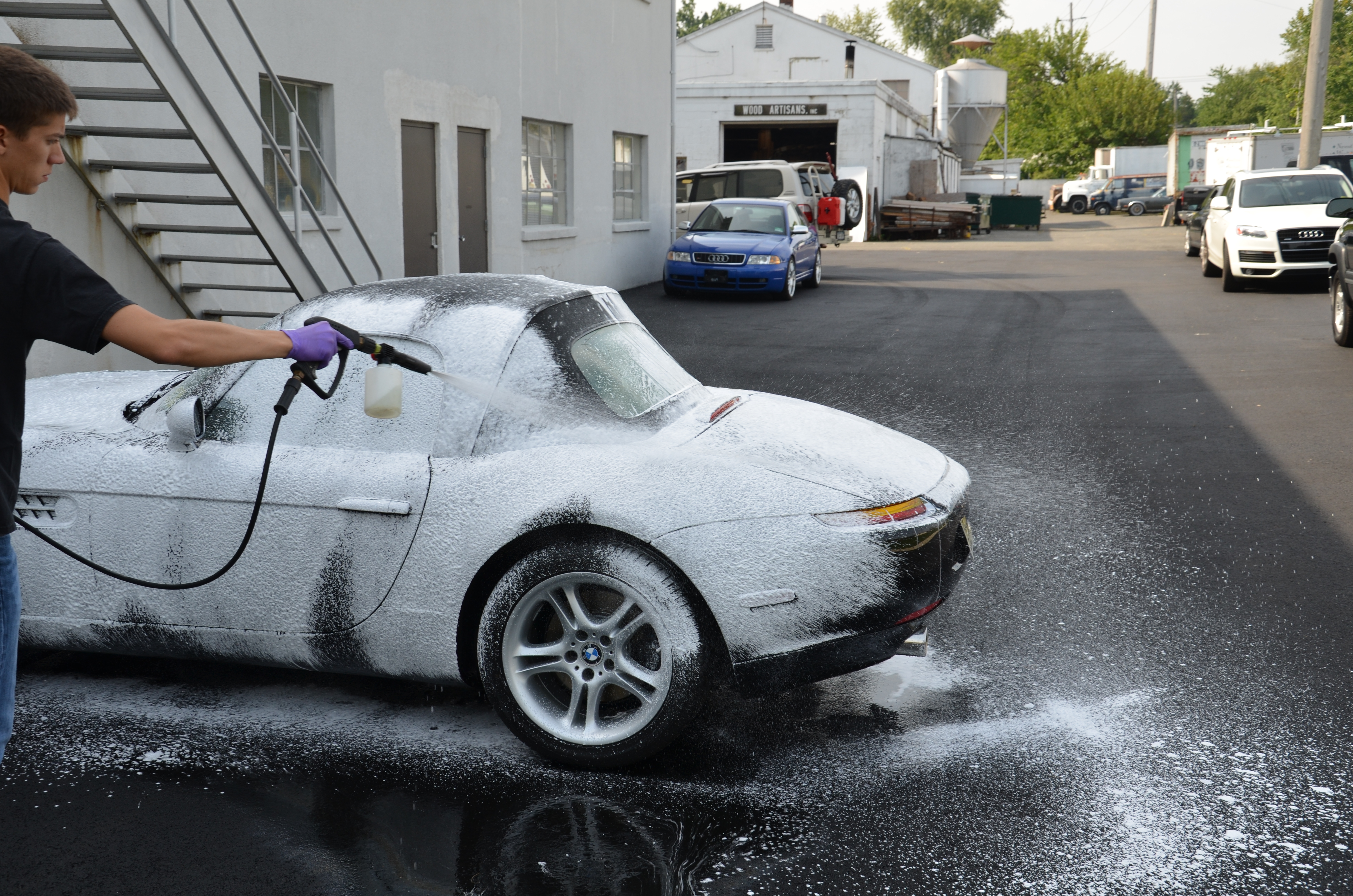

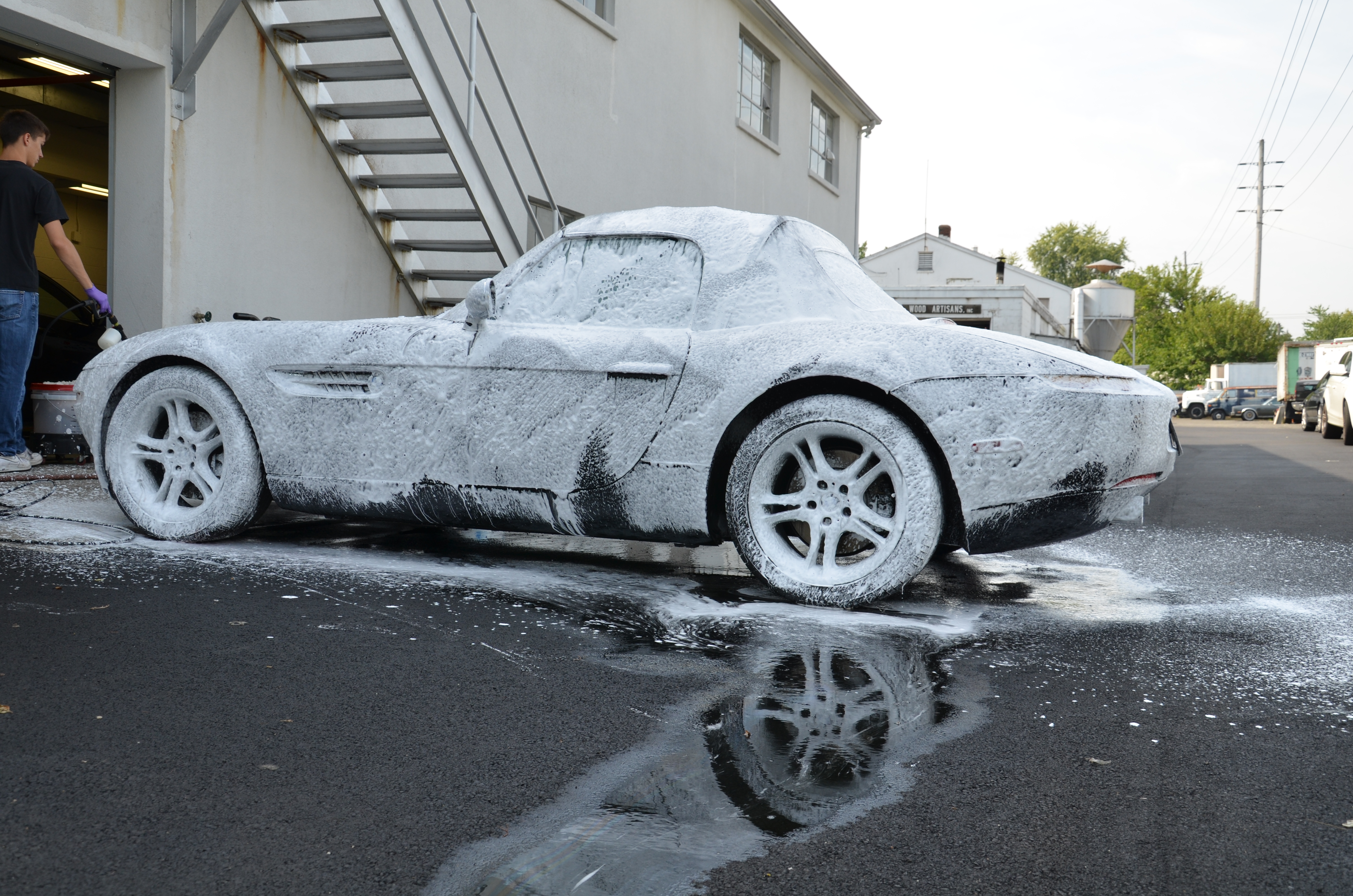

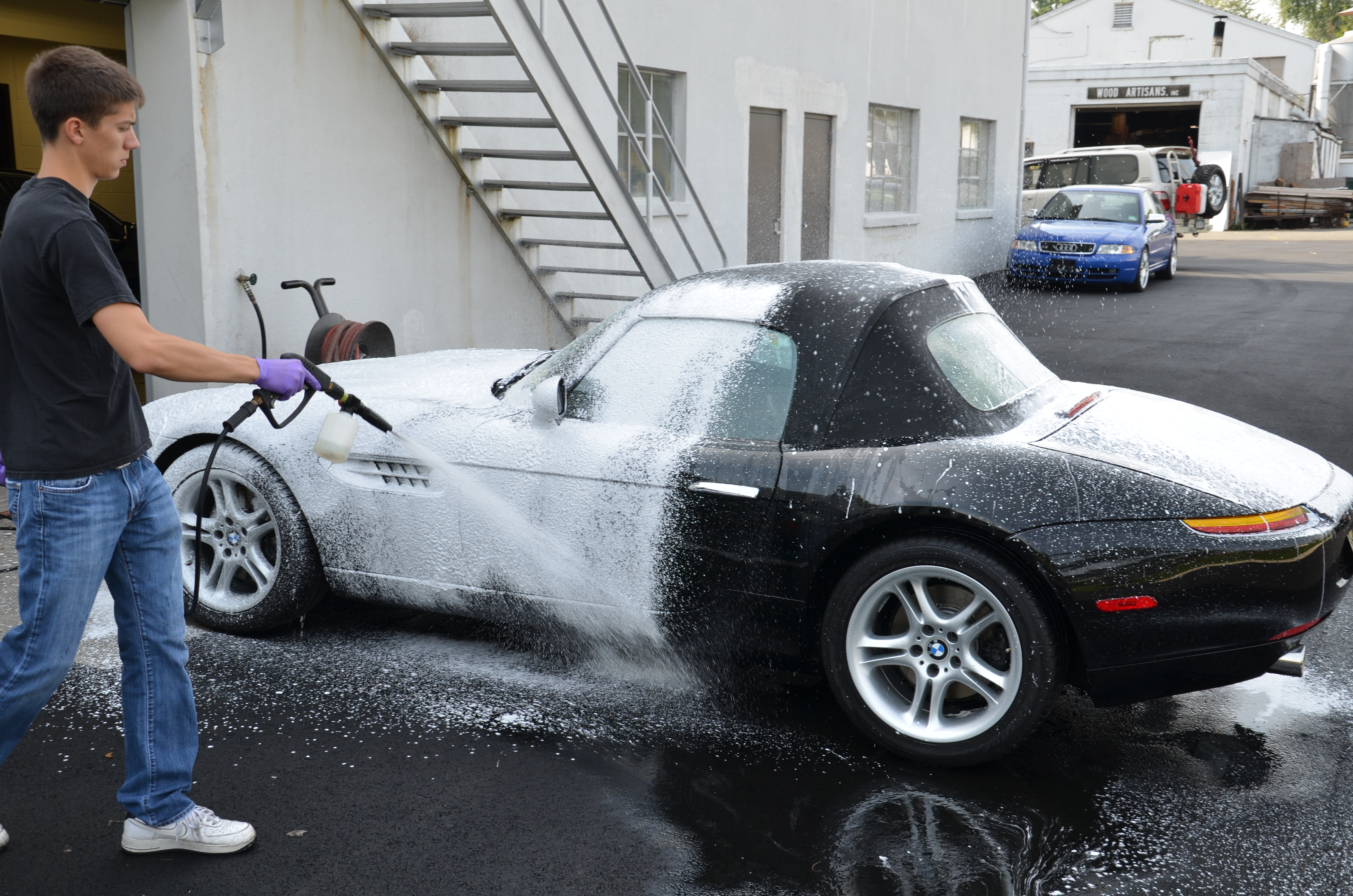

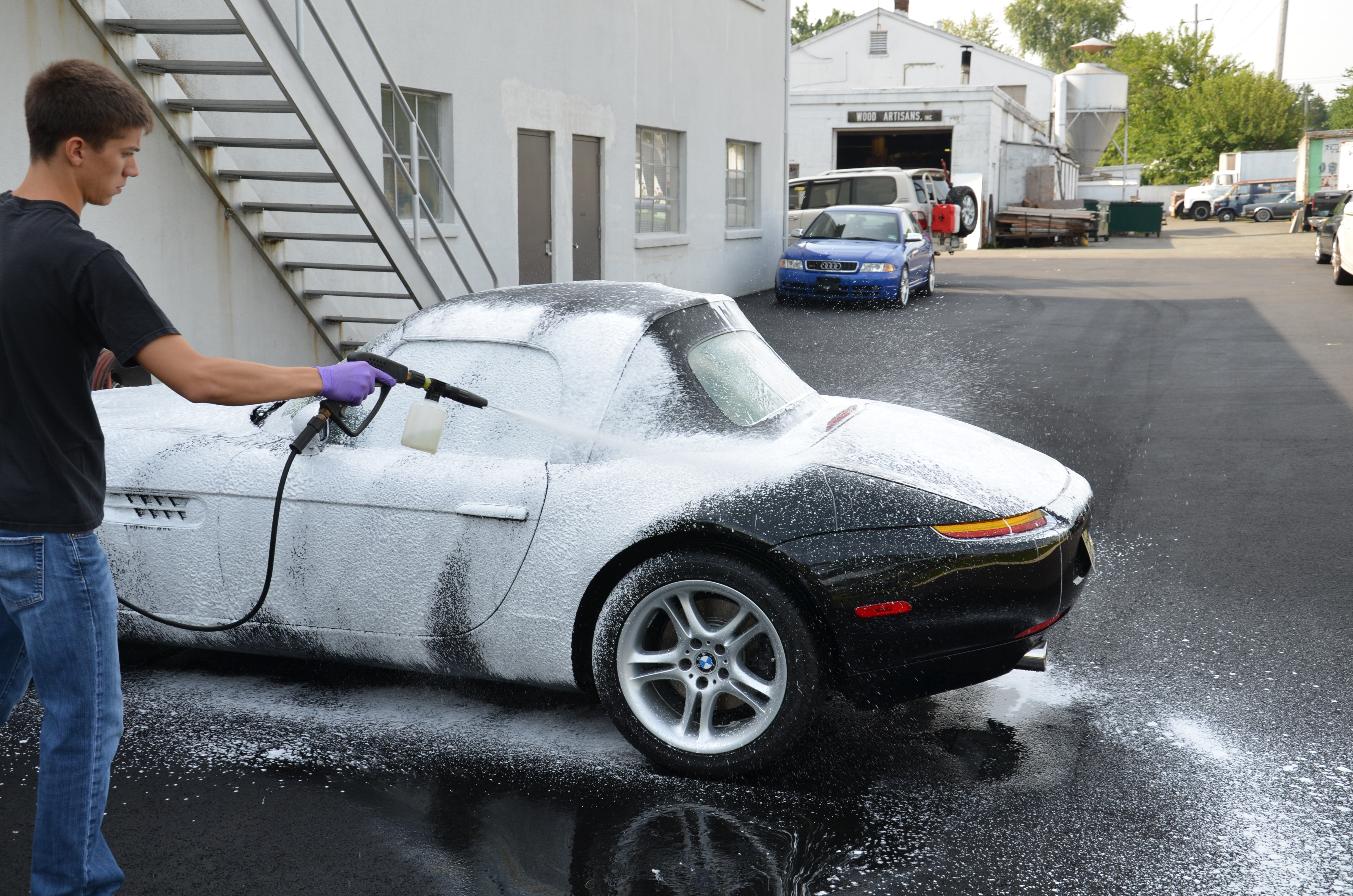

Exterior

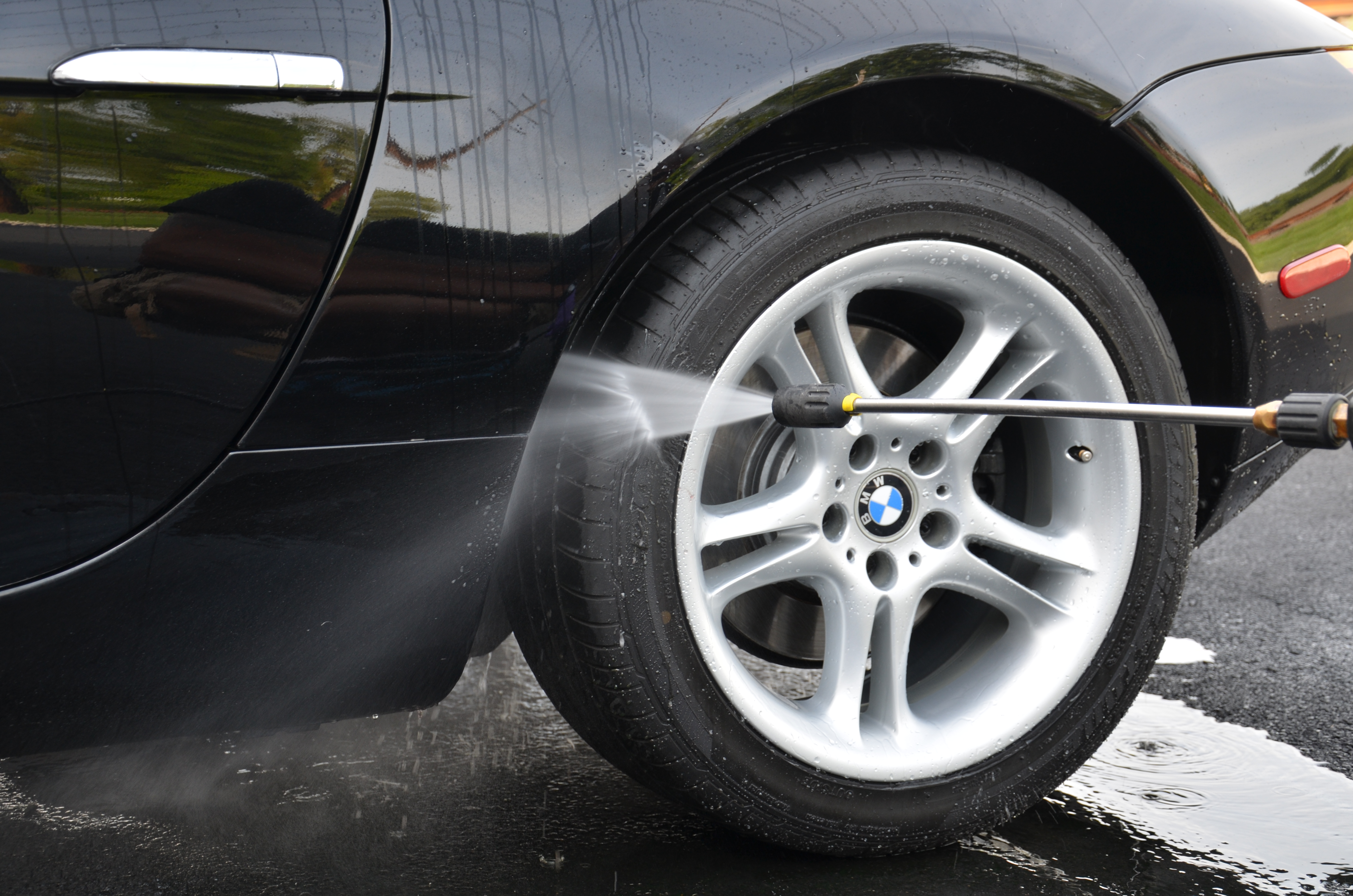

- Wheels were prepped with Sonax Wheel Cleaner and cleaned up with various brushes
- Tires were spritzed down with Adam’s All Purpose Cleaner and washed down
- Wheel wells were cleaned up

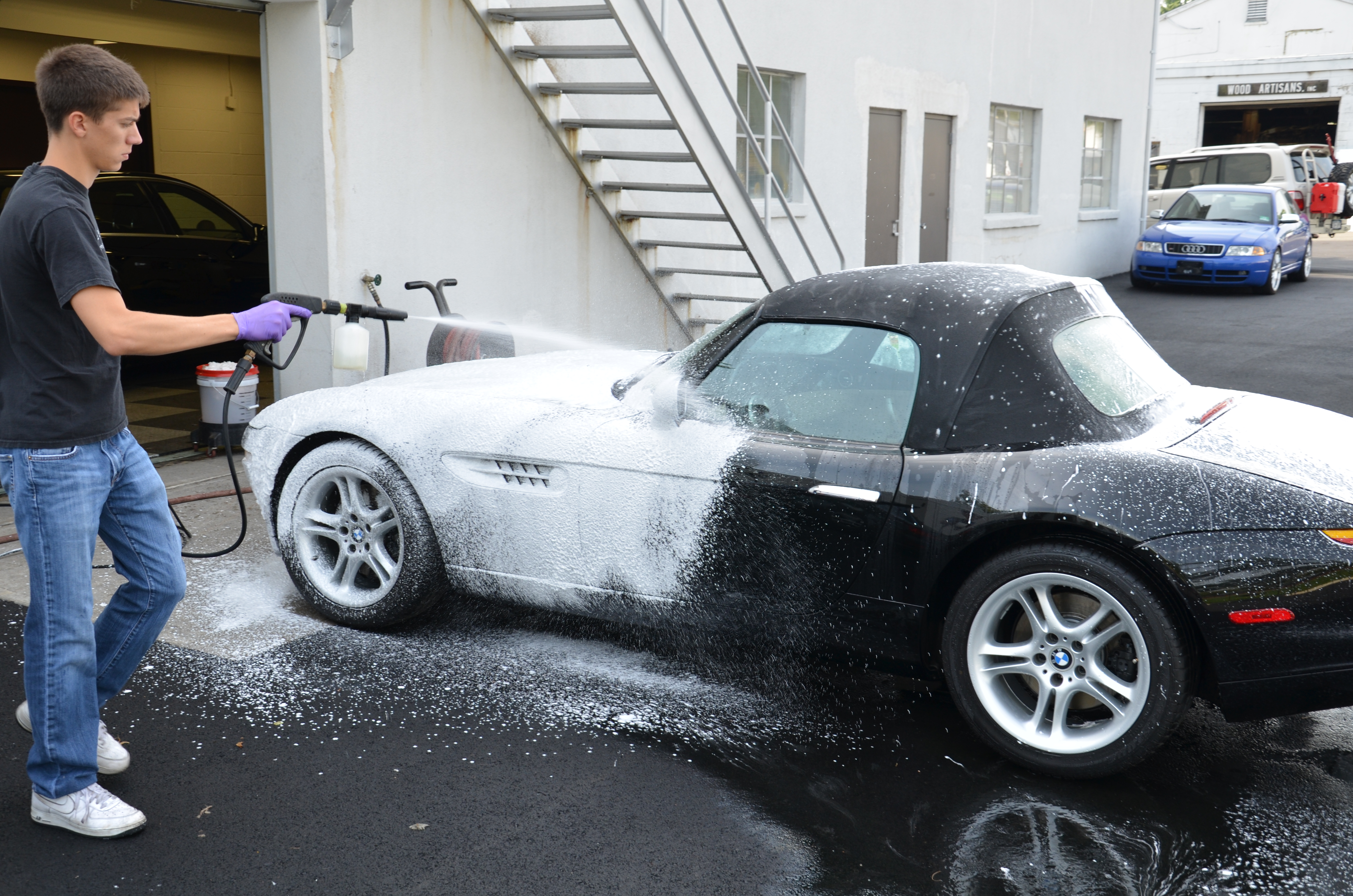

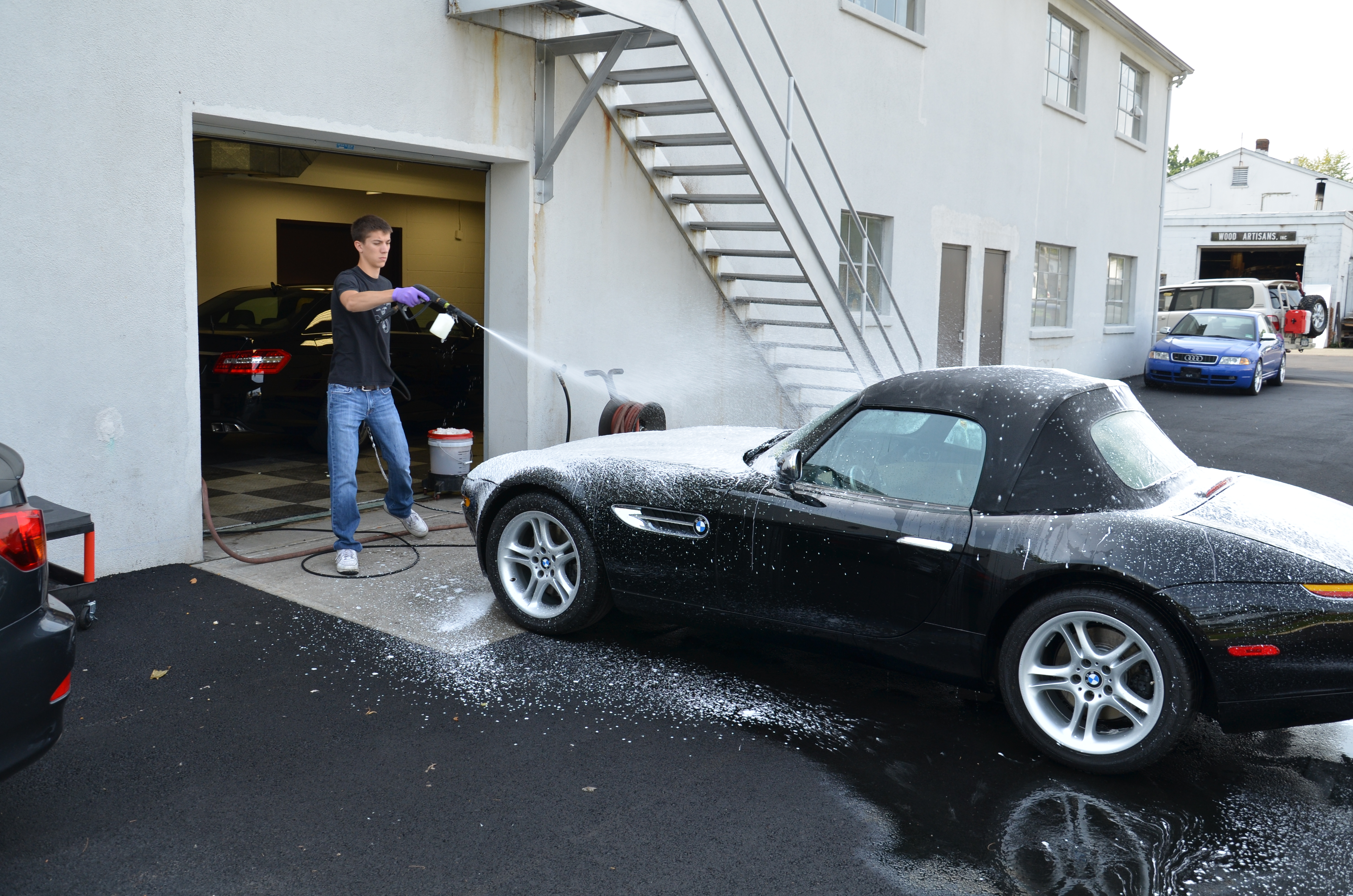

- Washed with 1Z einszett W99

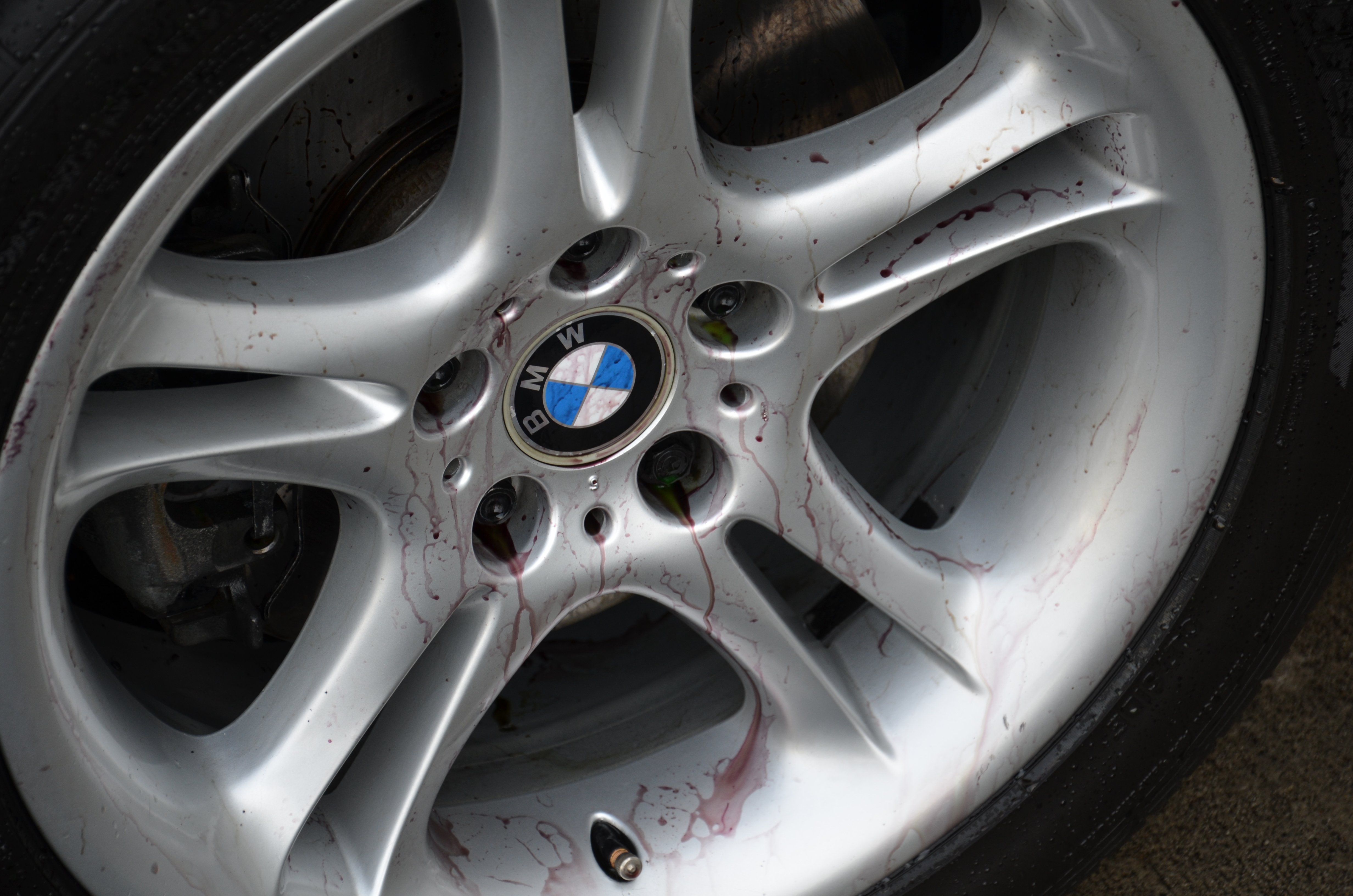

- Aquartz Iron Cut
- Wash down and rinsed
- Door jambs were cleaned up
- Nano Scrub AutoScrub
- Dried
- Tires dressed
- Masking

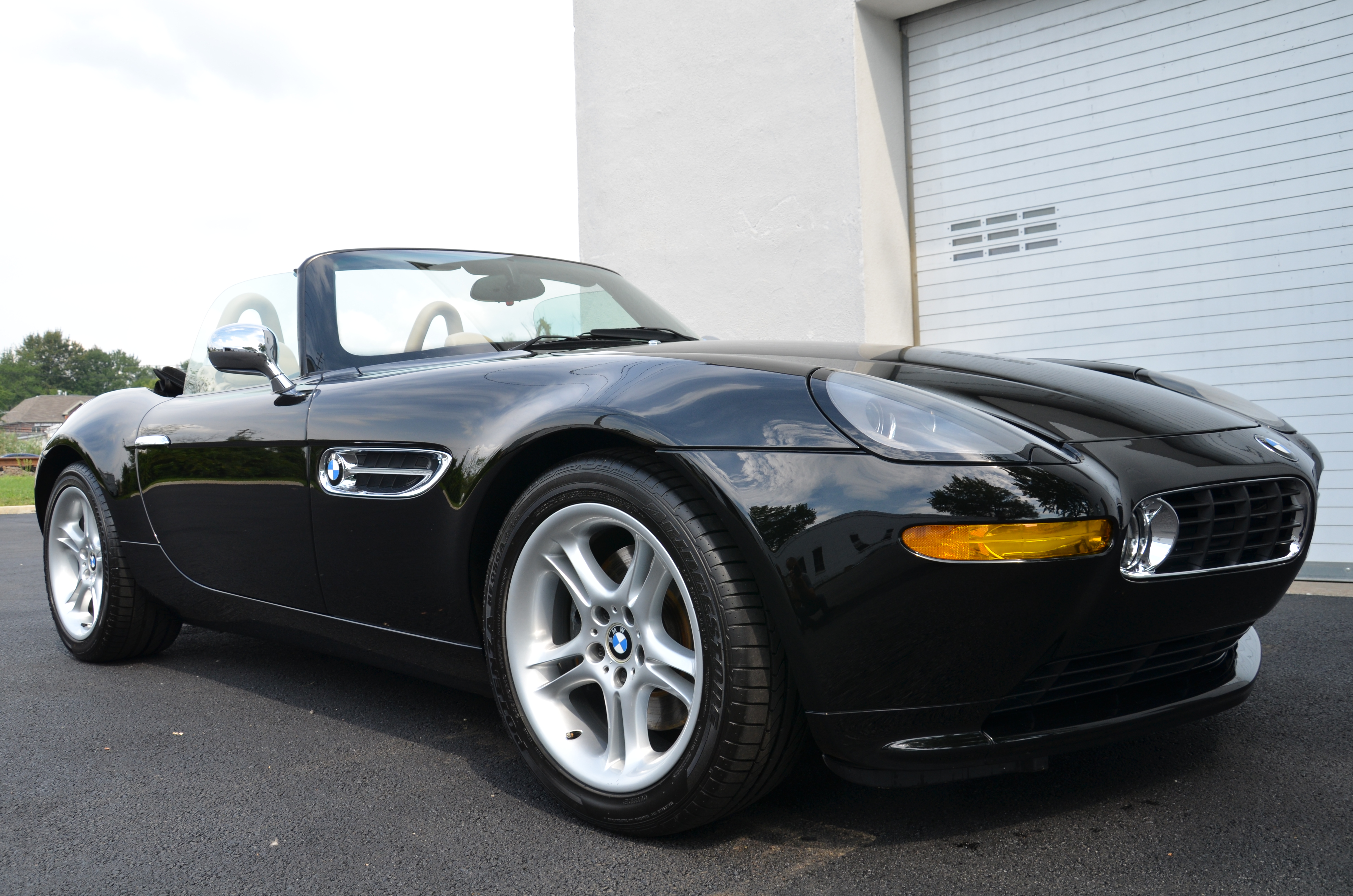

- Paint Measurement
- Meg's M105 with Surbuf and Griots Orbital
- Sonax 5/5 Fine Abrasive Paste - Microfiber DA Cut Pad - Griots Orbital
- Sonax 3/6 Nano Polish - Uber Green Pad - Griots Orbital
- Lusso Oro was used as a last step
- Inspection with Fenix, 3m Sun Gun, Infratech, and natural sunlight
- Wheel wells were cleaned and dressed
- Rubber and Plastics Treated
- Exterior windows and mirrors cleaned and sealed
- Exhaust tips cleaned

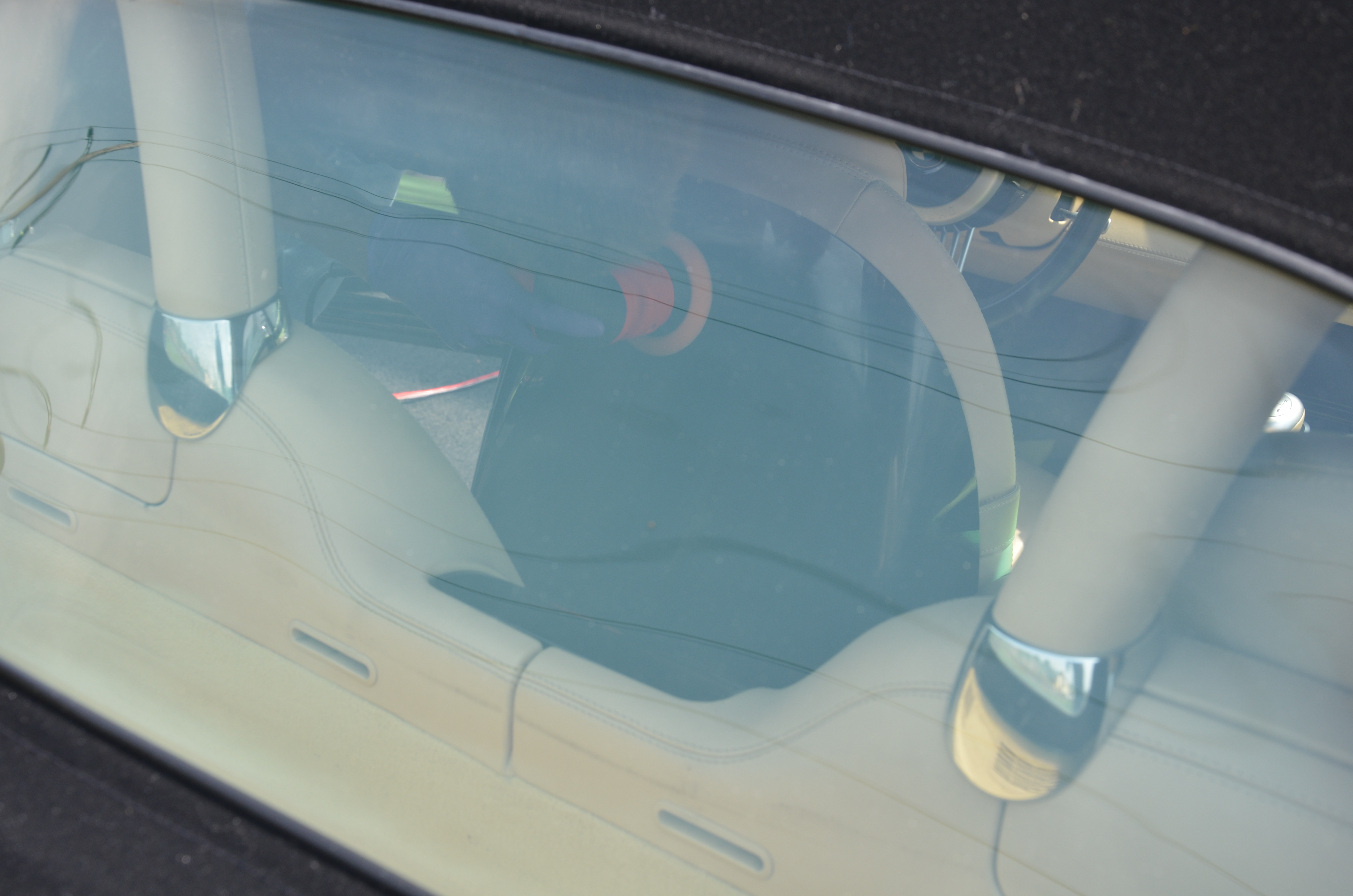

- Windows were autoscrubed, cleaned, and sealed

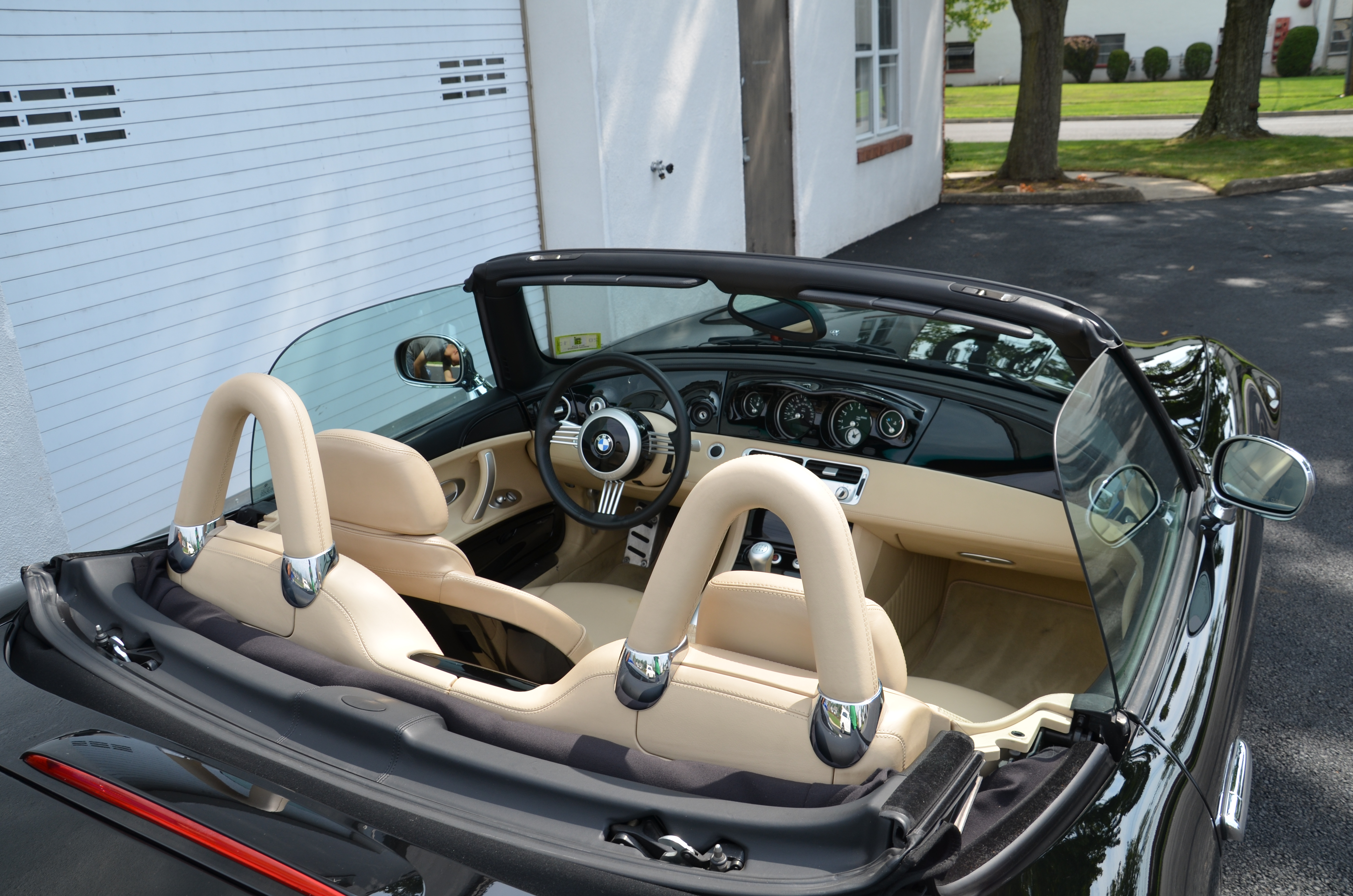

Interior
1Z Cockpit
1Z Plastic Deep Cleaner
1Z Leathercare

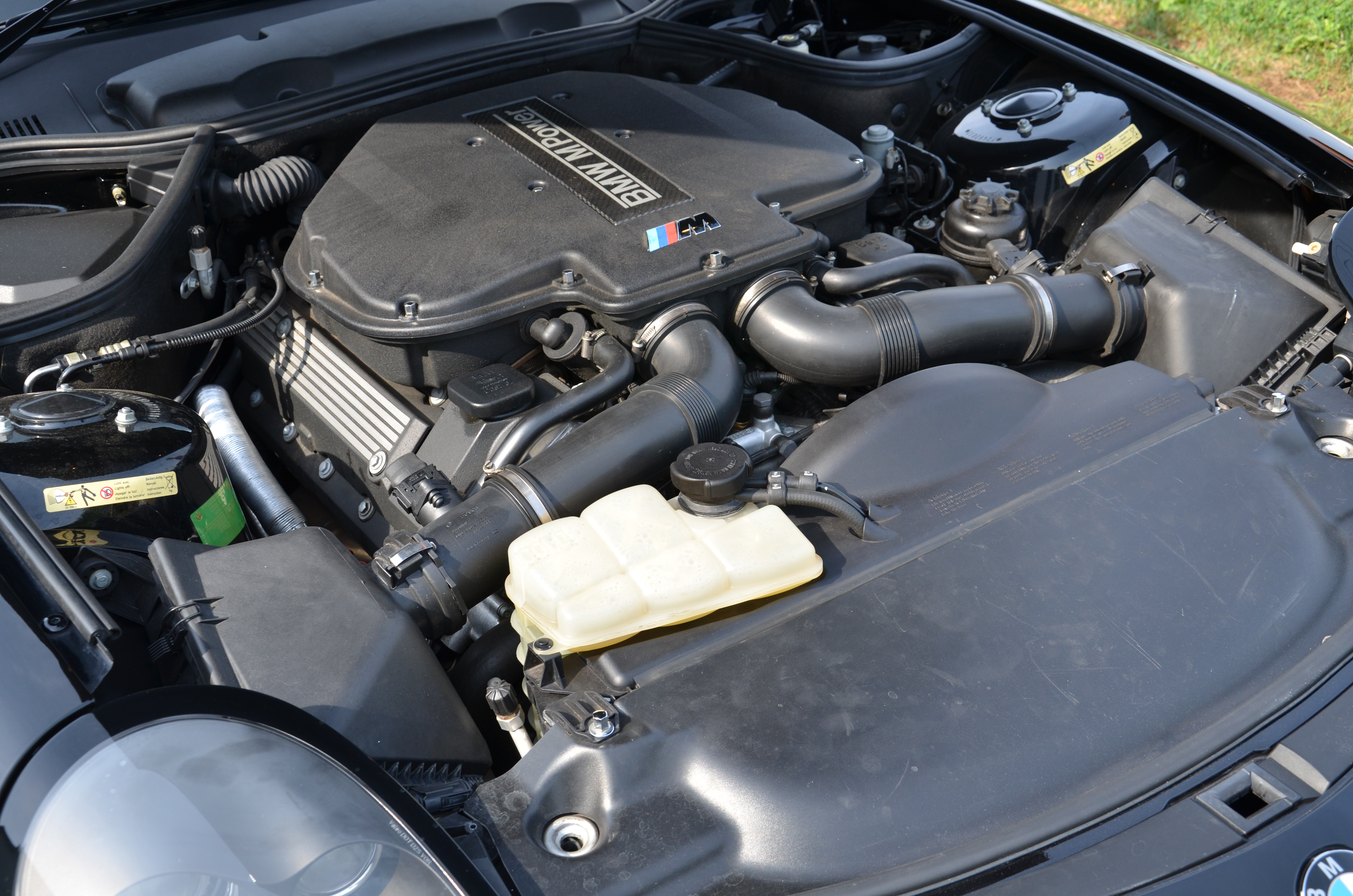

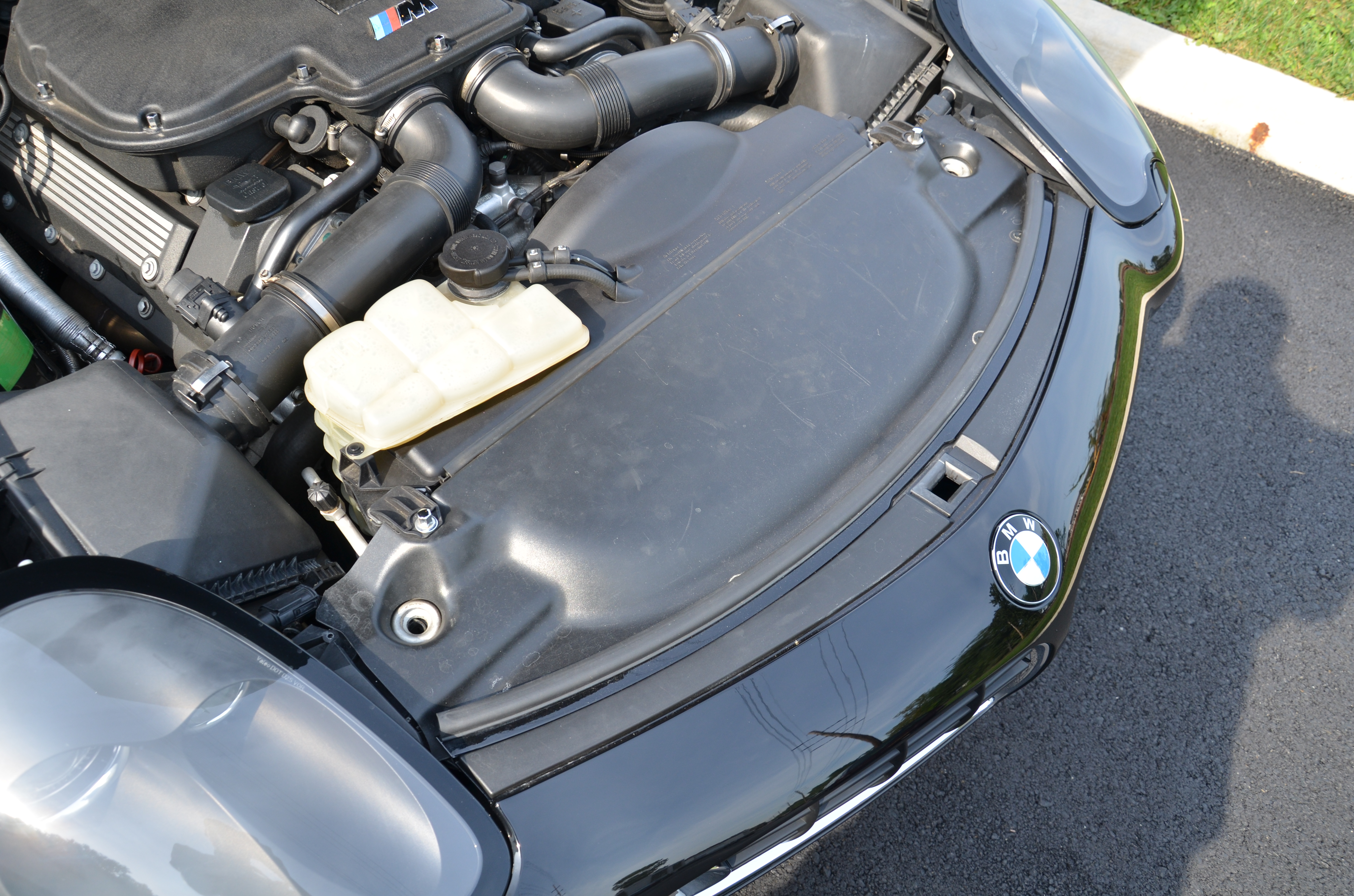

Engine
Adam's APC
Adam's In and Out Spray

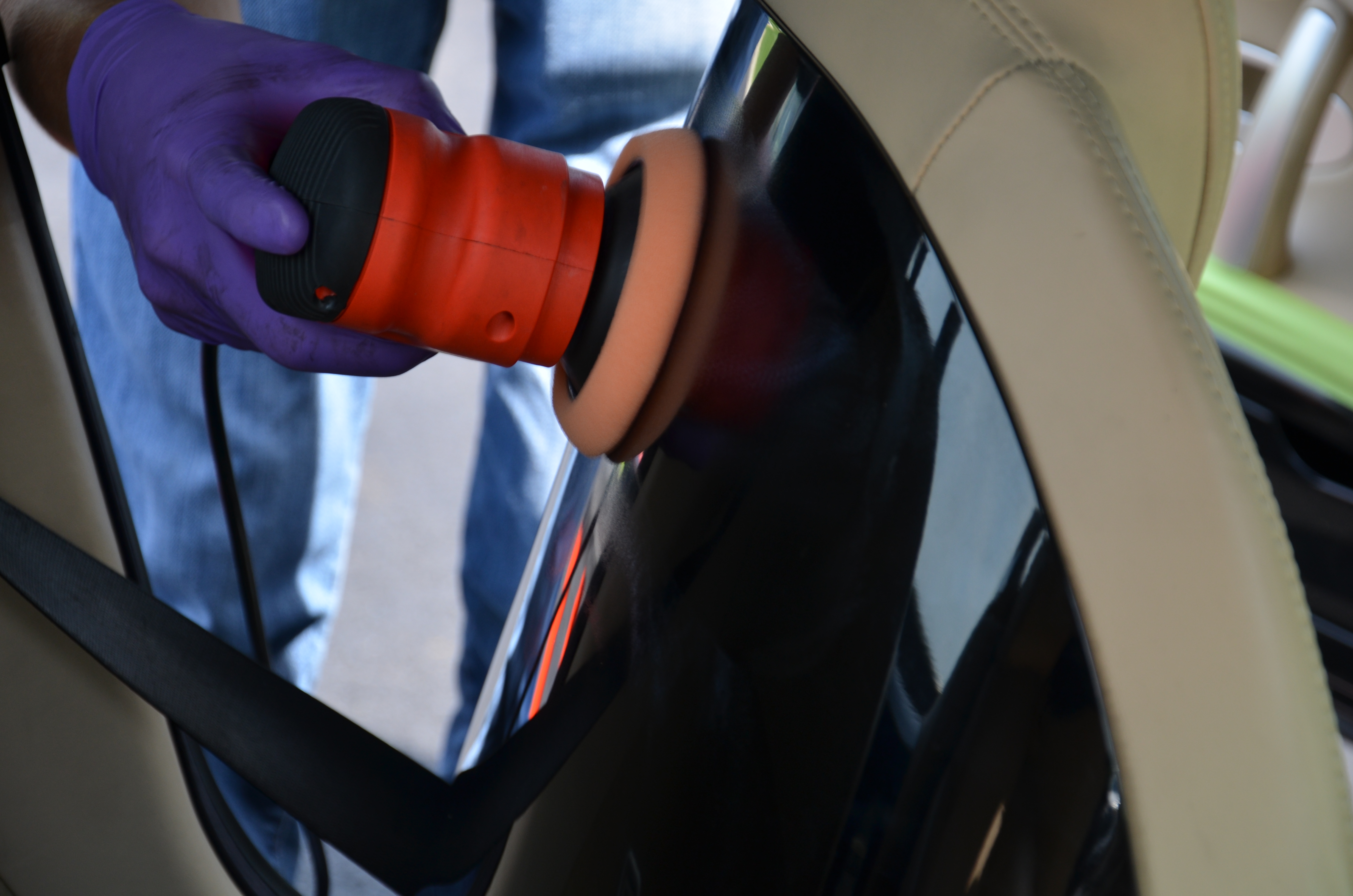

Polishing the seat backs with the Griots and Adam's 4 inch Focus Pads

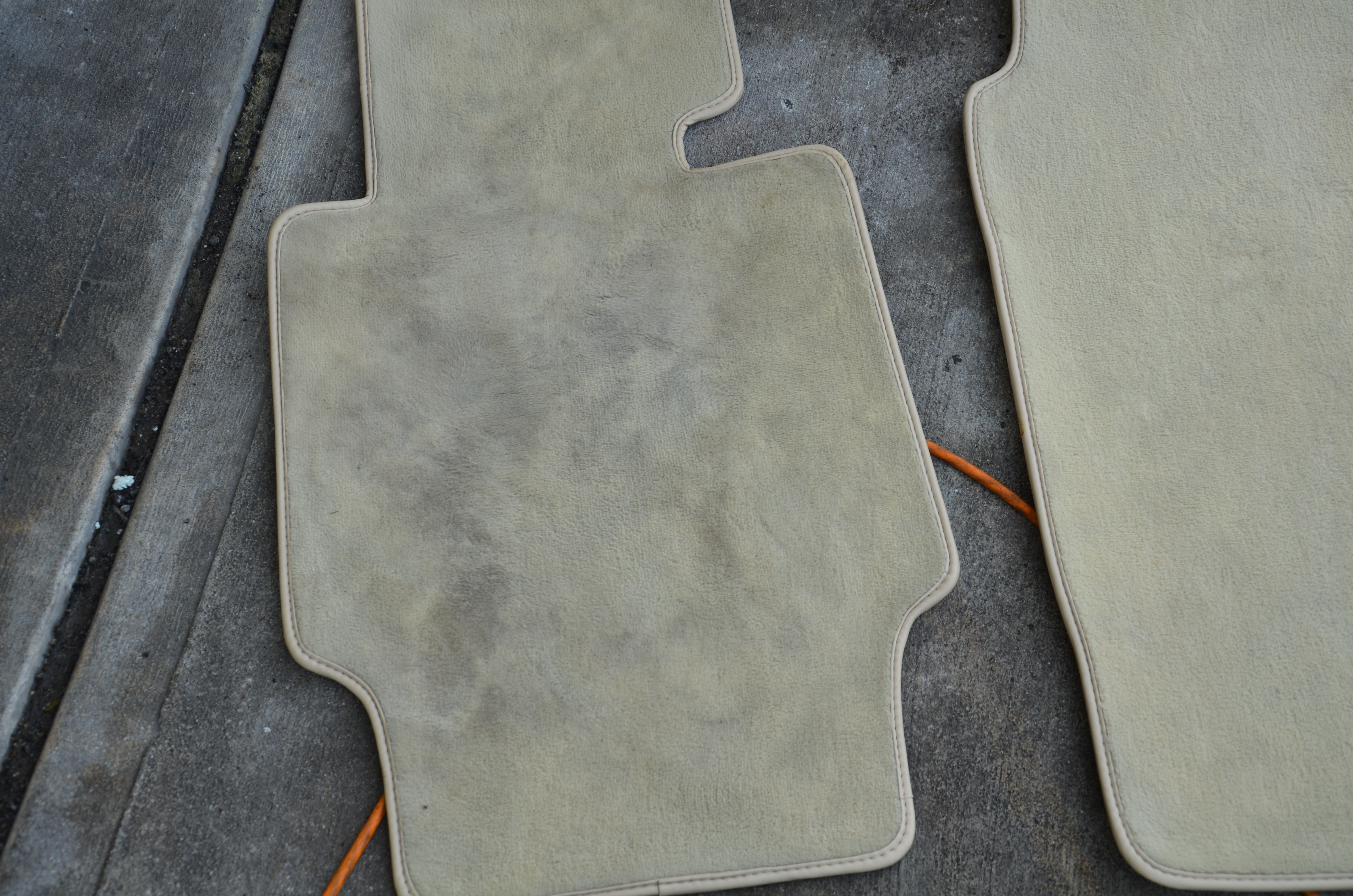

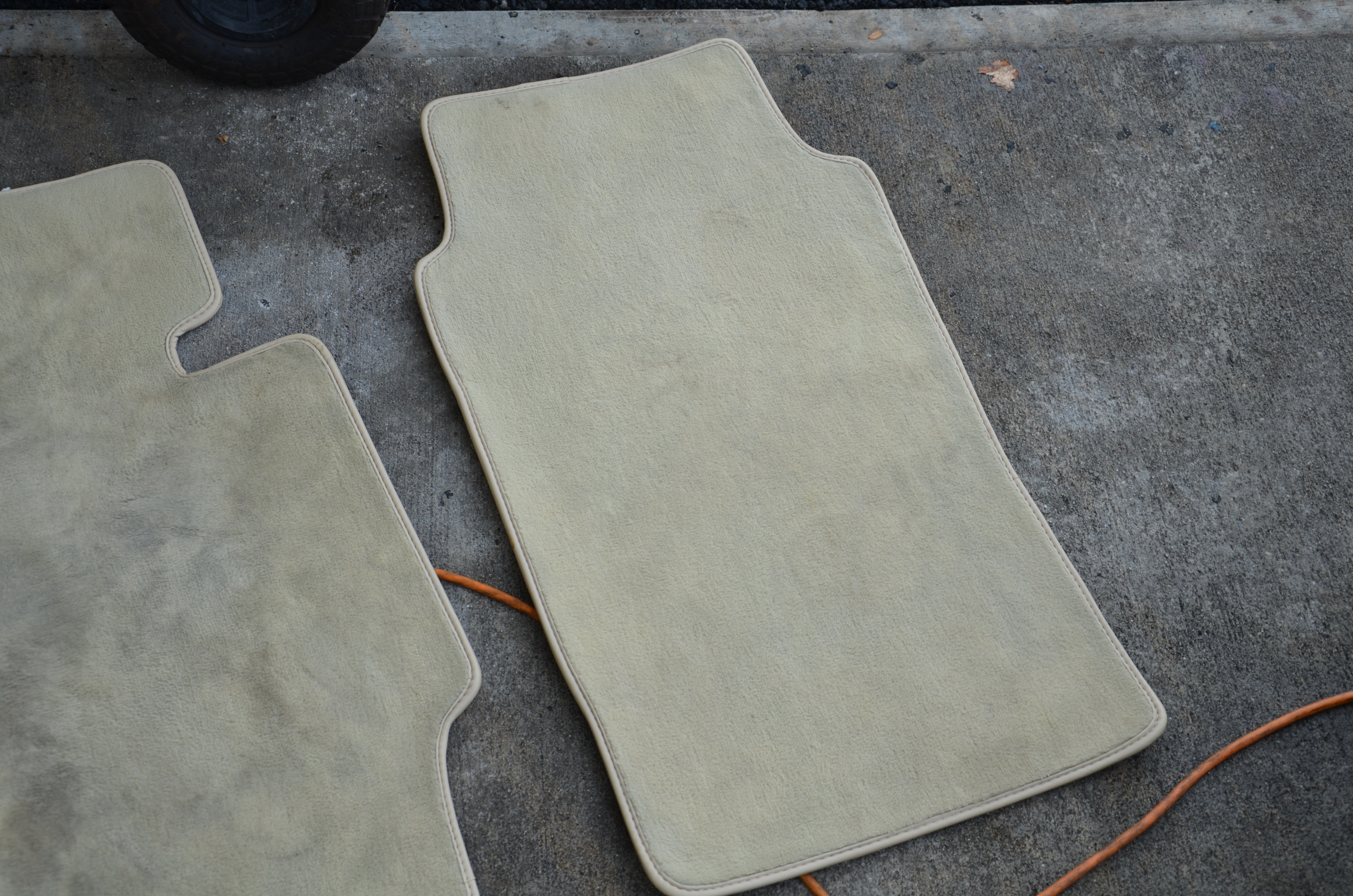

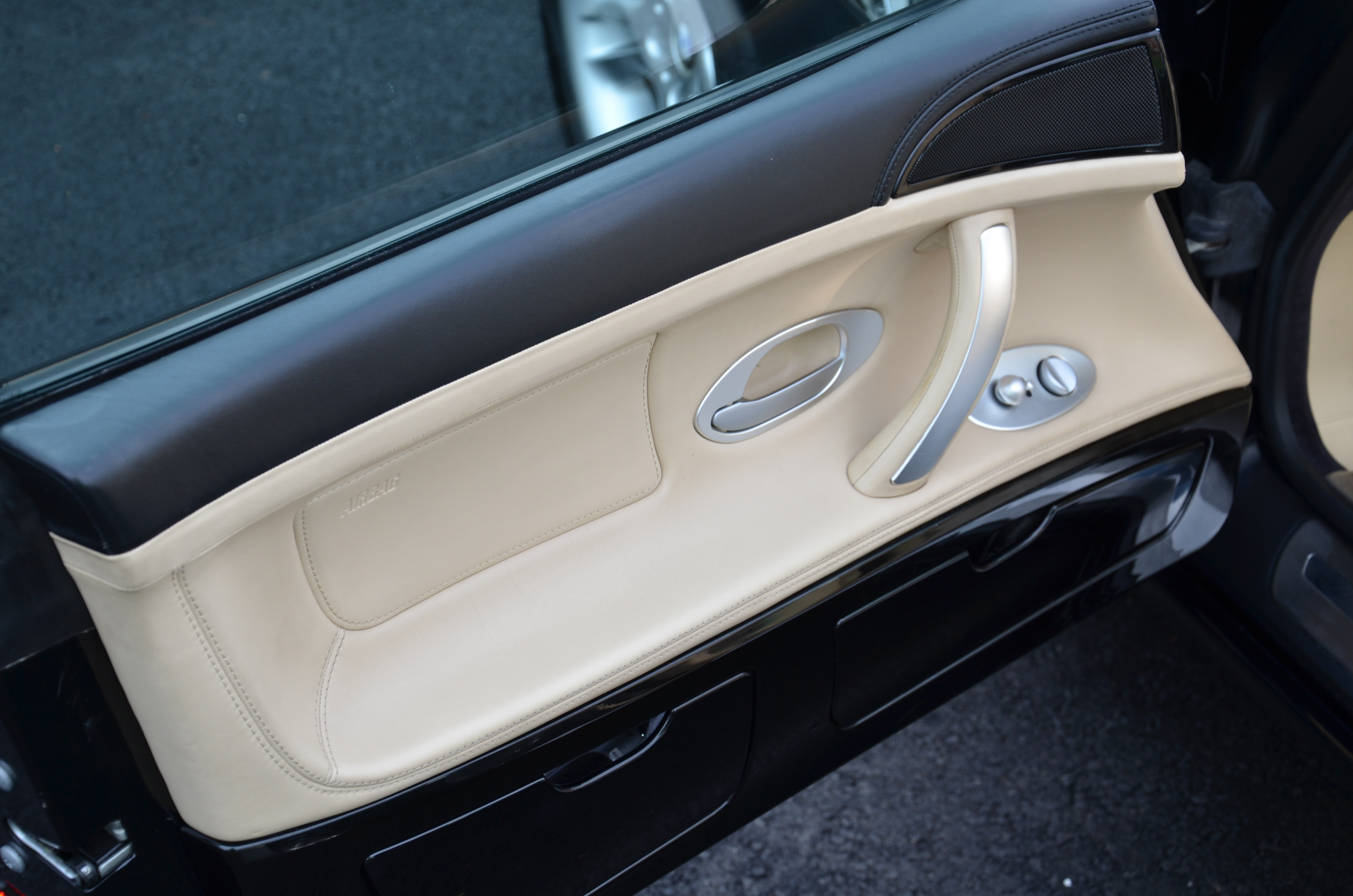

Not a great shot but as you can see the mat on the left was not cleaned up and the one on the right has been cleaned with the Griots 3 inch polisher w/Uber Ultra Interior Brush and 1Z einszett Deep Cleaner

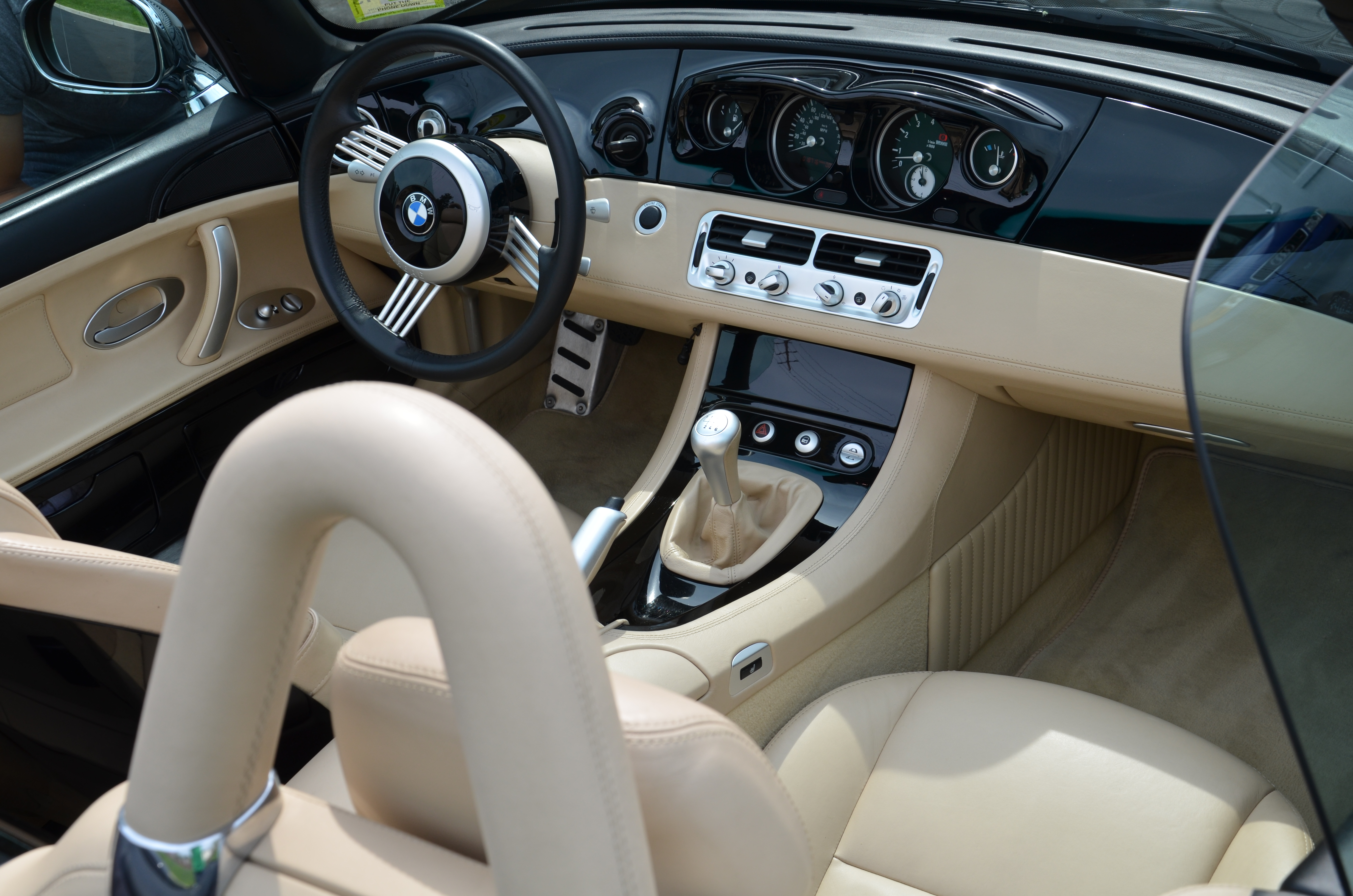

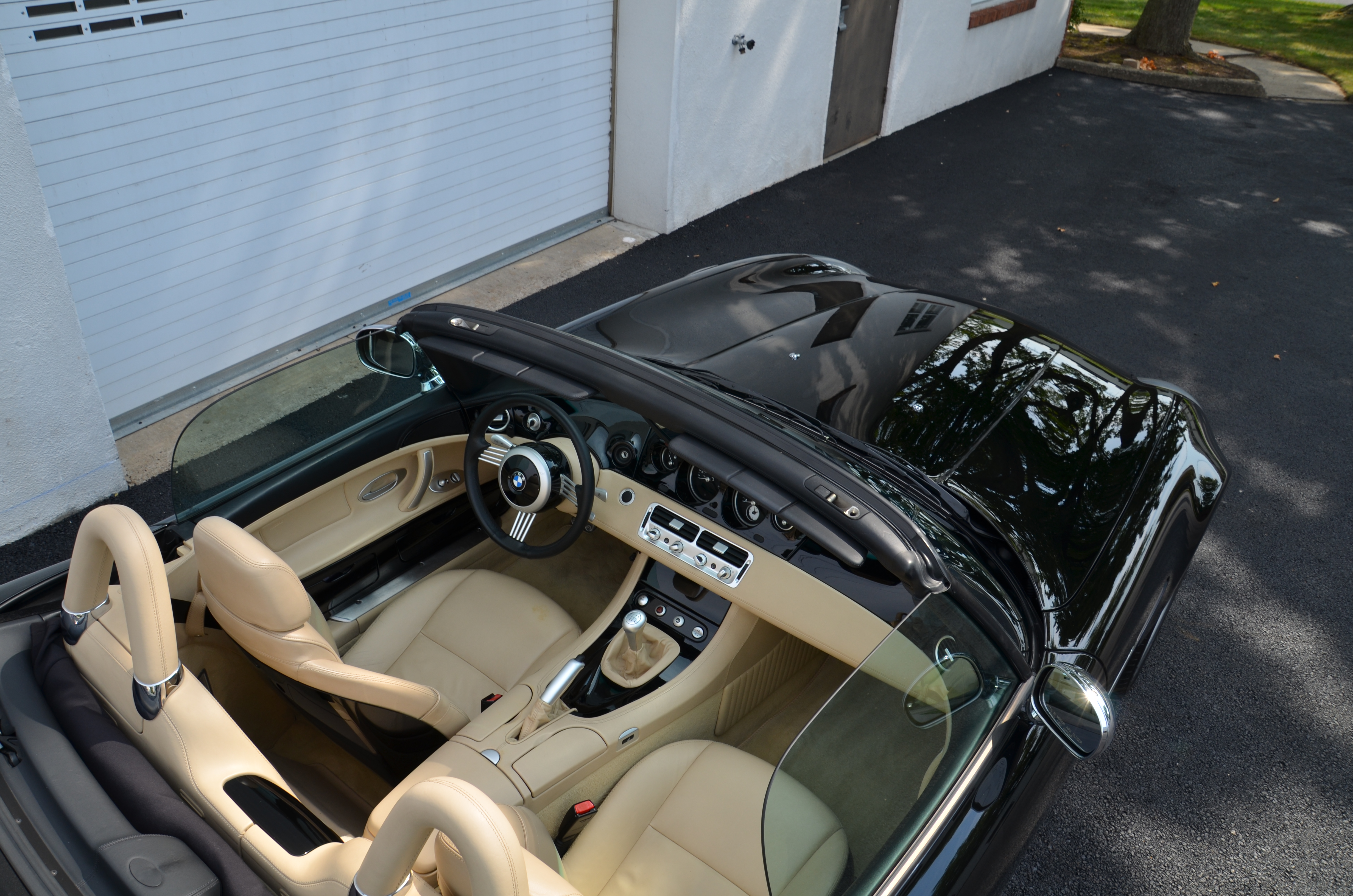

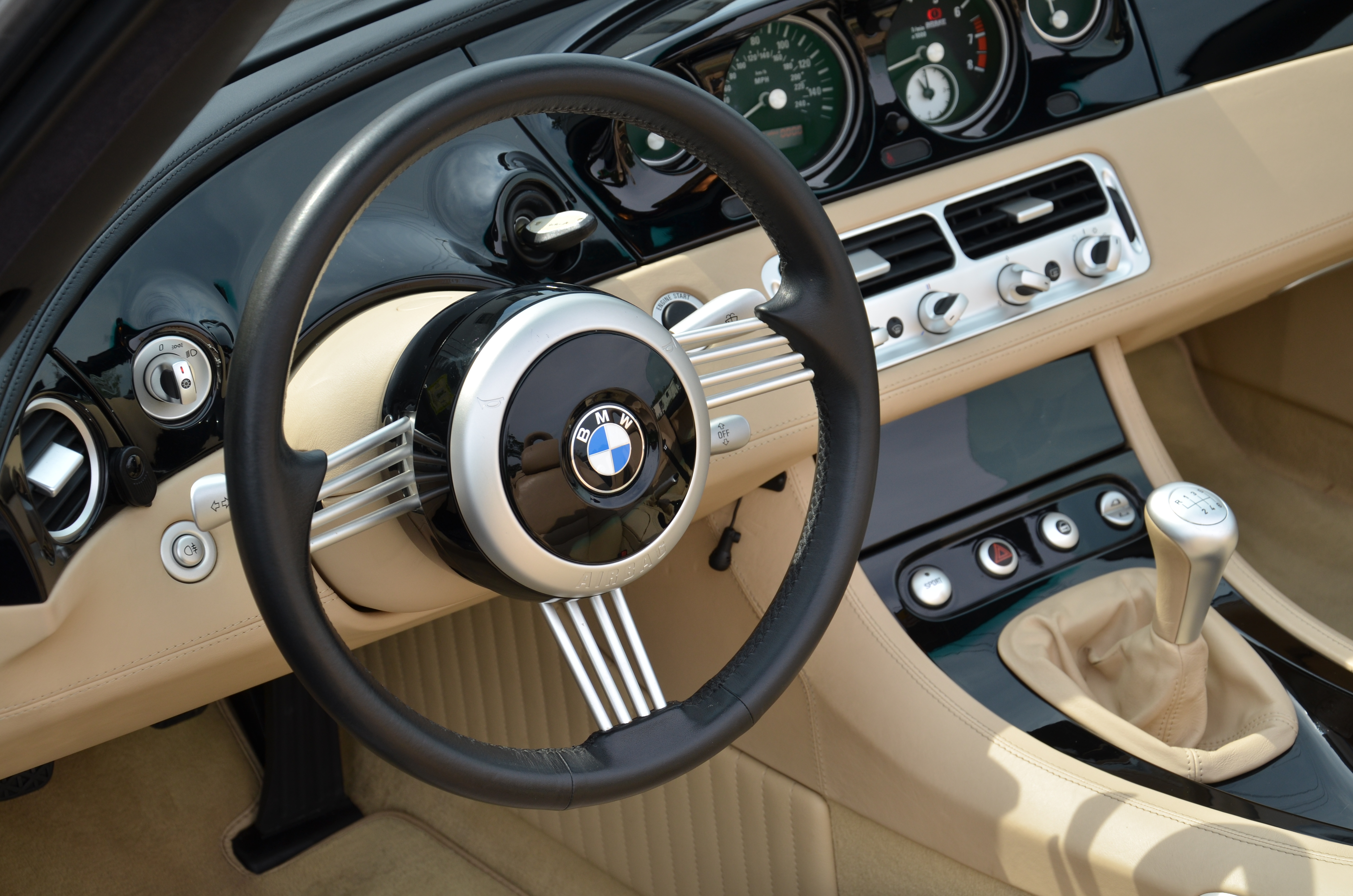

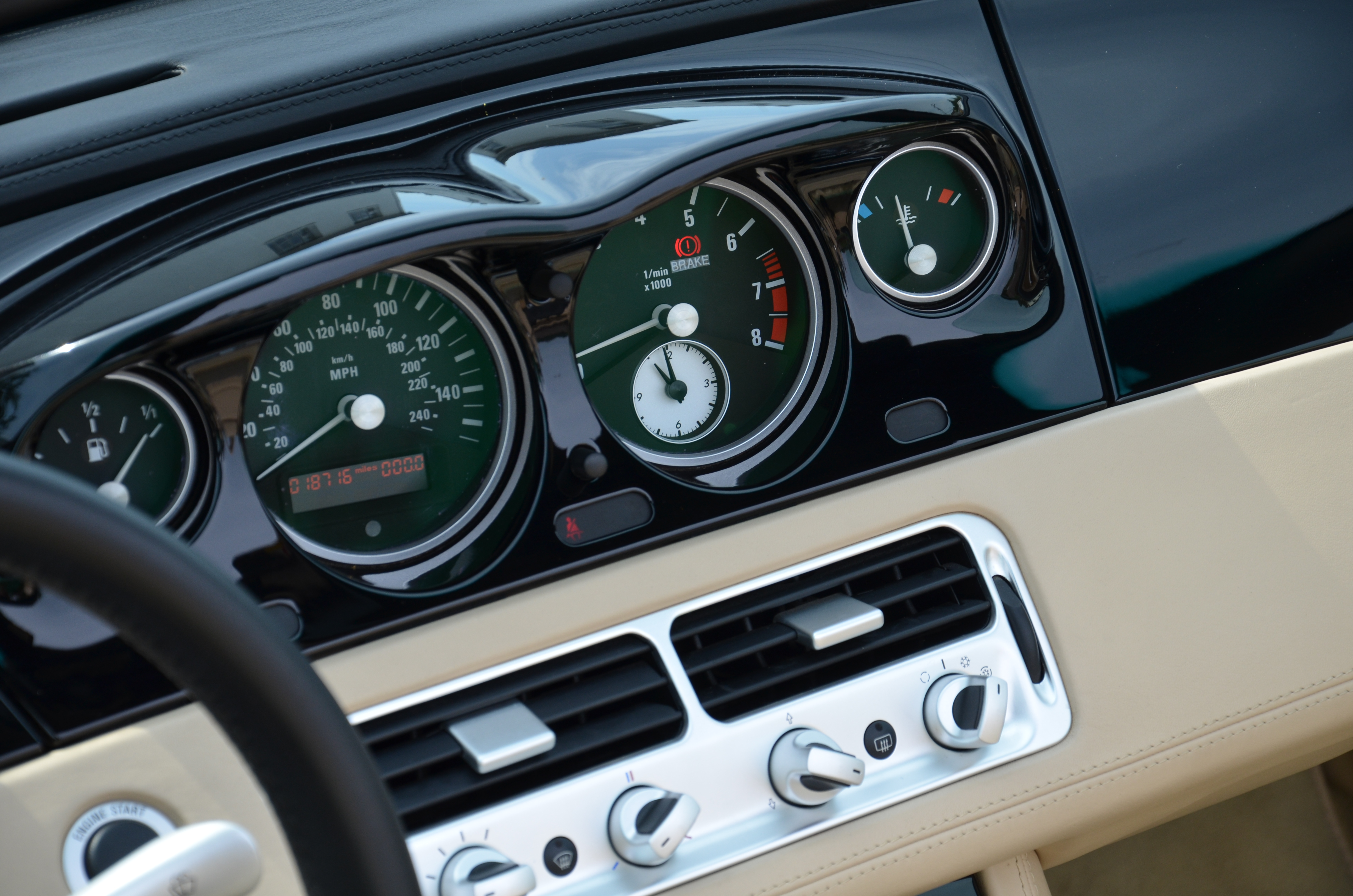

After Interior
Prep - Car Wash/Decon/NanoSkin/Wheels/Tires/Engine

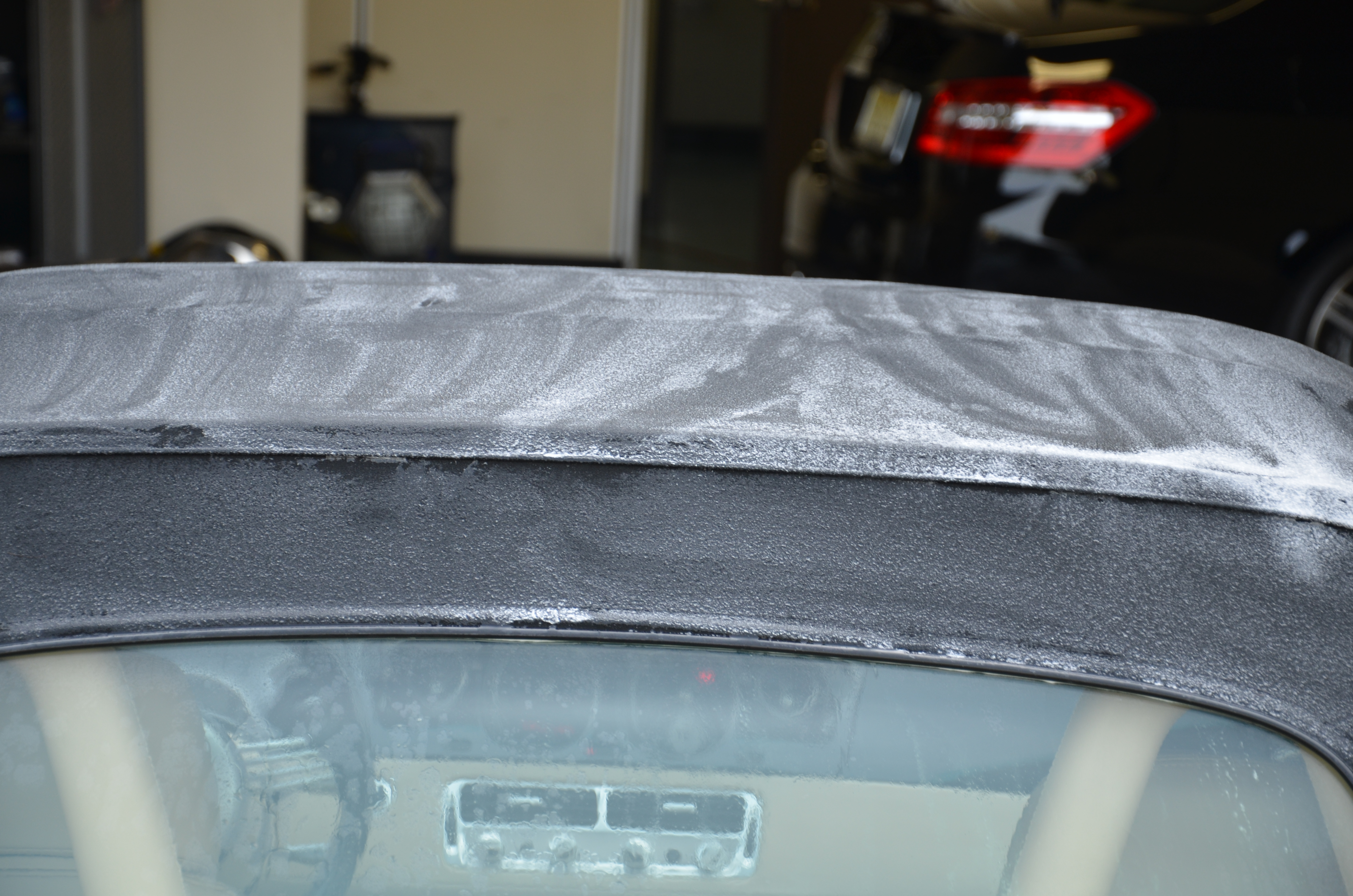

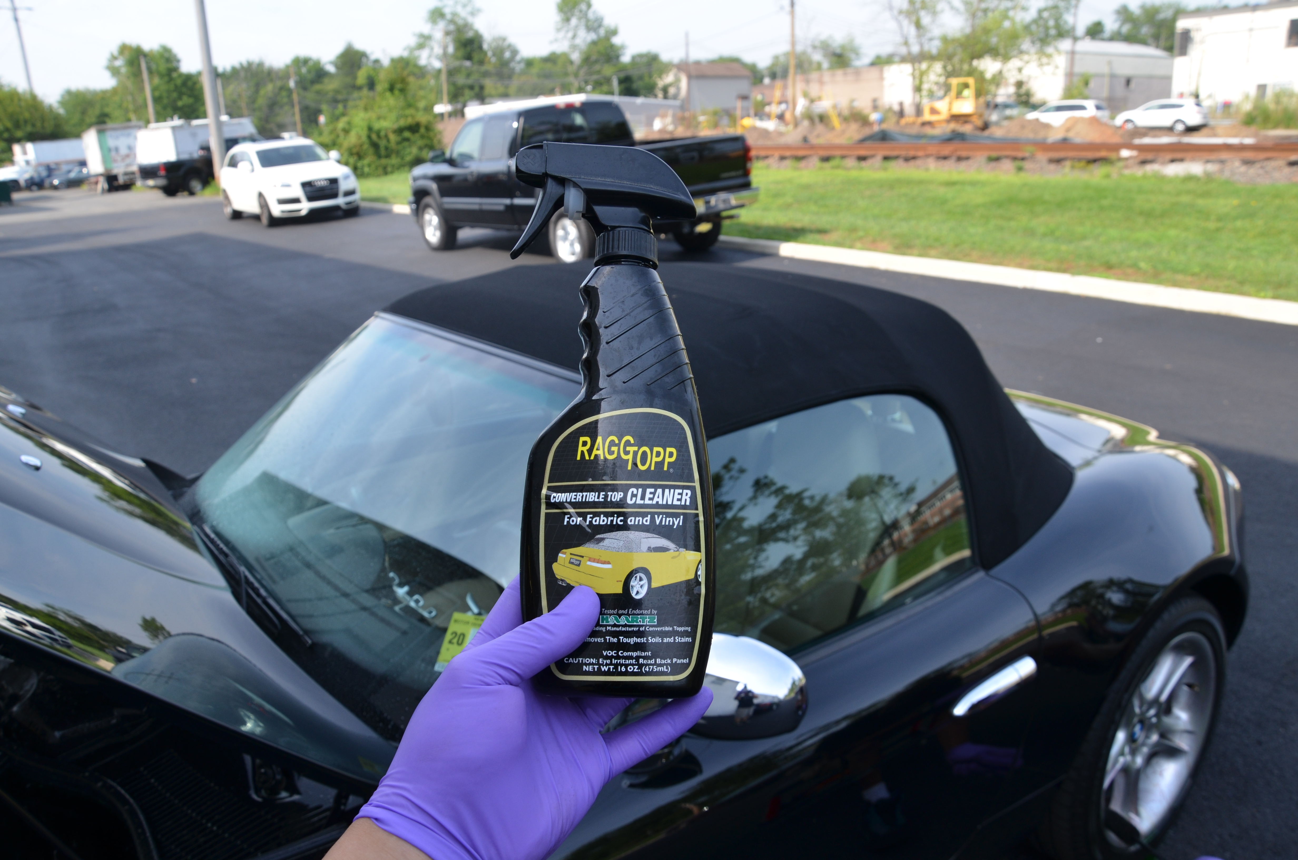

Convertible Top Cleaned

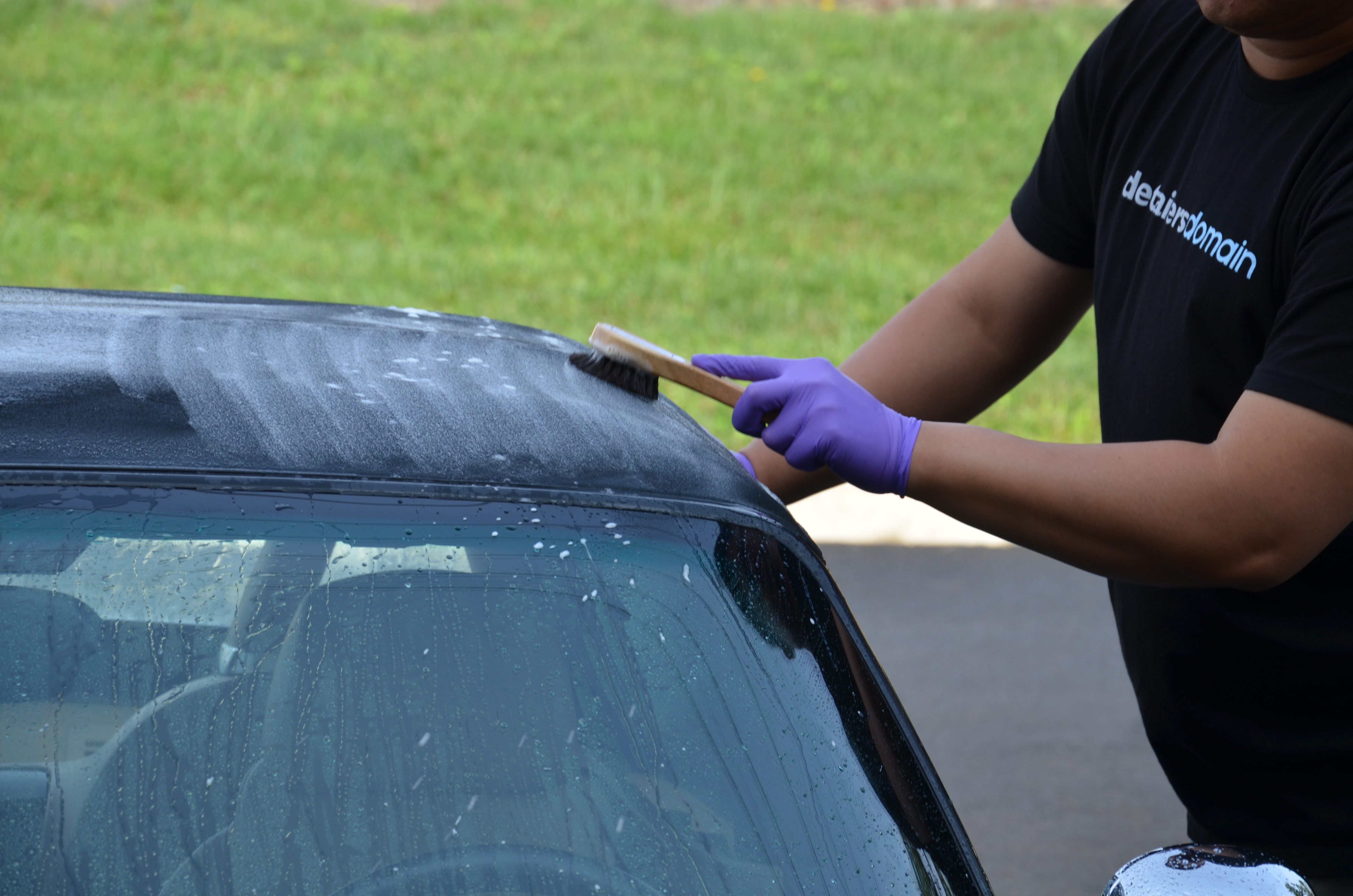

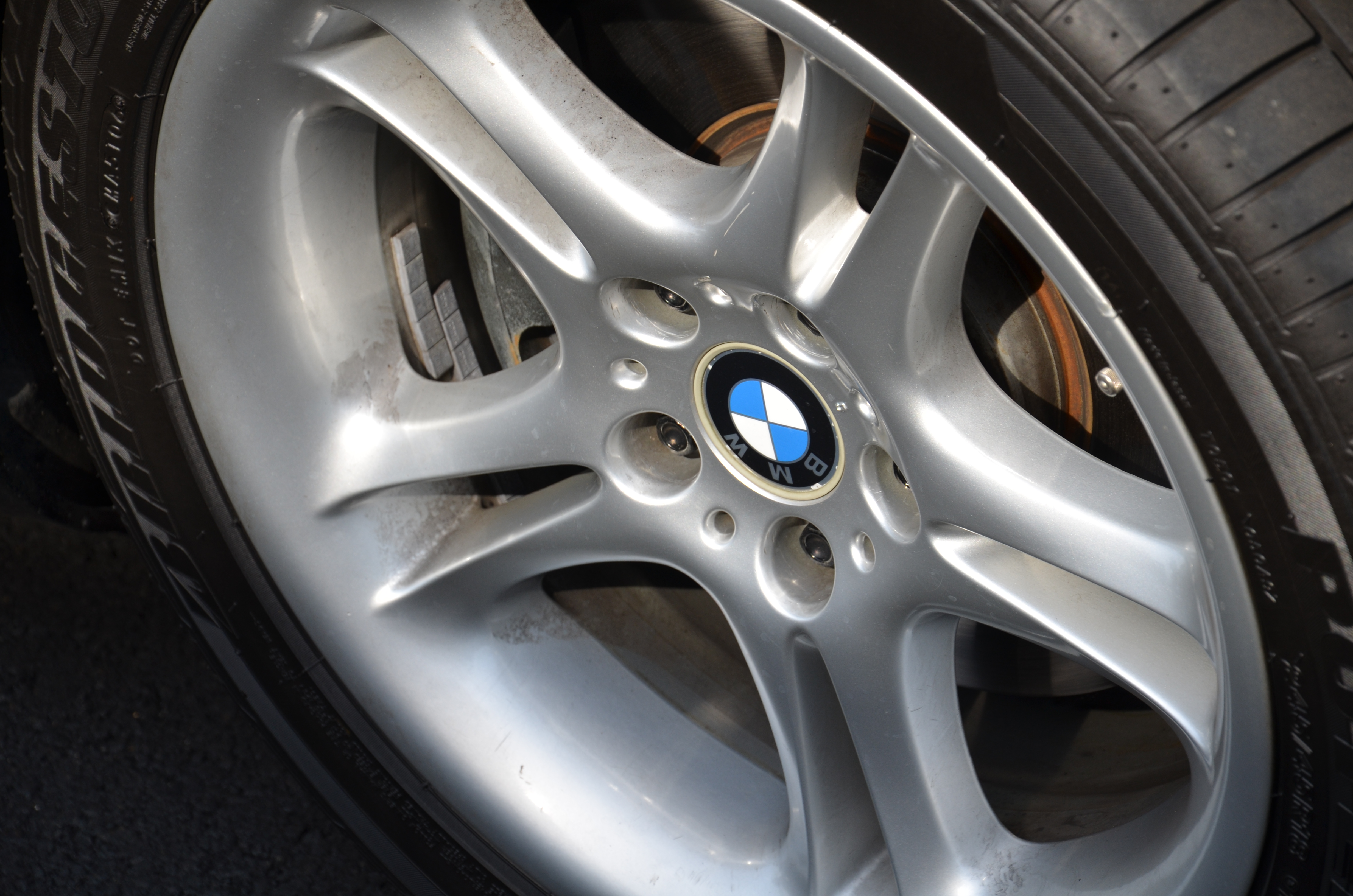

Wheels were not too bad

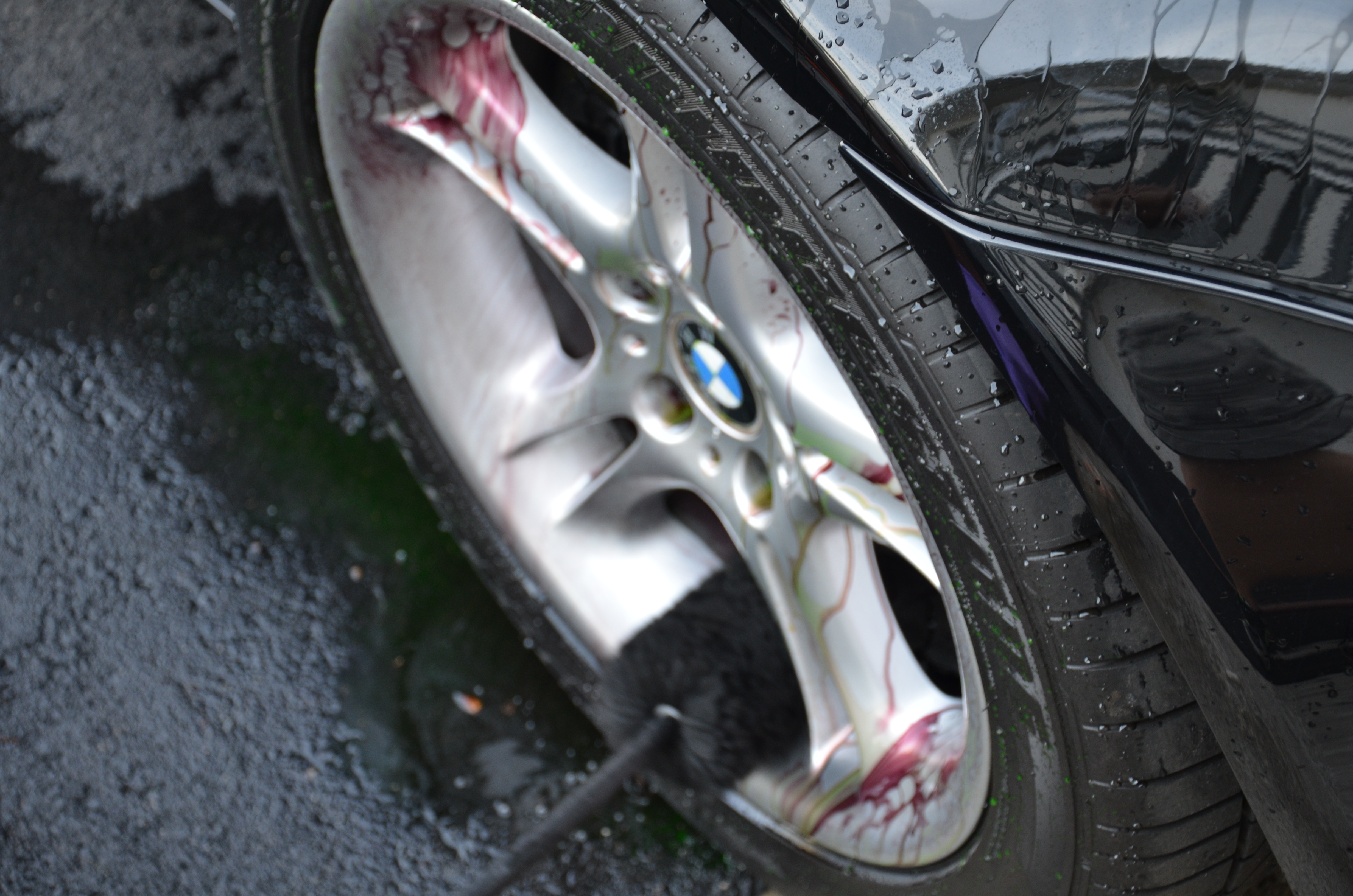

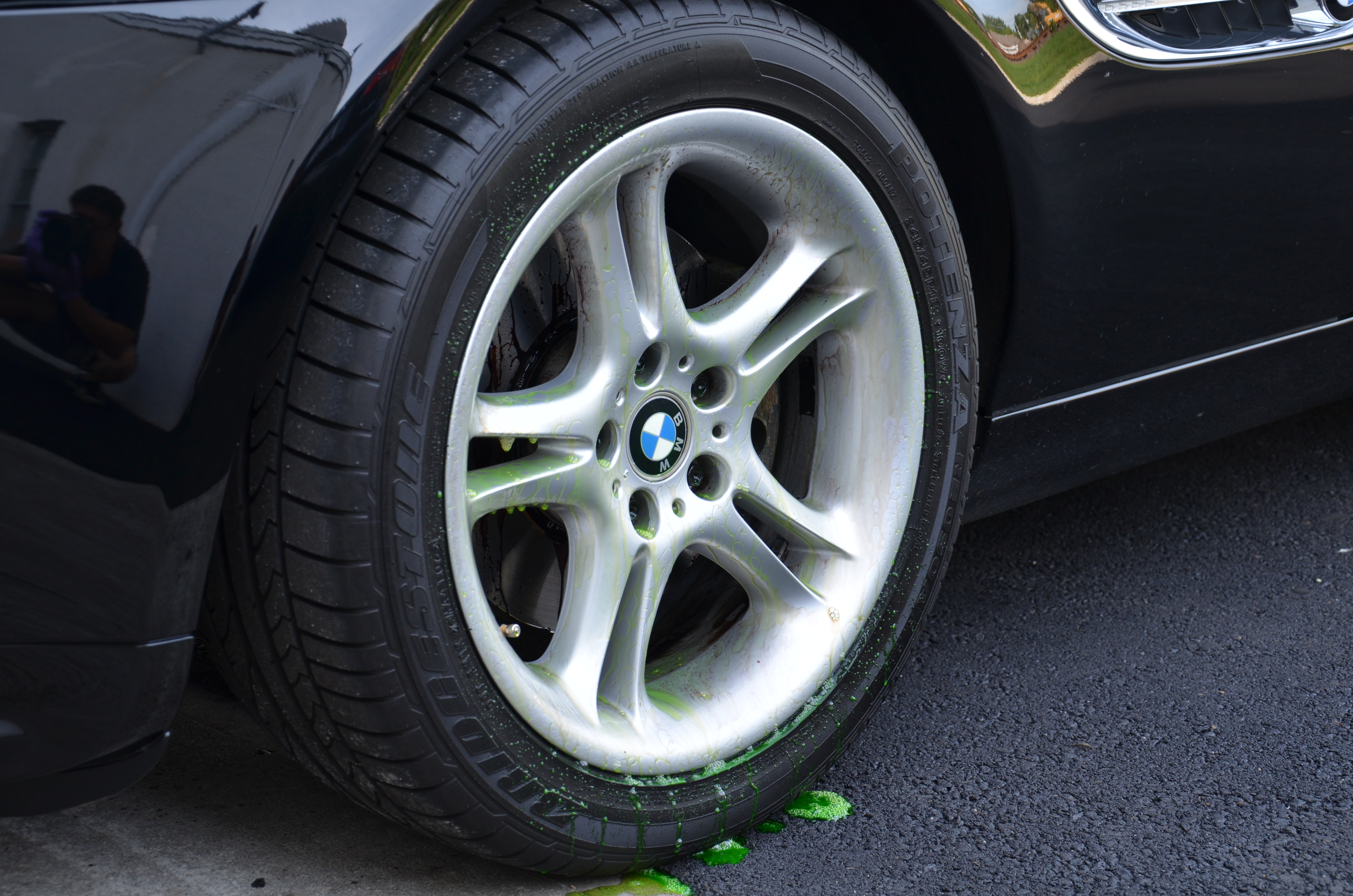

Sonax Full Effect Wheel Cleaner in action
Wheel Woolies used to clean the barrels out

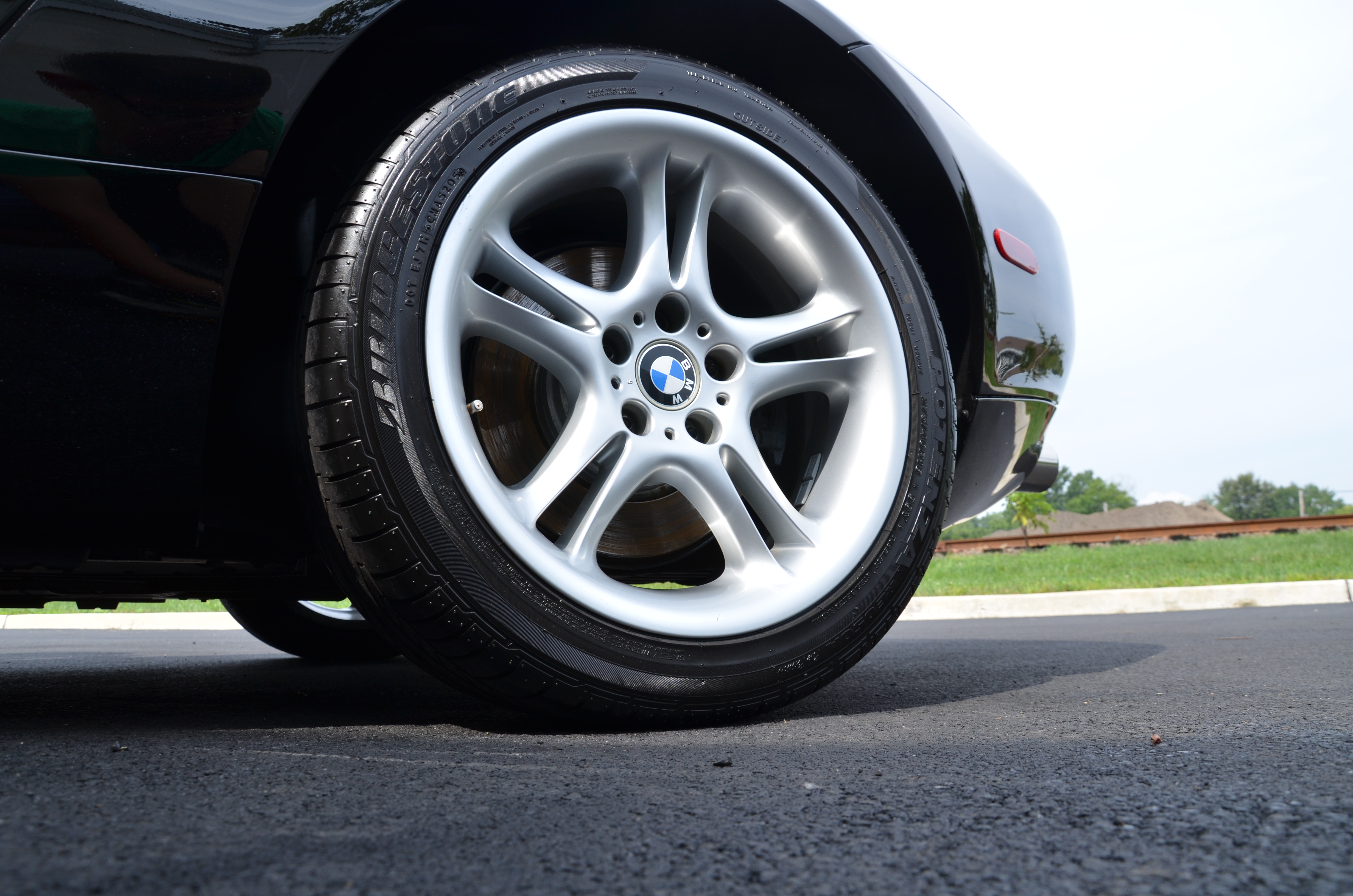

Wheels cleaned

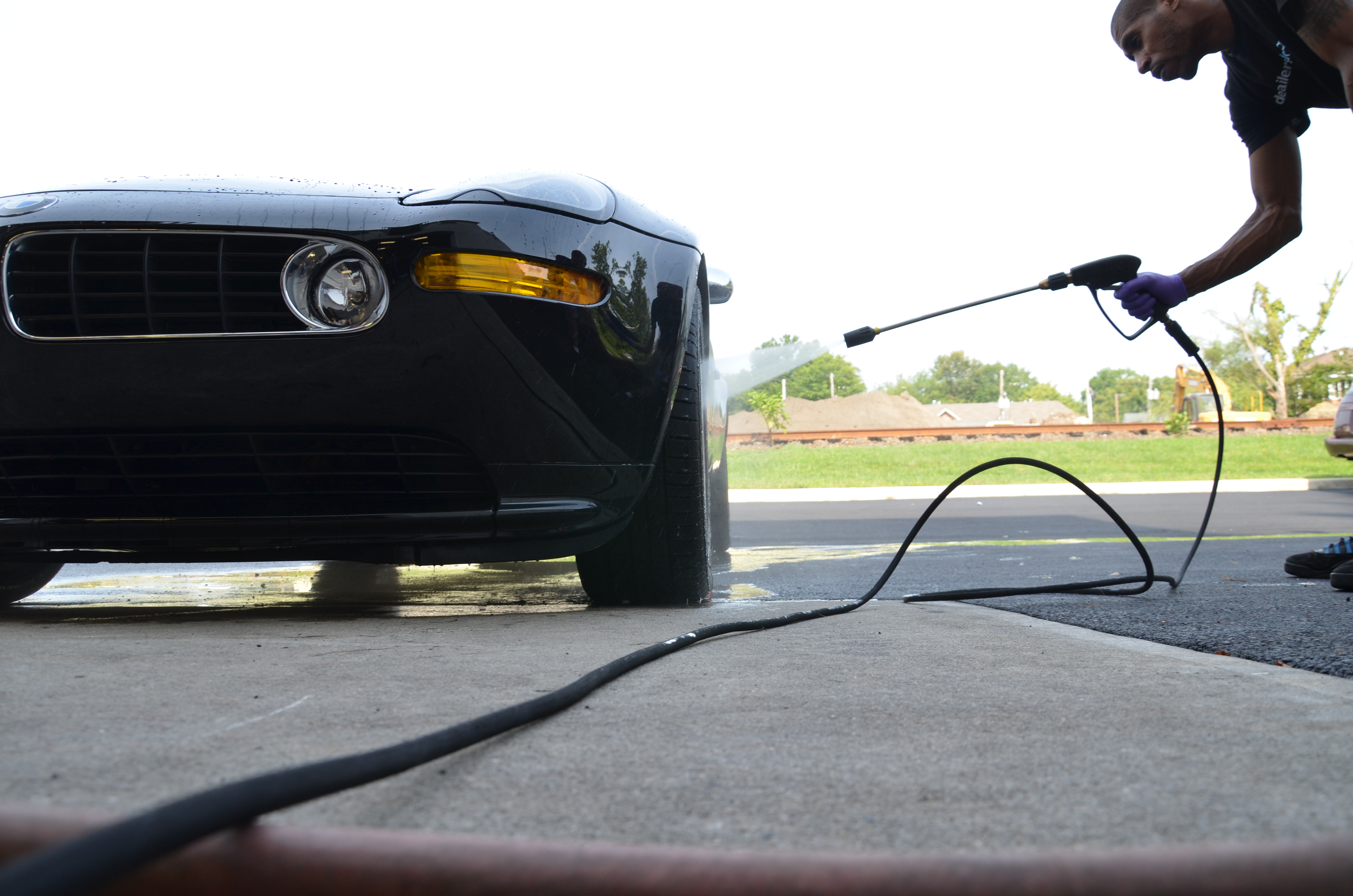

Wheel wells power washed

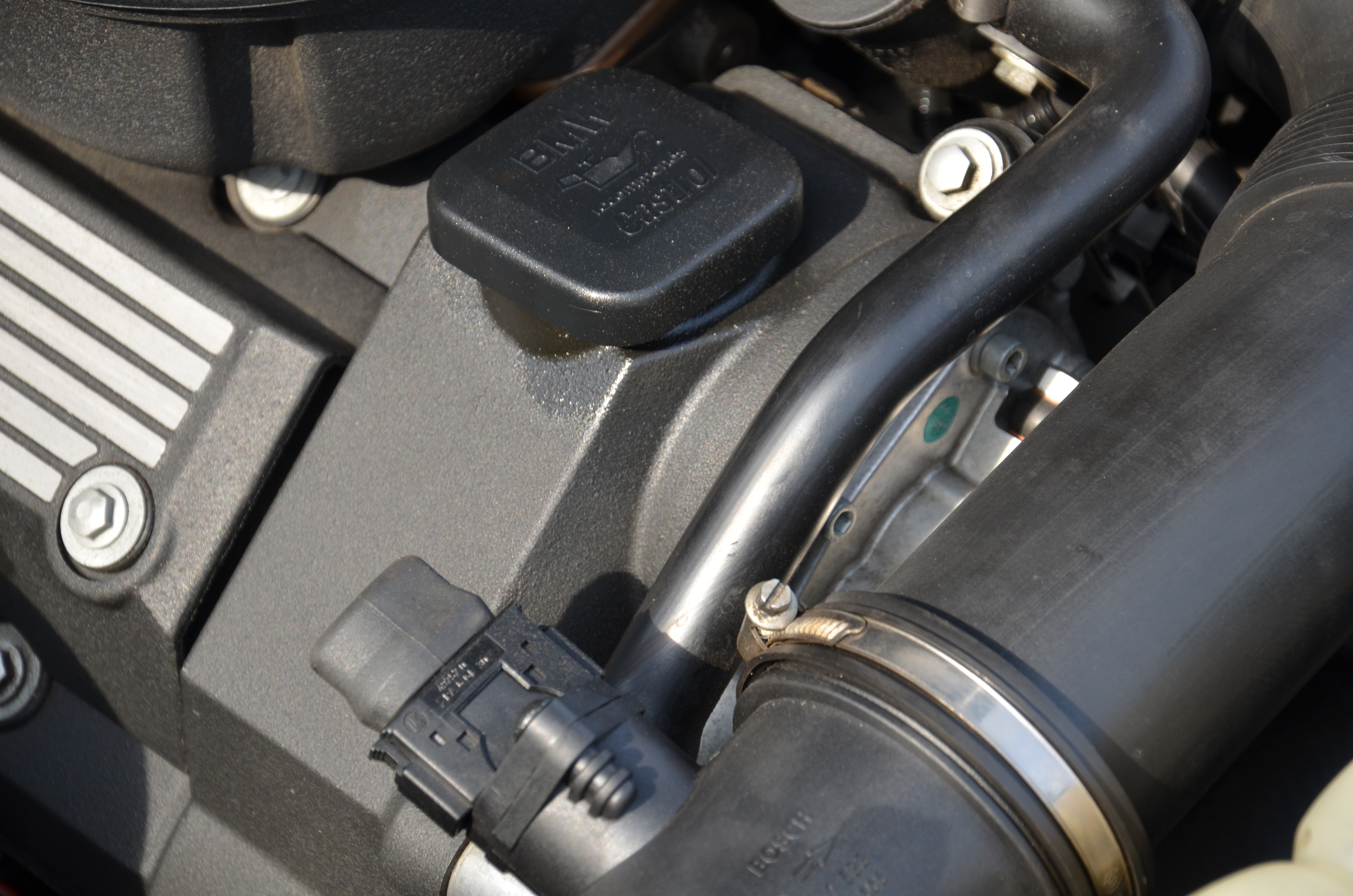

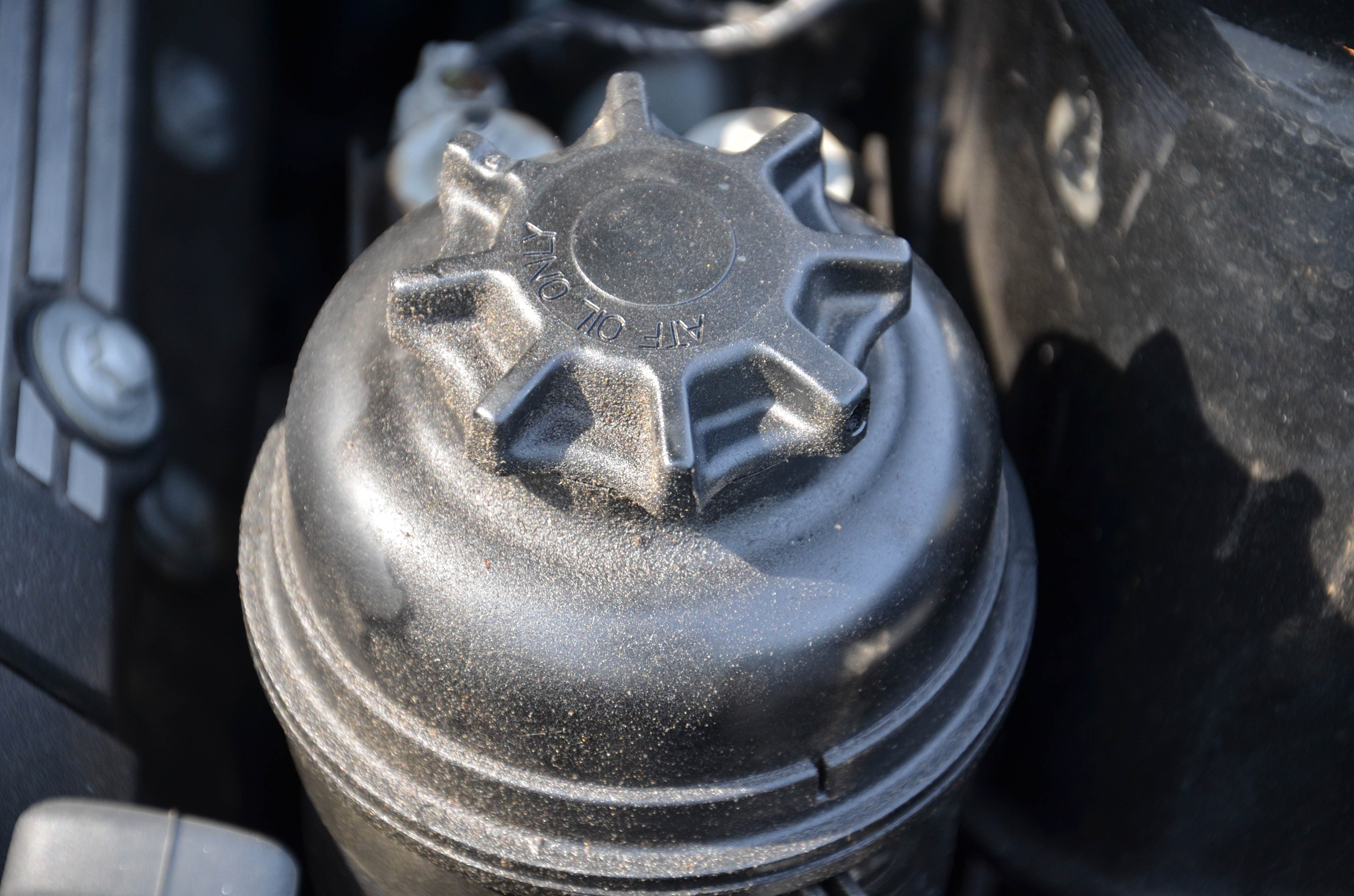

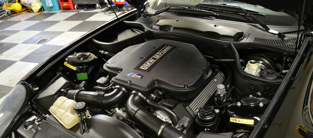

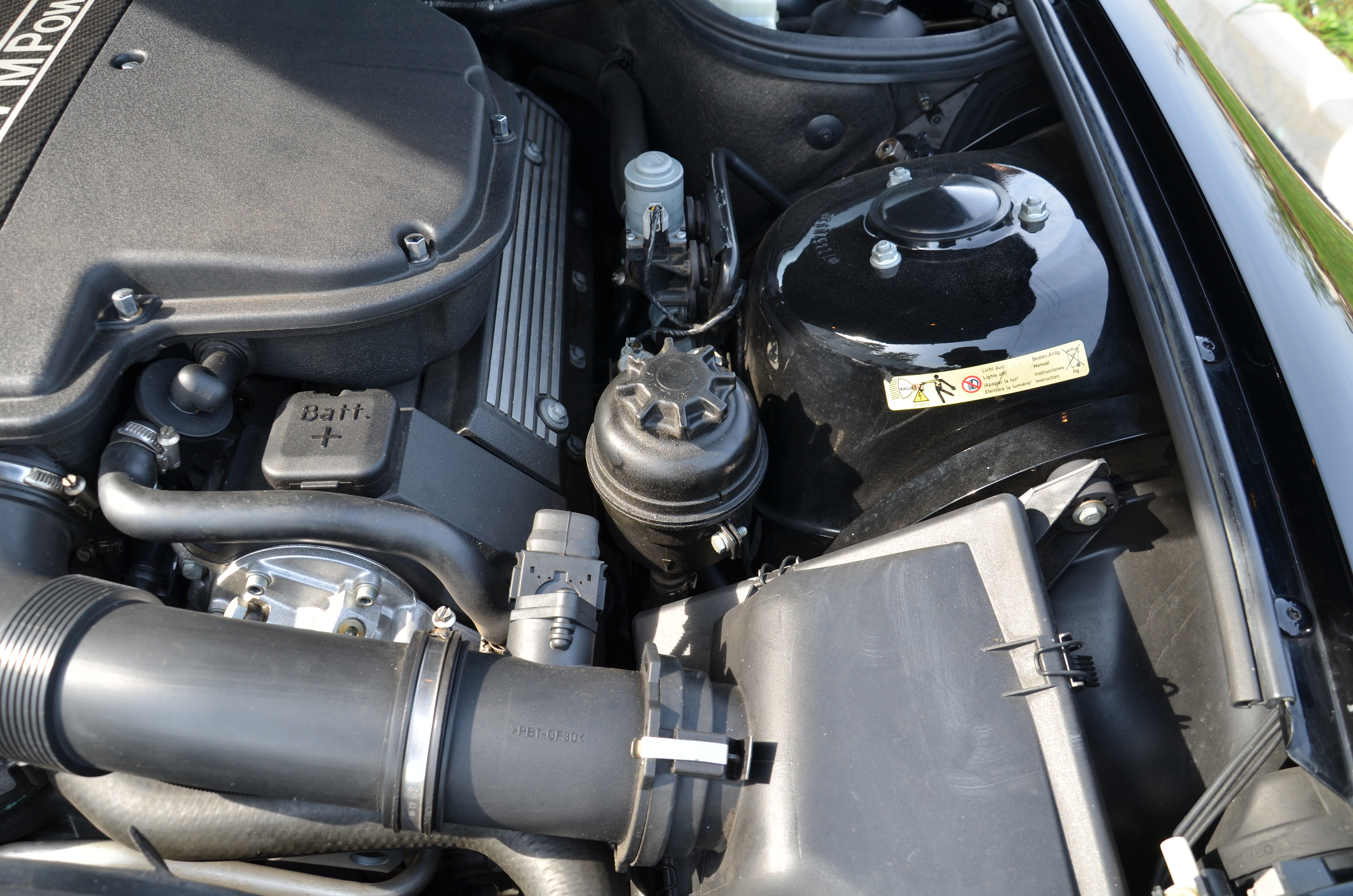

Before engine

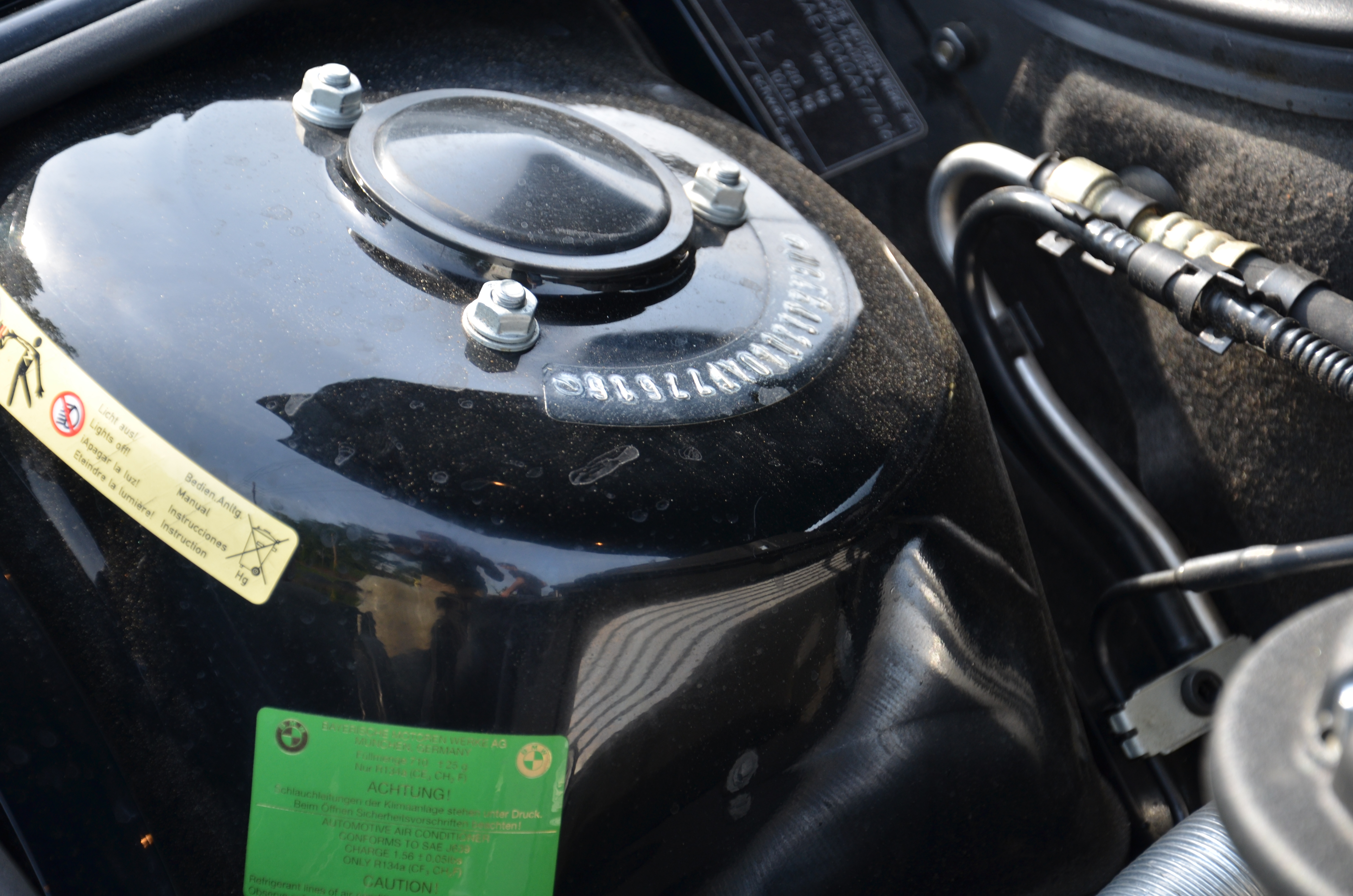

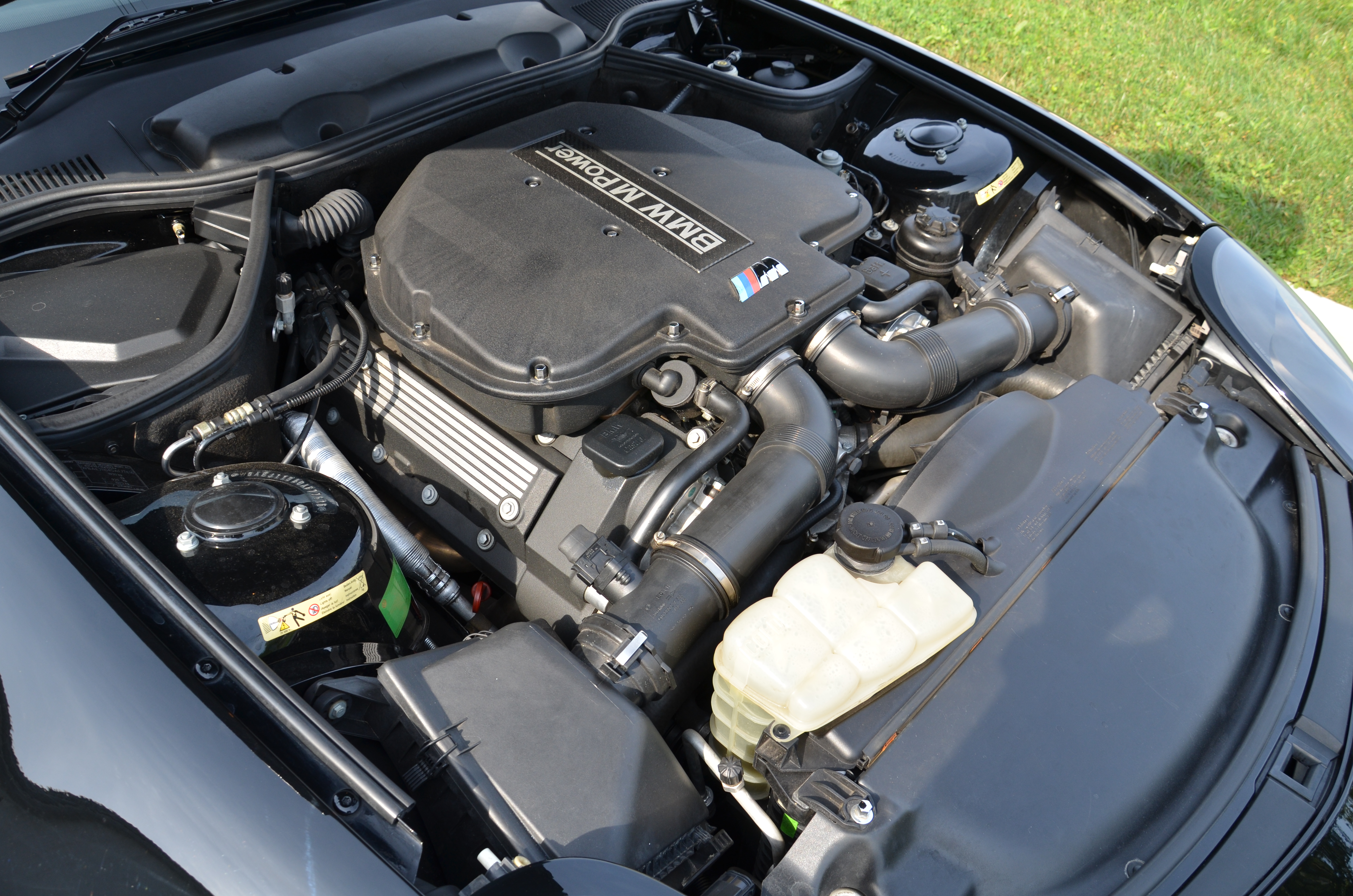

After engine

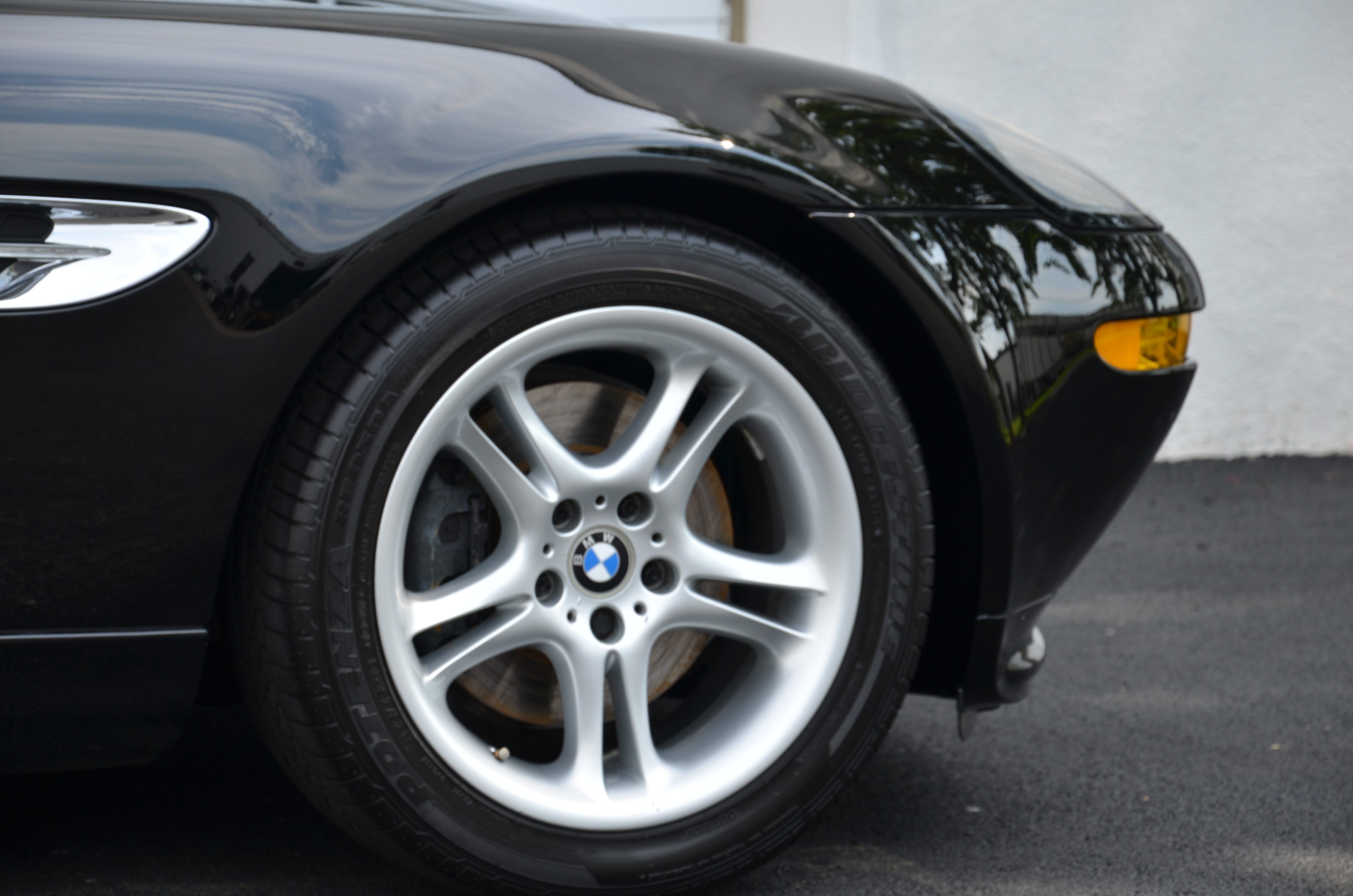

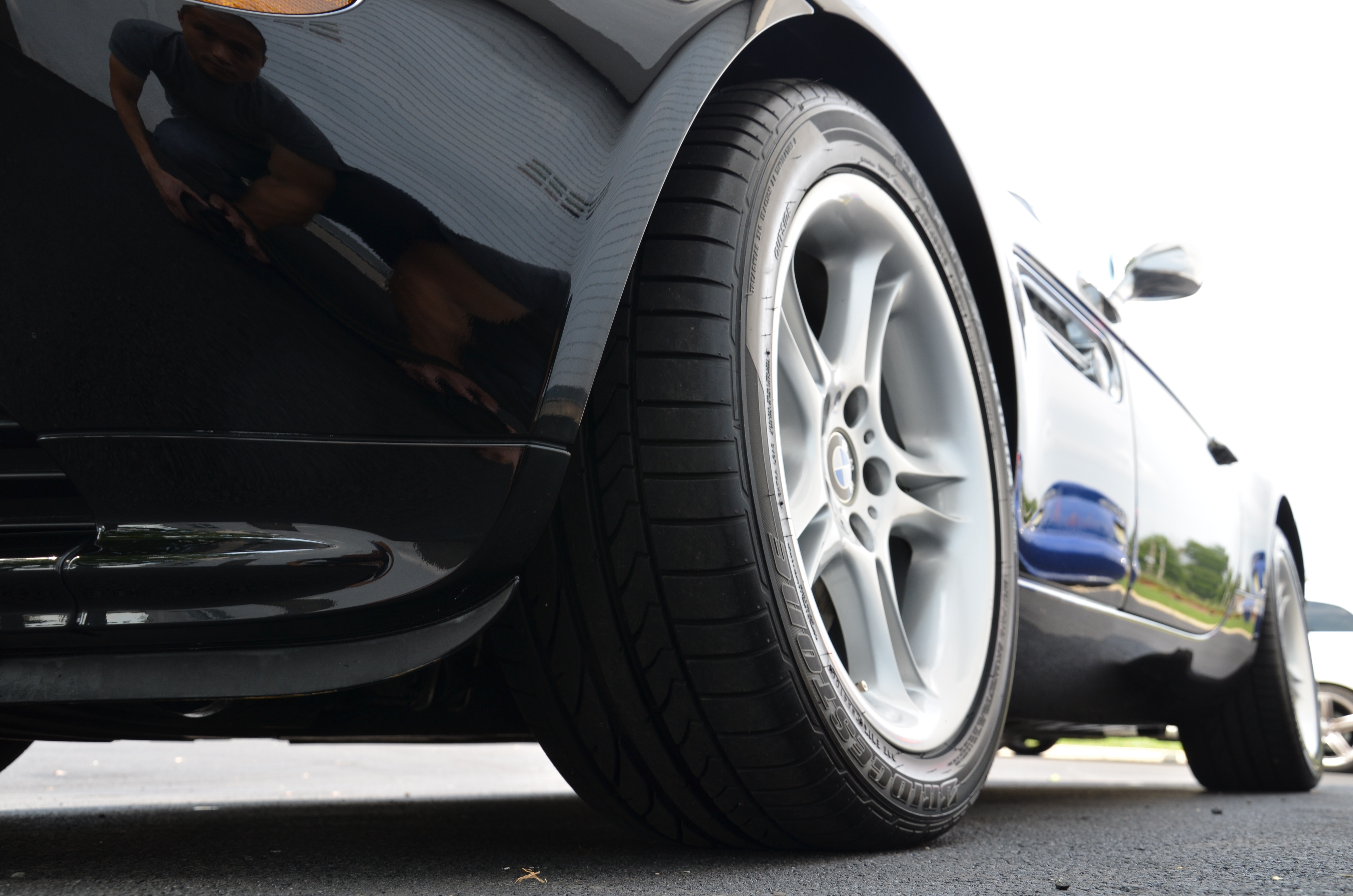

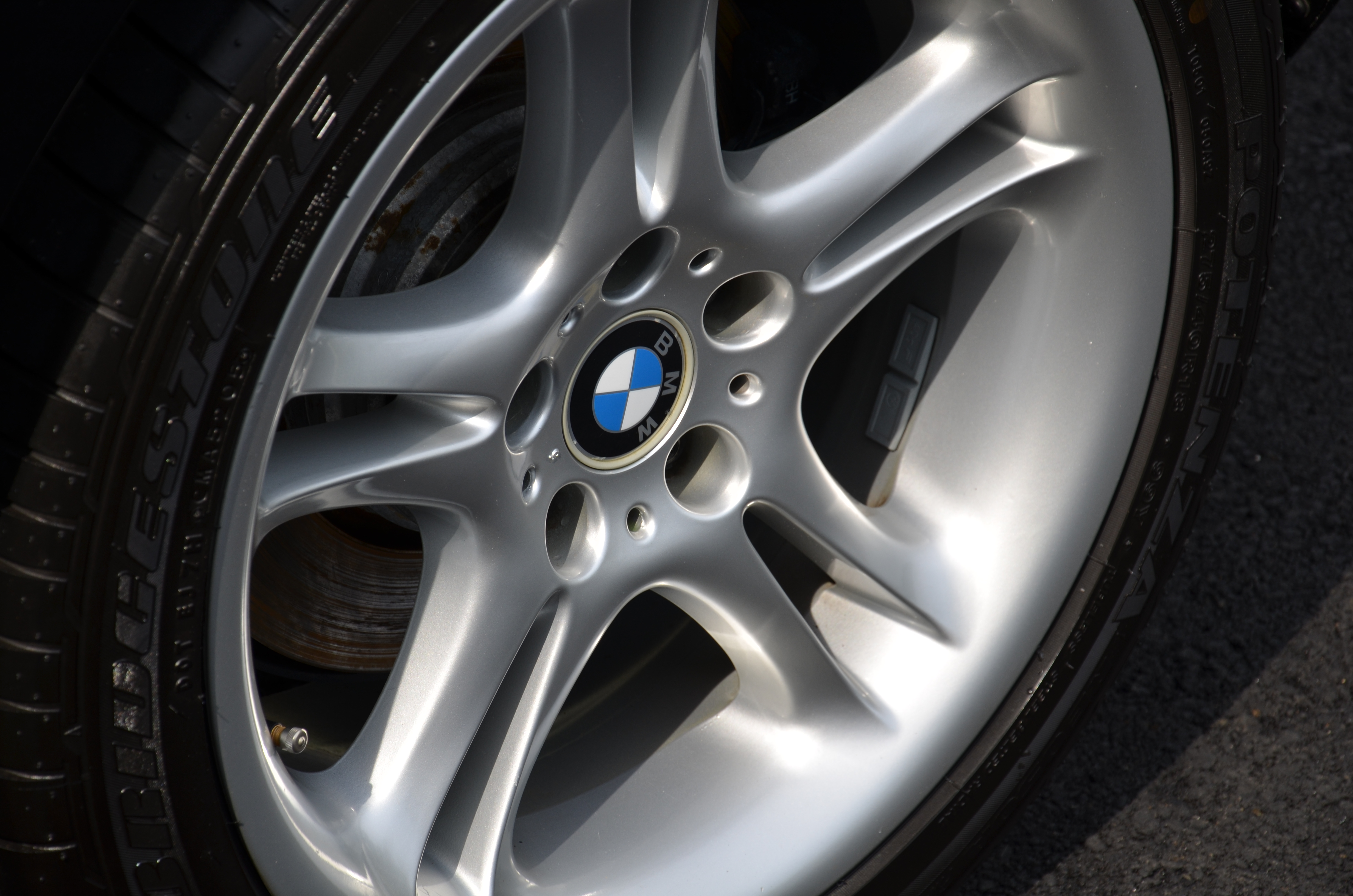

Wolf's Rim Shield used on the wheels

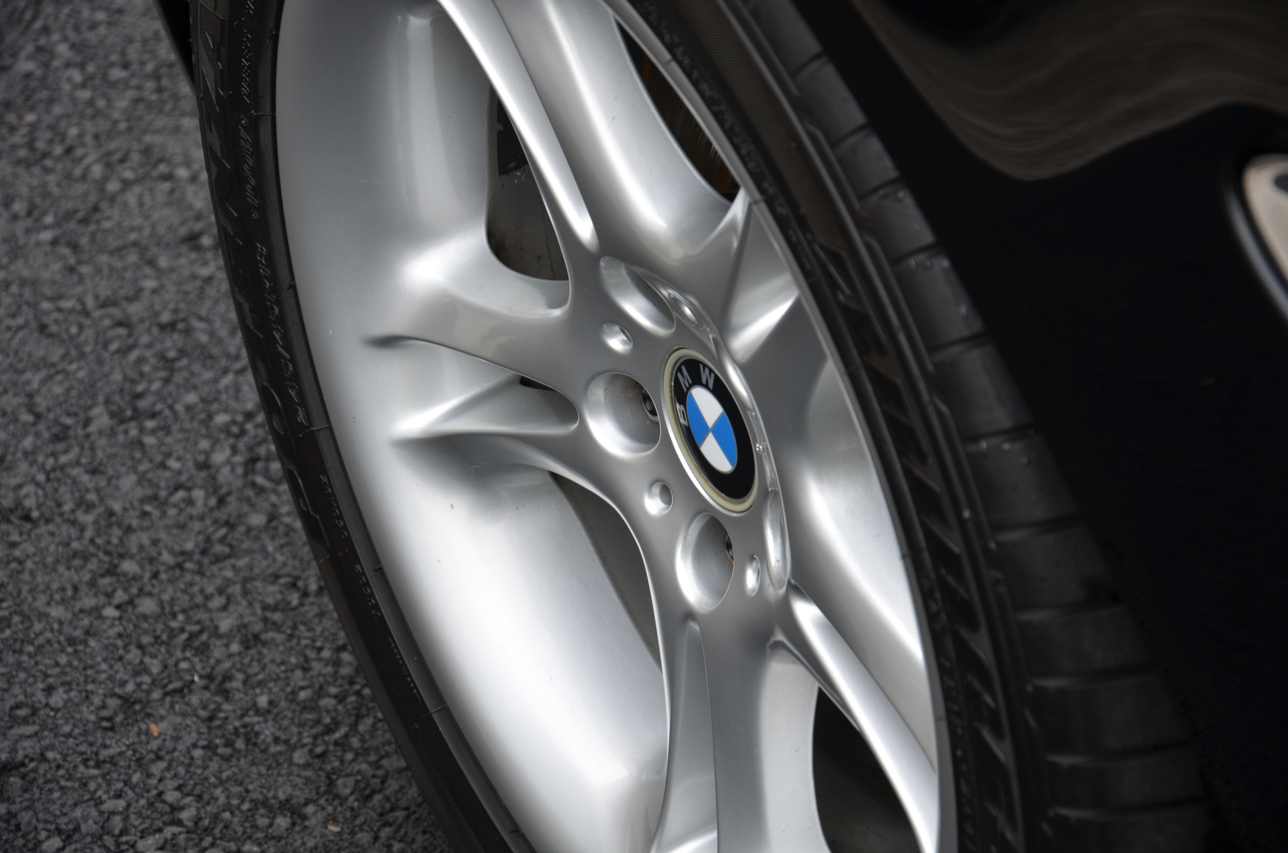

Wheels and Tires all done

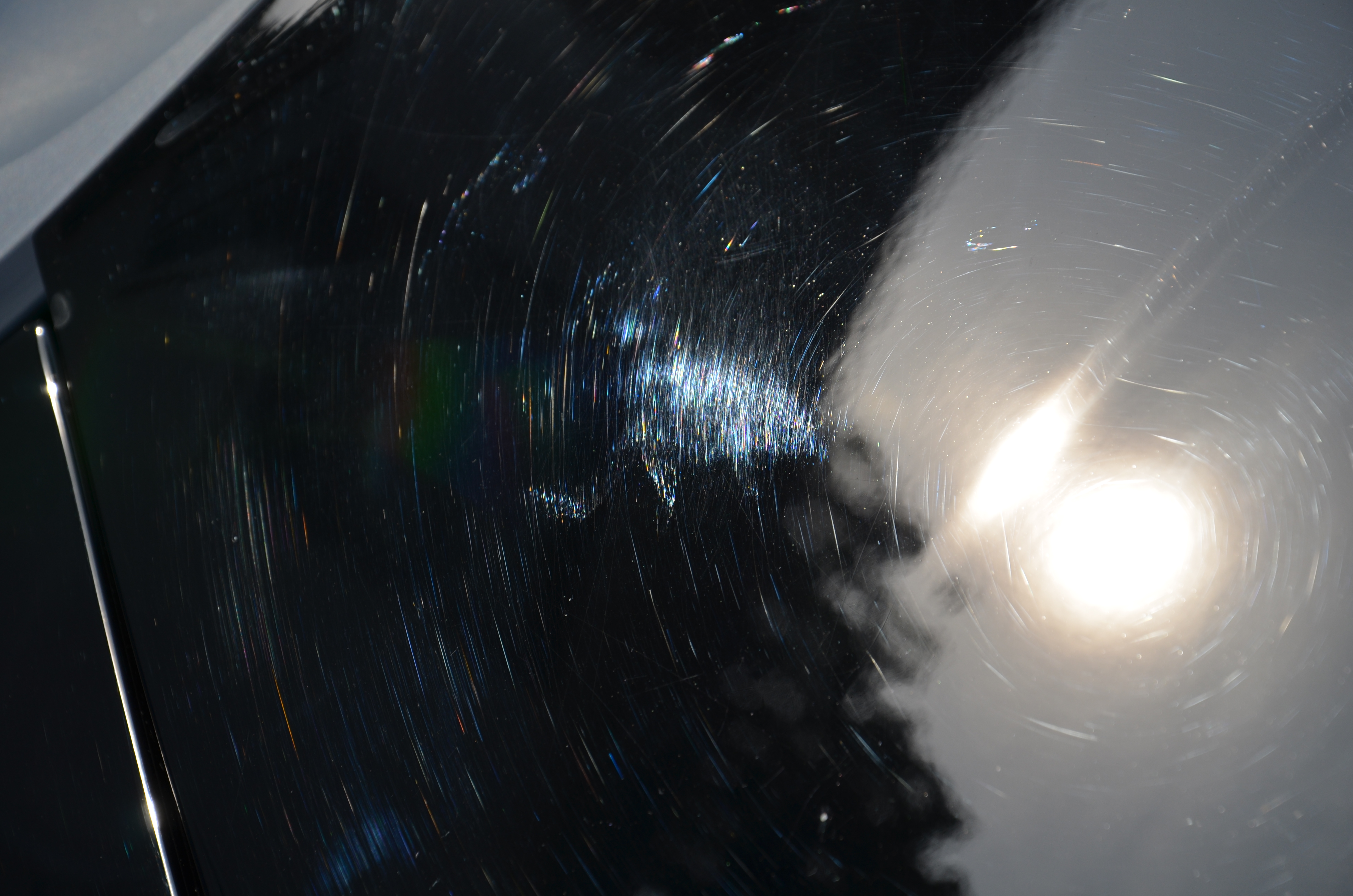

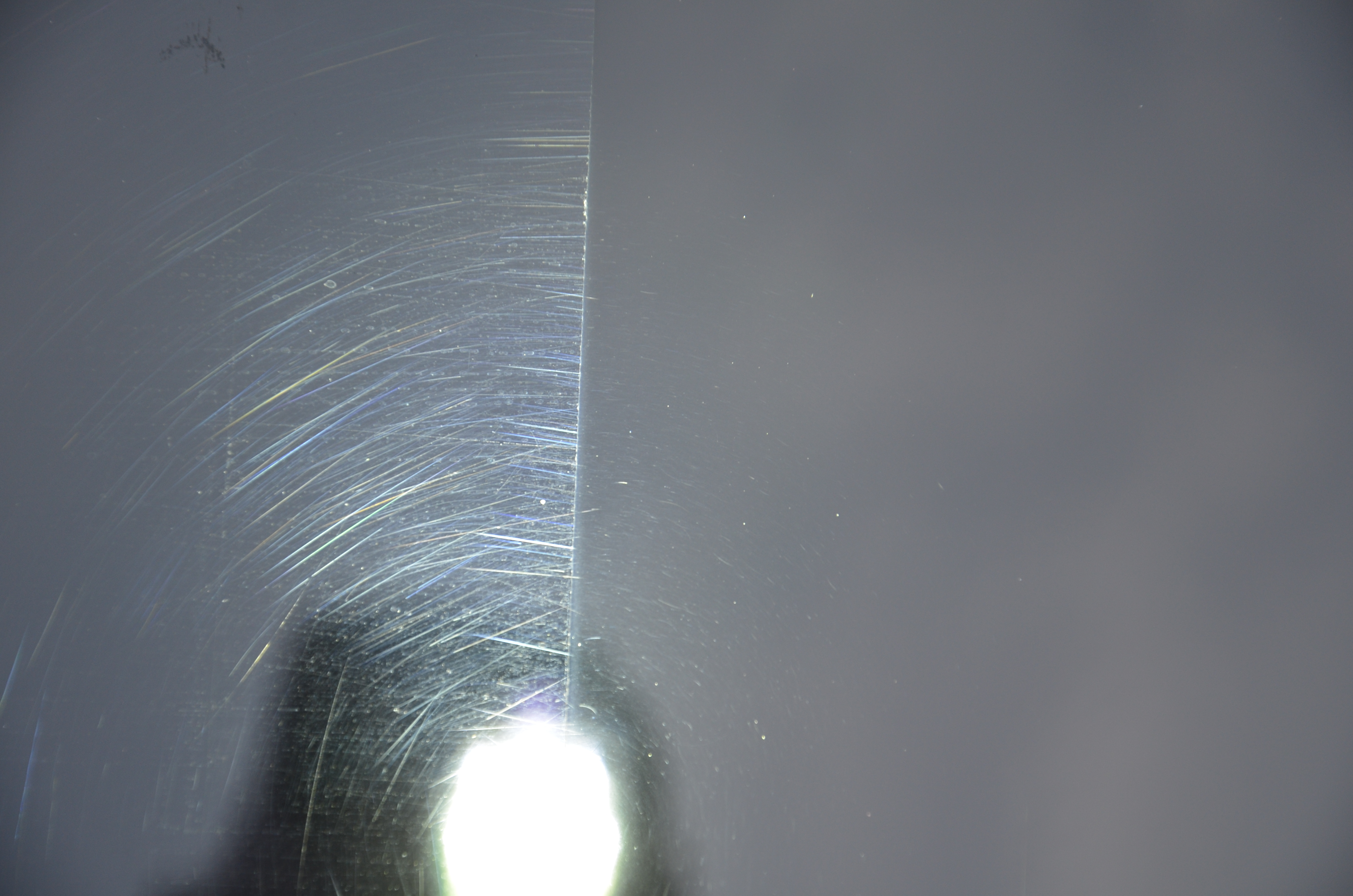

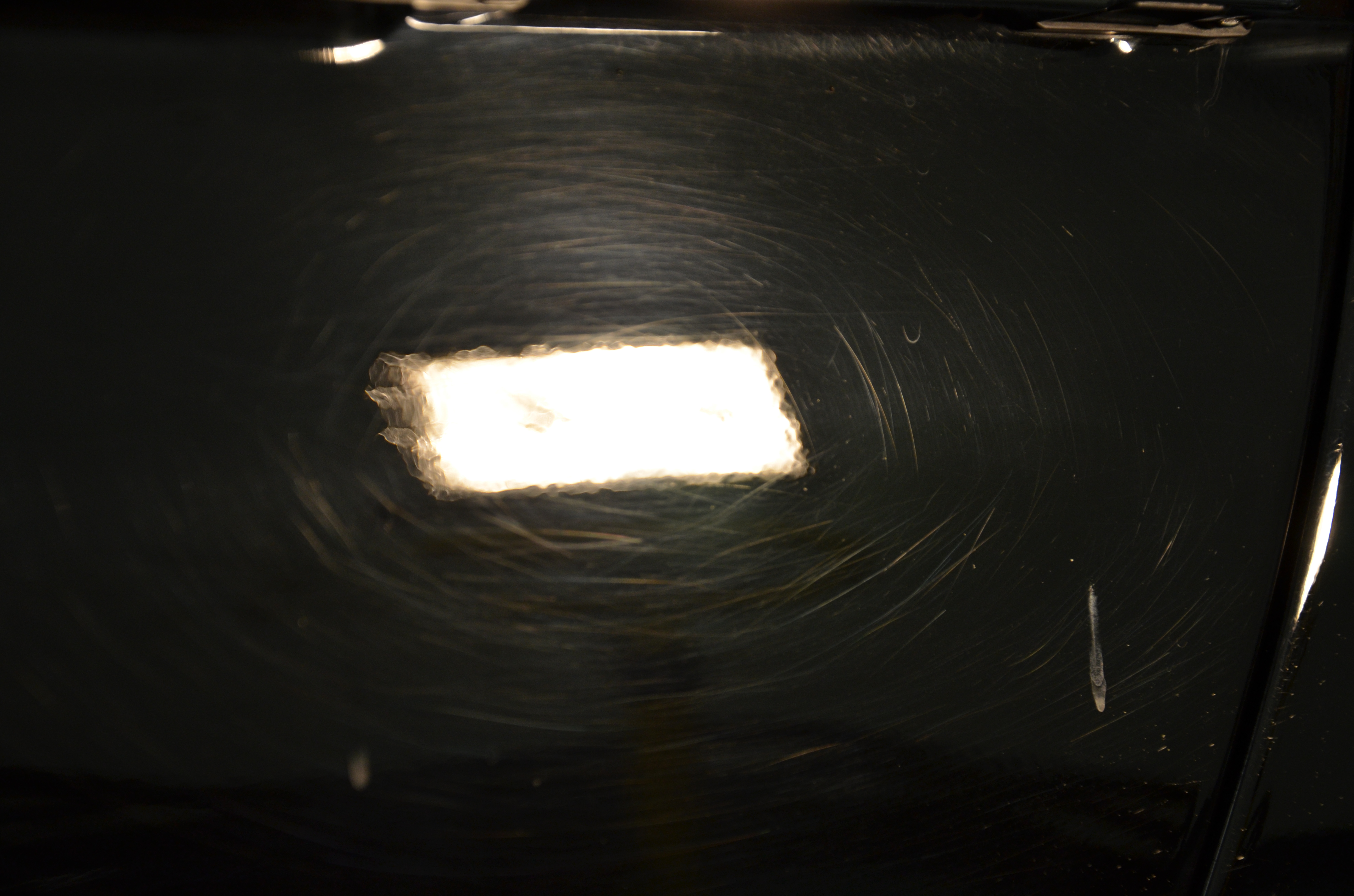

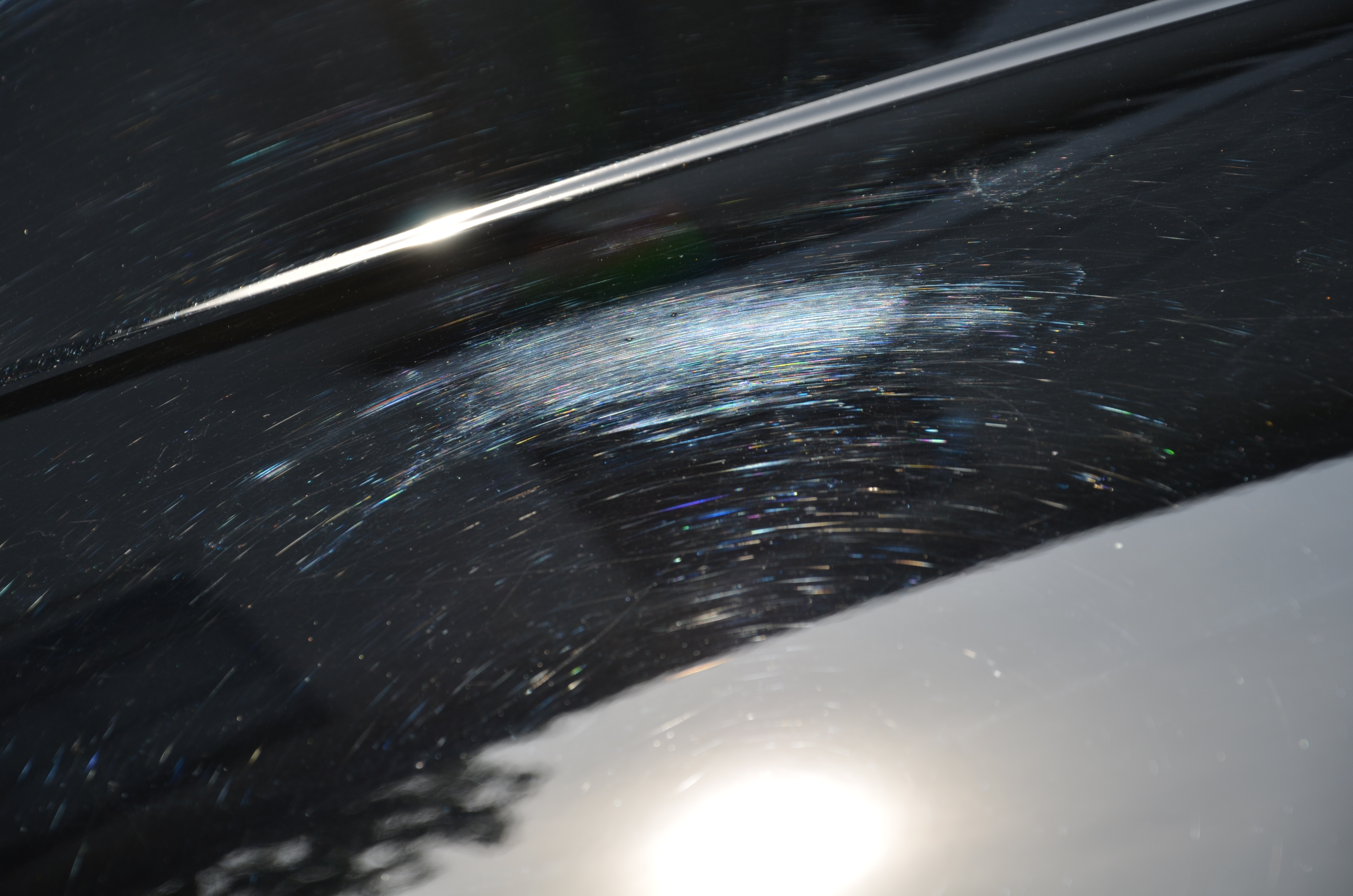

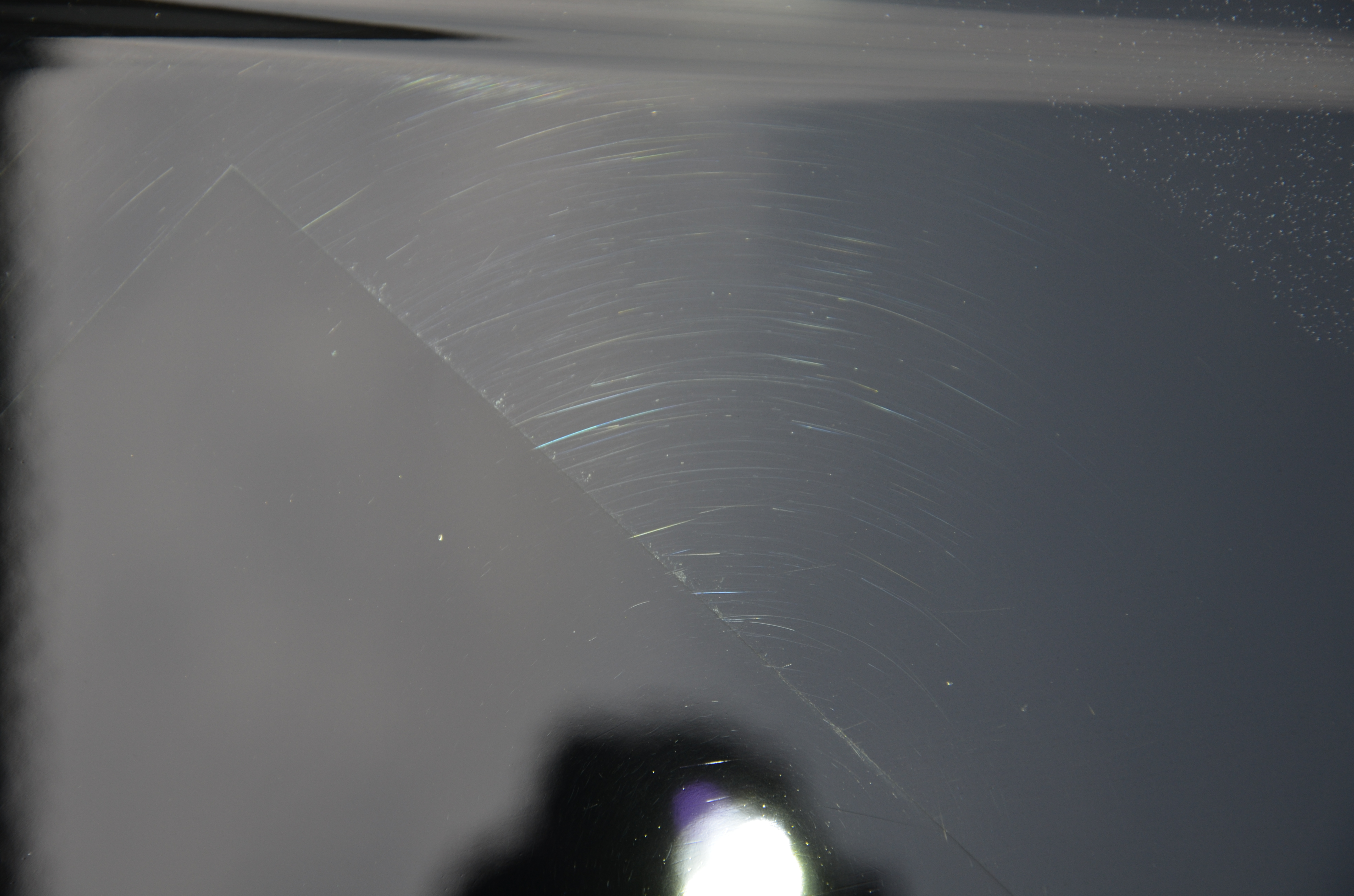

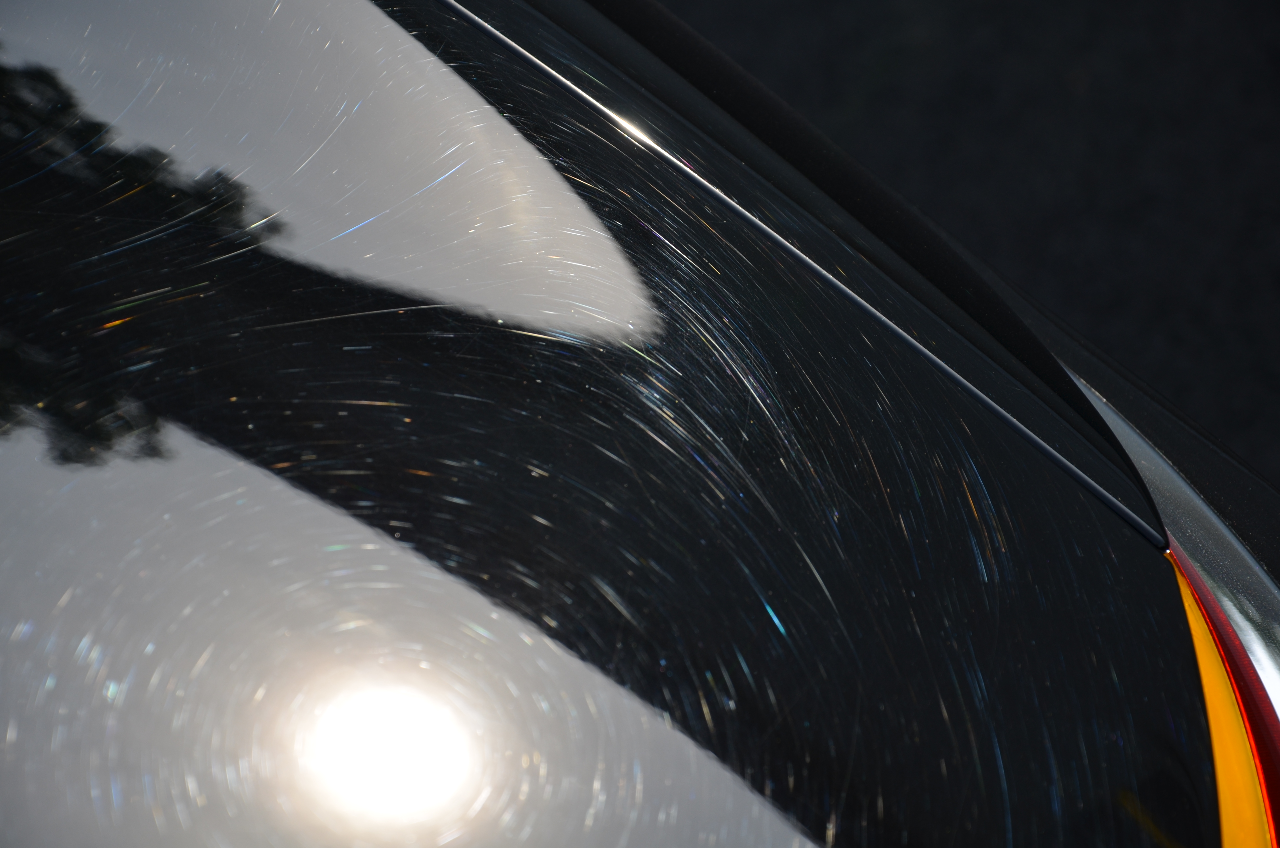

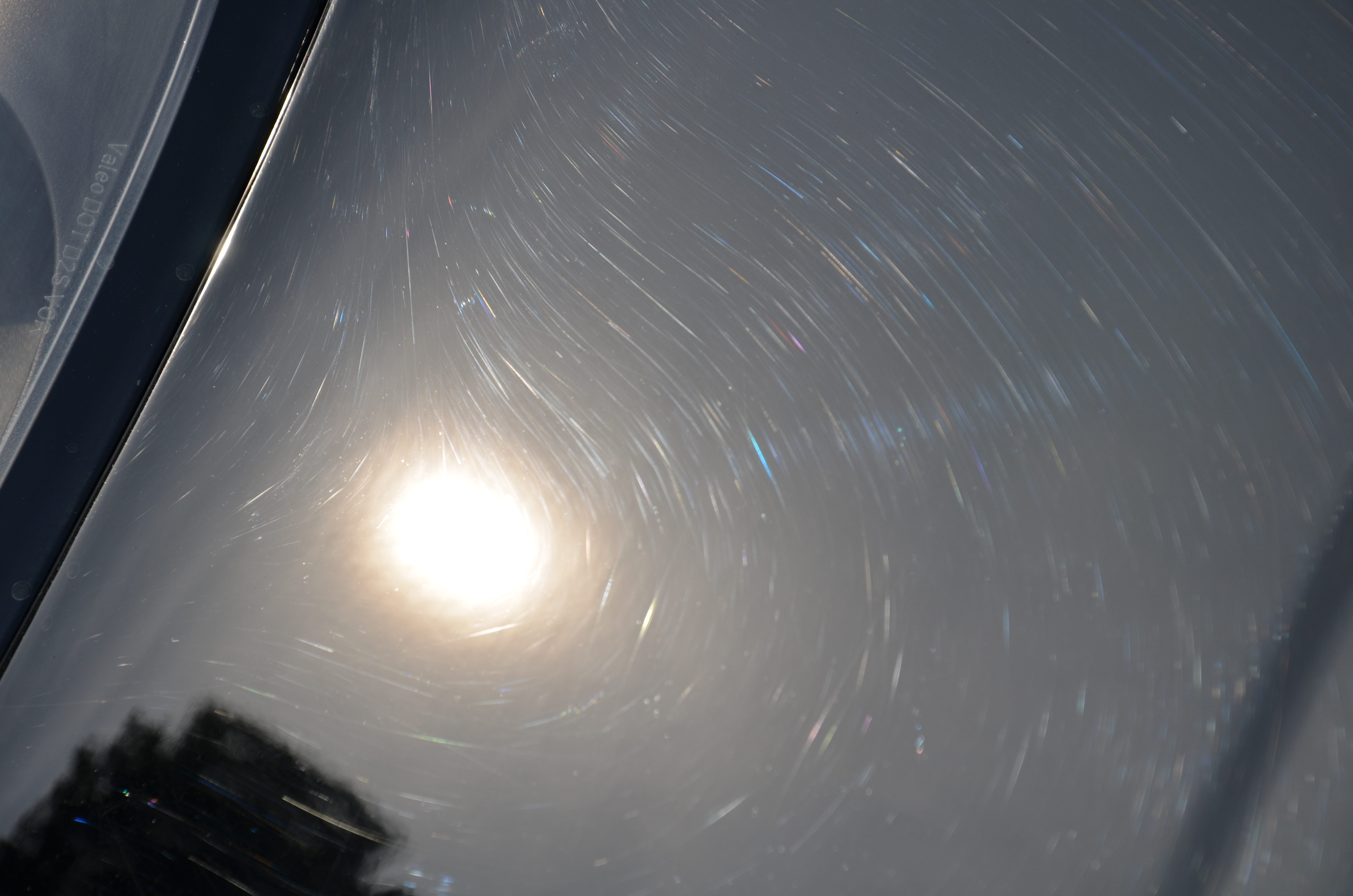

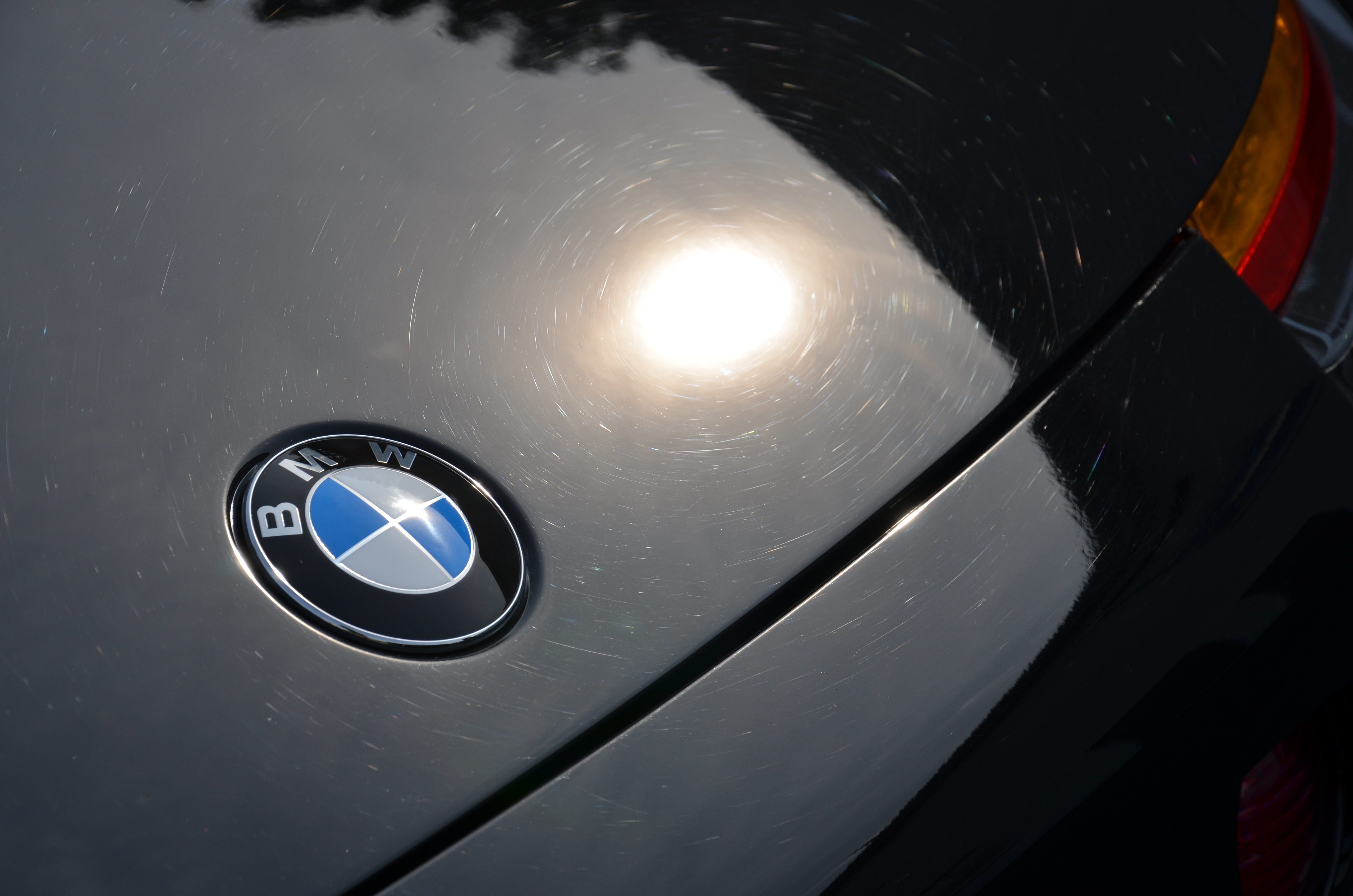

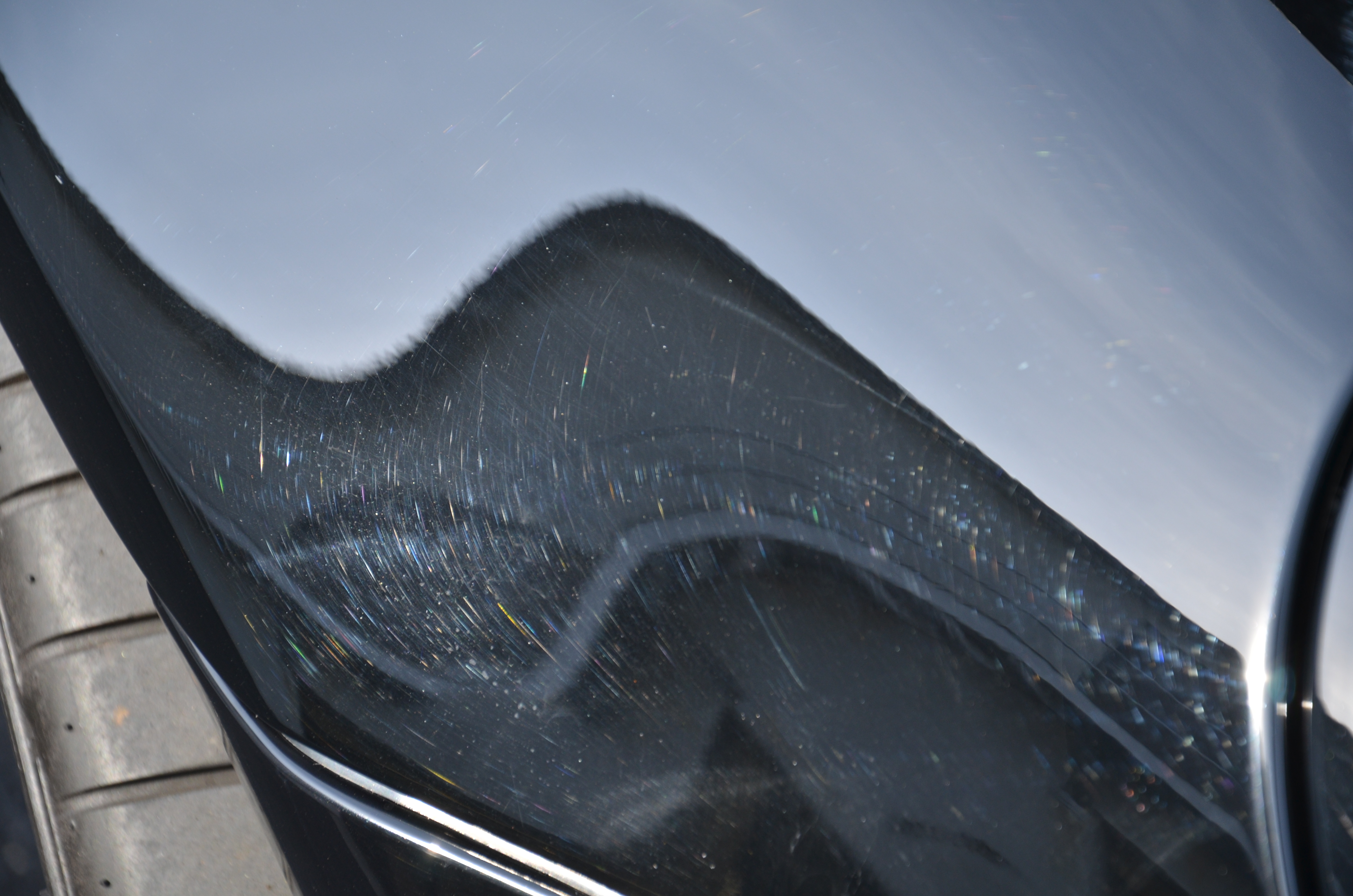

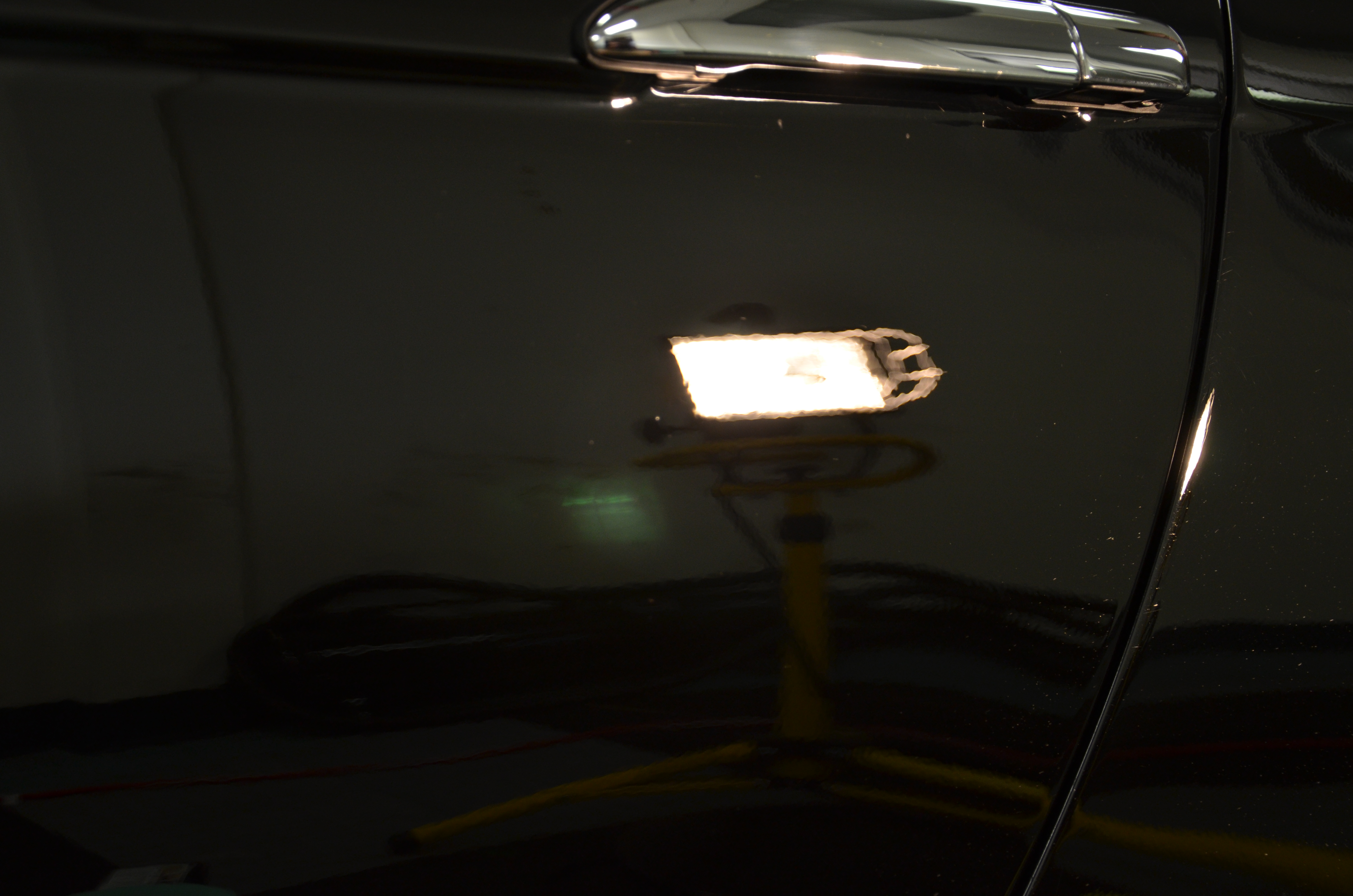

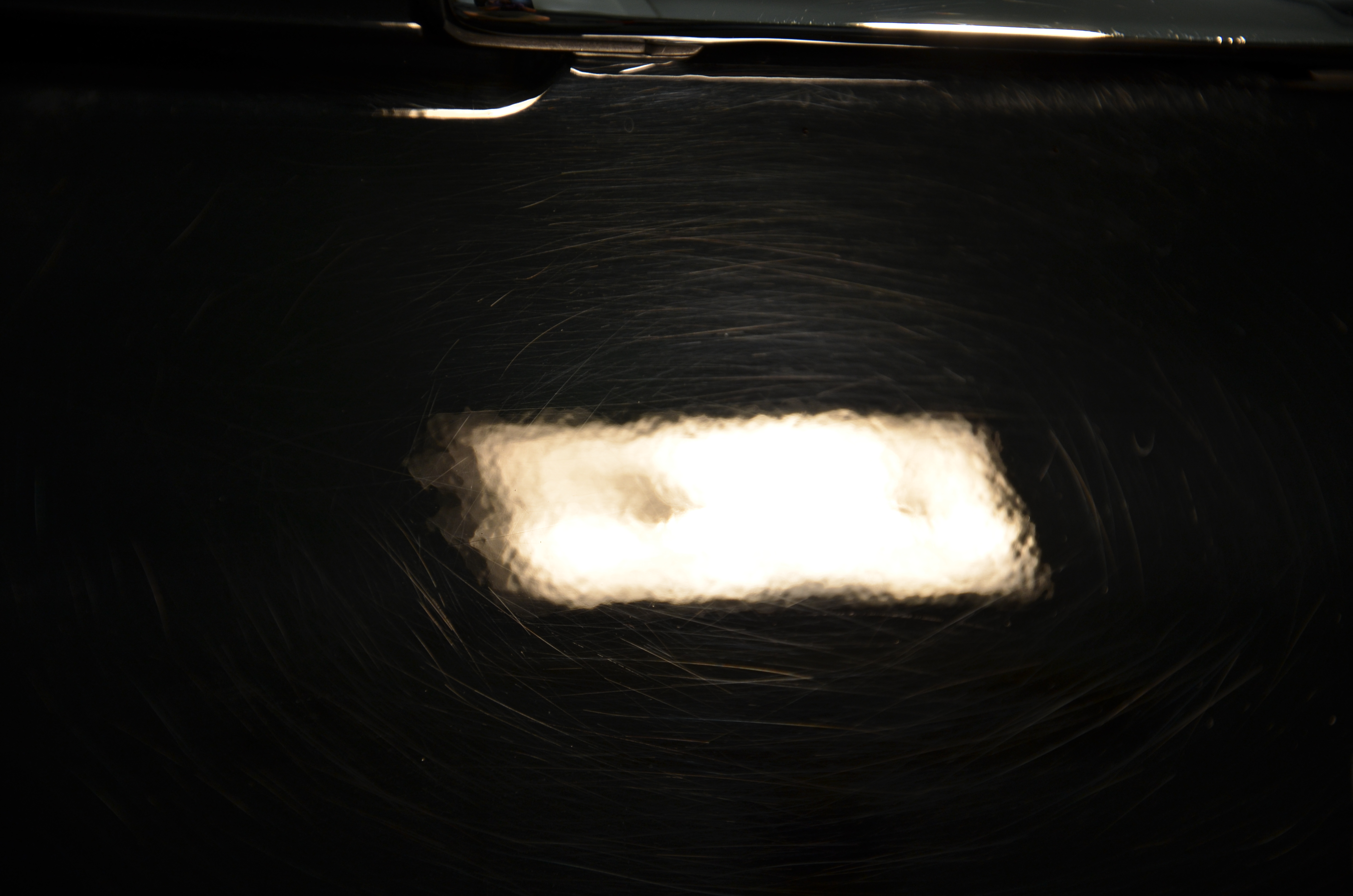

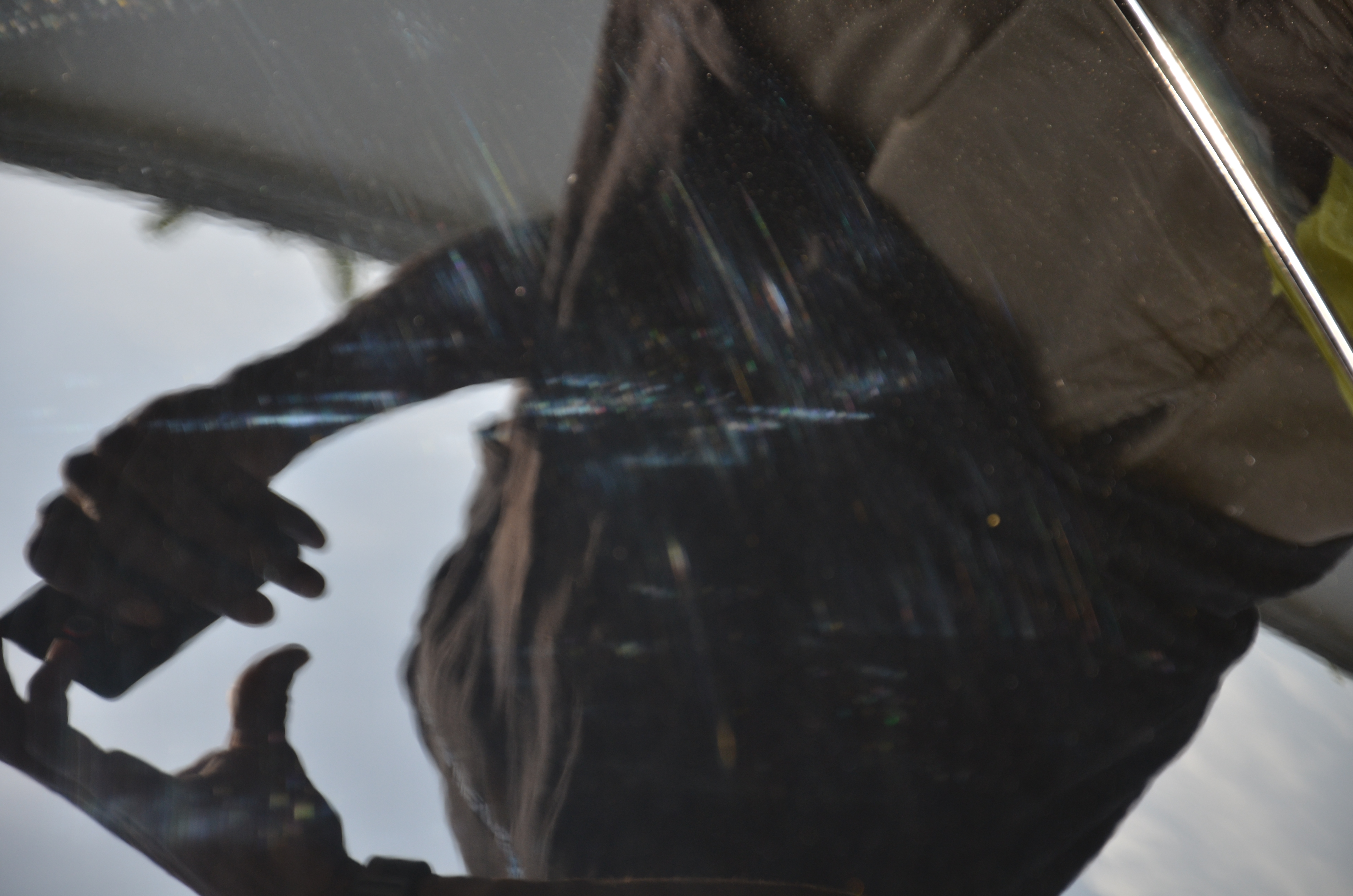

Imperfections that we were up against

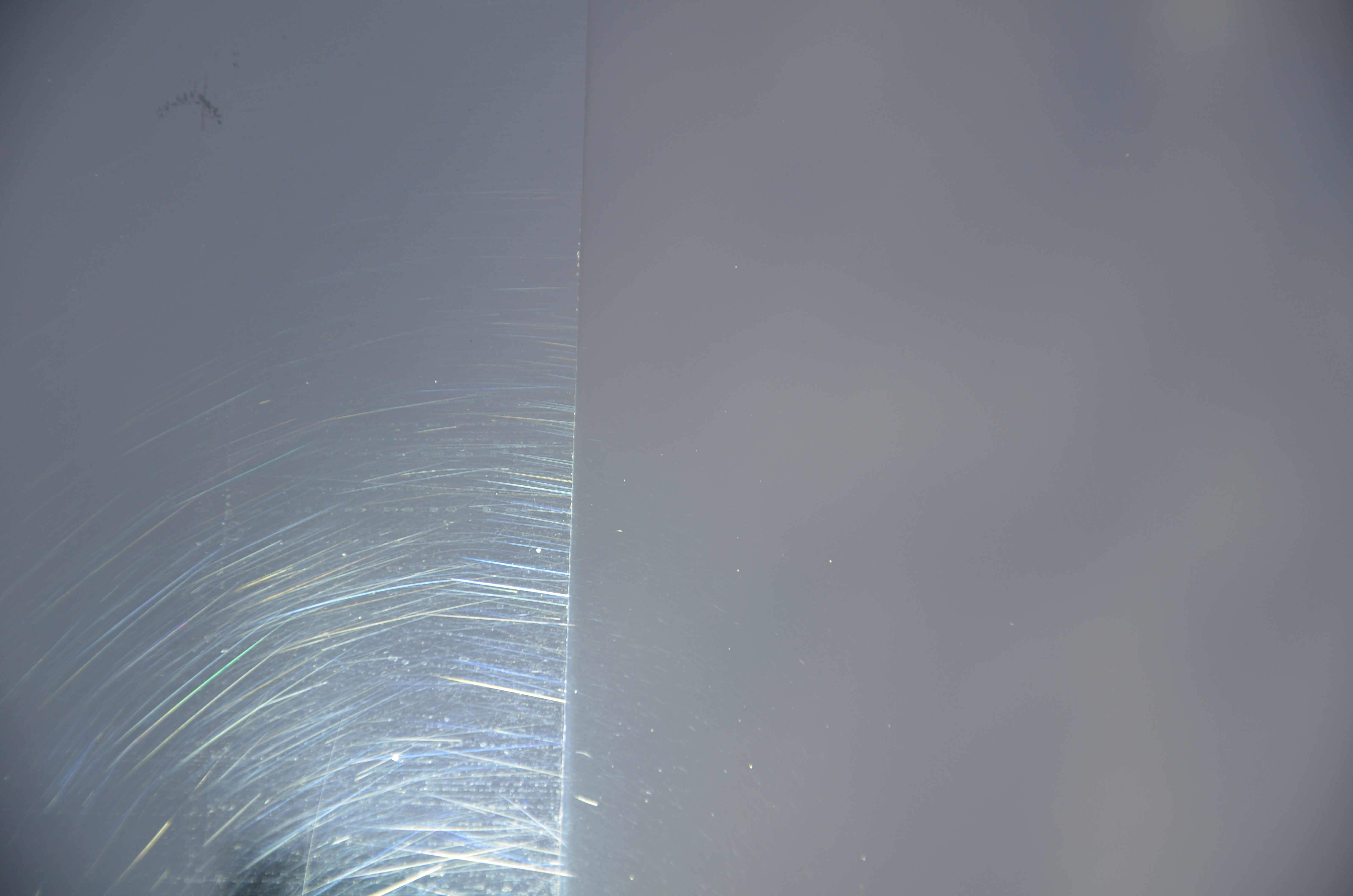

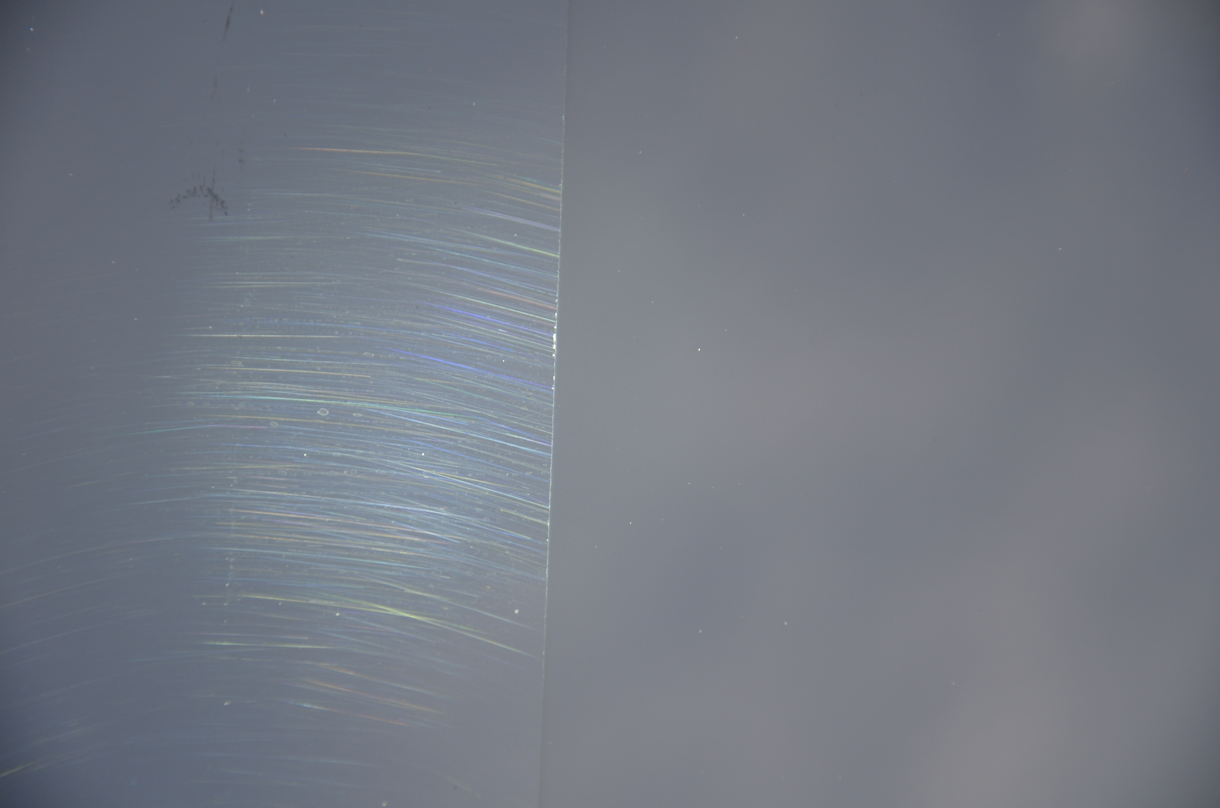

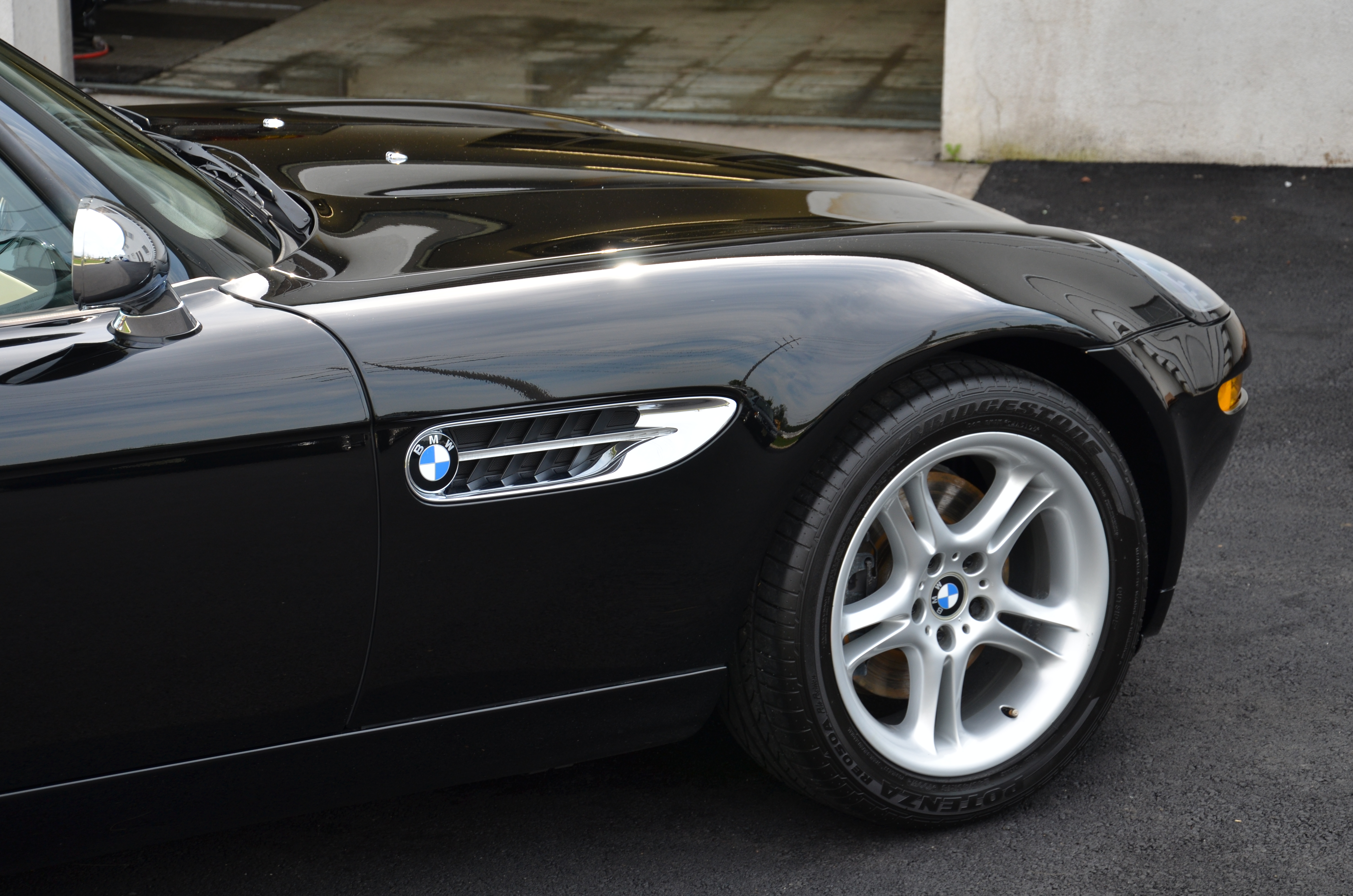

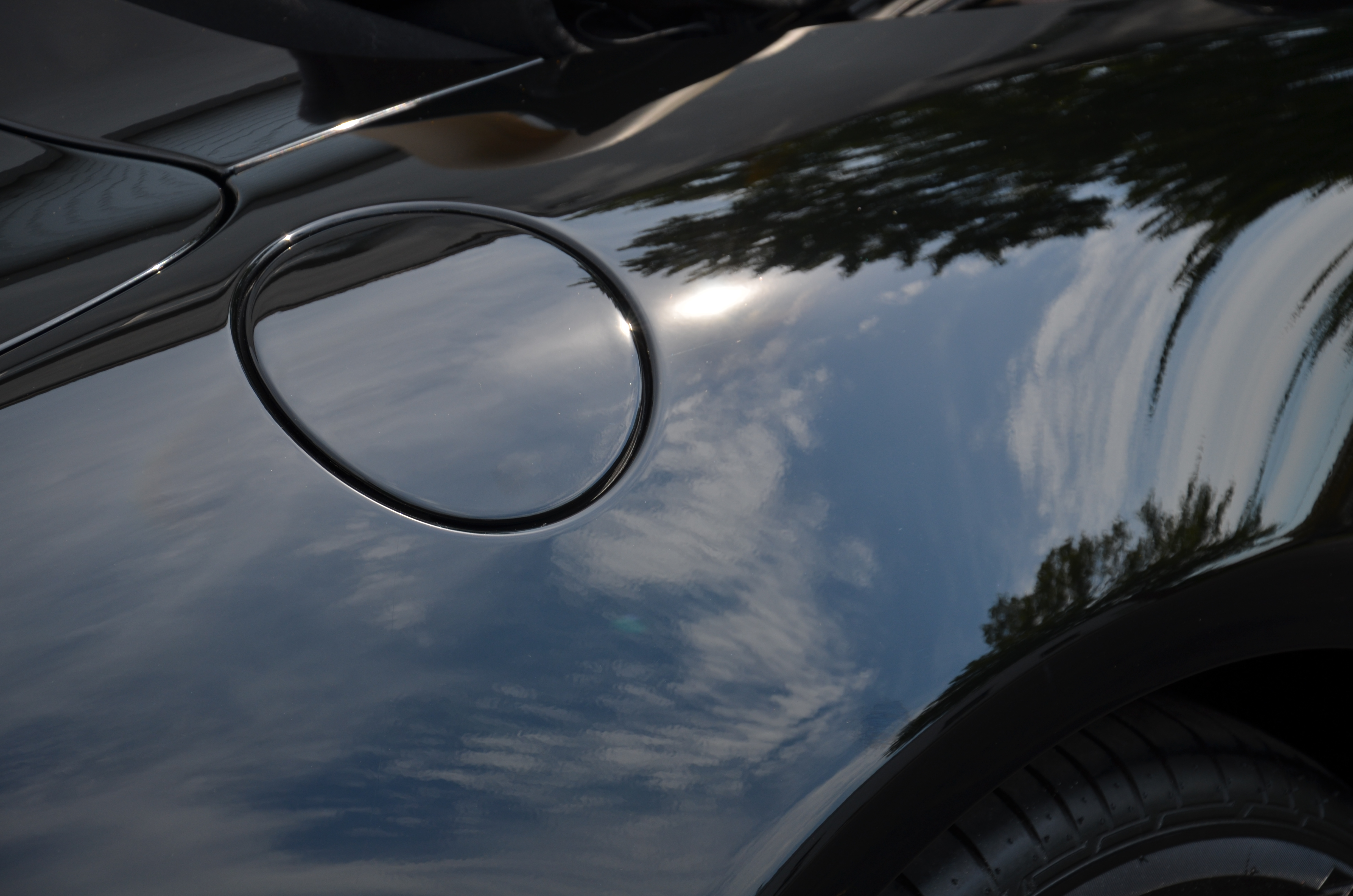

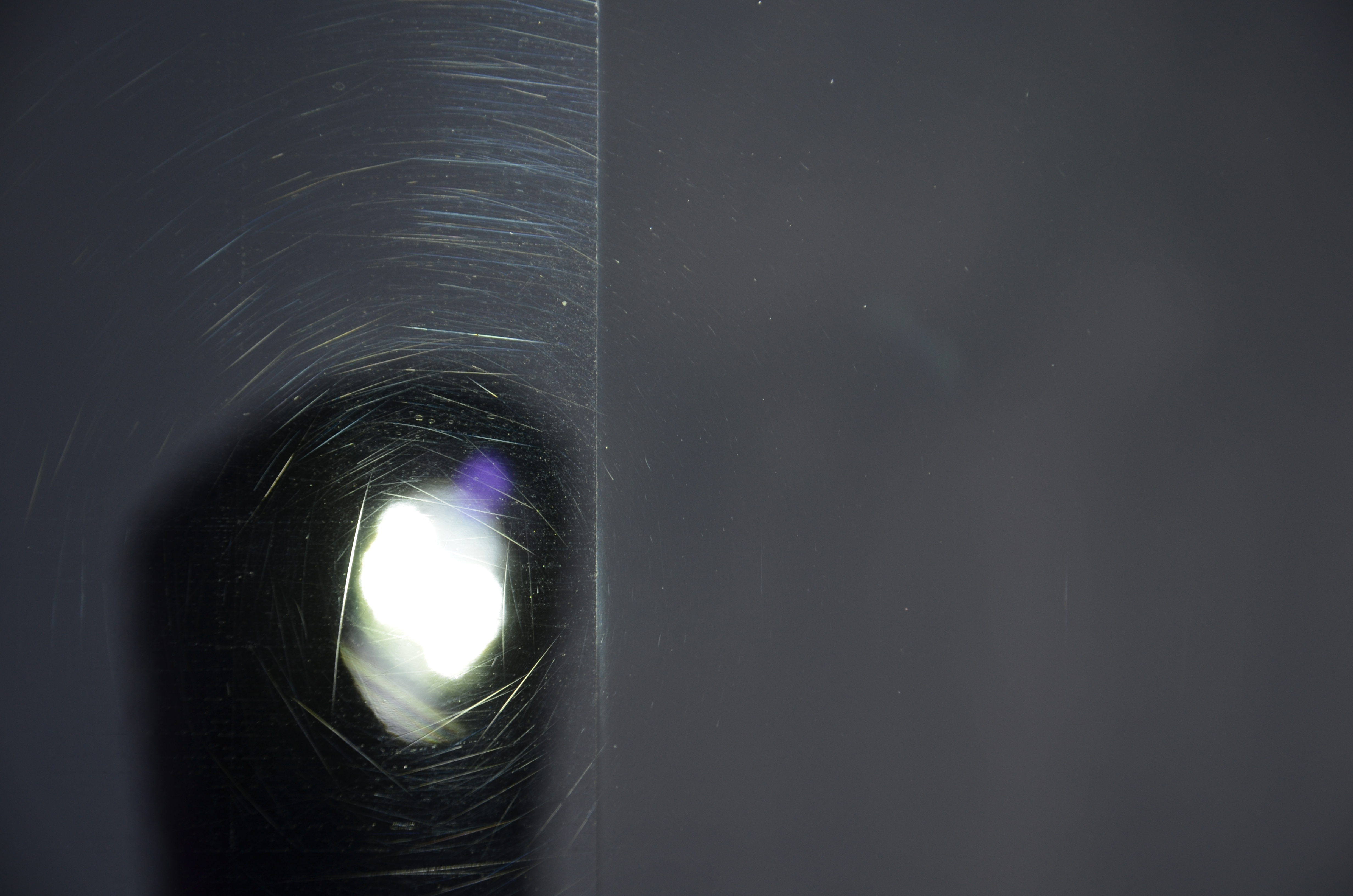

Compound and Polish -
50/50 shots
This was after compounding (various panels on the car)

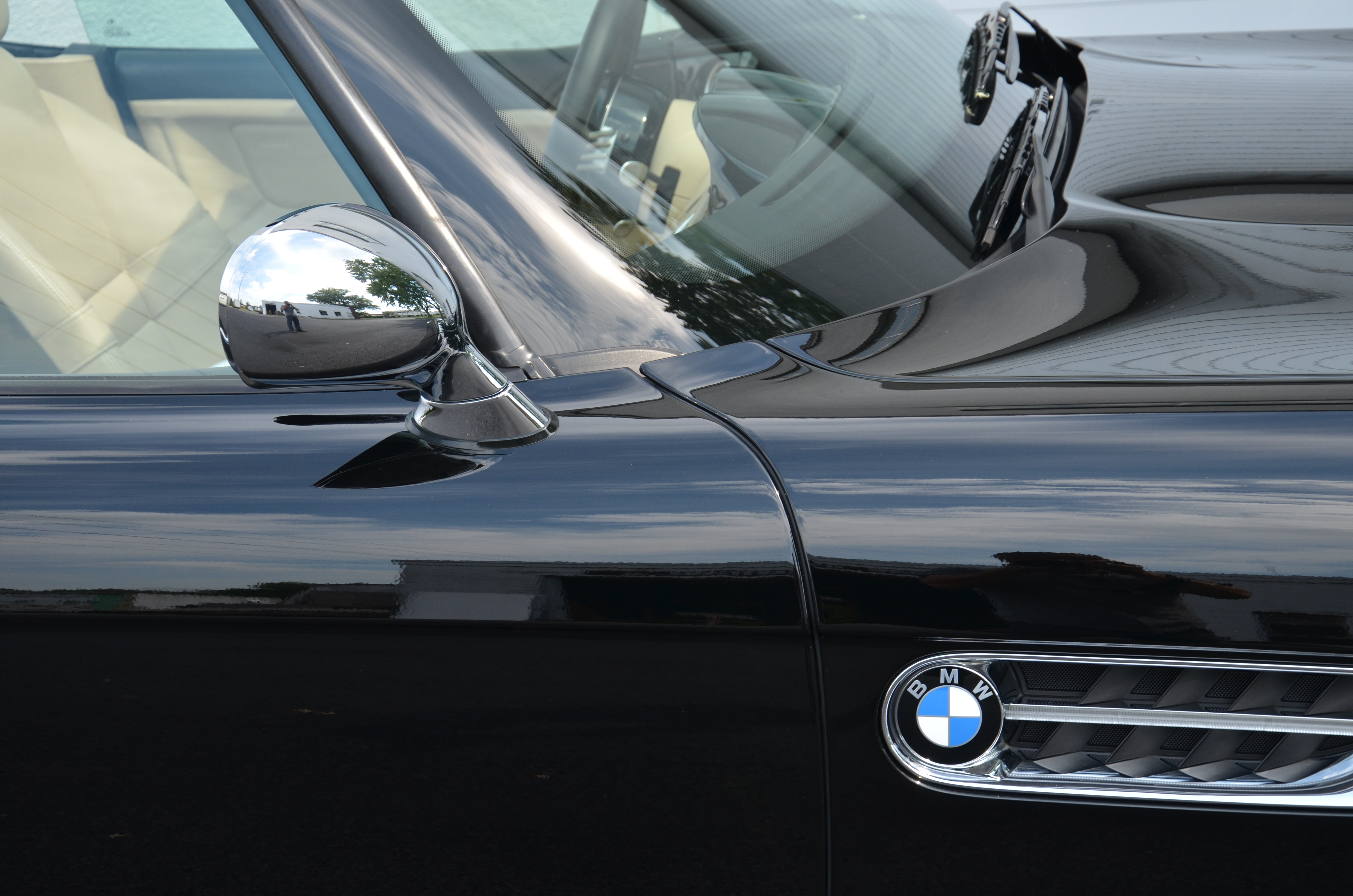

After

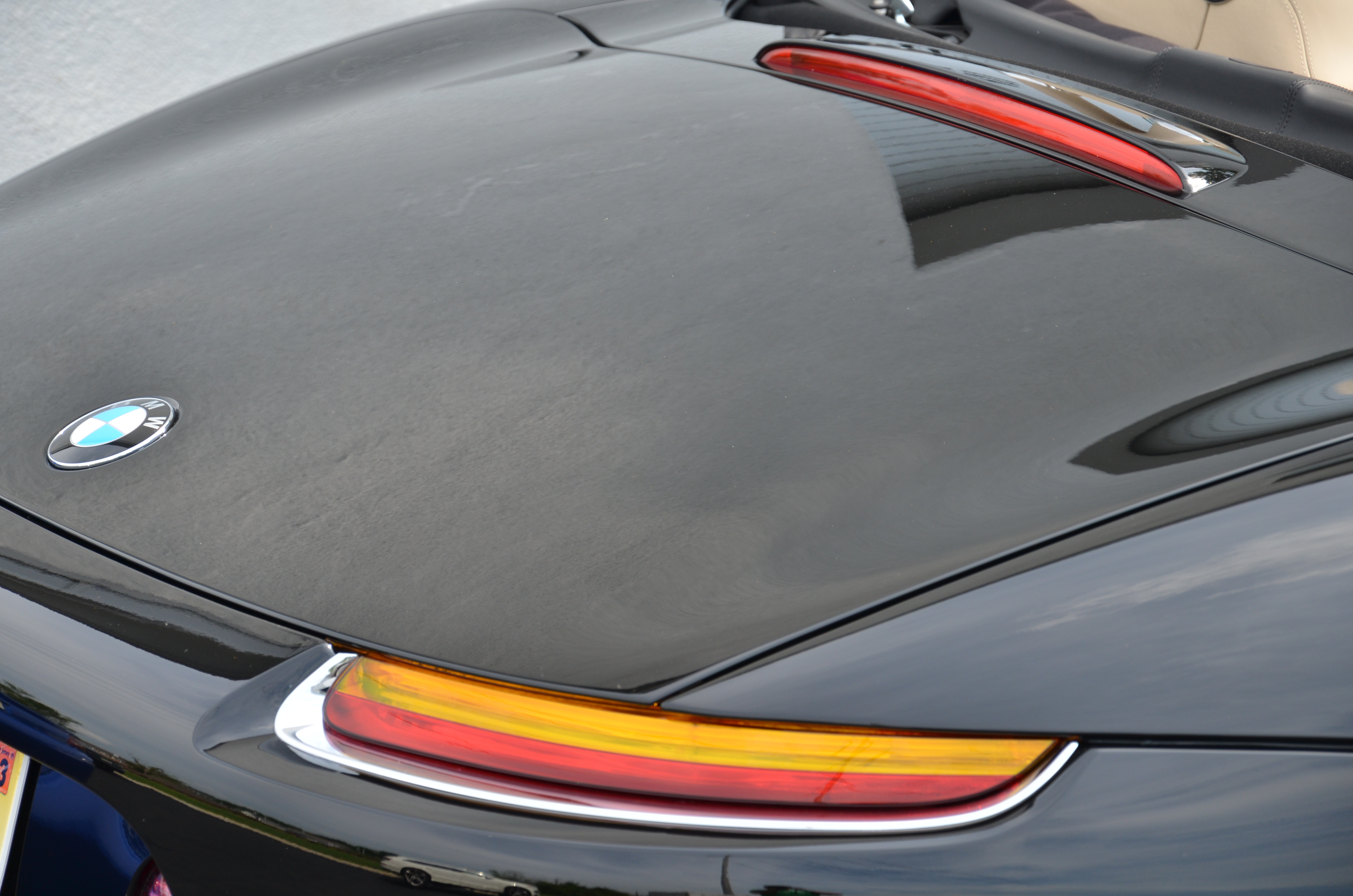

Before

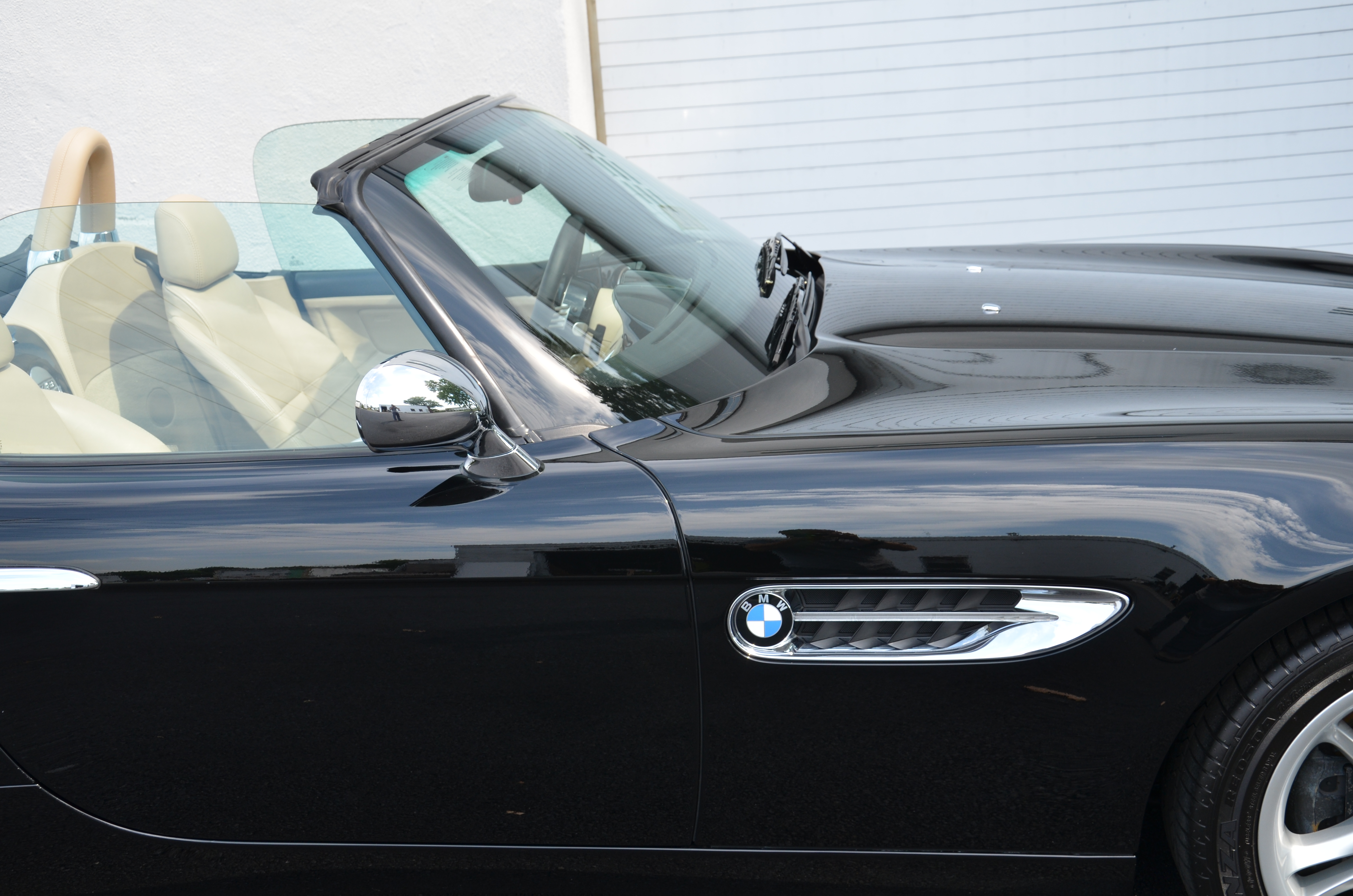

After

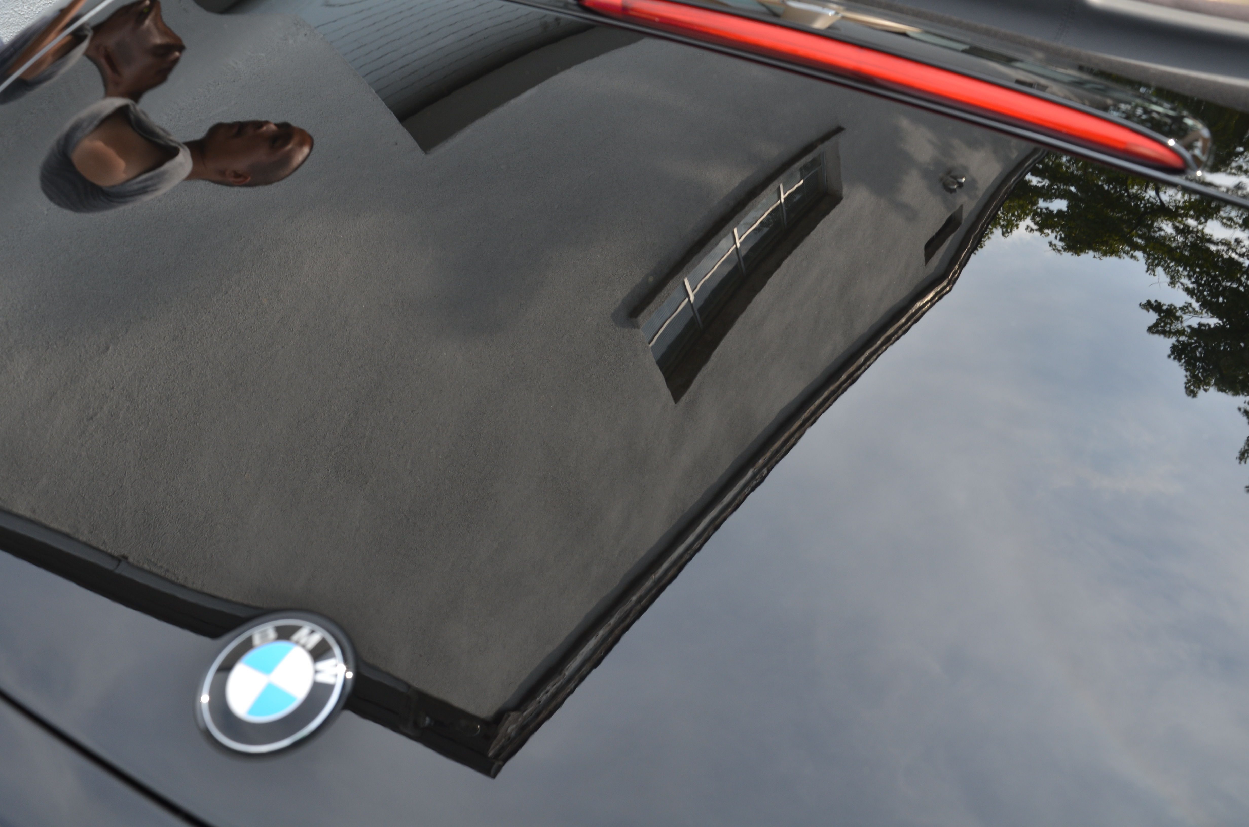

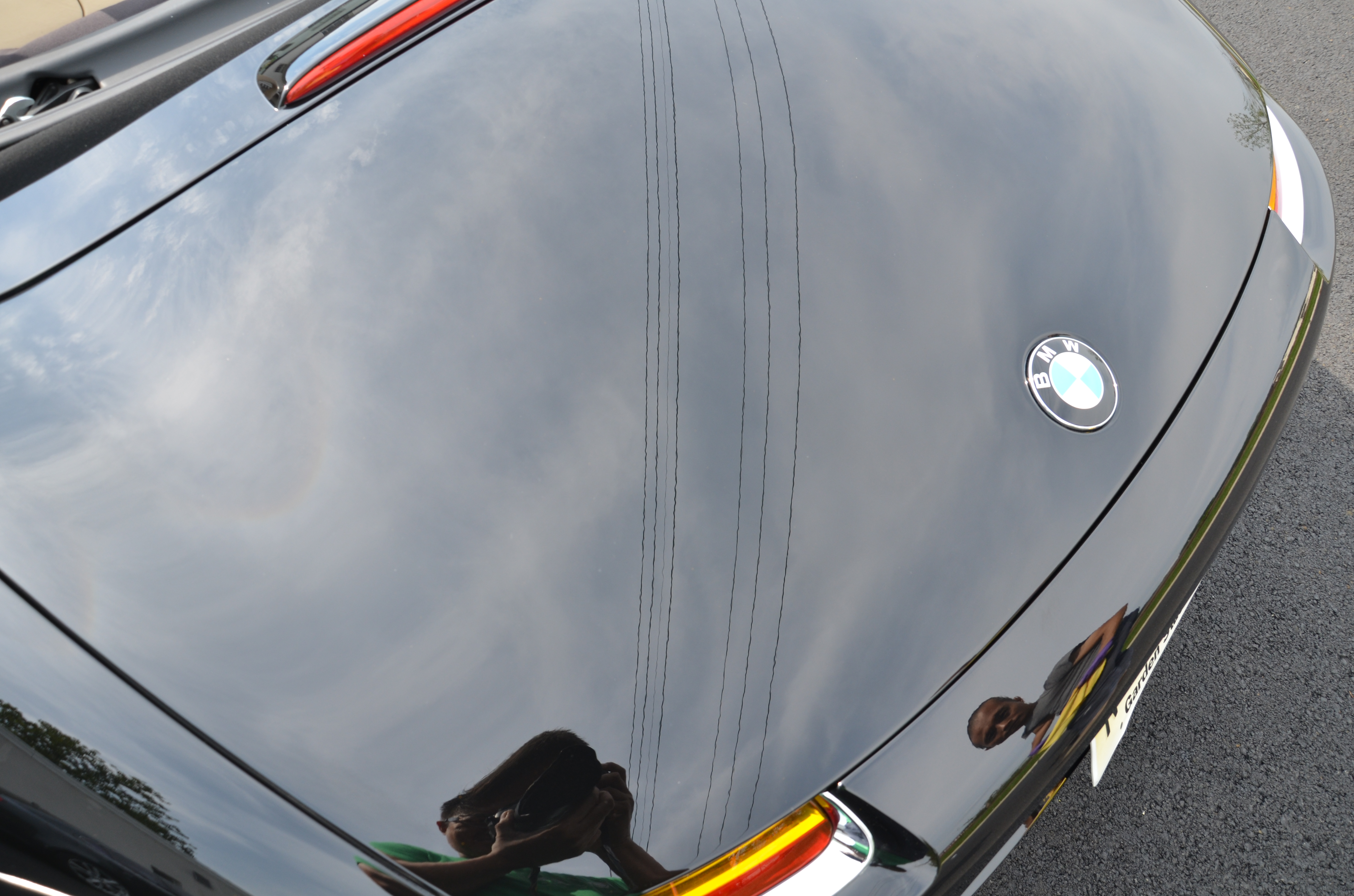

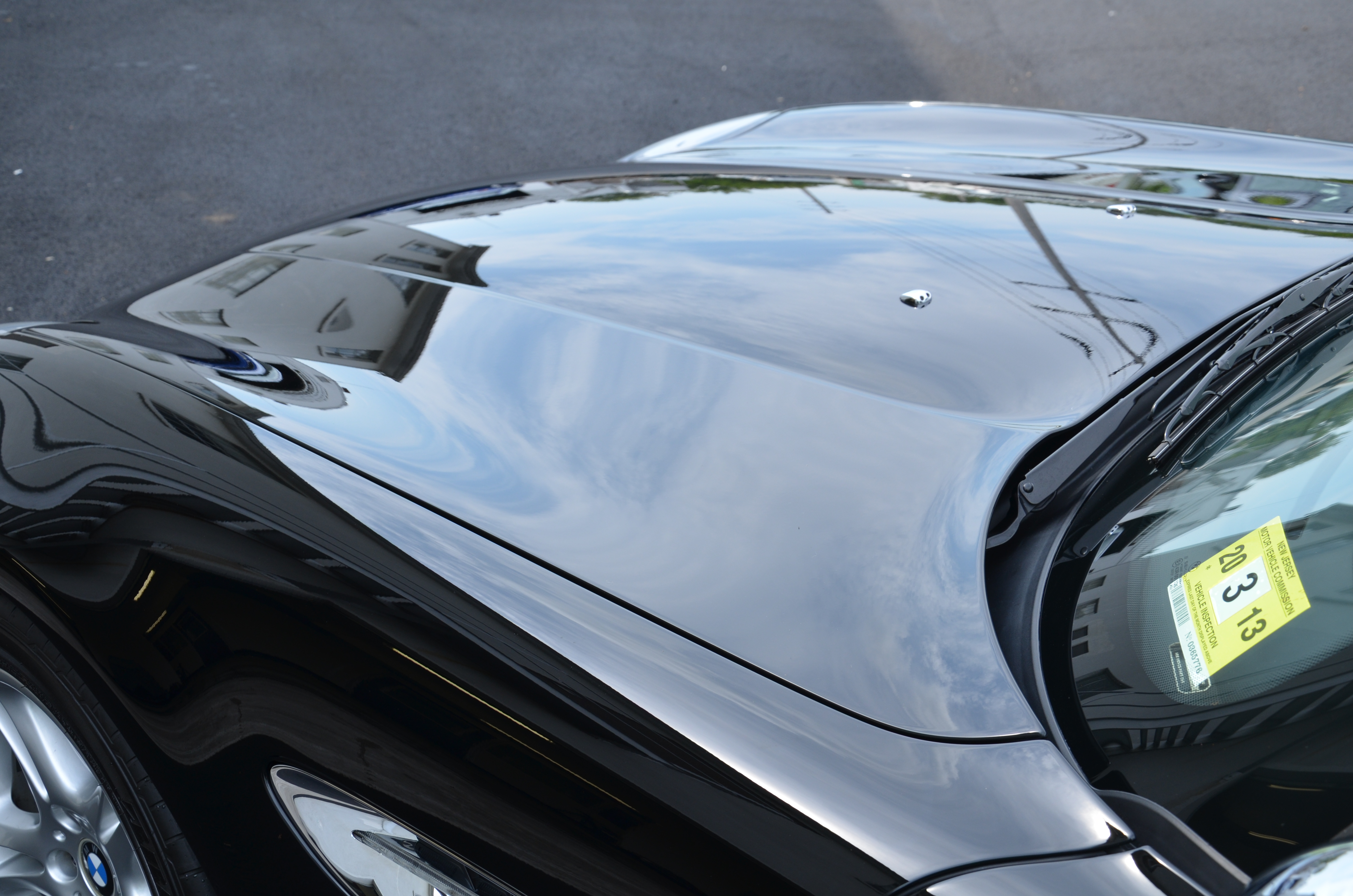

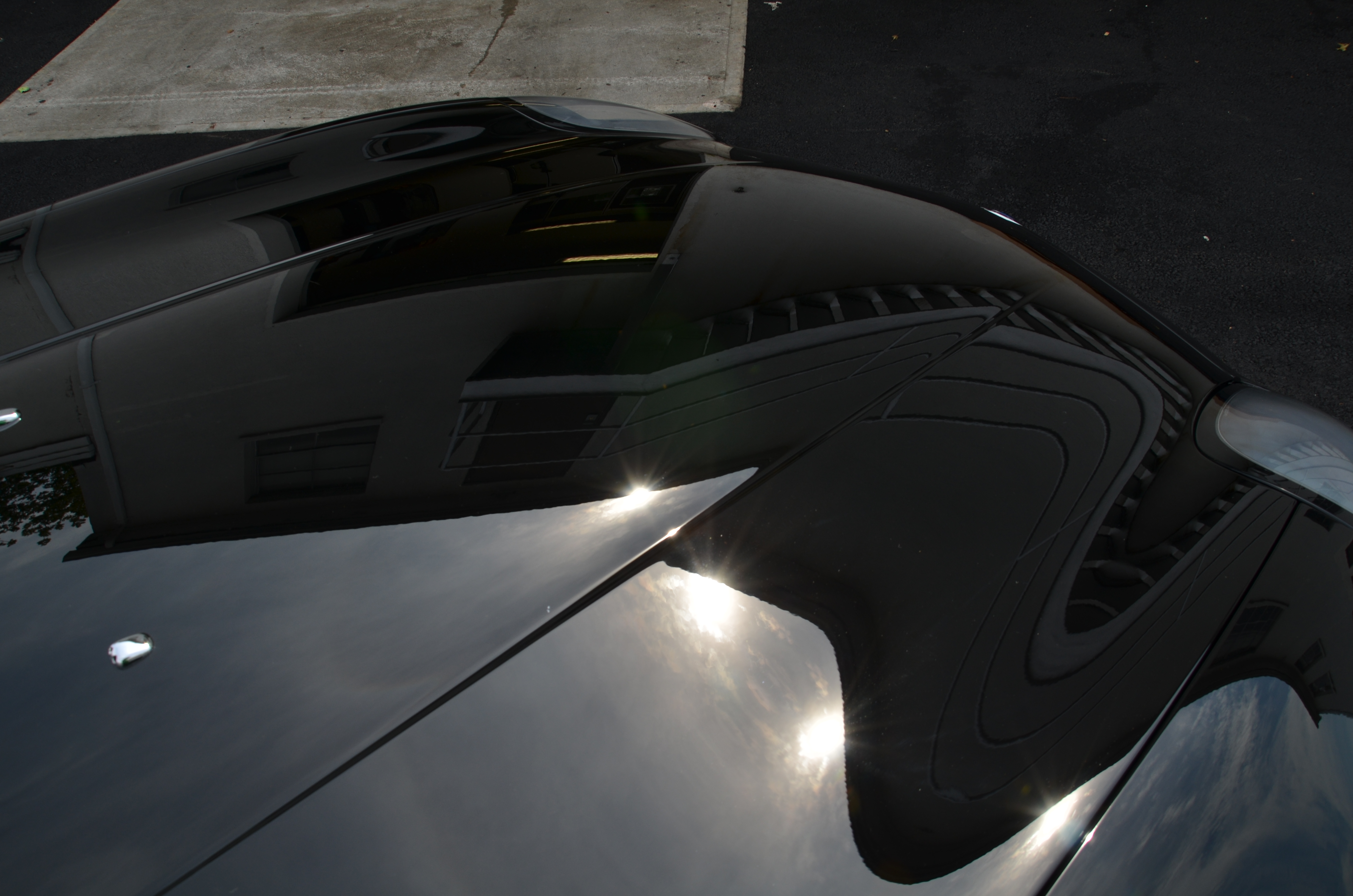

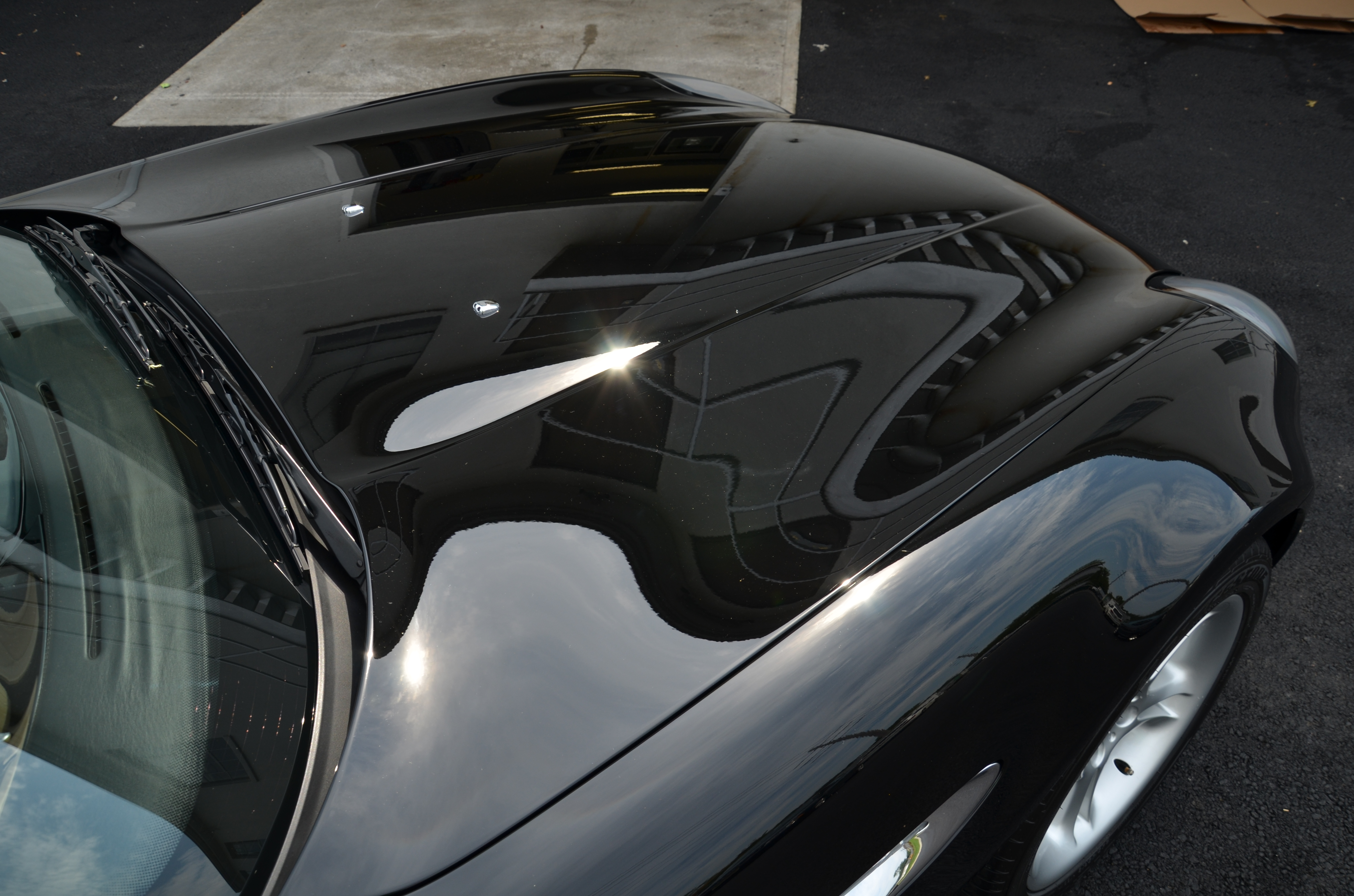

Afters under the lights

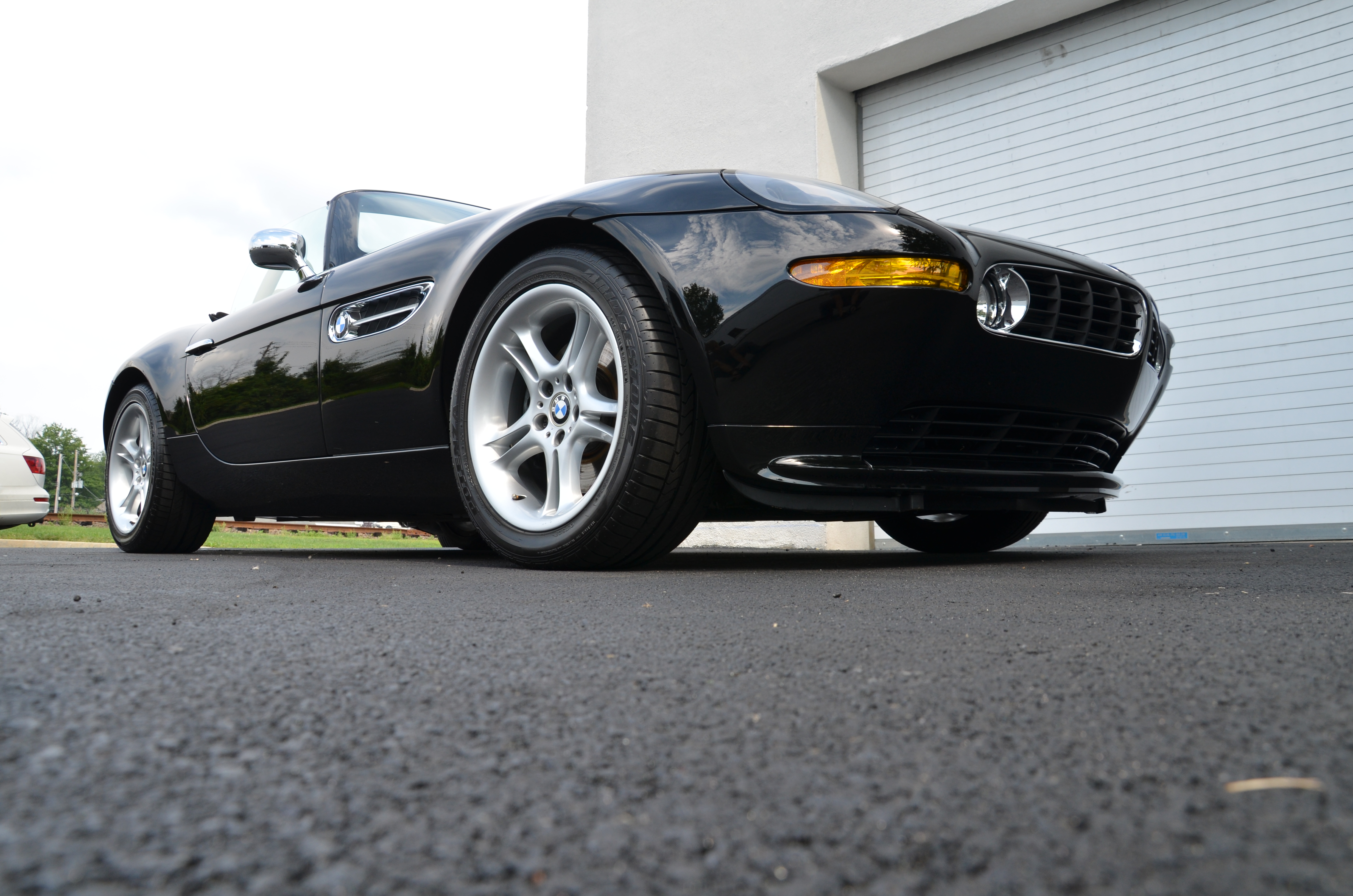

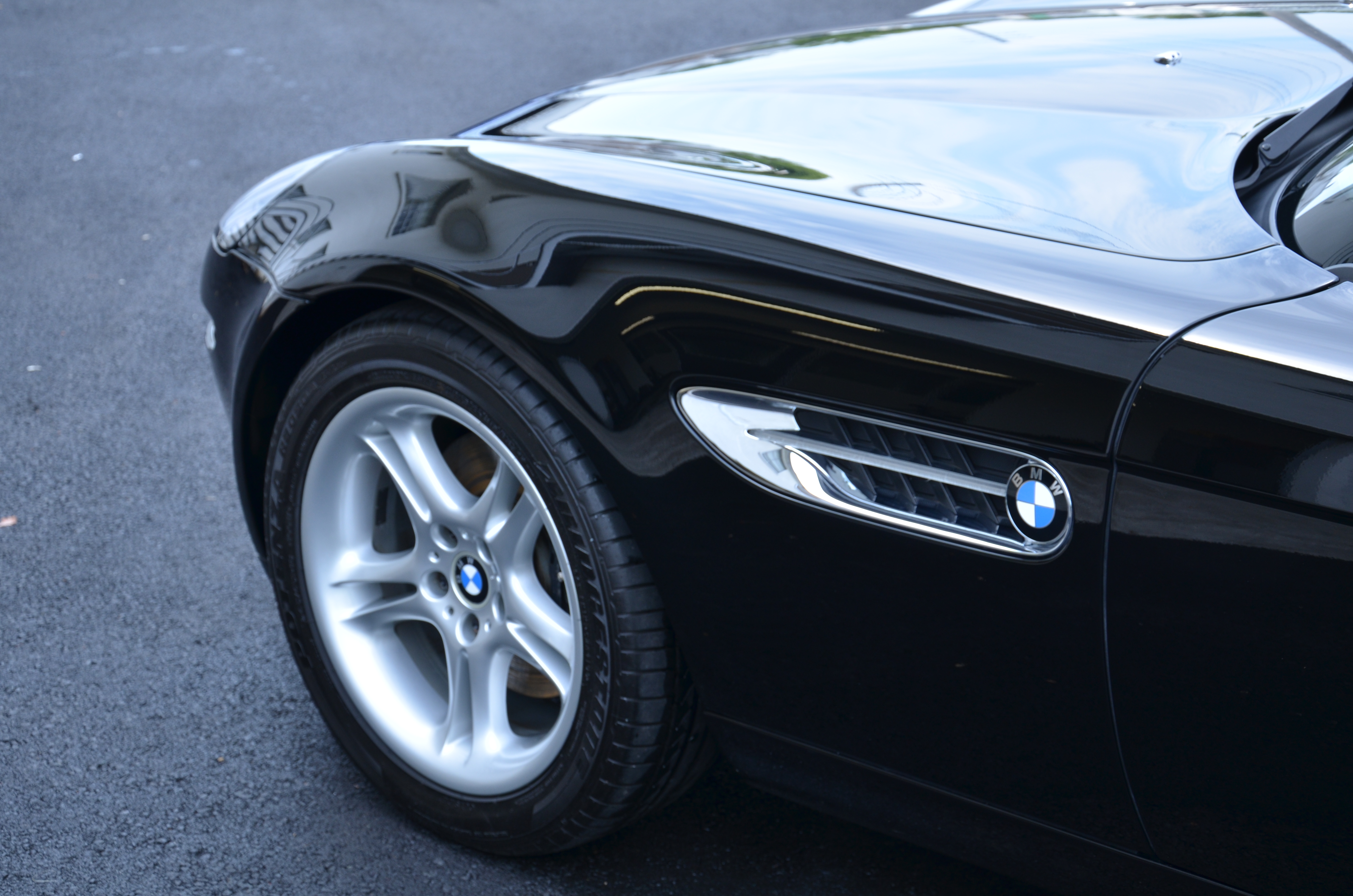

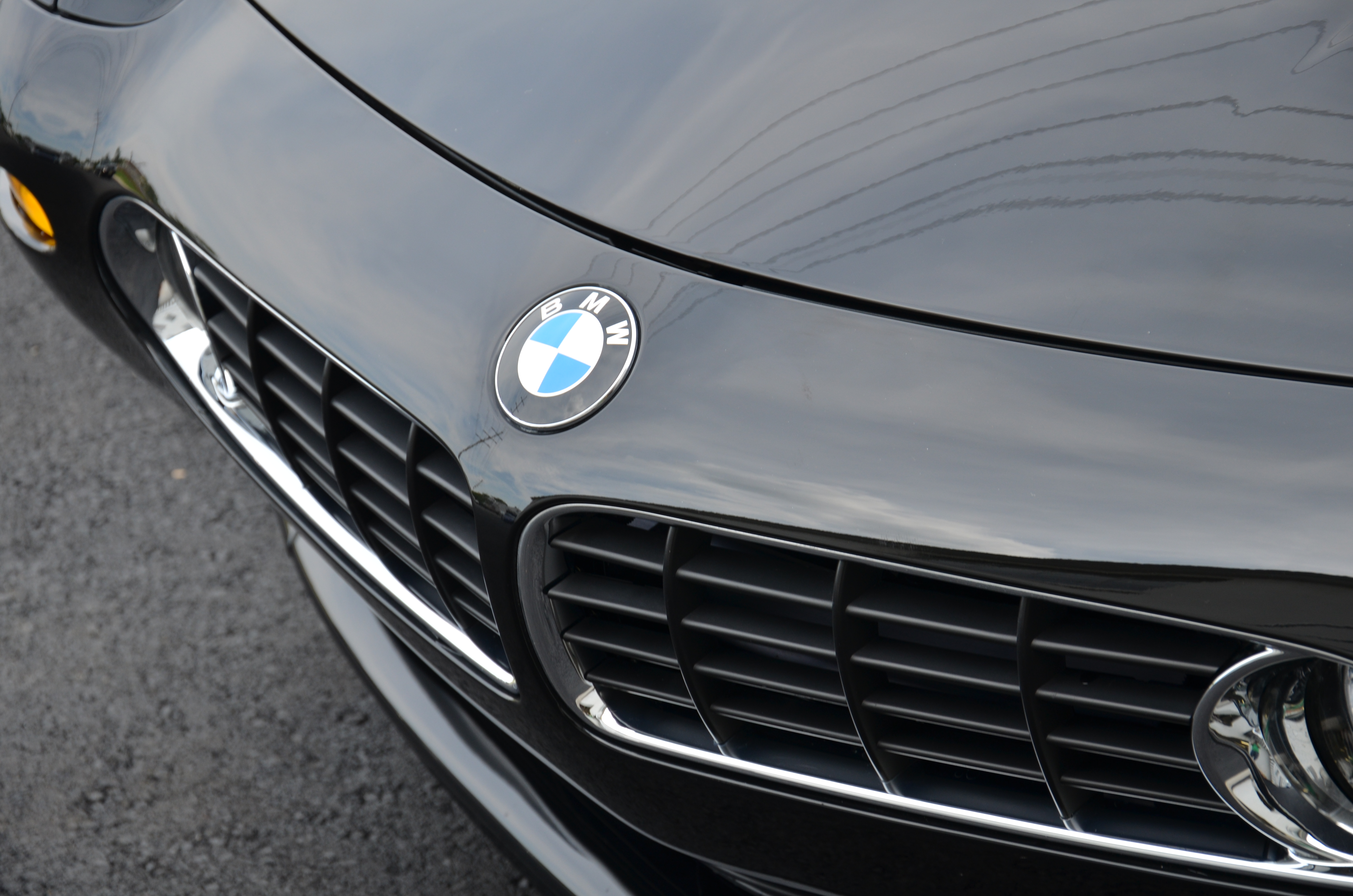

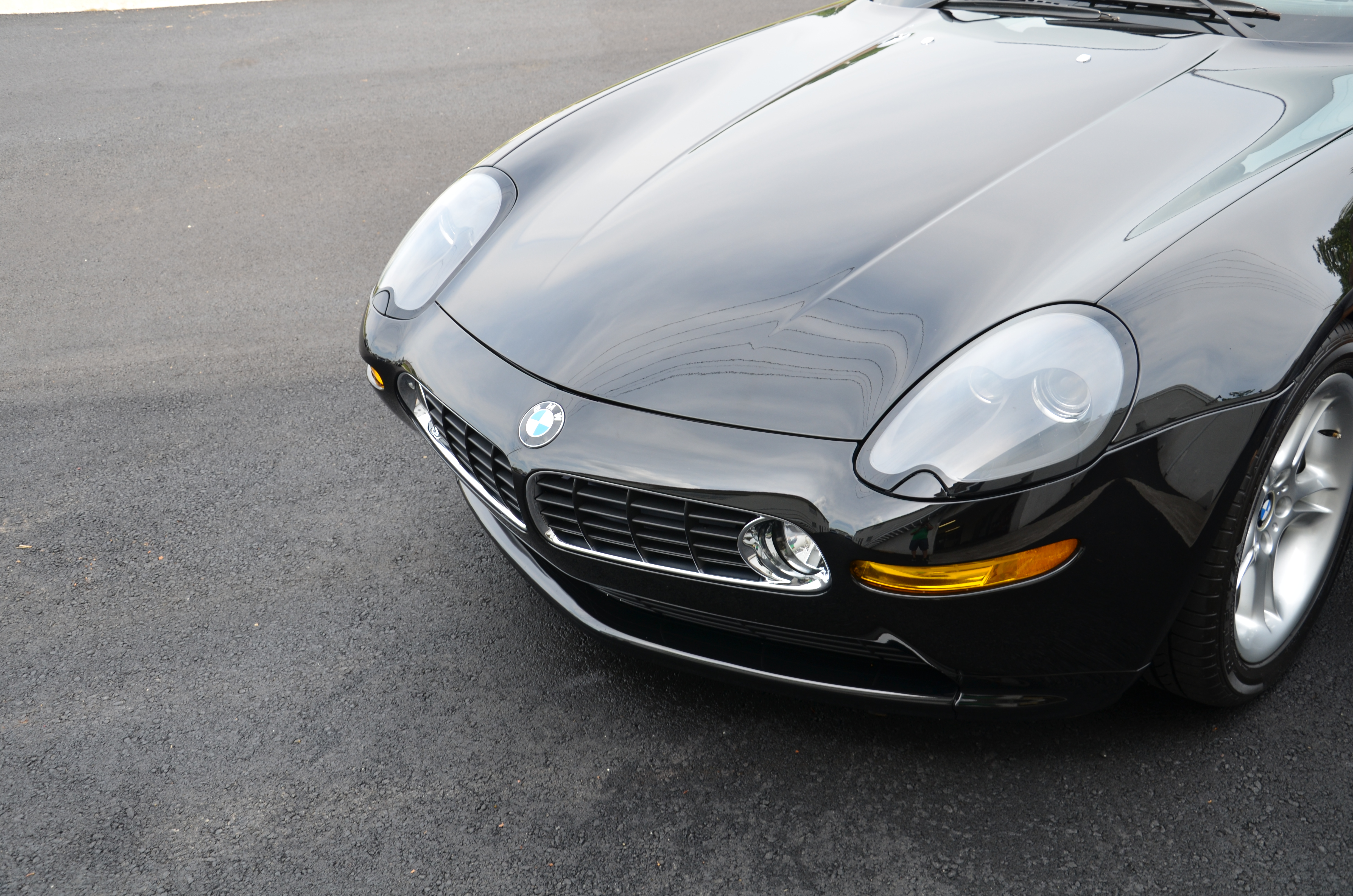

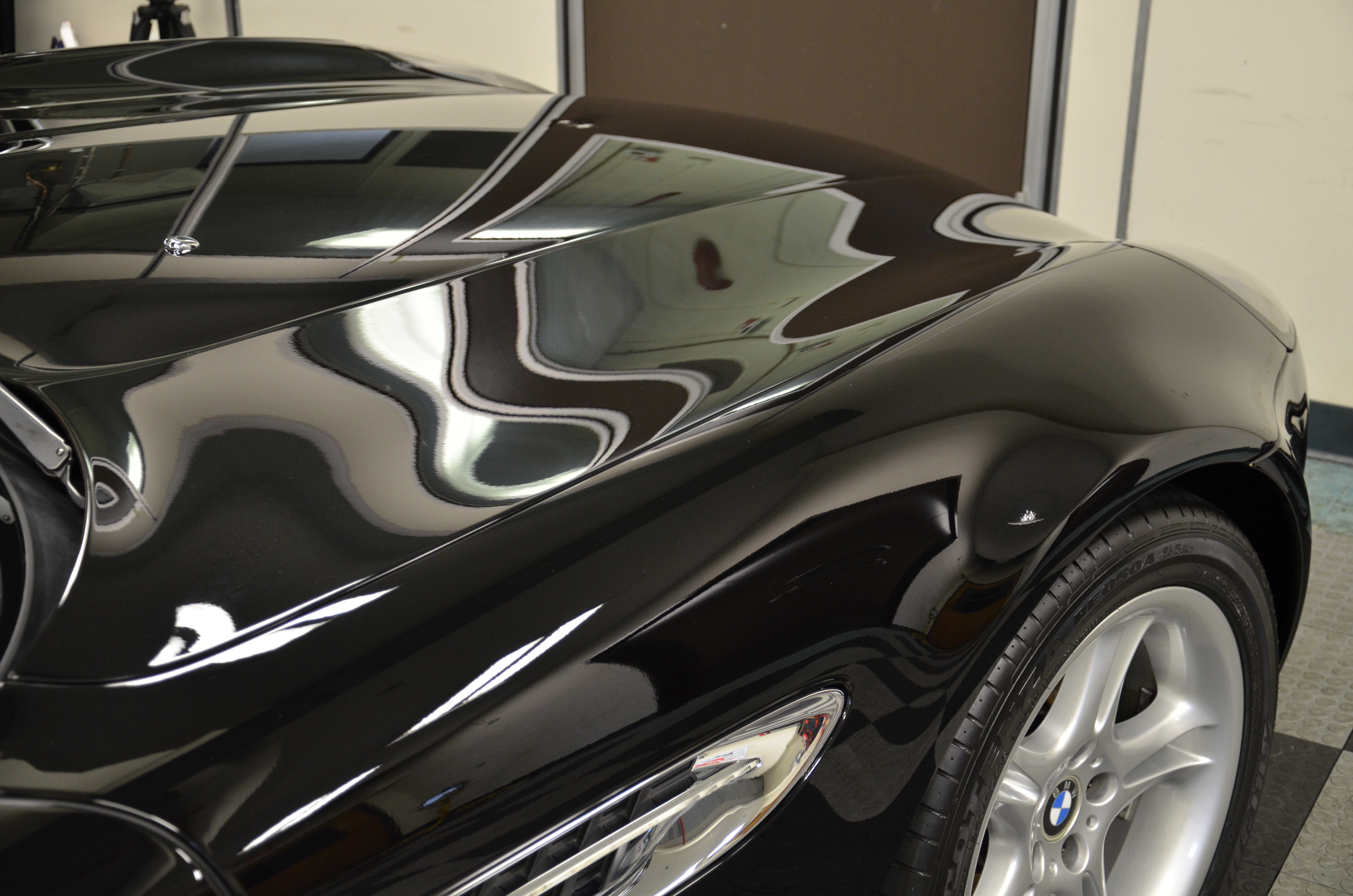

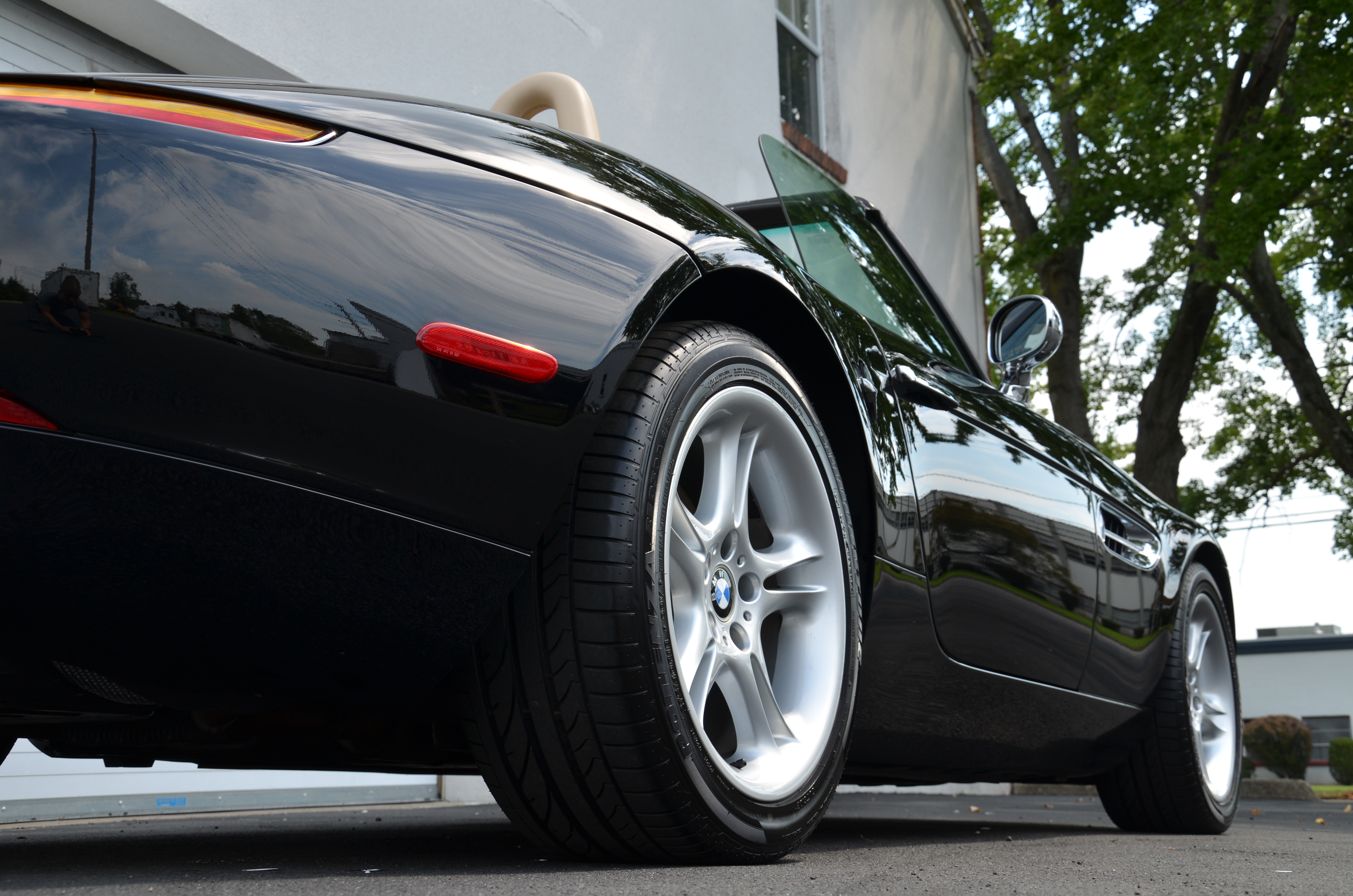

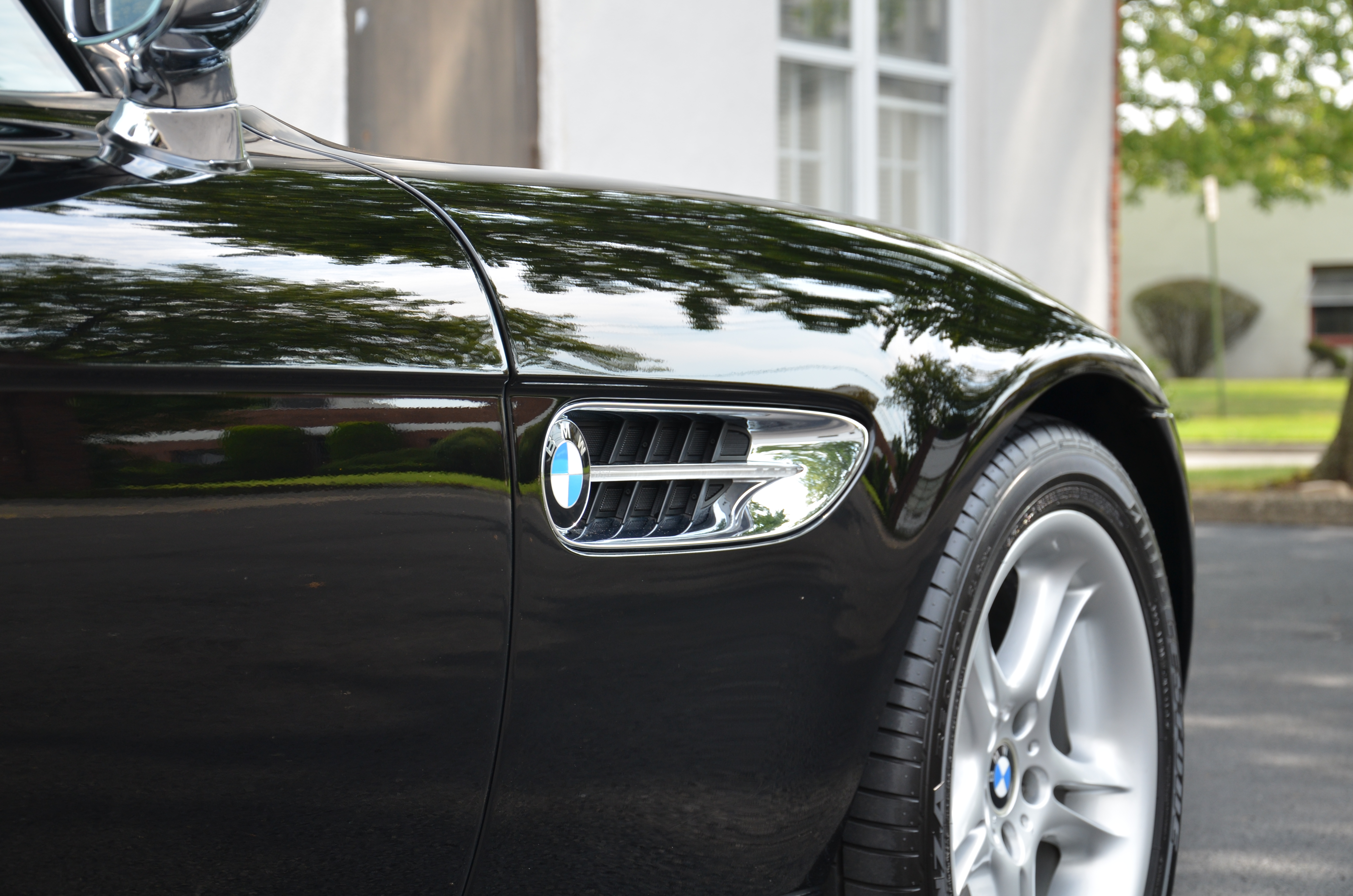

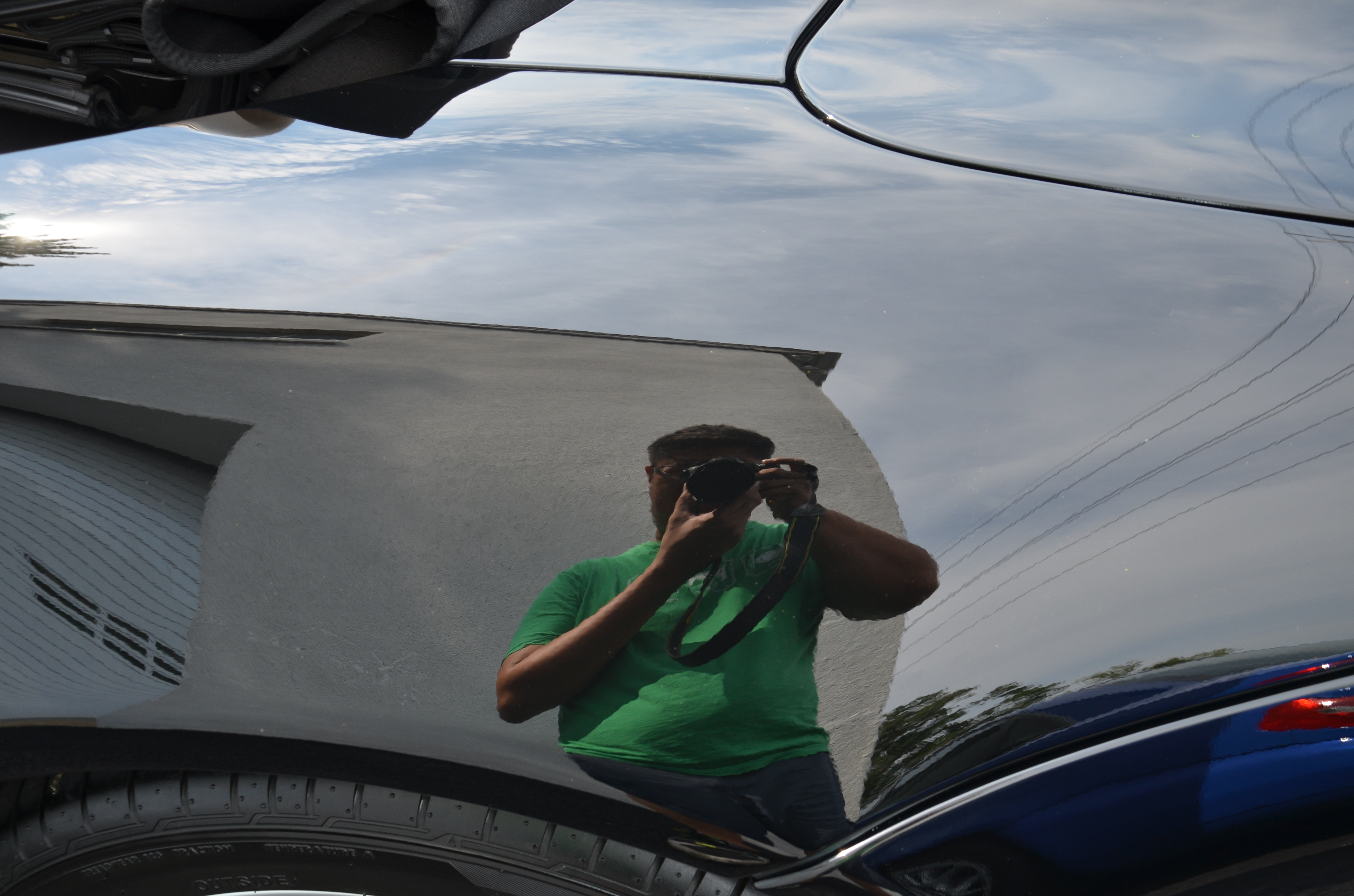

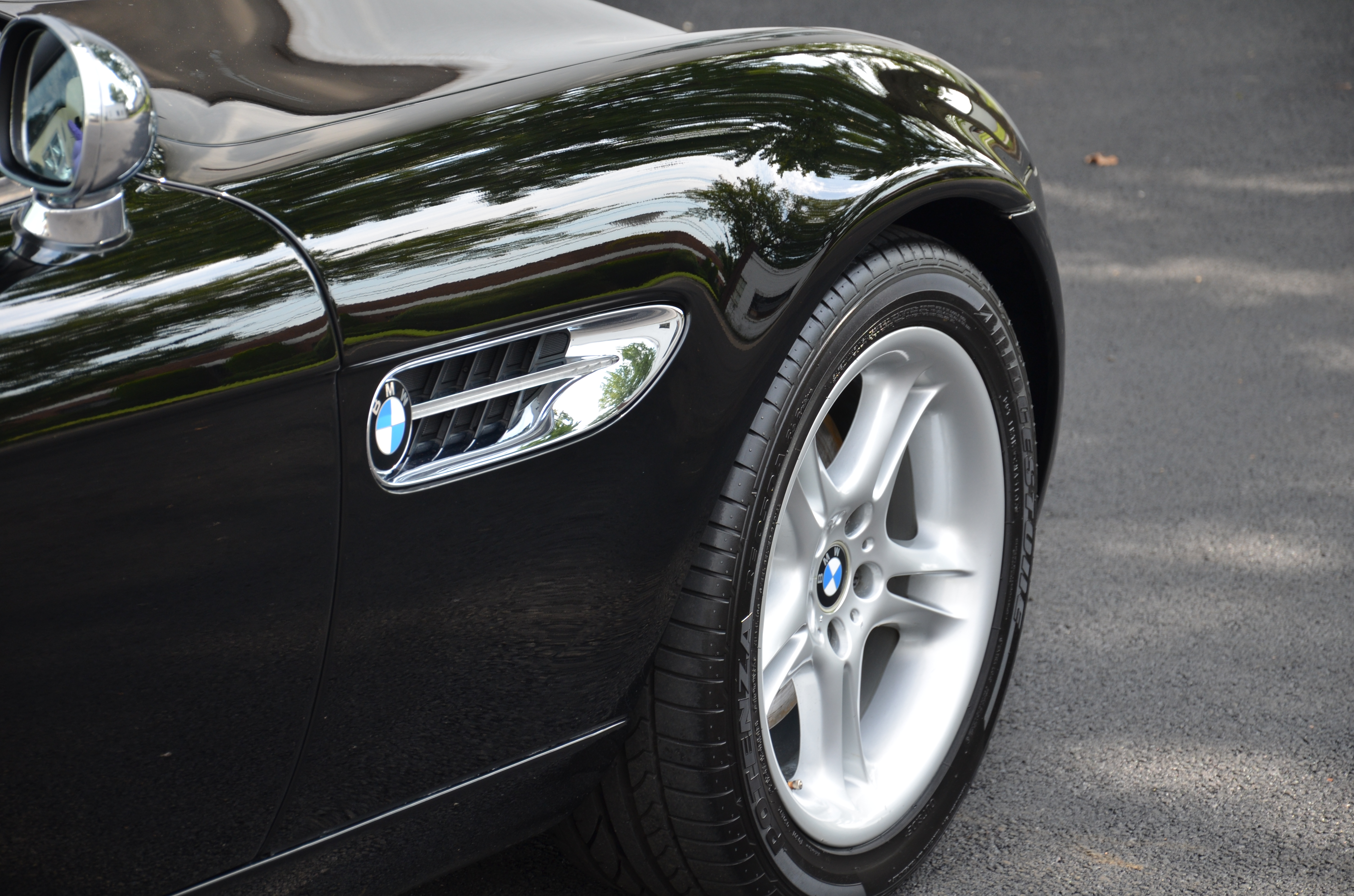

Afters
Enjoy
