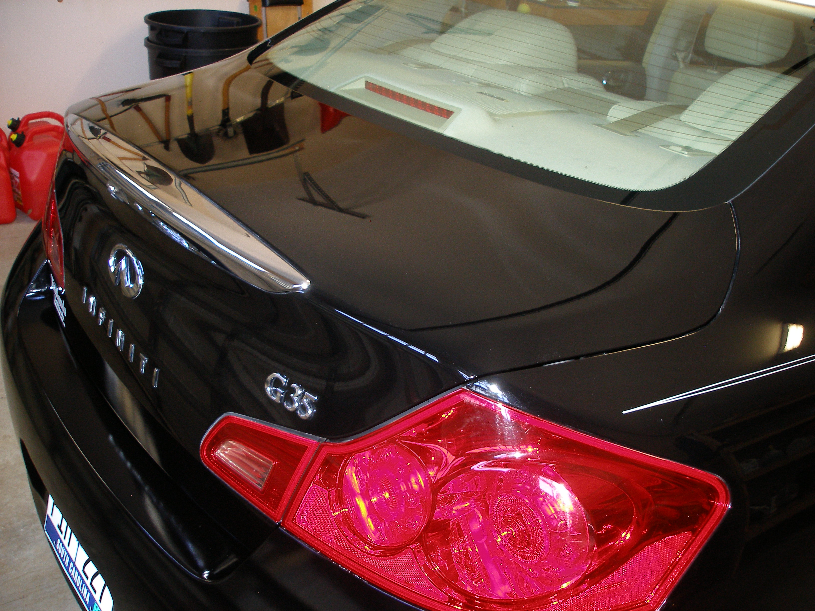

I just bought Blackfire Sealant and Blackfire Paint Cleaner. Hoped to use my D/A for the cleaner. I followed the instructions and could not get the product buffed out without leaving hazy smears. Had to use M205 to clean it up, I wound up applying it manually and buffing off IMMEDIATELY otherwise it would smear. What am I doing wrong? The product appears to prepare surface for sealant well but I am very bummed at having to do this manually.

Didn't get pictures of the problem. Here is the finished product. Will be doing the wife's car next. Will try applying at a lower speed. Fingers crossed.

Used the BF paint cleaner on my wife's G. Set the PC to speed setting 1. Came off without a problem so I guess the lower speed fixed my issue.

Glad you figured it out, car looks great!
