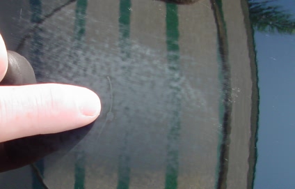

I am going to repair some chips, scrathes, and marks myself and I need some help. The DIY says to sand to sand the area after paint is applied with 1500 grit wet and dry sand paper. This doesnt sound like something that I want to do to my car. The next step it to polish and buff it out. Will it come right out and look as good as before.
Also please give me any tips you have. I will be doing most of the work on the front and rear bumpers. Is this a good DIY for the plastic.

With the proper polishes and techniques the sanding marks should come out of the clear coat.

yes...1500 wet sanded, can be followed by 2000 wet sand, followed by machine buff with 3m polish (not wax), followed by 3m hand glaze, followed by wax. custom paint shops use wet sand with the above process to completely remove orange peel texture of paint. this process leaves a glass smooth finish. however, this is not necessarily the look you want for patches of paint on a single panel. you must be very careful not to break though your clearcoat.
as far as the white paint scuff, start with a cleaner wax and a buffer (non-orbital). if you are not use to using a buffer, better leave it to a detail shop. if the key scratch is down to the basecoat or metal, there is nothing you can do to repair it yourself. a very light wetsand, followed by machine buffing can minimize the noticibilty of the scratch. if you are very picky, you need to repaint.

I totally understand - my car was the same way when I started. 2000 is going to be tough to take out by hand but it can be done, the only issue is with a lot of touchups you'll get damned sick of it fast, especially if it's not uni-grit. Id do one of two things, either find a place you can get 3000 uni-grit or buy a PC and some polishes. Either one will save you *hours* of work, and with the 3k grit you're much less likely to screw up and go through the clear.
In terms of how well each grit sands down marks, there is almost no difference. 3k sands down blobs almost as fast as 1500, and it's much finer so it's much easier to take out the sanding marks. You can see what I did to my car here:

First off, toss the buffing wheel. Unless it's a $200 Makita rotary it's probably crap. I'm betting it's a handheld $15 thing, right? If you decide to go with another machine what you need is a Porter Cable Dual Action Polisher. They're about $100, and they're dual action so it's almost impossible to burn the paint like you did. (The difference is buffing wheels spin like they're on a drill, they just spin. A PC is random orbital, so it never spins in one place)
Before you do that try by hand, though. The compound you got that says it'll remove 1500 marks probably will with a machine, but remember by hand it's a lot tougher to remove marring. Here is what I would do.
1) Get some 3000 unigrit, it's made by megauirs. You should be able to find it locally somewhere, I'm in Canada and we get it at Canadian Tire. I'd imagine Autozone or Pep Boys has it?
2) Clean thoroughly (rubbing alcohol and water) then touchup any scratches, chips. No, don't touch up the ones that are the size of a grain or sand, it isn't worth it. Follow the instructions on autopia-carcare.com under paint chip repair. Remember to let it dry before sanding.
3) Sand down blobs and scratches. Be careful, don't go through the clear. Use a block if at all possible and use a lot of lubricant. Sanding the touchup blob on that scratch you mentioned should work. You're just trying to level the blob with the rest of the paint. Do it just like they tell you to here:
http://autopia-carcare.com/inf-paint-polish-clinic.html (scroll down to chip and scratch repair)
4) Polish with your compound via the instructions. It might take a few passes and a lot of elbow grease.
