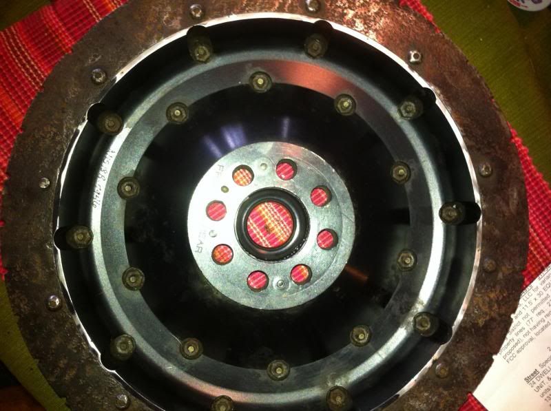

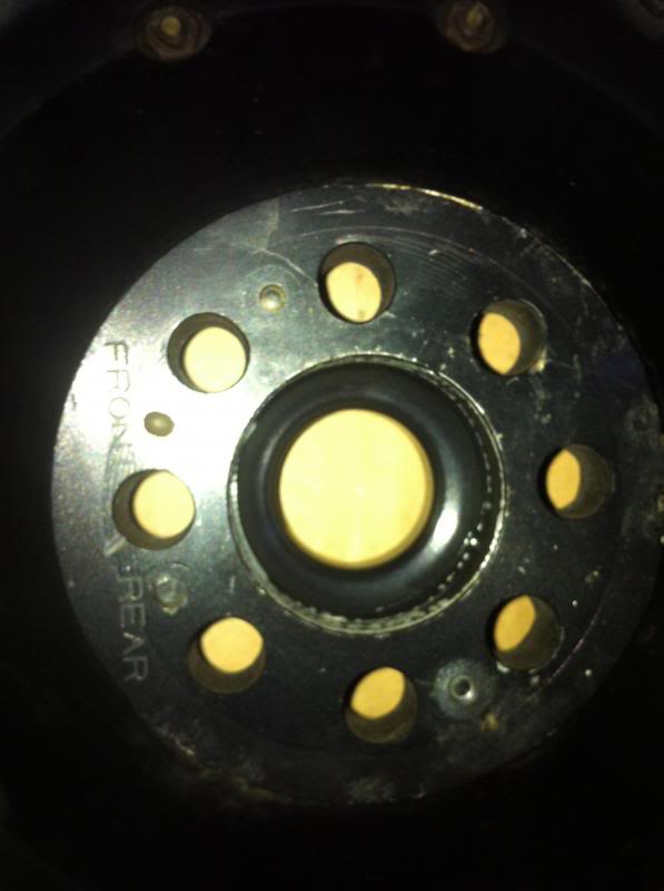

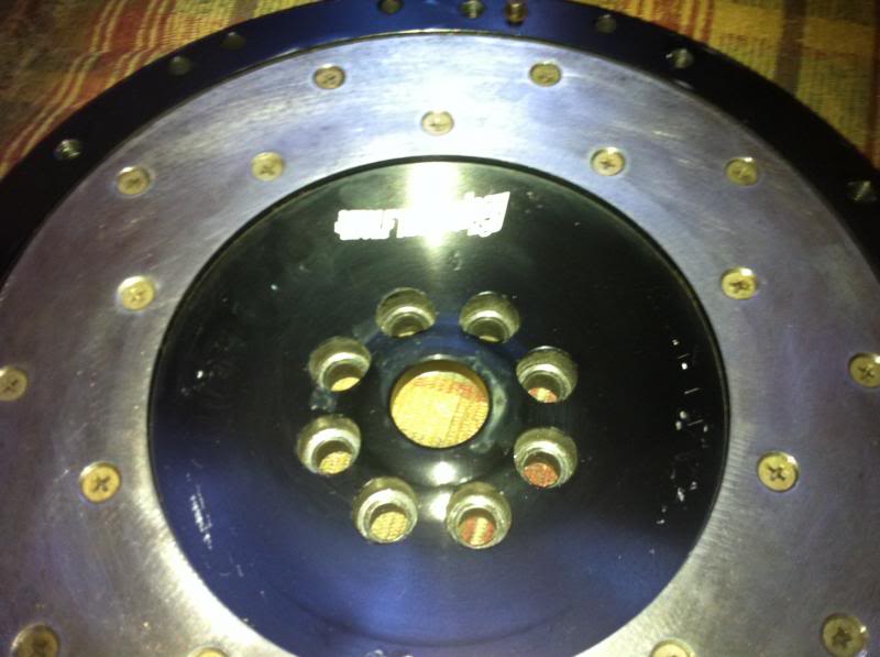

In process of getting clutch and flywheel in and came to a part i cant figure out how to line this flywheel up to the crankshaft dot on engine with flywheel. There is 4 little holes on the back of flywheel 2 of them says FRONT and REAR then 2 others. Having trouble in what one to line up to the red dot any help would be amazing see pics below.

Put the motor on Top Dead Center. Also, screw the Crank position sensor back in. The pin should be at the 1-2 o clock position. Make sure the dowel pin fits the flywheel and it should go on with the 'jwt' writing siting at the 12 o clock position. Verify the flywheel is indexed correctly.

The flywheel says Rear for the rear wheel drive vehicles it is used with arent i just lining up the rear hole on back to the whole in the image above?
